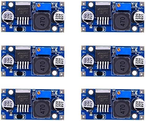

I’m not suggesting this, but I have my pi powered off the 12V with one of these (I don’t have this exact one, but it’s similar):
It has a set screw for adjusting the voltage, so you’ll need a volt meter you trust. You can either wire it to a usb connector or solder it to the pins of the usb connector. I have mine set right at 5V and I have it plugged into 5V and GND on the big IO header, but that bypasses the power filter on the pi. I think that’s fine with aomwthing like this because the power filtering on these boards is probably bigger than the ones on the pi anyway, just don’t set it to 6V.
