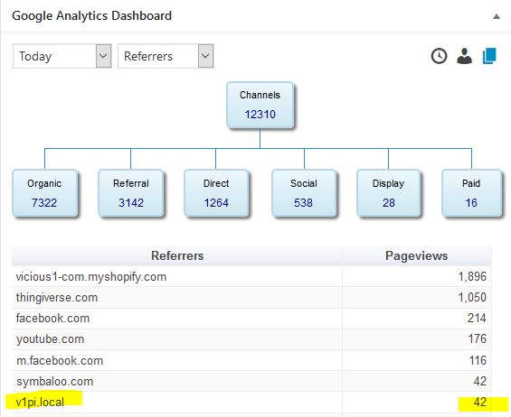

So…we have had some interesting visit stats today.
[attachment file=71915]
Tooo freaking cool! I love it. Broke into the top 10 even.
So that’s the link from the landing page, I guess? Is that just from today? I should have installed some ads :).
I really have no idea how many of these are out there. The only thing close is the traffic numbers from the github pages. It doesn’t track release downloads. AFAIK.
I would assume most people don’t use that link to get here, most of the time. So there must be a lot more than 42 of them out there. :smiley: . Thanks for sharing.
You can put me down for at least 10 of those.

No that is the previous browser location, and how many pages were seen after, collectively. So Steve and others were checking there machines and coming to the site. So total pages seen after being at that address for half the day.
[attachment file=71975]
This is just for the page views on the tiny landing page I made, I have to assume the github is much much higher. Sorry sometimes I forget I have these kinds of tools at my disposal. You used to be able to see a flow chart of what page was next but I can’t find it.
Huh. So if I was at cnn.com, and I typed V1Engineering.com in the address bar, that gets counted as from cnn.com? I thought it was something more like it only mattered if you clicked a link on cnn.com that took you to v1engineering. I have much to learn about these analytics. I also assumed if you opened a new tab to go to v1engineering, it wouldn’t know that you were just at v1pi.local in another tab. Certainly v1pi isn’t sharing that, so it would have to be the browser sharing that info.
I am not really sure. Does v1pi have a direct link to the site in it?
IIRC, the about links here and the logo links to the homepage.
