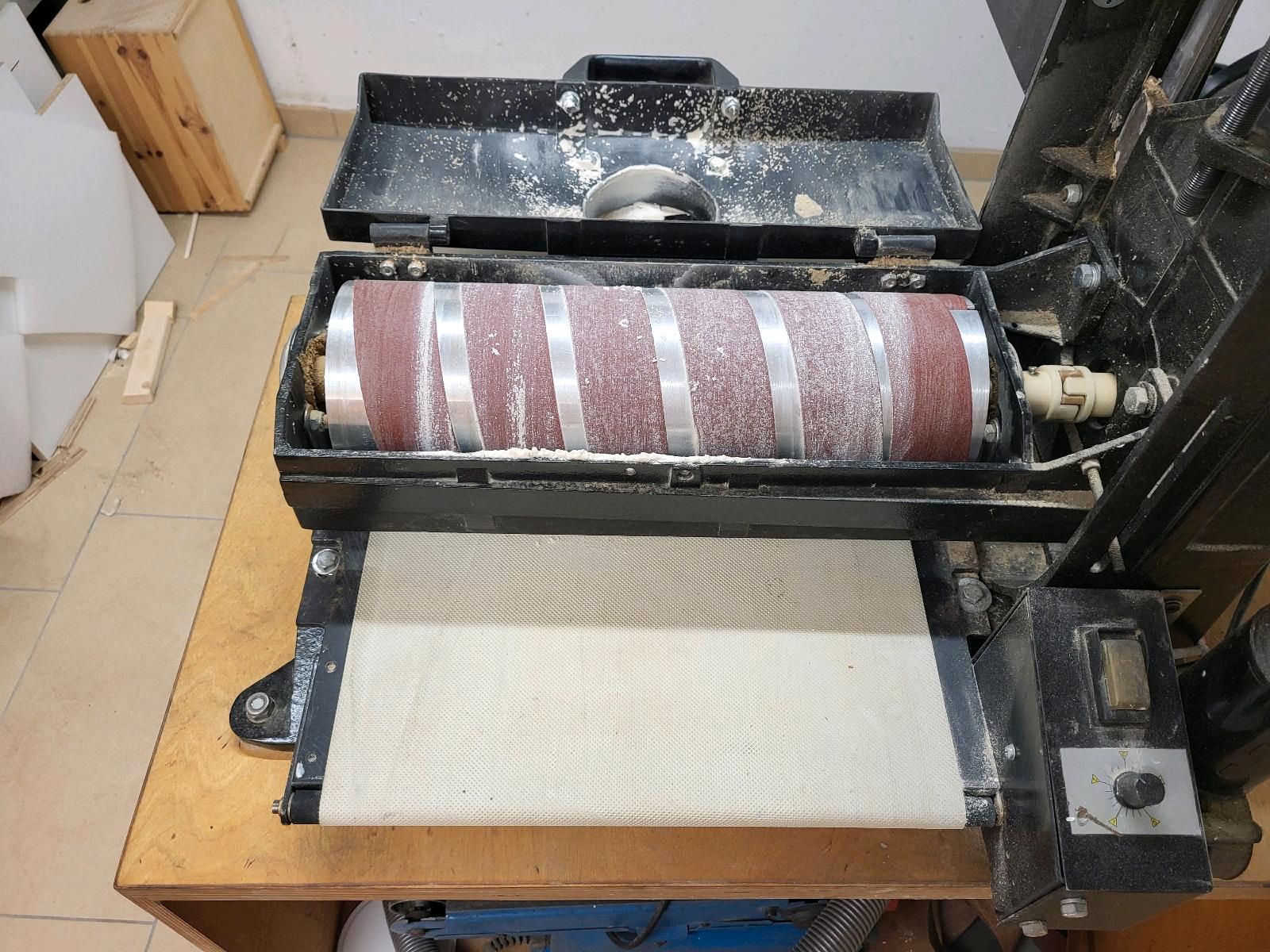

I guess so, a lot of builds on YouTube even use a drill (which I think is stupid), my motor has got 1.1kw and 1400rpm, which is roughly 1.5hp. It’s three phase power though.
The hardest part to find was the coupler. I didn’t want it to be belt driven because I wanted it to be low profile. :slightly_smiling_face:
Direct drive? I think the belt adds some vibration dampening and allows for a sort of clutch if something goes wrong and you need the slip.
How well does it work? I have seen drum sanders used a lot for things like end grain cutting boards.
It works incredibly well, made it exactly for what you suggest, cutting boards. If you look at commercial machines by Jet etc. they always use the direct drive, but have the height done via a main axis where the whole axis goes up and down.
You can see it here for instance (ignore the fact that the seller did something weird with the sanding paper):
This is a cheap version with a plastic coupler, mine is steel and has got a rubber thingy in the middle to allow for dampening and a little play.

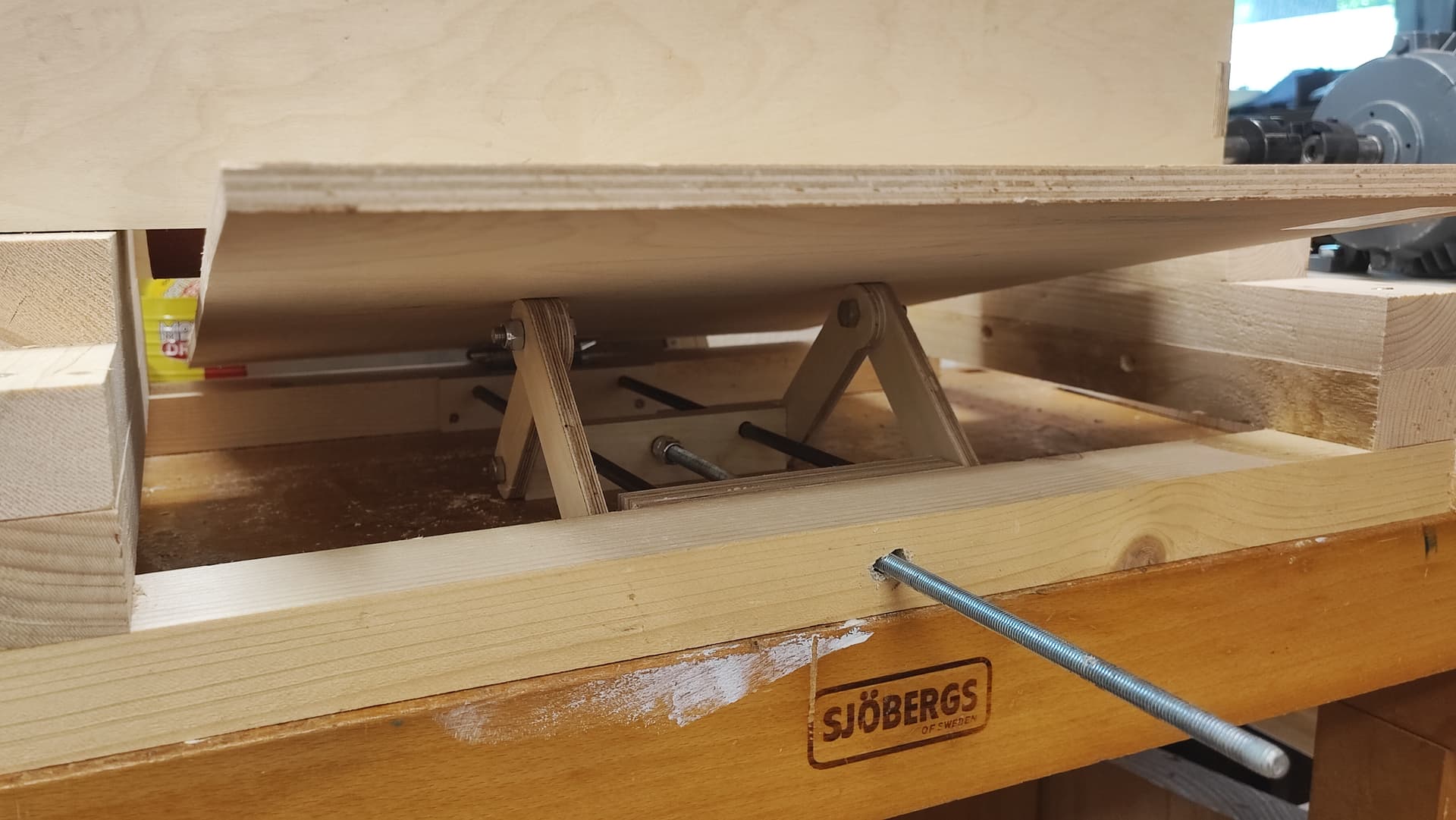

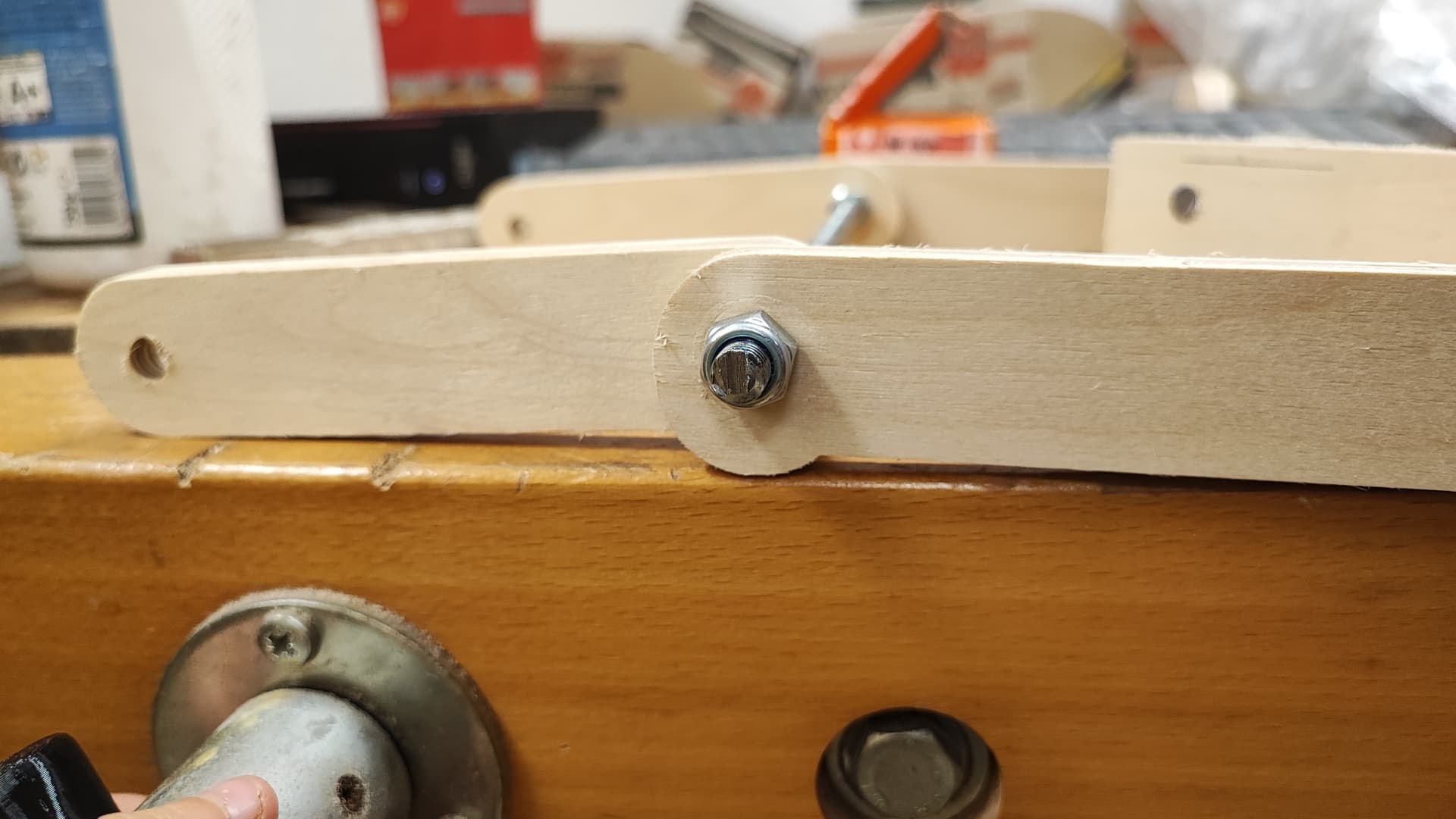

The little noses make sure that it only goes up and does not bend down into the table, which the first version always does.

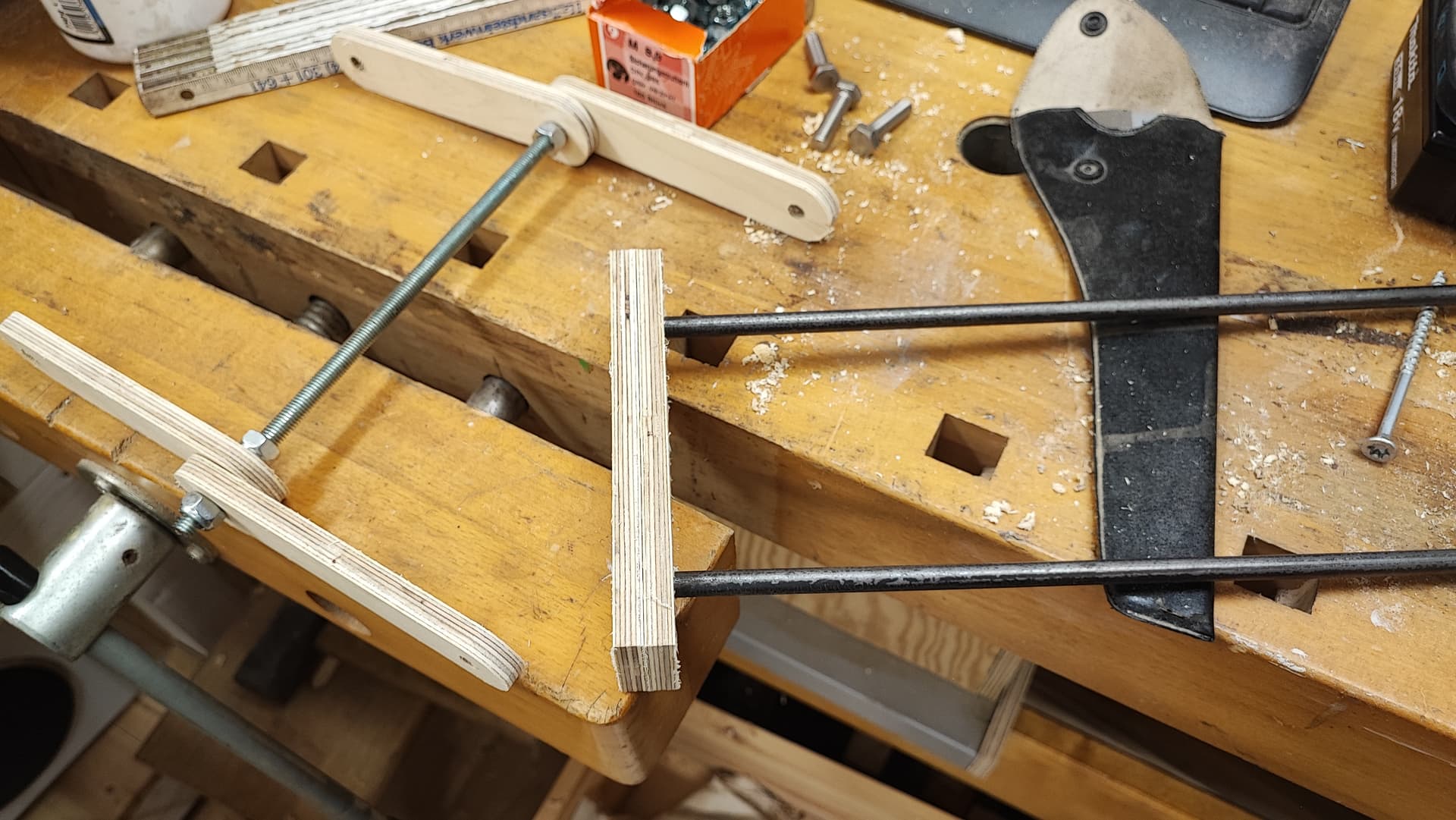

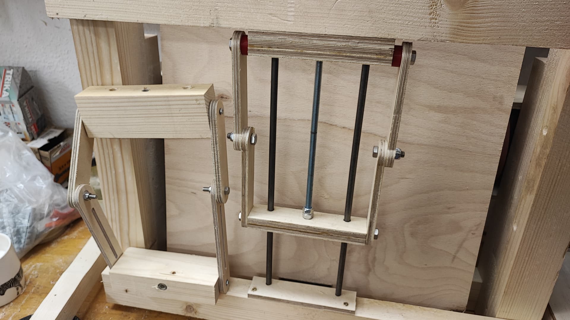

Started a new, better height sled thingy with steel rods for guidance and stability.

Old vs. New.
Okay, done, I guess. :smile: Now I still have to make sure the plate the workpiece is on is less wobbly. I might go to my woodstore and look for nice leftovers. I want one of those black plywood boards. :yum:

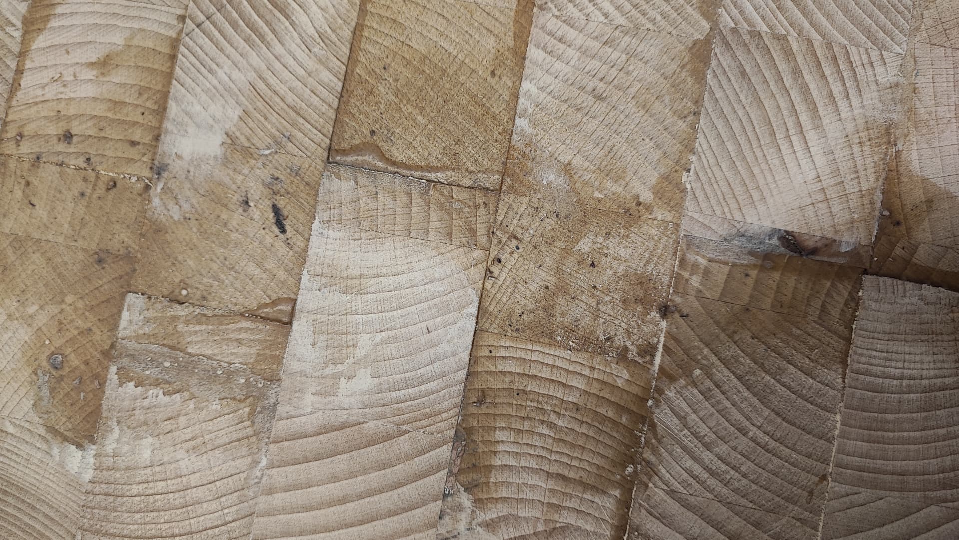

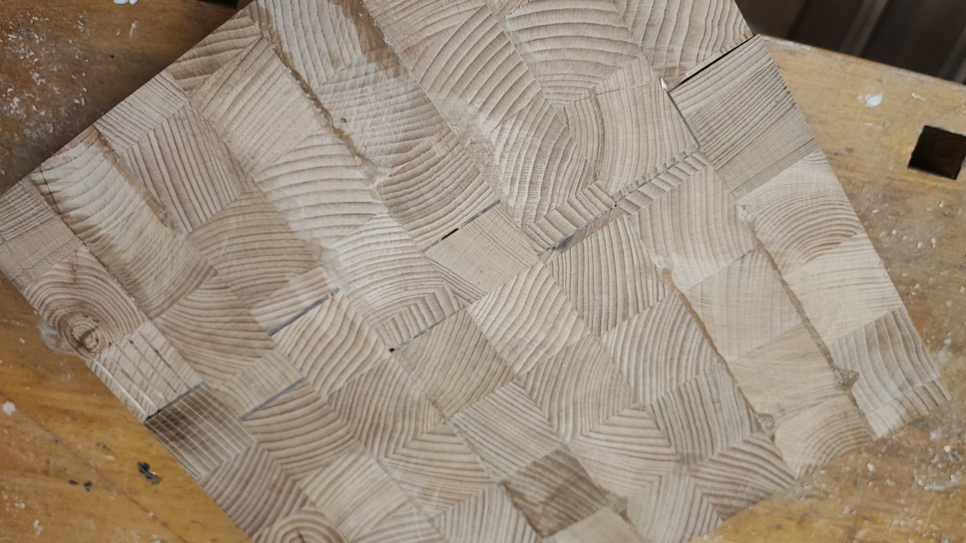

First results are in. I took the most shitty glue up I’ve ever done and the sander works better than I’d ever imagined.
I just stopped at some time, but I could have had it all smooth like a baby’s behind.
