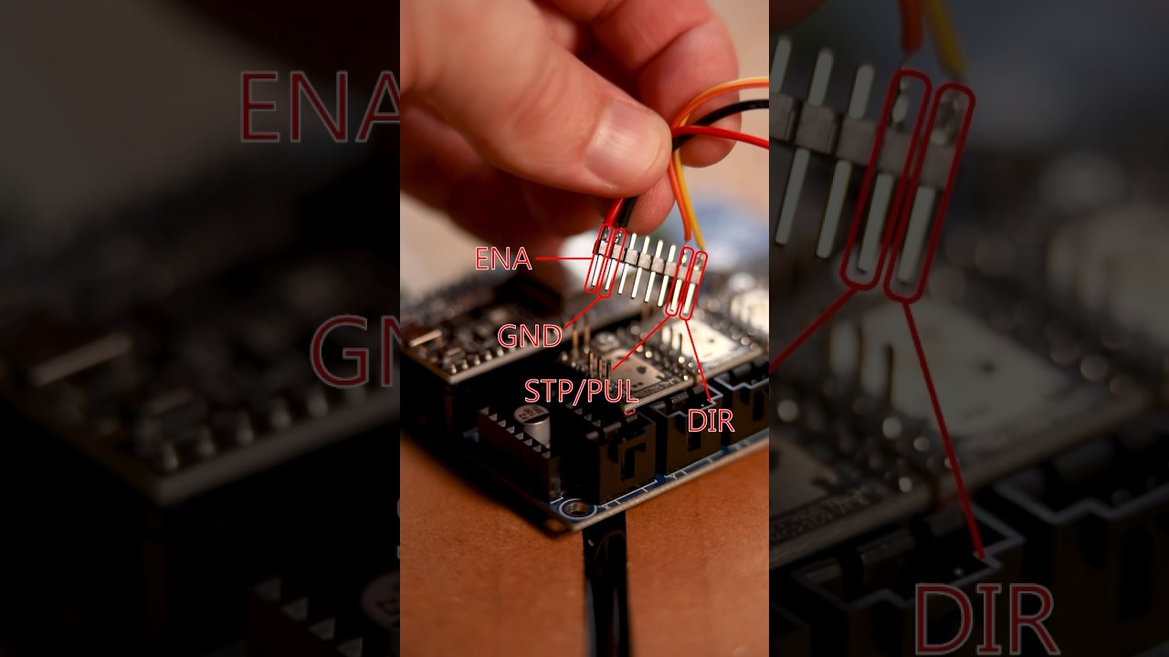

Hello guys/gals. I am a machinist apprentice in Switzerland and I am so fascinated by machine tools, that I’ve decided to build my own 3 axis CNC milling machine, but i need serious help. First off, sorry for my grammar, english is my 3rd language.
I have bought the V1 Jackpot CNC Controller with ESP 32. It is currently equipped with TMC2209 drivers, but I want to use DM556 drivers because I considered to use NEMA 23 stepper motors → higher voltage. I already have the UGS (Universal GCode Sender) and Fusion 360 / Mastercam to make CAM programs. I am planning to use 6 steppers (each 3,6V DC, 3,0A and 1,2 Ohm) and a MeanWell PSPA-1000-48 power supply.
Now to my questions:
  1. How do I connect the DM556 drivers with the board?
  2. I know that my drivers need external power supply, but does this apply for the steppers too?
  3. Two stepper motors and drivers for each axis (X,Y,Z): How do I change the orientation / layout of the board?
  4. VFD: How can I turn on the spindle with M-Code like M3 / M4 and turn it off with M5?
  5. Can someone please explain the inputs and output on this board and what they could be used for? Havent found anything related or easy to understand.
  6. Can I use 1 power supply for the board, the 6 steppers and their drivers? Or do they each need their own power supply, and if, please recommend models or requirements.
I am eagerly waiting for your responses. Any help is welcome. Thanks!
Well, the Jackpot is designed around the TMC2209 drivers. As far as I know, you cannot use external drivers with it but I will let someone else confirm.
Also, the Jackpot runs on 12 or 24 volts. You cannot use 48 volts.
There is a different FluidNC board (not V1) that supports external drivers.

You can use external drivers with FluidNC and therefore with the Jackpot, but it will take some work. We’ll need to do a fair amount of config work and likely some iteration with @SwissMFG to get it right.
You’ll also need to buy or make adapters to pick off the Step/Dir and enable signals from the board.
This is well “off the beaten path” so we’ll need to work it carefully together.

Can just use pins, or better still…
There’s an adapter already, $2/port.

Have you read through the documentation on using external drivers here?
http://wiki.fluidnc.com/en/support/external_stepper_motor_drivers
Bart Dring mentioned 556 drivers need 5v logic and the esp32 is 3.3v I don’t know if the jackpot has a level shifter built in.

It’s been done ocasionally with Jackpt, and it is done regularly with the boards Bart designed specifically to run FluidNC with external controllers.
It is possible to run your controller and stepper motors from different power supplies.
The key is to do the grounding (power returns) correctly.
That said, it isn’t clear why you’d want to do this.
We’ll need some machine specifics to start with (See below).
No. without position encoders or true closed loop stepper/servo control the system is open loop for motion control.
That’s not regular or standard for this class of controller electronics.
Out of curiosity, what is the shipment/customs fees for those parts to your location? (Curious if perhaps your location is better suited to having JLPCB build them from the sources)
You can go as simple as plugging pins into the step stick driver locations and routing the wires to your external drivers, which is easy and reliable if the board is in an enclosure.

ESP-32/Jackpot are designed using 3.3V electronics, so you either need to use an external driver that is 3.3V control compatible or plan to use level shifters.
