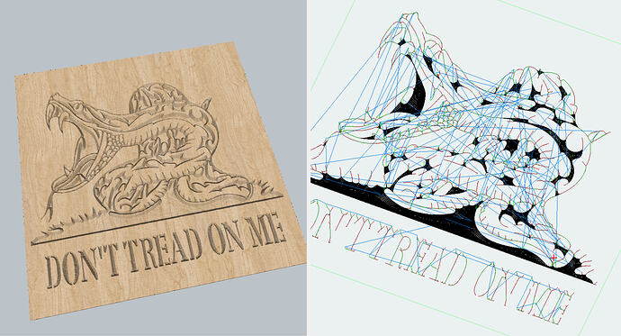

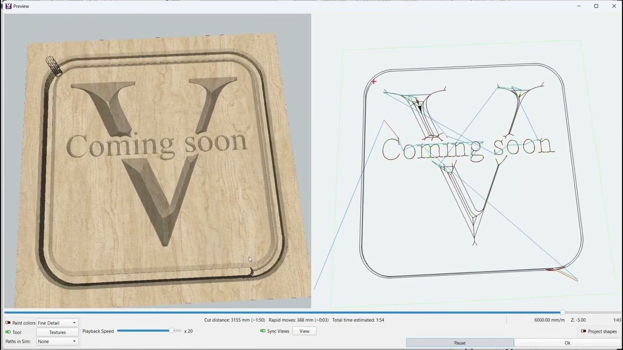

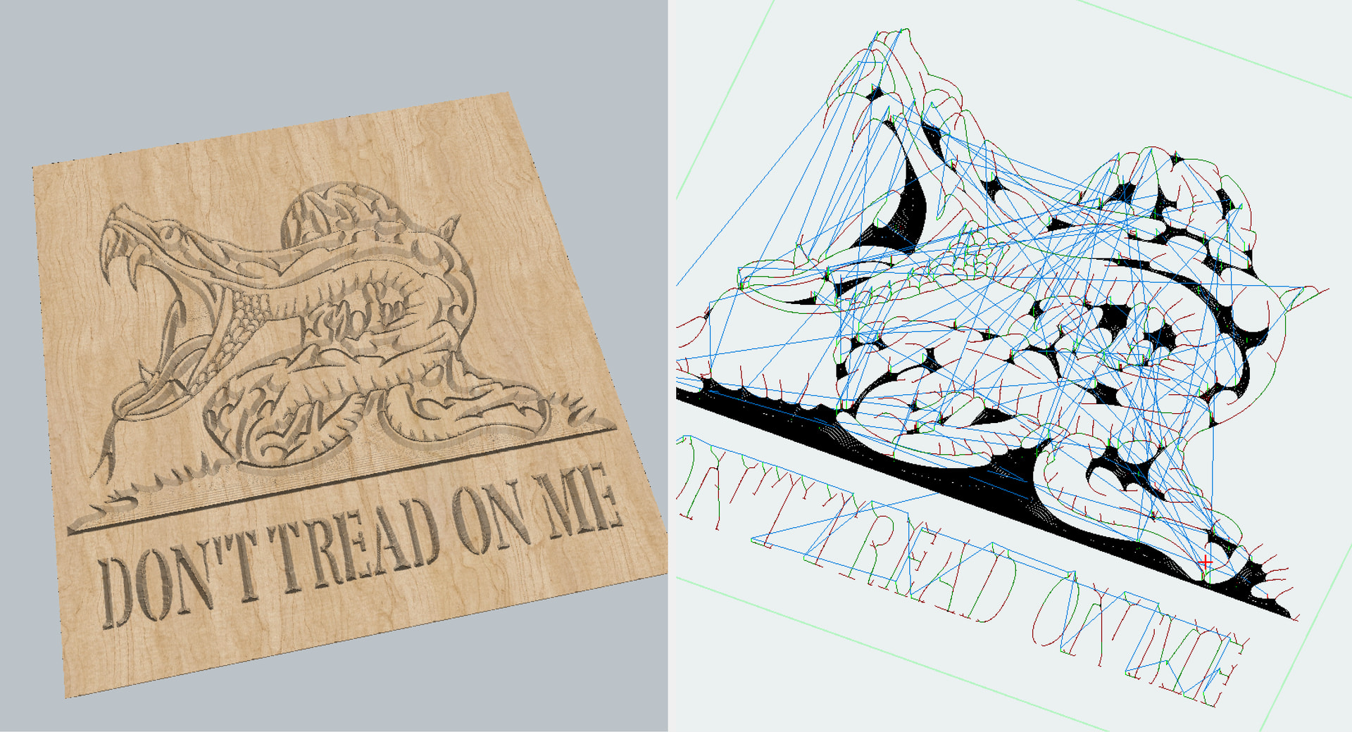

I know a couple of you here are in the MillMage beta group, but if there are others who aren’t and are keen to, we’re looking to add to the testing group.
V-carving already supports:
Normal V-bits (duh)
Flat-tip V-bits (Tapered End Mill)
Ball-end V-bits (Tapered Ball Mill)
You can also specify a last-pass stepover different than the clearing pass stepover
It doesn’t yet support a separate clearing bit, but I’m working on that soon.
The latest beta also has:
Offset pockets with support for stepovers > 50%
Pockets generated with our internal offset code
Centerline trace
Our new pro nesting solution (doesn’t support nesting into an arbitrary shape, but does do proper true nesting otherwise)
If you want access, create a user account on our LightBurn forum (if you haven’t already) and reply here with your username on the forum. I’ll get you set up.
