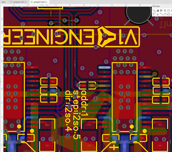

I want to play around with the stallguard feature of the TMC2209 drivers but I need clarification about the physical setup. On JP1, it looks like I need to run a jumper from the DIAG pin on the 2209 to one of the GPIOs on the limit switch input rail. Can somebody confirm this? And, if that is true, how is this handled on the JP3?

Stallguard is finicky. You can do it on a JP1 but I don’t think you can on a JP3.

Thanks Ryan. Does the JP3 hardwire the DIAGs to GPIOs?

I’m pretty sure they were made accessible in an early JP3 design but deemed not useful (including from my input) so it was removed.

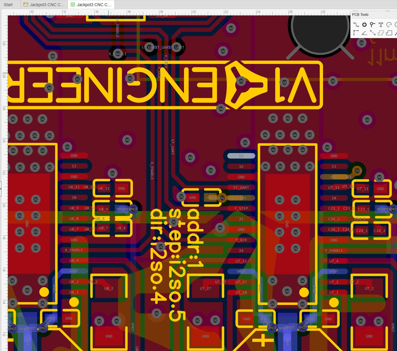

I really just want to use it for protection, especially during homing, but during running as well. Is there a schematic of the JP3 somewhere? I could swear I looked at one for the JP1 at one time, but I can’t find that either.
Jackpot3 CNC Controller - V1 Engineering Documentation , source files for the JP3. Similar link for the 1.
pin 15, is not used, but I suppose you could solder to it.

Yep, it would be a white wire modification to try and use it on JP3 just as it was a jumper wire on JP1
