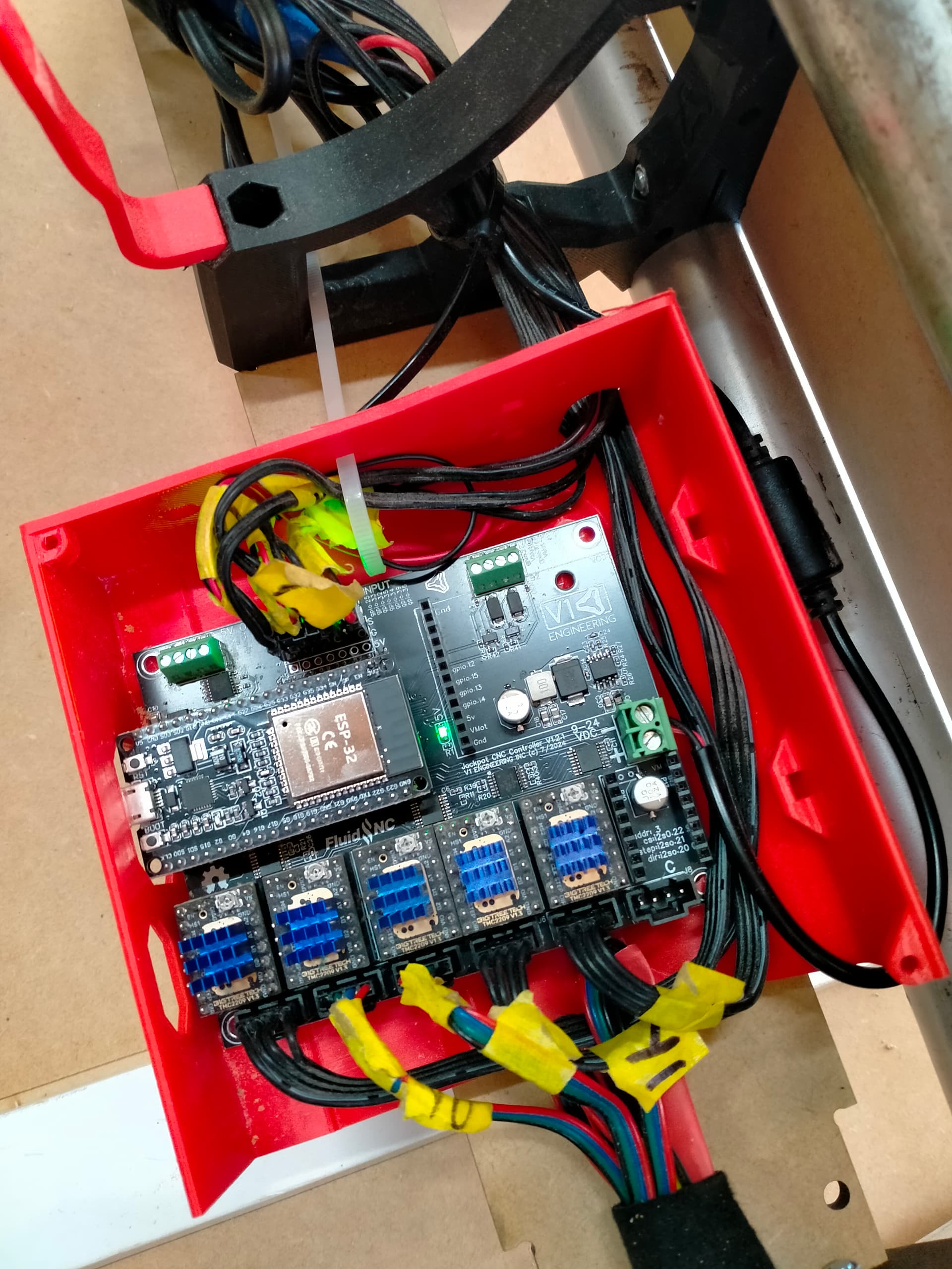

new board arrived a week ago , been connecting sweet till today now just wont connect to laptop, still connects to a phone or tablet
want to control it from laptop not tablet .cant use sta as router is to far away, phone cant even get signal, laptop has cable direct from router
has anyone used bluetooth with esp32 instead of wifi and had better connection
I haven’t seen anyone in the V1 community try/use the bluetooth variant of FluidNC.
Do you want to try troubleshooting the laptop?
Have you tried forgetting the WiFi connection on your laptop and reconnecting?
What OS do you run on the Laptop? Do you have a picture of your installed Jackpot board?
im picking laptop issue
windows 10
yip tried forgetting the WiFi connection on your laptop and reconnecting?
changed laptop wifi configs, to 2.4 only aggressiveness high , fluid nc will show sometimes but just wont connect to laptop says cant connect to this device
tablets way older than laptop but connects sweet as
i went and brought a tp link archer tx20u plus external Wi-Fi adapter turned of laptop internal Wi-Fi , it found fluid nc and connected straight away, fingers crossed problem sloved
