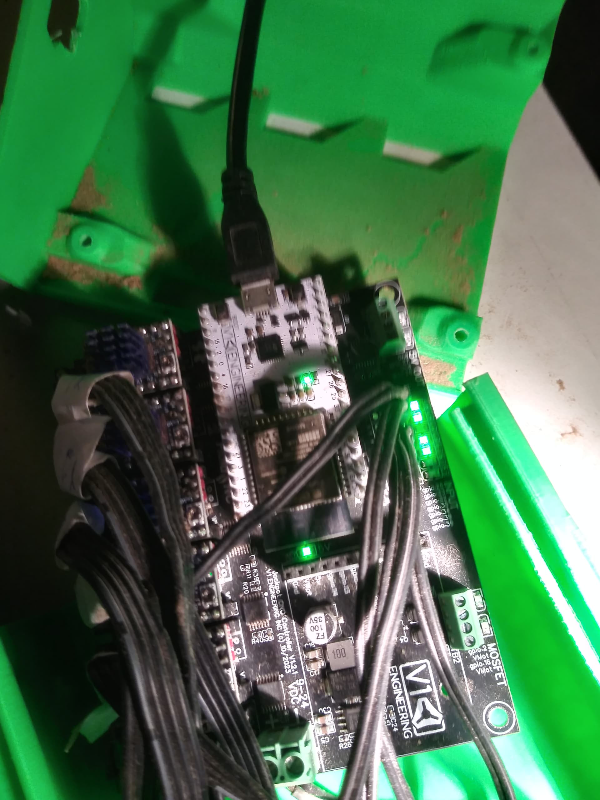

Hi, I having a lot of problems connecting to the Jackpot board through USB-Micro connection through Octoprint. The connection times out a lot.
If the Jackpot boots up and is accessible over wifi at fluidnc.local and the WebUI loads does that mean a USB connection to a Raspberry Pi running Octoprint won’t work?
Or do both work at the same time?
Either way, getting the Jackpot to work over USB is really flaky. I reboot over and over again and it only sometimes works.
I did see the following error in the Octoprint terminal:
[MSG:ERR: sdmmc_card_init failed code 0x108]
I don’t have a microSD card in the Jackpot, could that be causing problems? Is there any way to disable the Jackpot in WebUI from trying to read a card?

Let’s start with this one, as it’s a good idea. You want to have the ESP32 powered only by the jackpot, not by the Pi. If the ESP32 is powered up when the Jackpot is off, then you will have init problems with the TMC2209s, and nothing will work right.

The jackpot isn’t flaky- at least the jackpot in general as a product.
I have one of my Jackpots on a JL1 laser, and use LightBurn to operate it over USB.
It works flawlessly- with the provision as noted above that you have to be sure that the ESP32 is powered up by the jackpot before connecting USB.
They just added a new feature that points out any warnings. I think just to add a bit more robustness you might as well just put a microSD in it to stop that notification even if you don’t use it.
Sometimes I boot it up and it does not show on my router’s connected devices screen.
Sometimes it shows up on the router’s screen but when I load the page fluidnc.local it freezes on a Connecting ESP3D Please Wait.
Sometimes it successfully loads the fluidnc.local web interface but the USB connection to a Raspberry Pi running Octoprint freezes at the sixth stage of the connection process.
And sometimes it everything loads and connects and works.
I must have gone down to the basement 10 times today rebooting the Jackpot to try to get it working. It is driving me insane which is not a difficult thing to do
What version of board is it? Some early models needed a resistor added to reliably boot, I think depending on the esp32 version. I think mine is rc1.2 and it needs the resistor, however with the current esp32 I’m using it doesn’t. Maybe a picture of your jackpot and wiring would help.
I don’t really know, just suggesting an idea.
This is covered above, but one consideration you need to deal with is that any time board power to the jackpot is disconnected, you will need to then physically disconnect the USB cable from the Octoprint server and then only reconnect it after board power is applied.
You can avoid this bit of hassle with a “Data only” USB cable.
If you do not accommodate this and the ESP is powered when the rest of the jackpot is not, you will not have a properly running FluidNC after that until you power down the ESP and do the startup the right way.

You do not need one. You have the newest and most robust.
Maker jim’s suggest seems the most likely. I am not sure why you are using a Pi plugged in as well but I have a feeling the boot timing of them both is off. ESP first then pi.
I highly suggest taking the pi and memory card out and seeing how it does. If there is still an issue update to 3.7.18.
