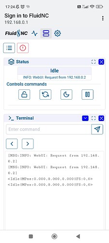

Upload Files button in FluidNC UI & scrolling upwards
The Upload Files button doesn’t seem to do anything when I press it on Android phone and tablet, and I am also unable to scroll the UI back upwards (by pulling down the screen - it will just refresh). At the moment to go back up to controls I’ve scrolled past I need to refresh the whole page.
This occurs on my phone, Redmi Note 10, and also on a tablet (both android).

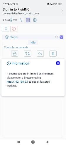

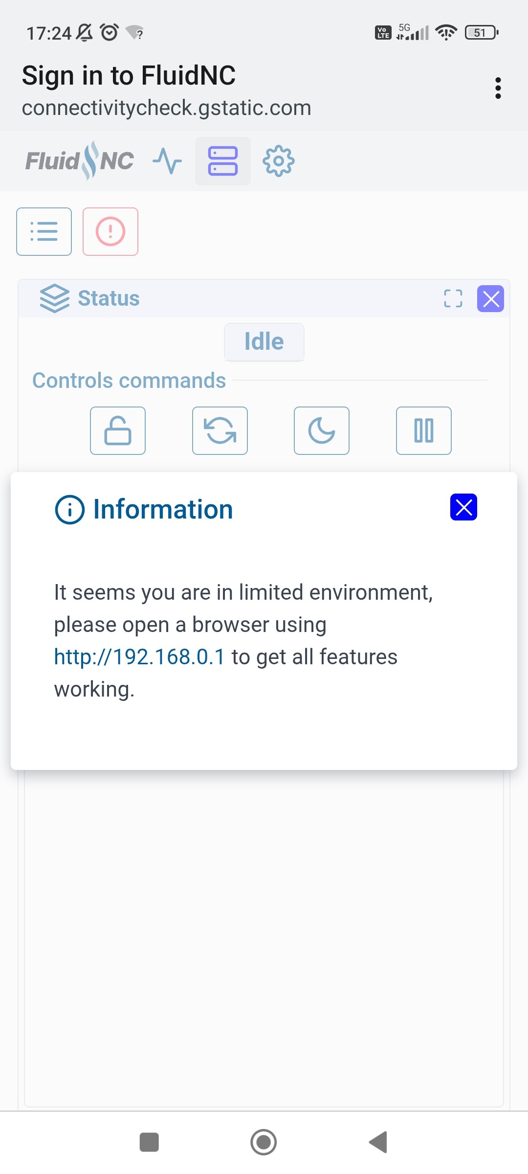

EDIT - Been troubleshooting - pretty sure it’s all because I’m just in the captive browser - can’t get it to open in the normal browser, more details below.
Additional info as I saw someone mention they had better luck putting the link in a browser.
Initially, when I choose the WiFi FluidNC, I get an authorization needed notification, click it and:
If I click that link, it basically just loads the same thing without the information box.

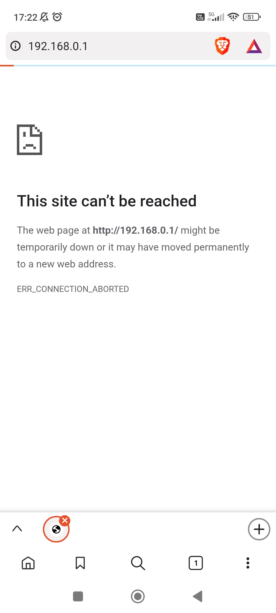

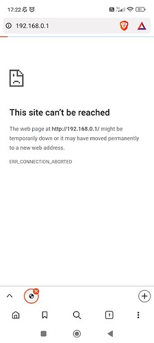

If I try manually putting the link in a browser
I saw in the terminal ‘request from 192.168.0.2’ so I tried that too just in case but same deal
I think I may be limited by not being able to access the actual UI through a browser.

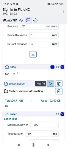

I put gcode on the card and it appeared in FluidNC, tried to click play and same thing - nothing happened.
I can jog, but uploading files or playing gcode doesn’t seem to work. I suspect the message about being limited unless in a browser tells me why, just need to figure out why it won’t load in the browser.

It’s definitely a captive portal problem. You should be able to open it in a browser. Not sure what’s going on there.
What browser is that? Does it behave any differently in Chrome?
It’s Brave and Chrome browsers
Some browsers will then need to be pointed to http://192.168.0.1, best to bookmark that address. If you get a drop down message about no internet just hit “use this network anyway”.
If you just use the page that pops up you should see a warning telling you to go to that address. This is a bummer of a step but for now in AP mode it has to be this way.

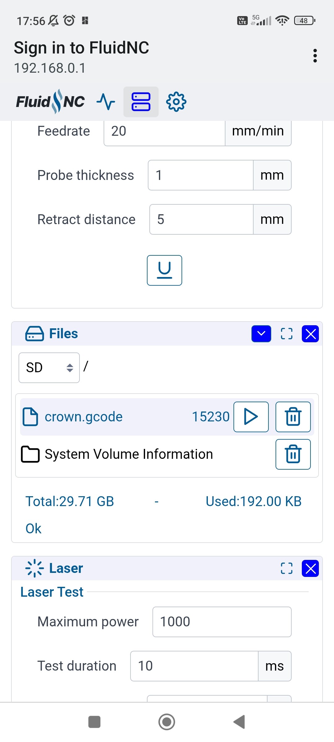

So on an android the steps are, connect to the fluidnc wifi, when that page opens hit the three little dots in the top right corner, “use this network as is”, then go to http://192.168.0.1.
This has two less steps on a computer since you can directly click the popup warning.
If you have a strong home wifi network signal in your shop you can use STA mode and all that goes away, direction in the docs.

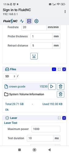

That worked, thank you!
It was clicking the three dots and choosing ‘use network as is’
