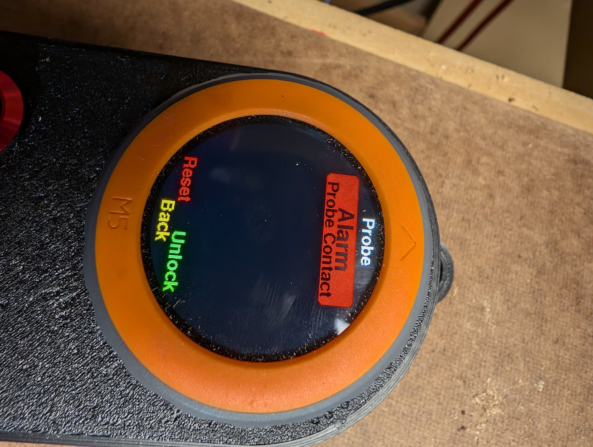

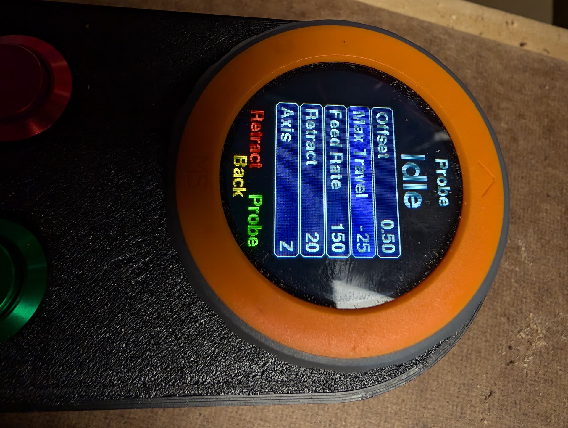

I ran the Probe directly from the WebUI, set the max travel to 10, and let it error. My steppers still disabled and it dropped.
I’m not real sure about the G91, but the drop at least seems reproducible. (I only did it once though…)
I’ll ask the FluidNC guys if it is expected behavior or not.

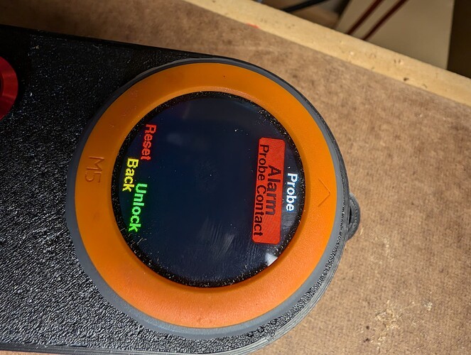

Interesting. I think I might have done that before and chalked it up to prerelease version.
I just ran out and tested the pendant probing. It works as expected with no motors disabling/ dropping on Alarm. I did notice I can hit retract multiple times until it runs into the Z hard limit switch though, so I won’t do that again.

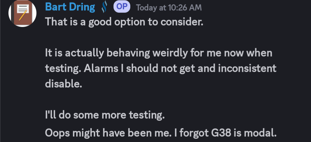

I only ran it once, but mine fell when the G38.2 triggered an alarm.
FYI, I asked on Discord last night about the motors being disabled on alarm, and the following conversation was the result
So it looks like the drop may be going away in a future release
Very cool! Thanks for working on this! I take it we’re not just being crazy!

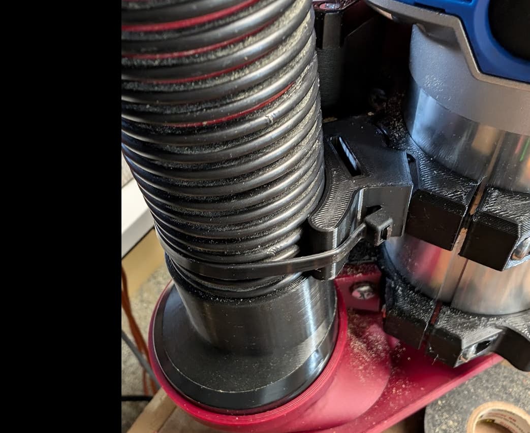

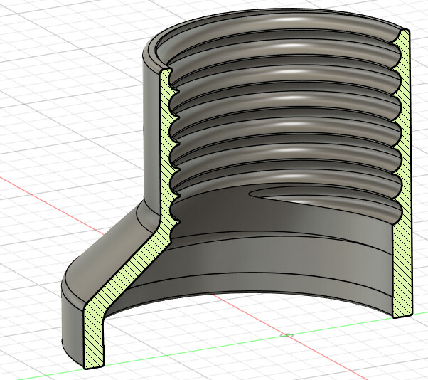

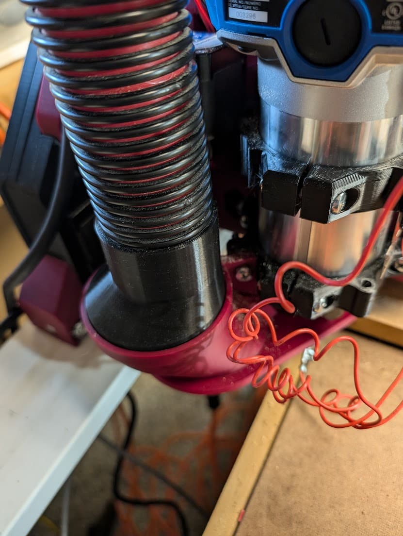

Testing a shop vac hose adaptor, offset so it’s close to the zip tie anchor. Will post it if it works, then on to cutting new strut plates with great enthusiasm!
(edit: I realized this morning that it would make more sense if the adaptor part went on the OUTSIDE of the hose, to get a few more mm of hose diameter, so will do that instead)
This should work slightly better, will pseudo-scientifically test tonight.
(edit: threads were backwards!)
Curious what setting the Z stub distance instructions will entail; will just leave it disconnected for now.

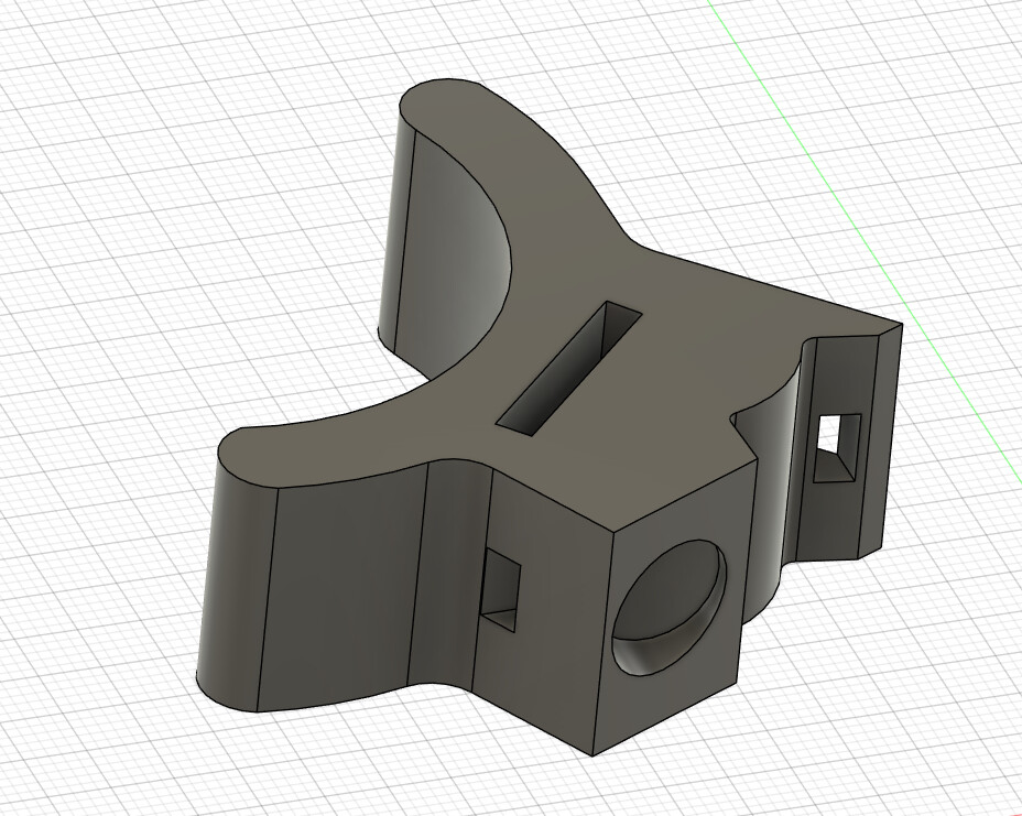

Nice fit, but might have to make a weird spacer thing for the gap between the hose and the router mount, hmm…

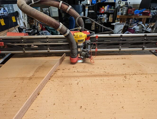

That is a rigid hose jut attach it to the core and you will be fine. The soft hoses sometimes need the mid mount.
Ah, will experiment with it. If I can get it to bend correctly then that sounds perfect. I think I had quite a big loop for my LR3 until it was happy (also pictured: yardstick of dust collection)
I will likely just use a floppy 2.5" hose eventually, but figured I’d just make some crazy stuff for fun.

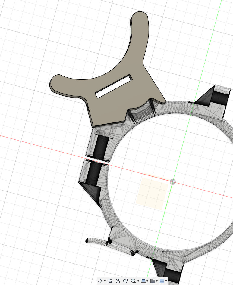

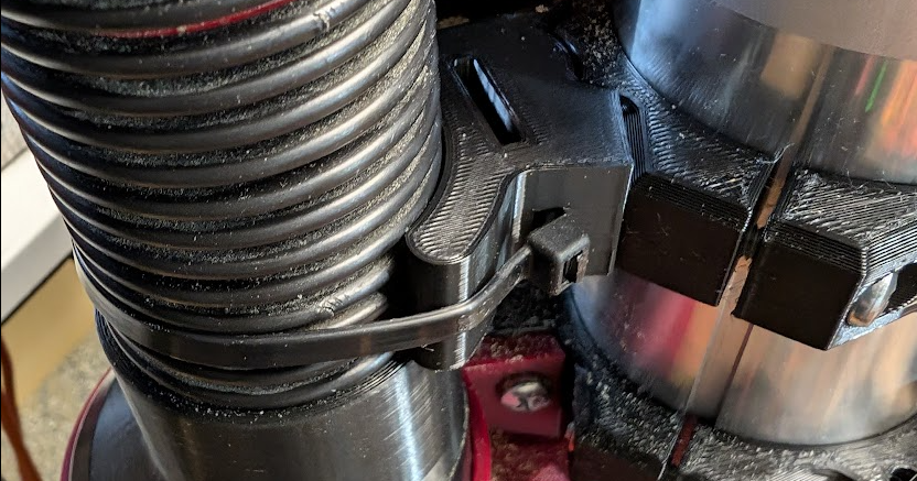

Weirdo Spacer Dongle 1.0 printing away…
Dongle thingy hooked up to the snuffletrunk. Now to secure the hose and the wires things to the handy Core zip tie holes, in a way that allows smooth X travel…
(the slot is a place to shove my disc magnet, which I use with the alligator clip end o’ the probe)

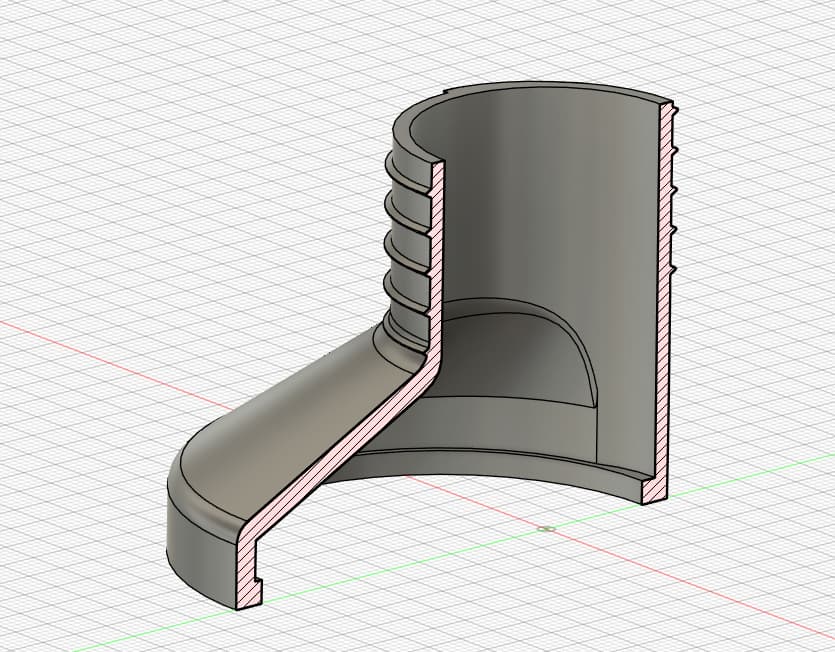

I’ll post the stl’s of my vac hose and spacer, if anyone wants them (before the official vac hose adapter is released.) If it’s not clear, this is SPECIFICALLY for the older 1.5" LR3 hose that Ryan linked: Amazon.com (I have a longer one I got at the hardware store)
Link to my (Unofficial!) hosery:

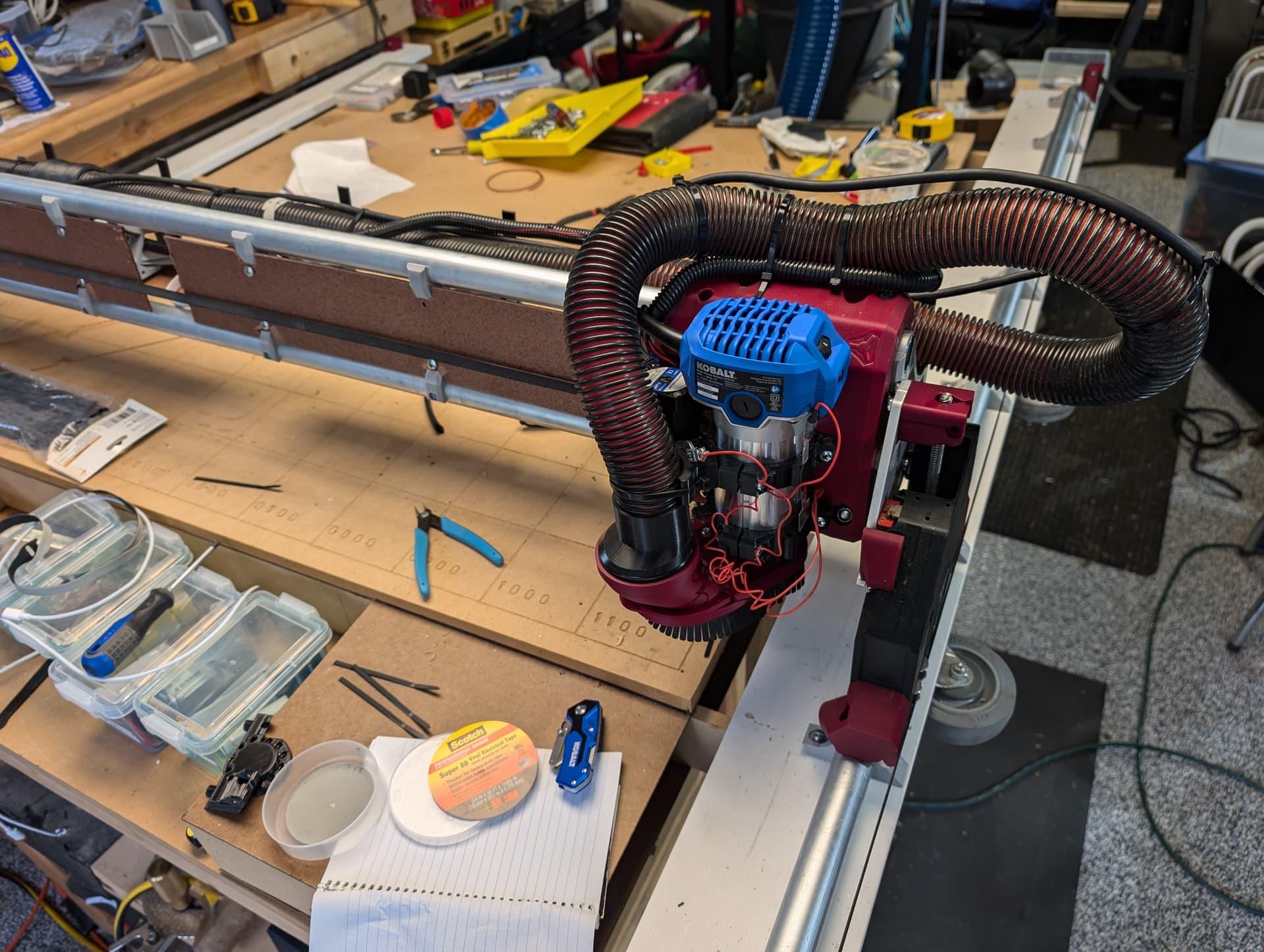

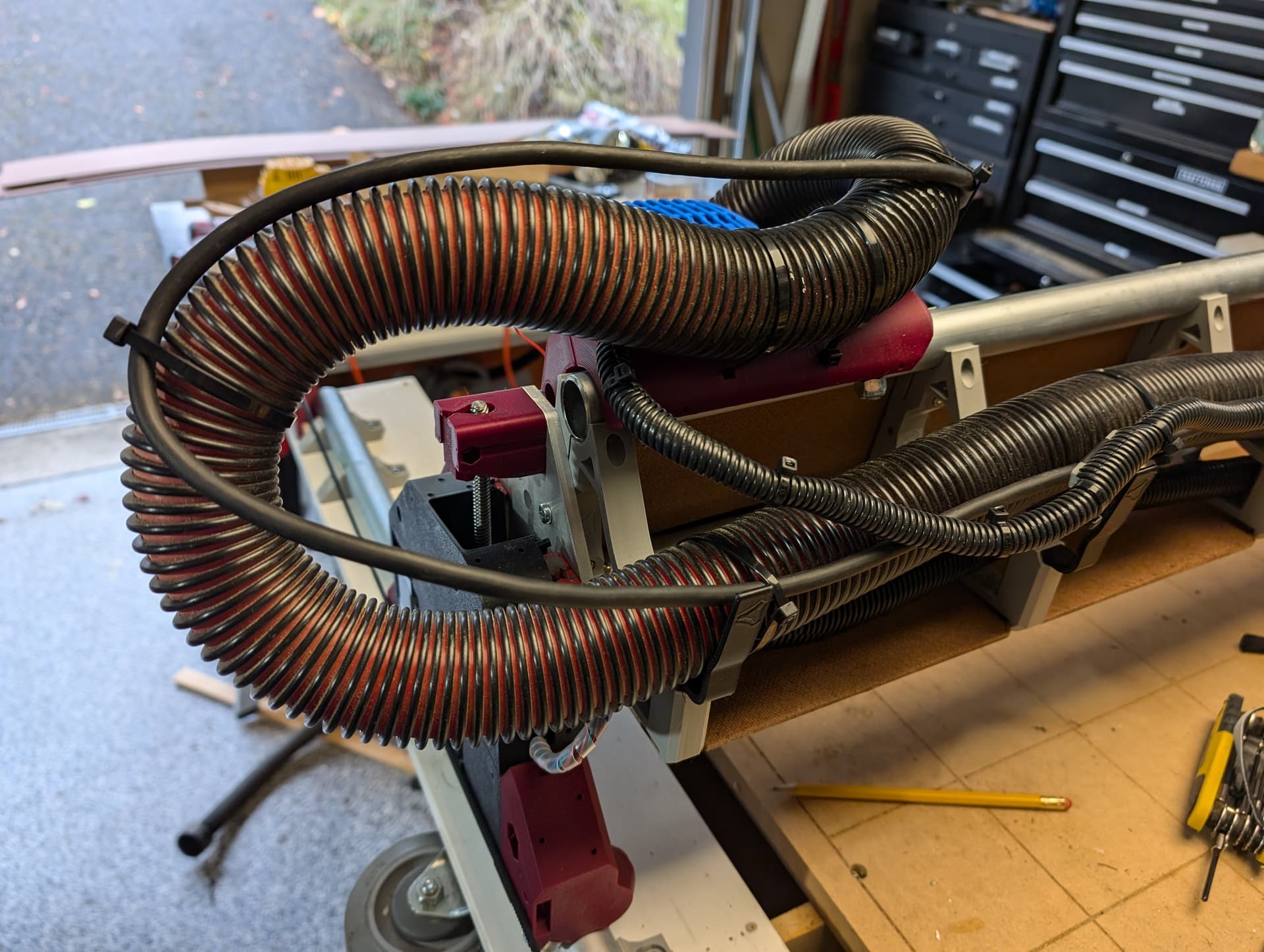

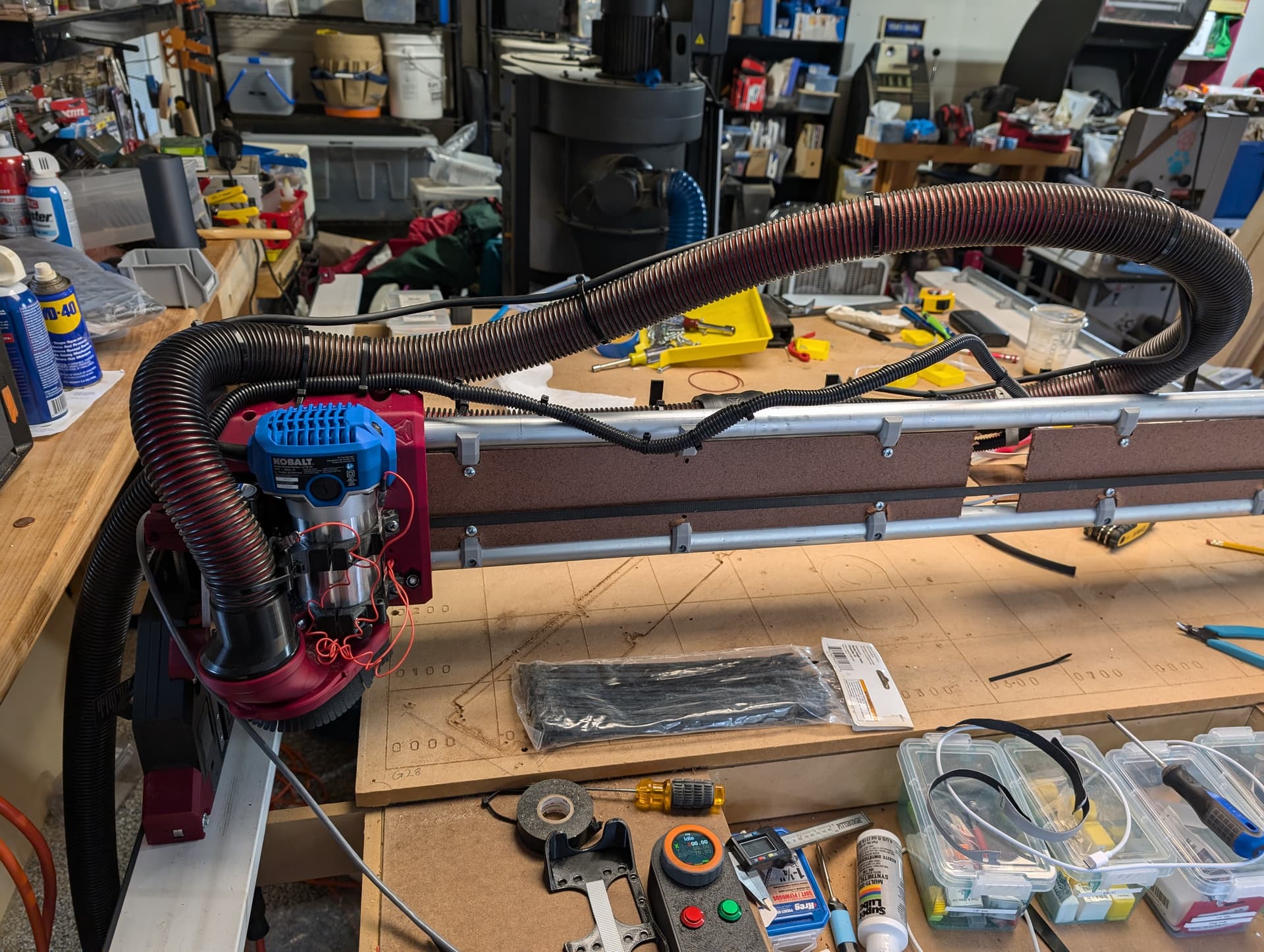

OK, after jogging back and forth a few million times, I think I have the cords and hose configured in a way that minimizes drag, avoids snagging, wires remain slack, and is compact. The key was making sure I had enough hose at full X extension.
Hopefully static isn’t an issue, I didn’t run a wire as mentioned in the docs, but I didn’t have a problem with problem with the lr3, so will keep a close eye on it.
Now to clean up my build mess, final squaring, and hopefully dust will fly this weekend!
In the instructions I mention not plugging in the Z axis and doing this unpowered.The trick is getting the right twist in the hose after the right amount of hose.
If you did not ground your vac hose it will 100% be a problem. Ranging from random reboots to frying your control board.
Roger, will ground the hose.
I think it worked pretty well with jogging X, I think I spent most time just making sure the wires didn’t get snagged or tight (would have been easy if they were all the same length as the hose) but good to know about the suggested Unpowered workflow, I kinda skipped ahead when I didn’t have a hose solution at the time (2.5" I got was too short, didn’t have a 1.5" adapter.) With the rigid hose it was pretty “obvious” when I had the right twist.
