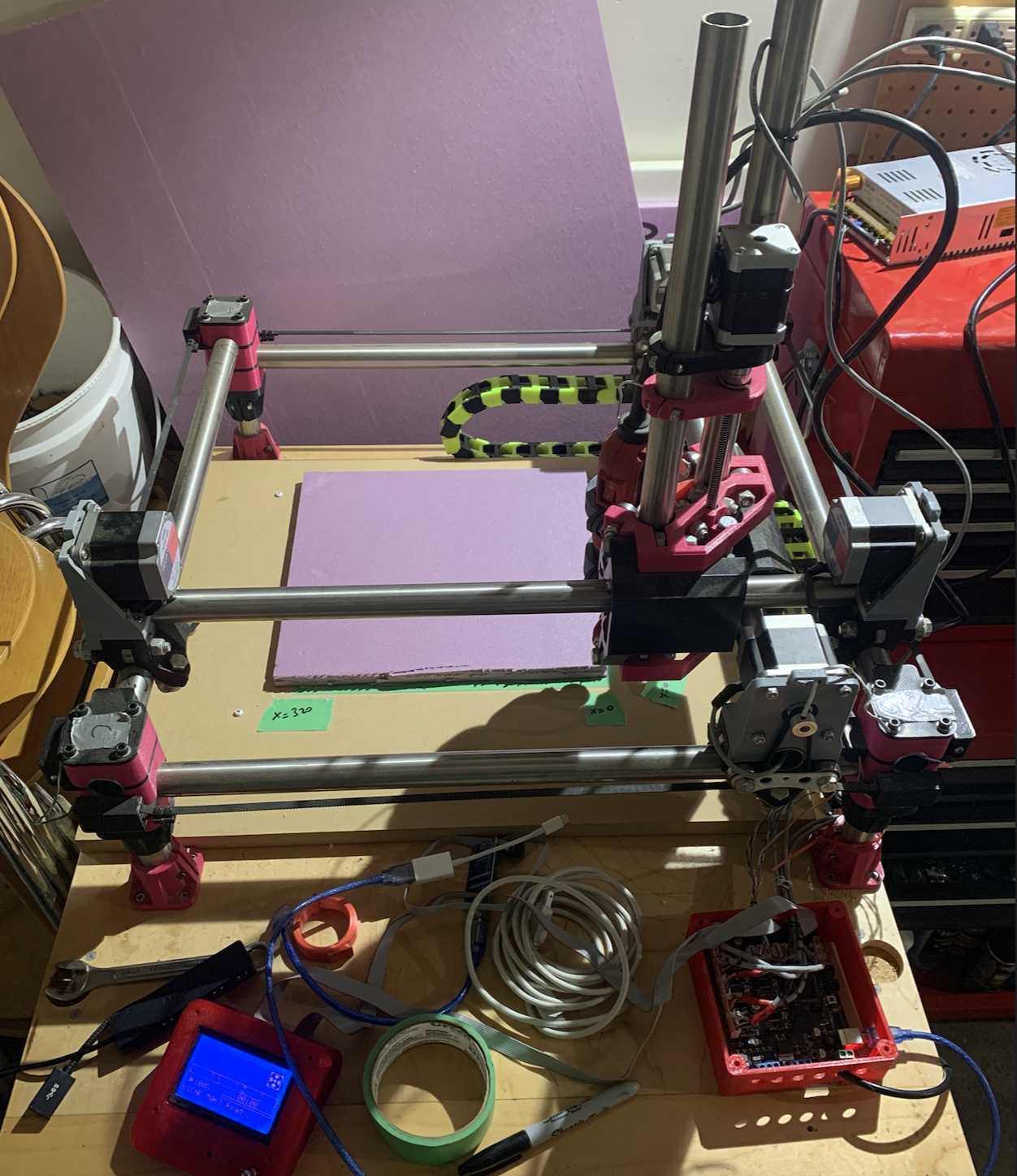

I’m kind of curious about this machine now. Care to share some pics?
Yeah, there are some interesting choices going on here. Here are some pics!

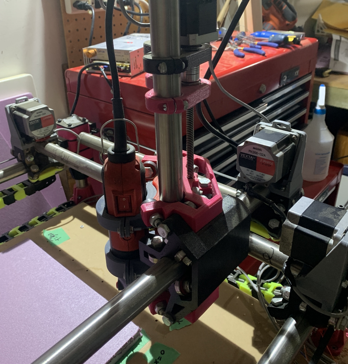

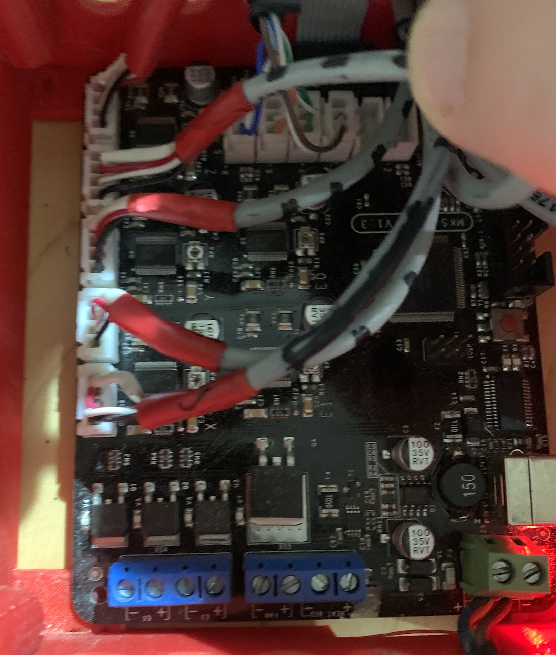

Of note: there are five stepper motors, which I assume is normal. But it means that they’re wired to X, Y, Z, and E1 and E2 on the board. So somehow the firmware knows that E1 is X and E2 is Y?
(0,0) is in the top right (any other choice of origin ends up with negative coordinates). which means I have the whole setup in the wrong orientation, and I should flip the board around, but then I’d have no space to store the controller, etc.
The end stops however are at the bottom of the picture and the right of the picture, so not at (0,0). I haven’t yet figured out how to get the firmware to use those so it’s not a problem yet. =)
It currently has a cheap dremel-style spindle, but I have a Dewalt 660 that I will print a holder for once I get all of the workflow working.

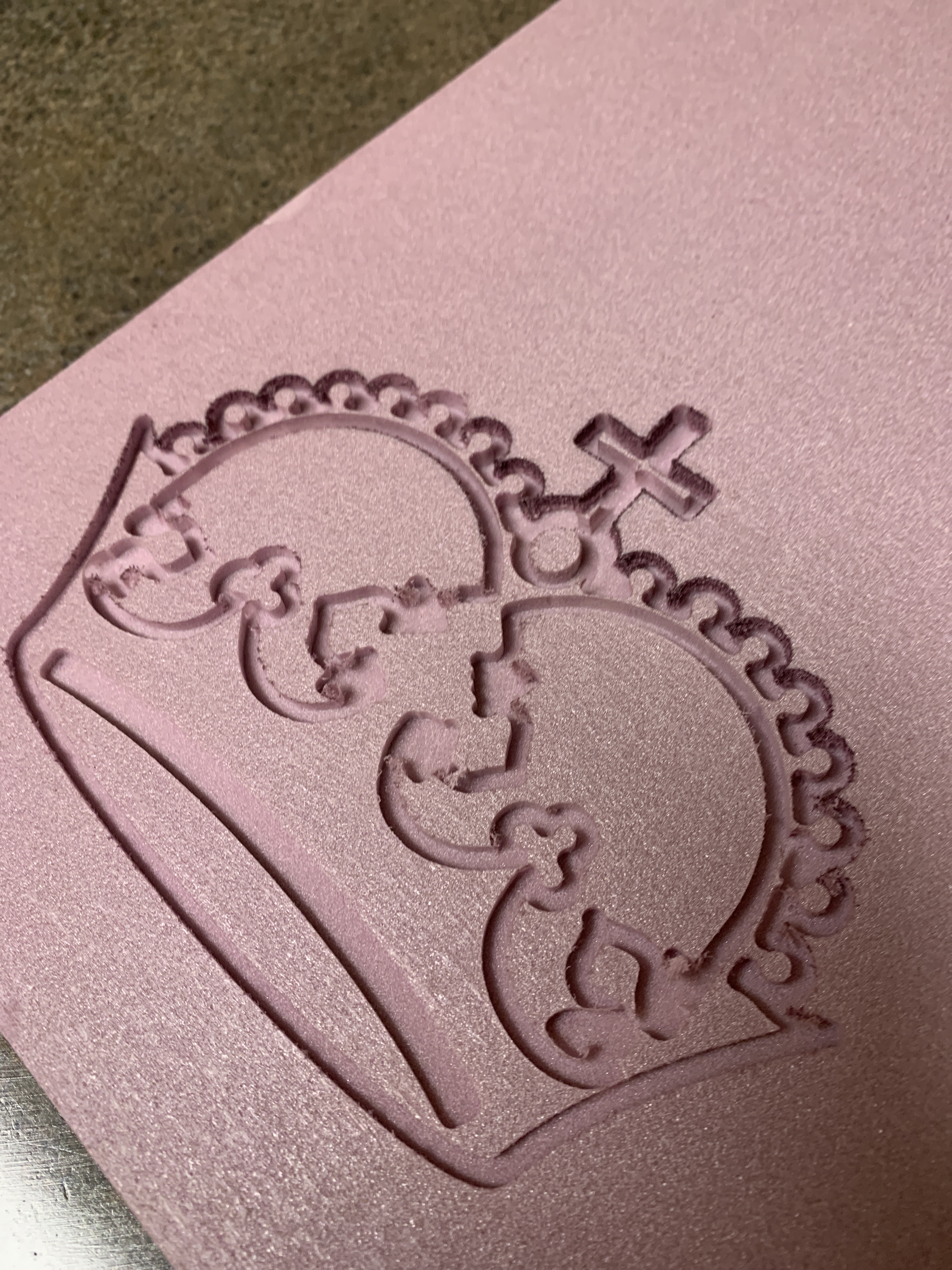

I’ve adjusted the stepper size to 78.1 and it’s roughly right.
Some success!
Yes. This is the dual driver and dual endstop configuration. You can find these settings in configuration_adv.h. The firmware I shared with you does the same thing.
You can reverse the plugs and it will switch directions (4321). It looks like you have keyed connectors though. You can also swap the first two wires and it will also reverse direction (2134). There is also a setting in the firmware to reverse the direction. It is somewhere in configuration.h.
Weird. I thought that is the wrong way. 80 might be 1/16th microstepping and 20T pulleys. A4498 drivers can only step at 1/16th, do that makes sense. Nema 23s, but then 20T pulleys is a bit odd. But it should work. Most people use nema 17s for all 5 motors and 16T pulleys.
