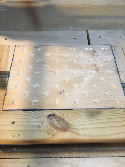

So I thought I was doing pretty good seeing that I had about 10 or so successful projects done on my MPCNC. This was until I tried to cut out a US Flag union for buddy which has be basically perfect.

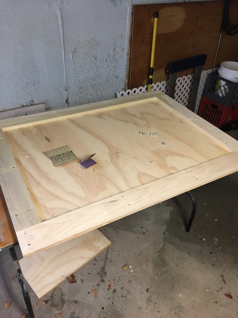

Here is my spoil board pocket area thats meant to be changeable once its cut up. I used particle board as my spoil board.
I used a 90 degree vbit with a 1/2 cutting dia. The wood was 10.5 x 14.75" and my MPCNC cutting area is 23 X 35".
Heres my first attempt…I didnt realize at the time but the wood was slightly cupped and actually had a small rock to it. Another rookie move was the wood was not fixtured perfectly straight.
You can see in the upper section the stars are much fatter than they should be. Also the lower row of star (which look right sizewise) are crooked.

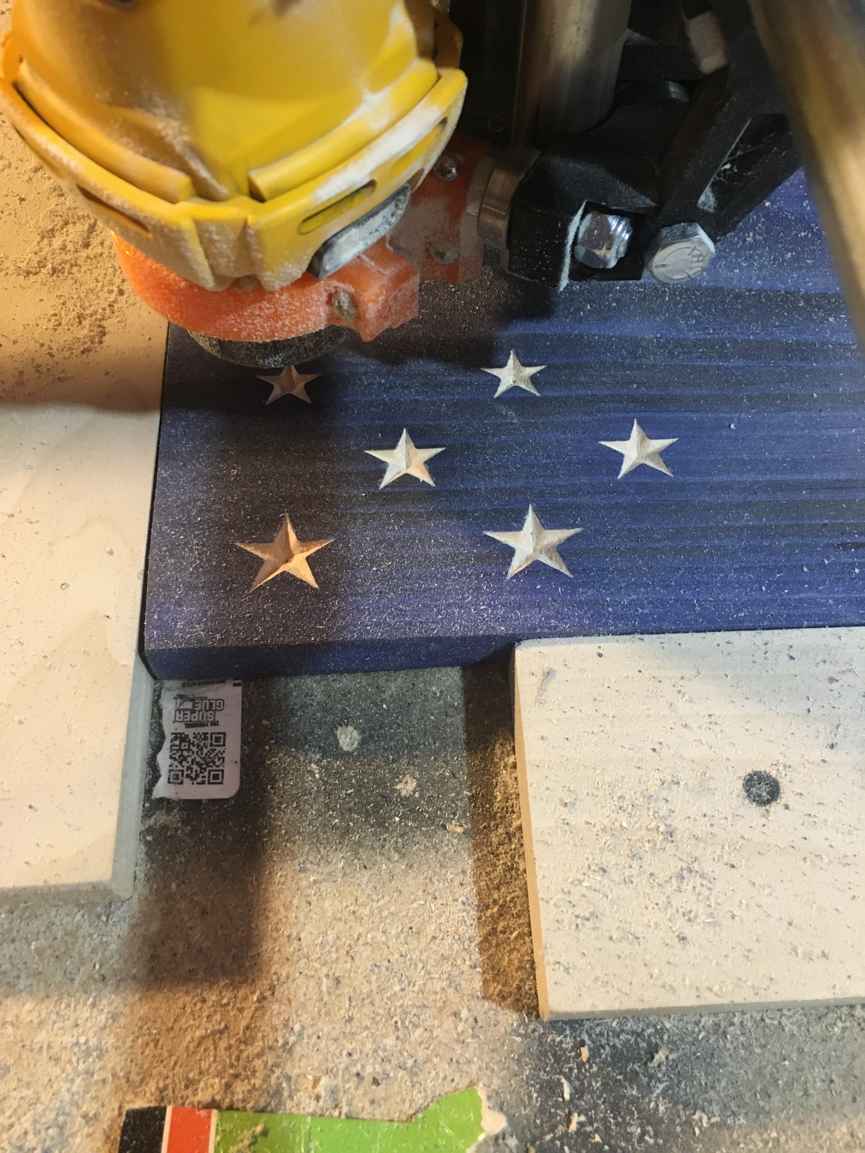

I flip over the piece since its scrap now to test and shim out the wood so its not rocking anymore and also get the wood lined up straighter using the X axis and the bit riding near the edge. I decided to touch of Z in the middle vs the corner thinking maybe it will help look less obvious if there is some warpage.
You can see it looks better but the stars are still not all the same.
So now I start checking my corner piece heights and they are not exactly all the same height I cant recall the numbers but it was enough to raise concern. So id like to correct everything and get this beast as flat as possible. Let me know if these steps are correct?
  1. First measure and set all feet to exact same height
  2. Run a fly cut bit over the entire spoil board using a pocket program
  3. Check machine with dial indicator somehow mounting it
  4. Fly material if its really bad both sides
I most likely never noticed it being this far off because I haven’t ran anything with repeating patterns this big.
Carving is very strict on Z accuracy. There are some things you can do to make it less strict:
  • use a sharper bit. The error on a fat bit is going to be larger. Imagine cutting 1/8" too deep, a 90d bit will be 1/8" wider than it should be a 45d bit will be closer to 1/16"
  • break up the job, and set a new Z between parts. If you zero the Z for each star, you’ll get very good results. If you group them by 5 stars, or 10 stars, you can find a good balance. Just keep the machine alive between cuts. The only thing you’re changing is the Z height, so you can do G92 Z0 for each new file.
  • Surface the top of the workpiece first. It won’t be “flat” but it will be the same “Z height”. You could technically do it after as well.
The shape and curving of the stars has more to do with your speeds for that bit. A wide bit is hard to get right because the middle is moving so much slower than the edges. So take it slow. You can also do a finishing pass.
Also, your steps for surfacing the spoil board look good. Just remember that it is the top of the material that matters.

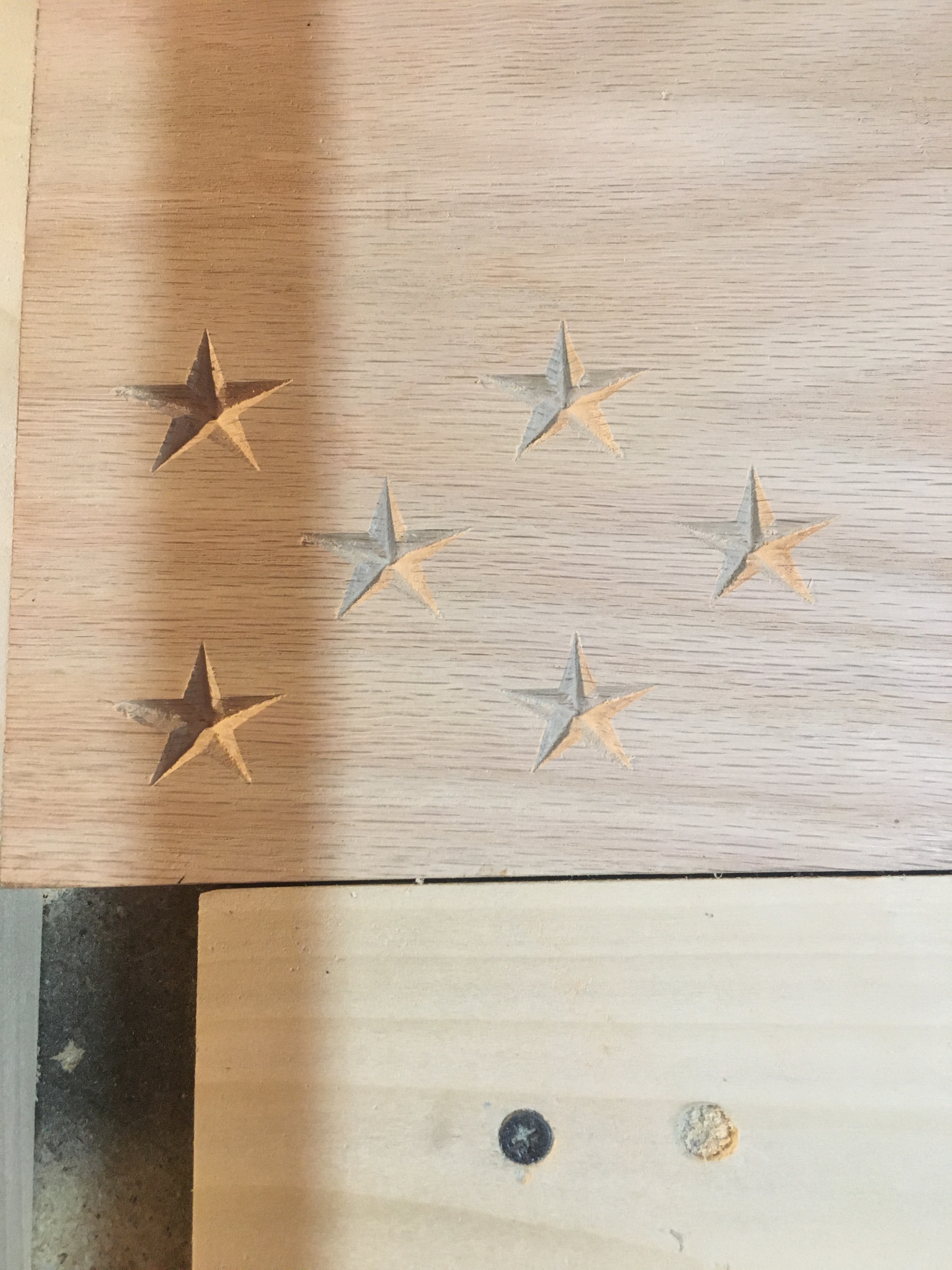

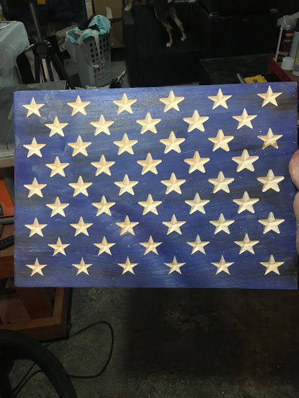

It finally registered as to what you’re saying. I broke that project up to 6 different toolpaths. I didn’t even make past the 1st set of 5 stars though due to height variations. Clearly there’s some problems with this material. This was supposed to be a paying job. But there’s no way I want to sit there and set the z depth for 50 stars lol. I told the guy plane the wood or get better wood.
But the jist of it would be move the head to a center location of the star grouping, manually move the head just over the top of the part hit G92 Z0 in repetier. Raise head slightly and manually move to start point of project hit G92 X0 Y0 in repetier. Drives me nuts that repetier doesn’t change its xyz to zero thank god for the LCD. Hit the program go rinse repeat with each grouping being careful with my G92s.
Unfortunately this wood was pretty bad. Just to make sure I wasn’t crazy I ran the same test and a piece of oak that was much better. Better being more consistent repeated stars.
