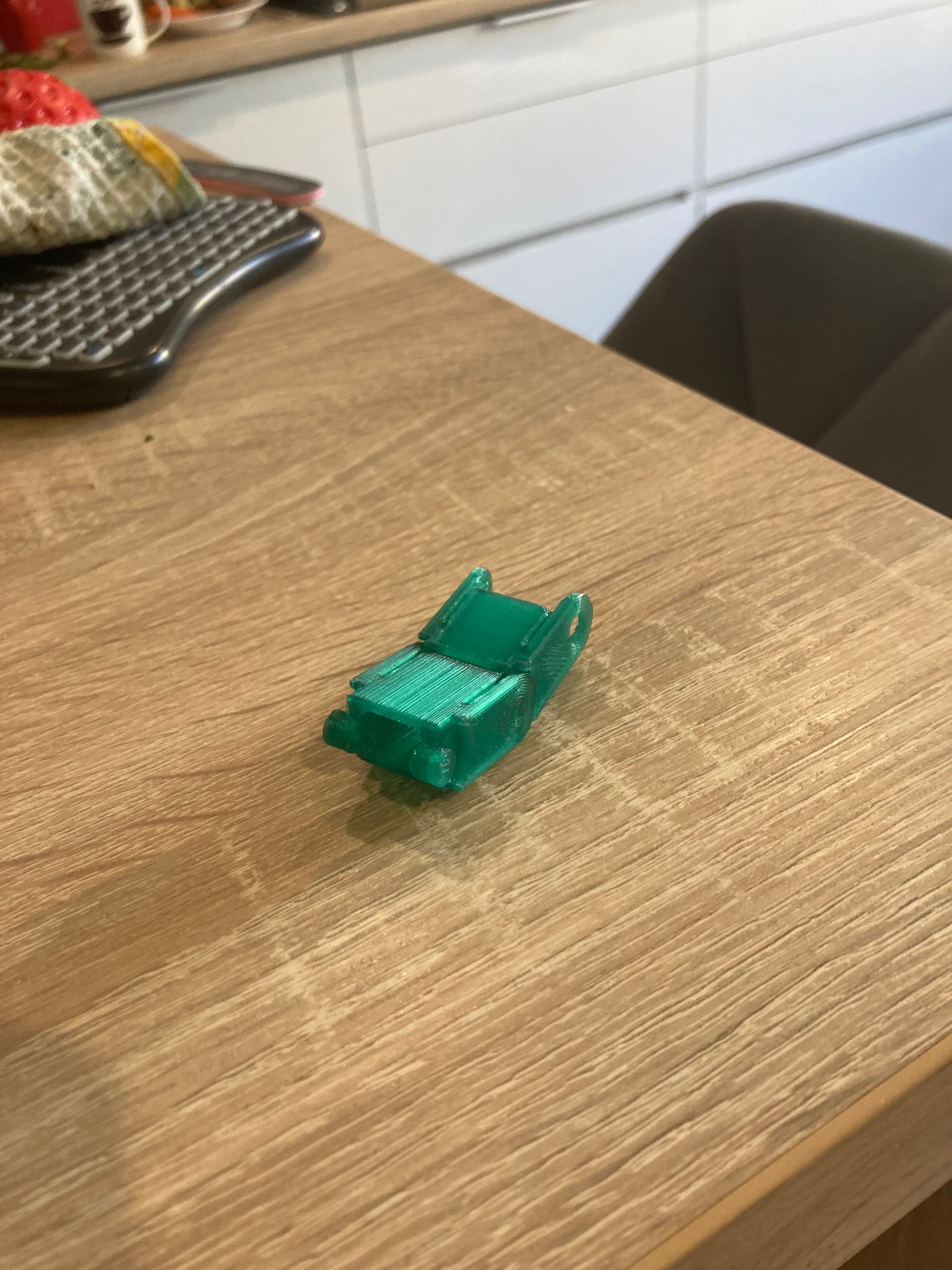

Due to disrupted transport logistics, there is a problem with the acquisition of materials and components. A temporary solution was to use furniture pipes with a diameter of 25mm.

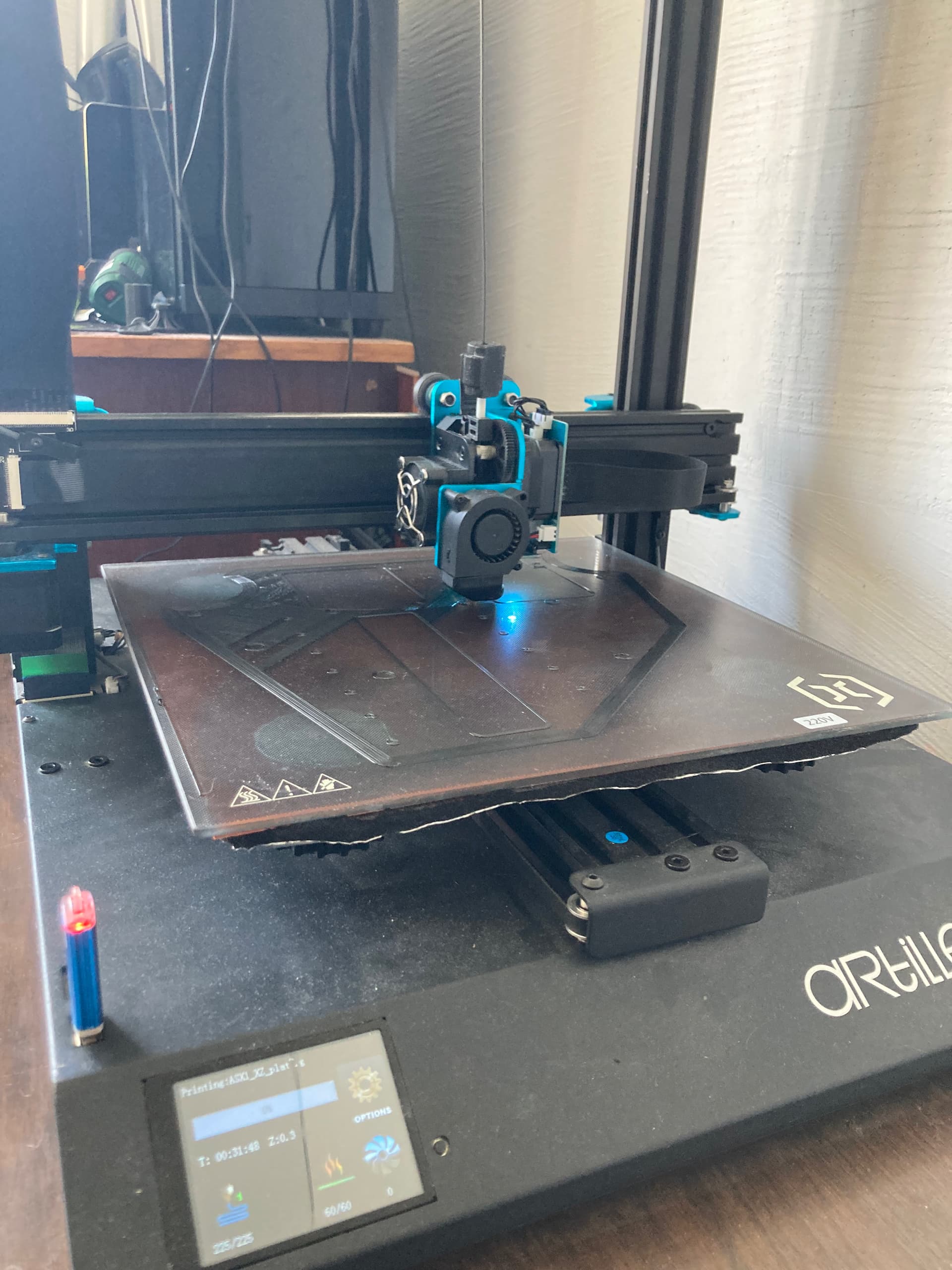

I accept your information. As a result, the X axis came out 1.5 meters. Brace - by the number of 6 pieces. the extreme parts with 60% filling, the rest 45% each. At first glance, it looks tough, without hesitation and sagging. LR Core without router moves without disturbing the structure. If at full it turns out that the design is broken, you can strengthen it by adding another Brace detail.

But let’s not talk about the bad. Following the advice Dan gave me, I printed three more Brace pieces at 45% infill. Distance between segments +- 170 mm. With the LR-core and router fully assembled, the total weight is 2.8 kg. Movement along the X axis without sagging and jamming. The axle came out very stiff, thanks for the tip Dan.
