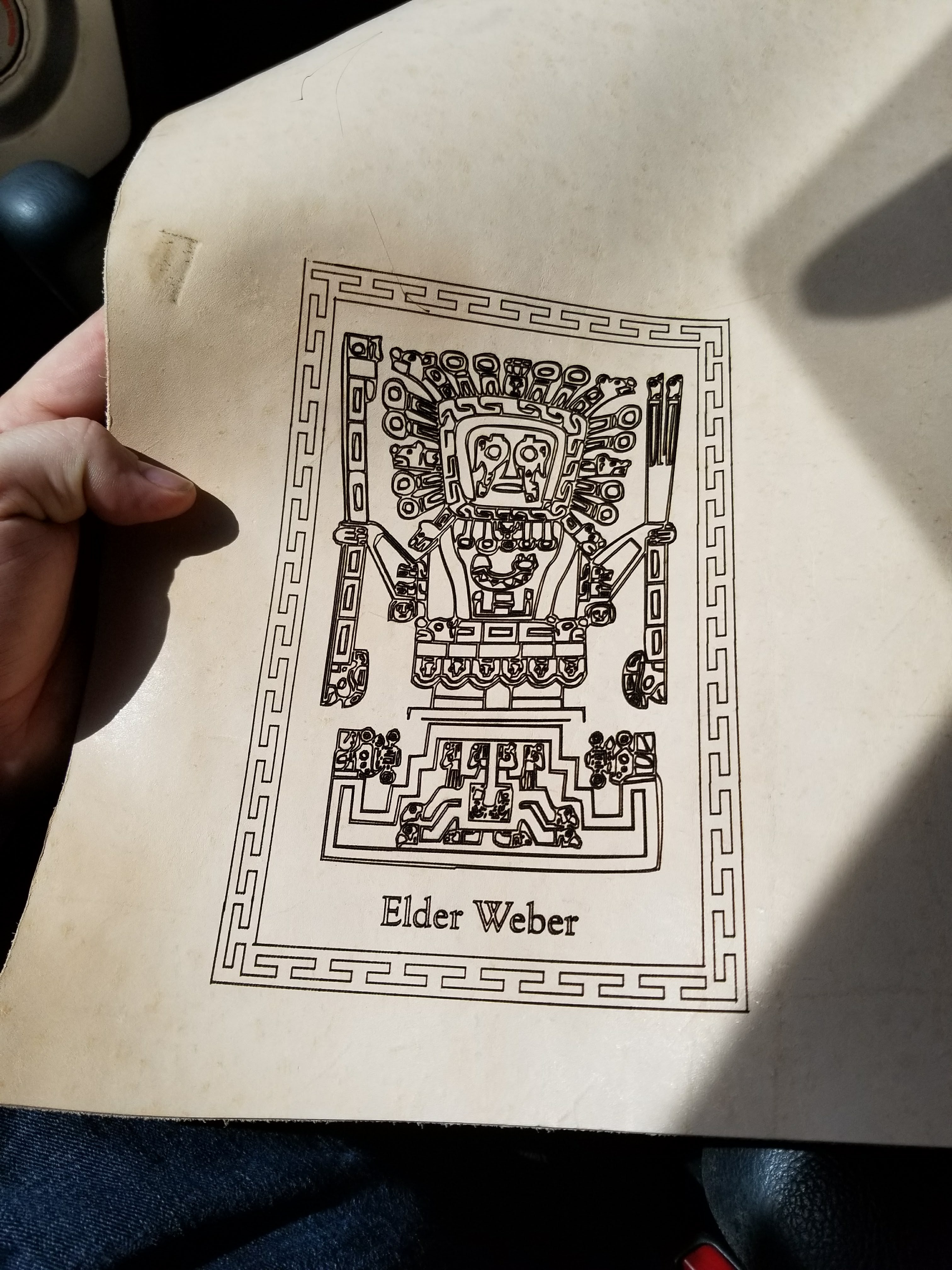

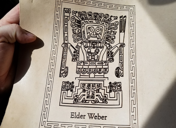

Here’s an laser etching I put in some leather… going to make a book case. Fun stuff.
