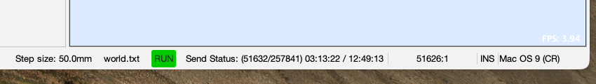

Could anyone please confirm my assumptions that in the following:
“51626:1” means the cut program has just completed line number 51626 after starting at line 1?

No, that means the cursor in the editor is at line/row 51626, column 1.
It doesn’t necessarily know what line is completed, it only knows what it has sent. You can see that it has sent 51632 lines out of 257841 lines total.
