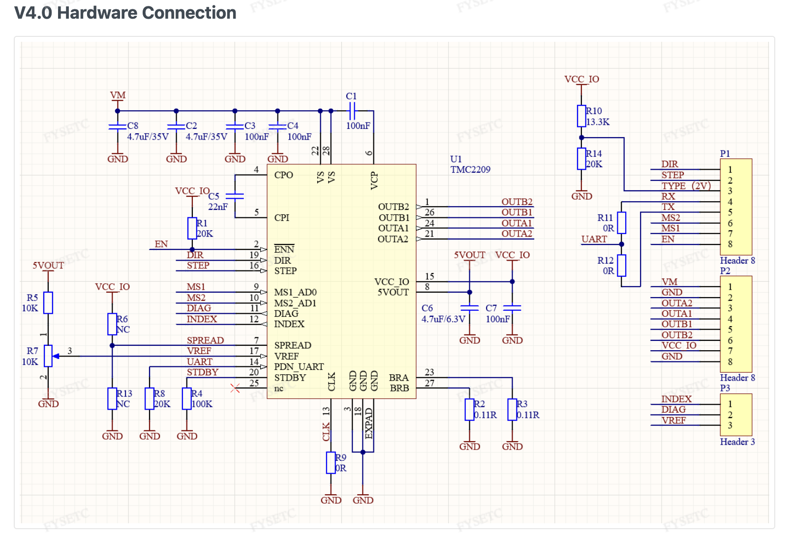

Admittedly I took a chance when I arrived at the junction about setting the Vref for the FYSETC S2209 V4.0 drivers I have. Whilst venturing down the rabbit hole of manually setting Vref I learnt that these drivers were UART compatible and that the jackpot board is set up to run drivers in UART mode.
This meant (or so I understand) that I did not need to manually set Vref and could manage the stepper current via the configuration file and FluidNC. However, I could not find details confirming that the Jackpot board had the correct circuitry to put my particular drivers into UART Mode it being noted somewhere along the line (but I could be totally mistaken) that not all TMC2209 drivers use the same external circuitry to get them into UART mode.

My drivers call for 0R (I think this means zero resistance) to be fitted on the TX and RX circuits to get them into UART mode. This may be standard for TMC2209 drivers but I am not sure.

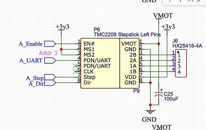

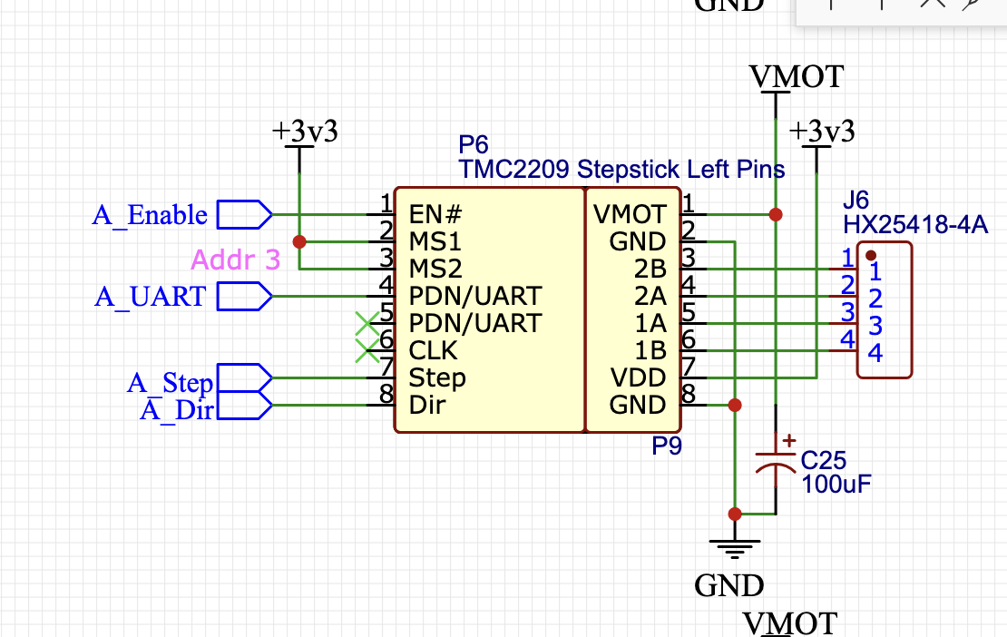

Your pinout looks compatible with the Jackpot or SKR Pro style pinout, which looks like this:
With one caveat- If your driver doesn’t have TX/RX multiplexed, it won’t work.
So let’s try and find out the detail about that zero ohm resistor.

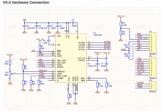

According to the fysetc documentation, V4.0 of those drivers should have R11 and R12 fitted with 0 ohm resistors, so the UART mux should work.
The one concern is that 20K pulldown on UART. It might pose problems for the three unique ID parts on the Jackpot. If it did, we’d have to remove that resistor on the three drivers in those slots- or replace those three locations with different TMC 2209s.
