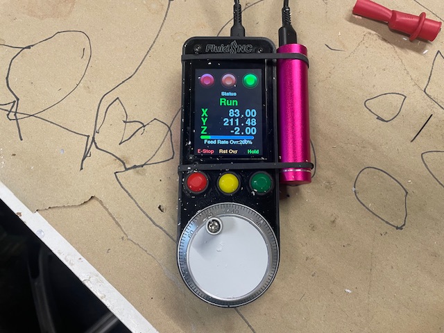

For now, I’m going ahead with building up my 2nd CYD pendant. I’ll build up one as wired, and one as a wireless prototype.

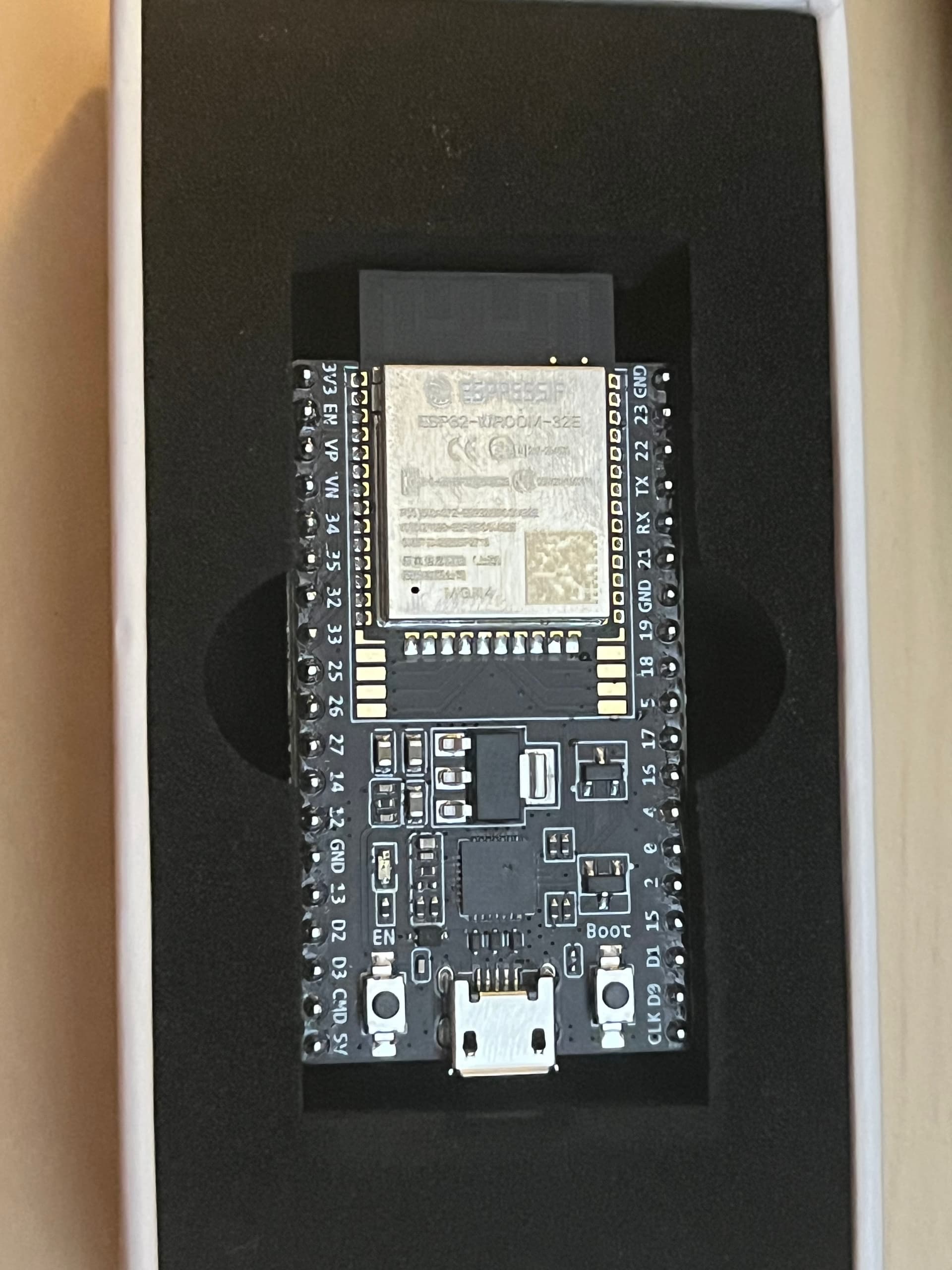

I grabbed a few more genuine Espressif ESP-32s. (or, at least they’re good fakes if not)
I’ve got the code up in the thread above building in PlatformIO , but need to figure out the MAC addresses of my two test boards, and I’m pretty much out of time for now.

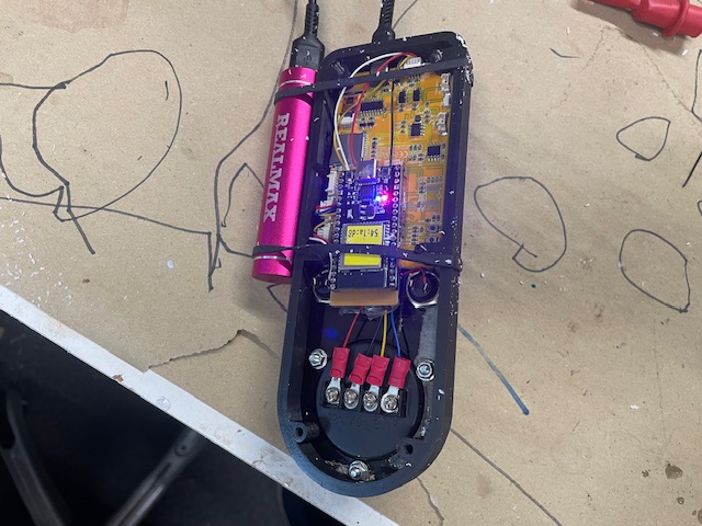

Here’s where I’m at:

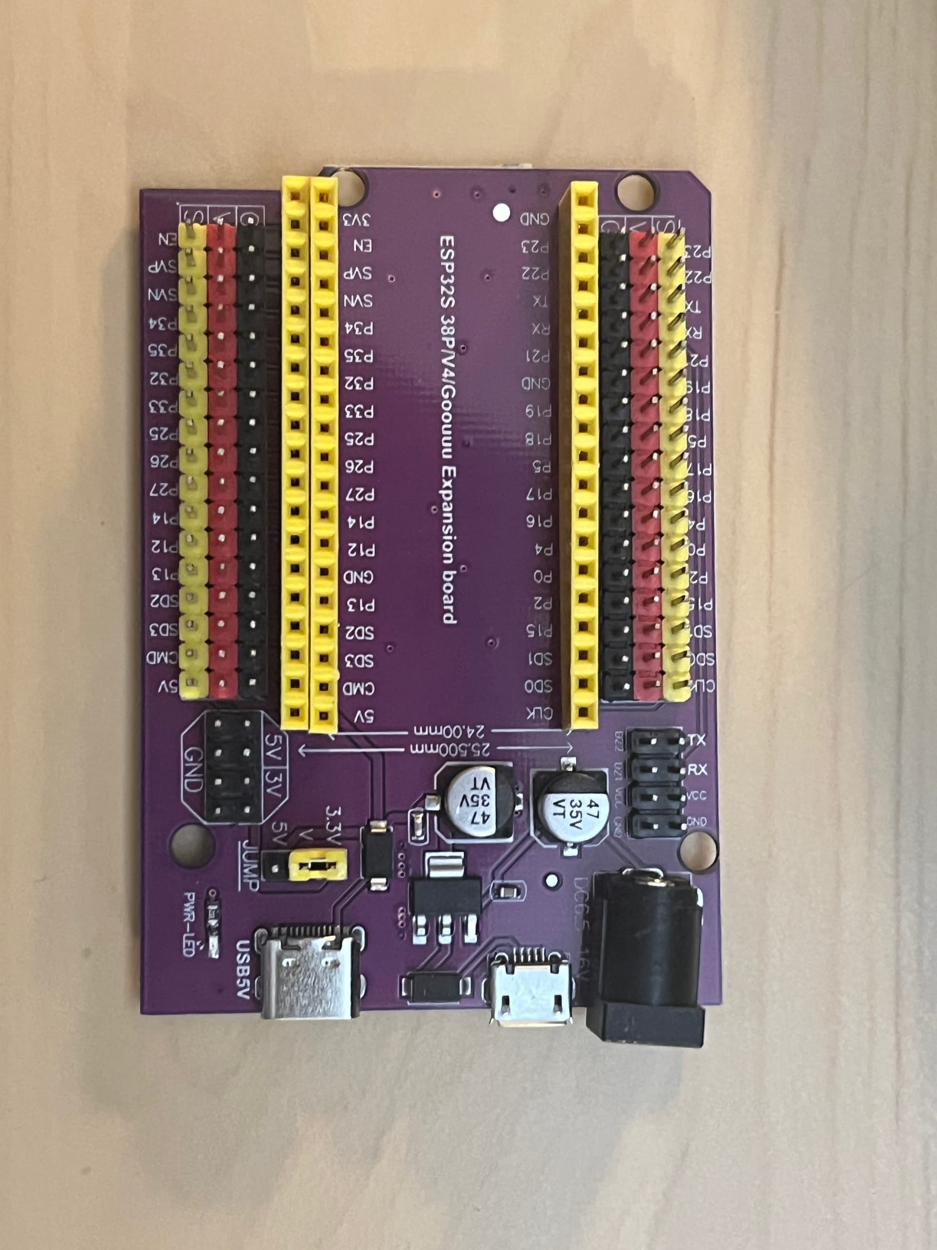

I got some definitely not genuine boards. For one thing the silk screen had a pin labelled GND that was in fact CMD on the pinout. That was a head scratcher for a while.

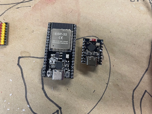

I had previously make a custom shell that is thinner than the original - A deeper back box is on the 3D printer and that’ll fit the esp32.
I’ve also been checking different baud rates - it does work down at 115200, no noticible lagging. What I have seen is if you turn the pendant on during a job it doesn’t connect - I wonder is that down to that lock UI setting.

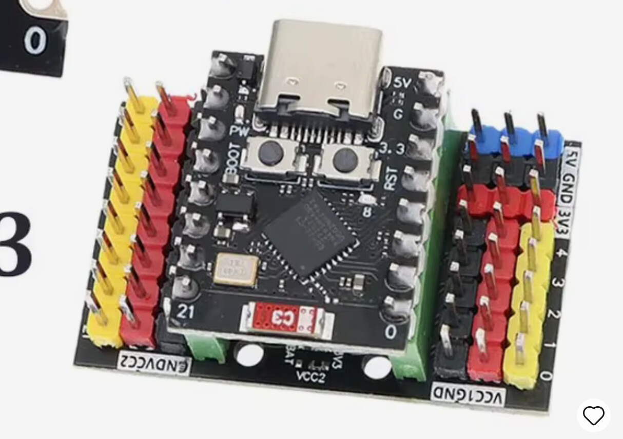

I also got a couple of esp32c3 breakout boards to make testing a bit easier:
Using them remains my preference, just down to size.

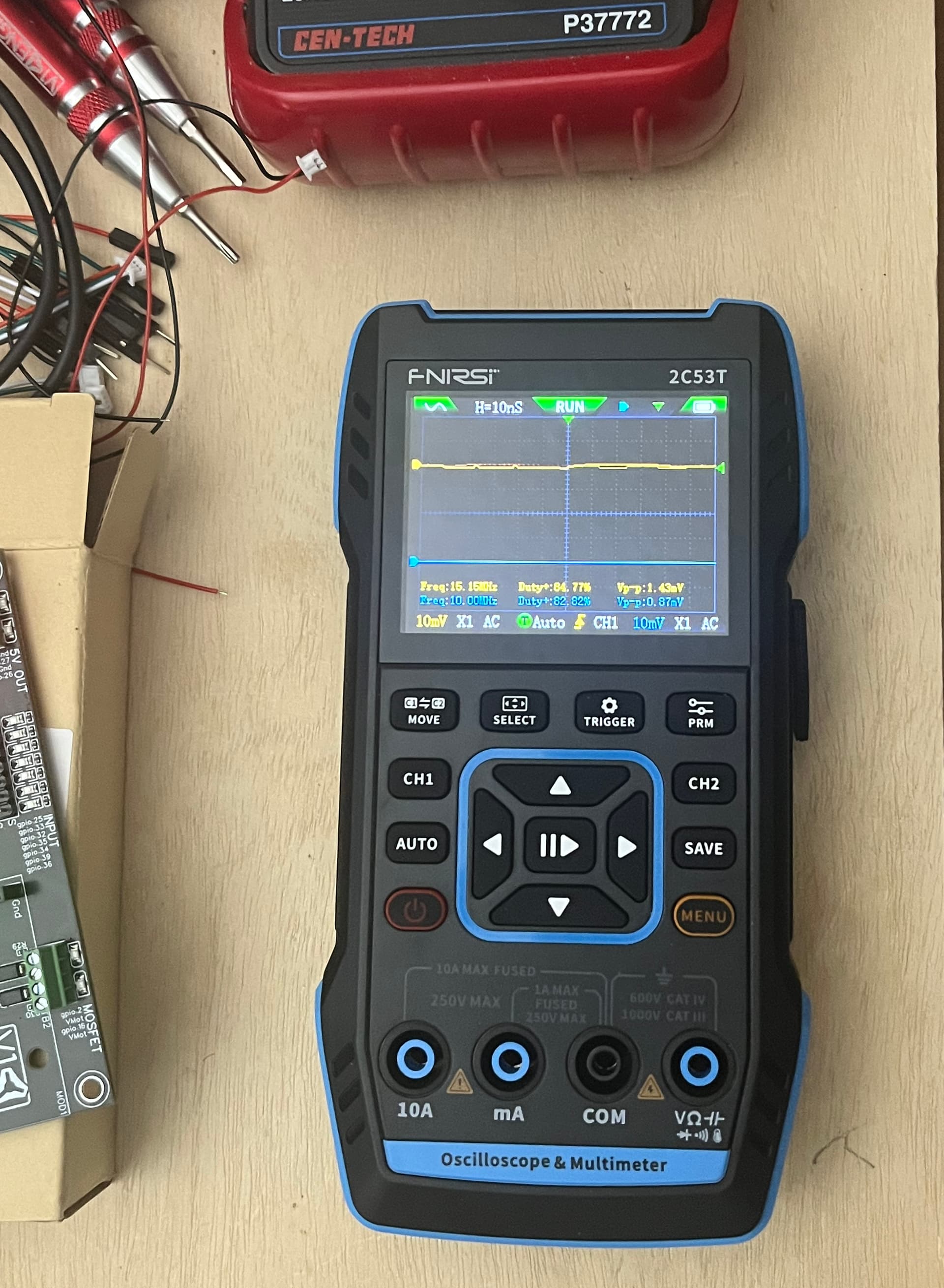

Since the uart pins aren’t shared with the usb port in order to see activity on the uart pins I’ve bought a cheap and nasty oscilloscope
No idea how to use it but there’s a few YouTube videos on this model so hopefully it can do enough to see if there’s data moving.
Might be useful for troubleshooting the jackpot end not booting with the bridge board connected!

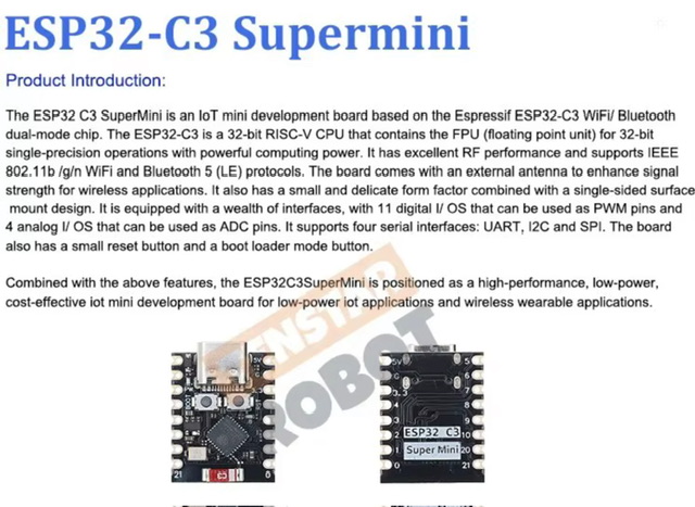

Which variant of board is that?
Love it. I just picked up similar for my growing collection of WROOMs

Nothing wrong with adding to your test capabilities! Plenty of uses for a scope around a V1 machine.
It’s great to be able to get test equipment affordably. You can even get not totally ridiculous DMM scopes these days, here’s the one on my home office test bench

Esp32-c3 supermini

Can I ask your advice on how to approach the 2 issues, now I have an oscilloscope and DMM available:
  • FluidNC not booting with the bridge board attached
  • Checking data flow on pins 20 & 21 uart
For the booting freeze you mentioned checking if pins were high/low during boot. What’s the diagnostic process for that?
For the data flow do I just put a Probe on one of the lines, set the voltage to 5 and look for 3.3 signal bursts or something more?
I’ll do some more writeup of this shortly, as I’m also having a few more cycles this evening to work on some things.
We want to see a scope shot of the TX and RX signals, at the jackpot, during boot. One scope shot with the pendant attached (presumably not booting) and one with the pendant not attached (presumably with fluidNC booting). I’ll see if I can get a picture of this with a Jackpot V1 and an M5 Dial sometime this evening.
Same setup, but after the boards have booted and the pendants are trying to communicate.
You put the scope on both TX / RX signals, boot up, and we look at the scope shots. We can be interactive with this.
