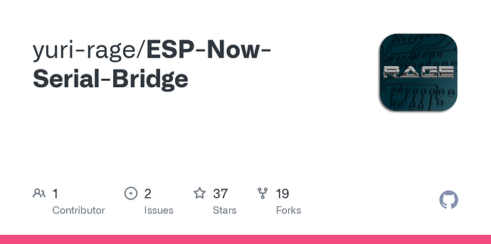

And heres the code -
 * ESP-Now-Serial-Bridge
 * ESP32 based serial bridge for transmitting serial data between two boards

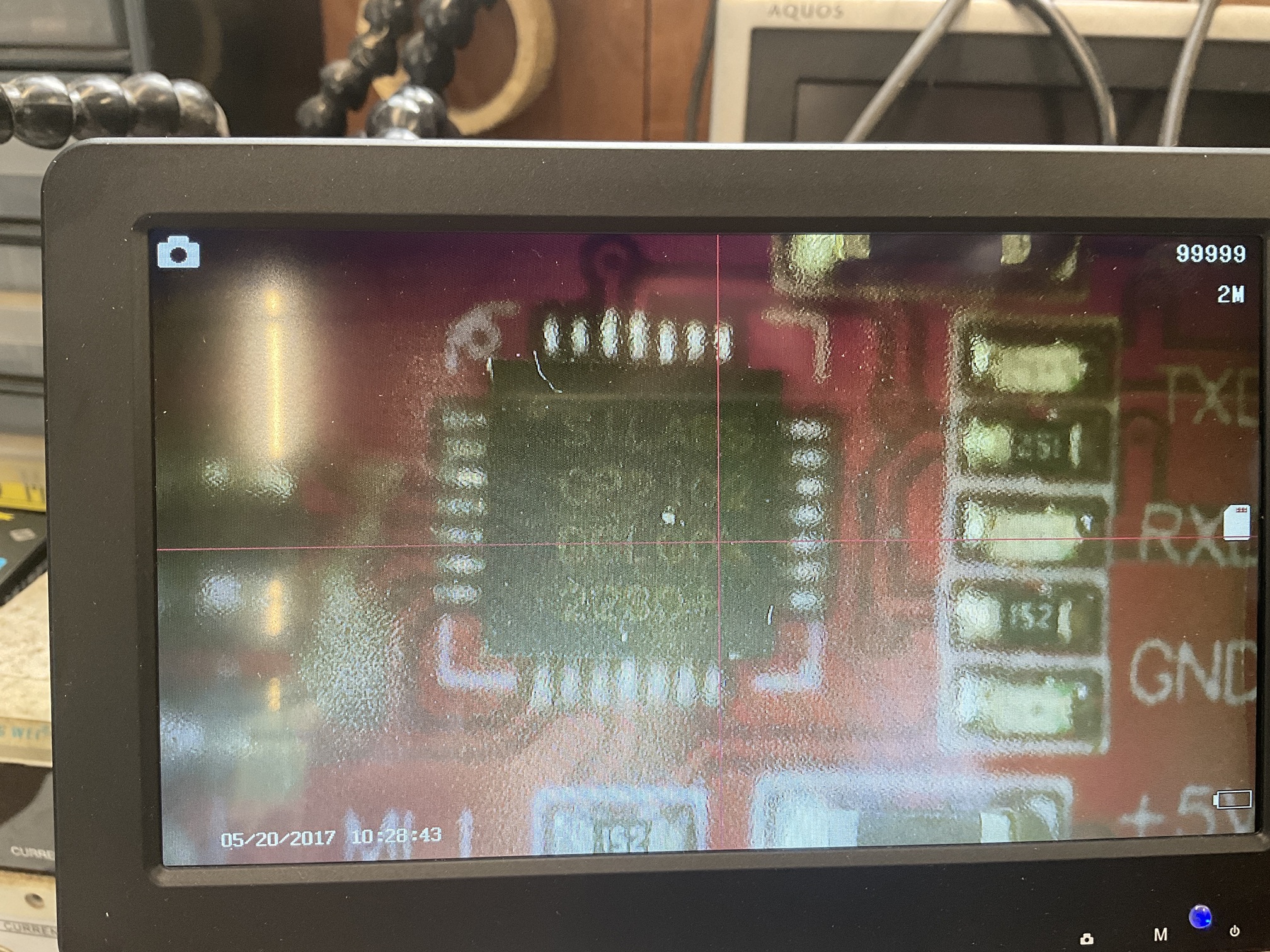

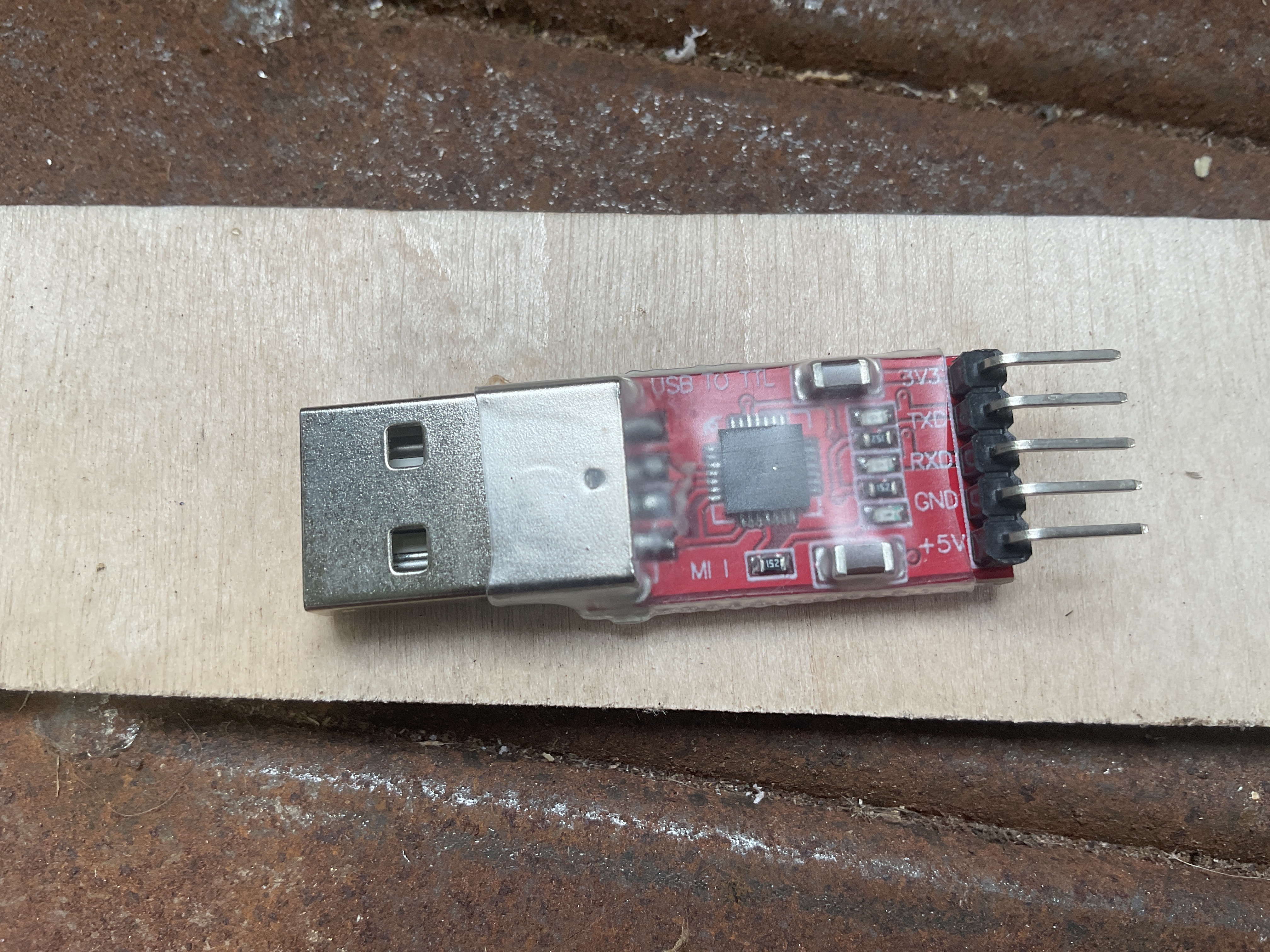

I don’t have an oscilloscope. I do have one of these
Is that what you mean by a usb bridge?
Check the signal levels of the serial signals. The Jackpot / CYD are 3.3V signals. Your adapter says USB to TTL, which for me says it is 5V IO.
Better to use a 3V3 UART.
If your adapter has a 5V UART signal level, you could still at least use RX and GND to make a probe to ‘listen’ to what’s happening on your wireless bridge serial interfaces.
“In theory” the ESP-32 would be 5V tolerant- but I don’t like mixing them. Old habit.
The RX side of your adapter, though, should be able to interpret a 3.3V UART correctly on its RX pin, so that’s why I say you could use it as a probe.
It would be helpful to know what chip is on your adapter- you can get this from Device manager on Windows or from system logs on Linux or MacOS.
Do you know how to set up the loopback test with your wireless bridge if you don’t end up using the USB-to-UART adapter?
It’s the ubiquitious CP2102 - I have a couple of them used for flashing IoT esp8266 devices to tasmota once upon a time.
I’ve no idea how to do the loopback test - it would be good to prove each part of the link - confirm there’s data going to the bridge and know the problem is the esp-now connection. But this is all new.

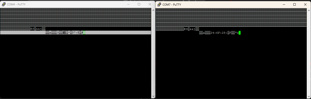

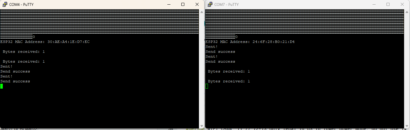

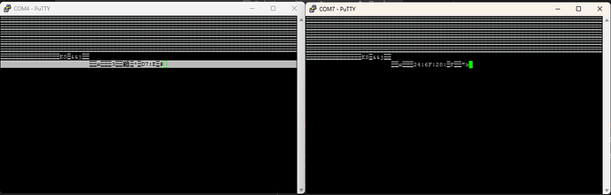

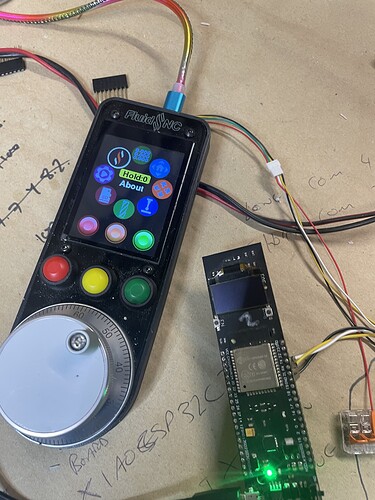

I ditched the esp32c3 in favour of a couple of esp32-wroom boards that expose more pins and got the bridge code flashed to both.
At 115200 I can send serial data one to the other each way no problem and use the usb-TTL to connect to either. You get confirmation data was sent and. A see it arrive.
But when I change the baud rate to 1000000 I can’t successfully open a serial connection anymore using putty. Either over usb or the TTL adapter. The port opens but there are no messages. I just don’t know if this is past the limits of usb serial. :confused:
The esp-now part should be okay. From the documentation:
ESP-NOW uses a vendor-specific action frame to transmit ESP-NOW data. The default ESP-NOW bit rate is 1 Mbps.
https://docs.espressif.com/projects/esp-idf/en/v5.0.9/esp32s2/api-reference/network/esp_now.html
I guess if it was that simple someone would have already done it.
I’ve seen USB serial at multi megabit speeds.
I haven’t tried it on a CP210x, though.
How fast can you go and still have it work?

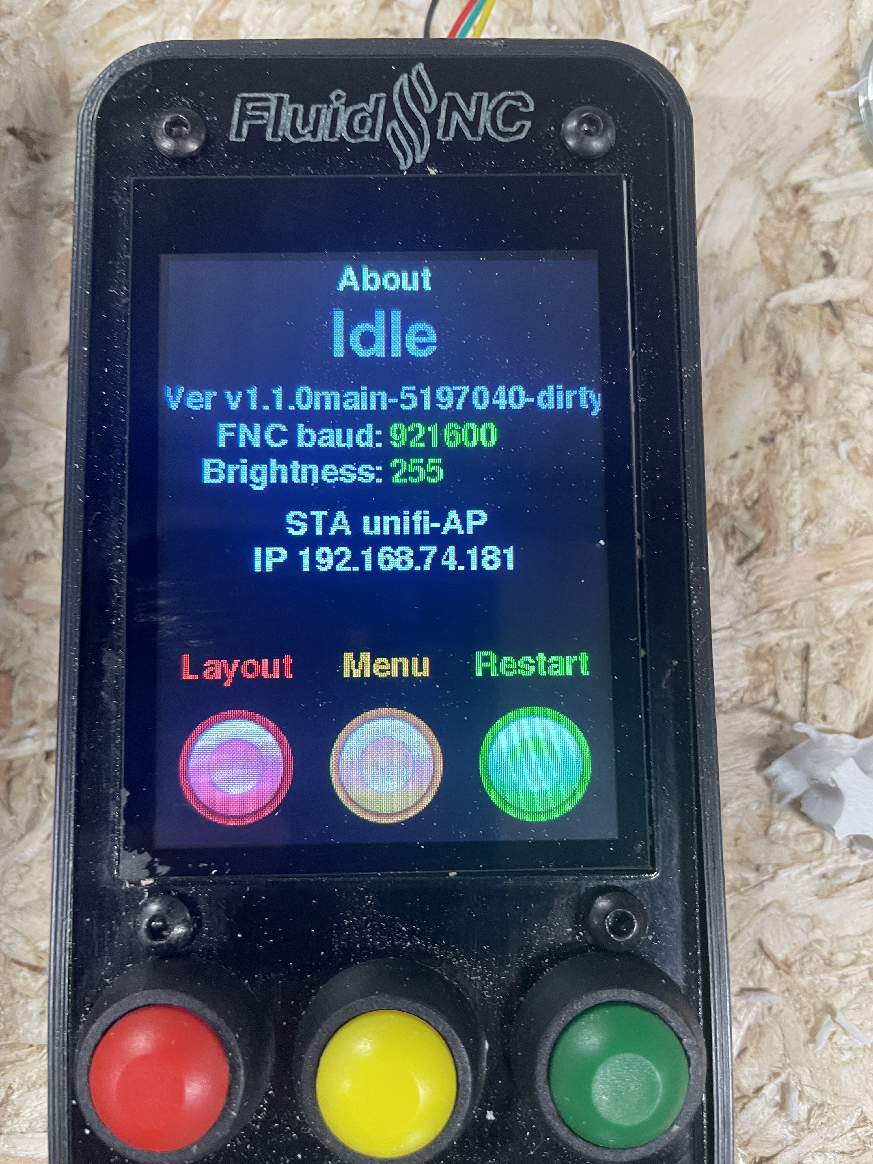

Works at 921600 bps - if I change it to 1000000, upload and open a serial console in putty it appears to open but doesn’t accept any keystrokes.
Also tried it at 1048576 - same - opens but no keystrokes
At 921600
:thinking:
Does FluidNC accept that bit rate?
Not sure but the pendant is hardcoded to 1000000 anyway isn’t it?
Actually I’m not sure if it is or not, I used the precompiled firmware but I could take another look at the raw code

Also change the uart2 baud rate in your config to 921600. It might work.
Progress.
I changed the dial firmware build flag to 921600 and reuploaded. It’s now showing that correctly in the about menu of the pendant. I also changed it to match in the uart2 section of my config.yaml
It connects!
There’s a BUT… for some reason it constantly shows HOLD - if you try and resume or quit it comes back almost immediately.
I wonder if it could be the status messages built into the bridge code… that would make sense - but it feels like I’m close…
If you want a UART bridge to work, you need all of your UART bridge status messages to be out-of- band. Do not corrupt the bitstream for any reason.
If that’s not the issue, double check what the largest serial string is in the interface and make sure your UART bridge can process that many contiguious characters without breaking it or breaking the bit transfer timing of the string.
I’ll comment out the debug messages, I bet that’s the issue.
