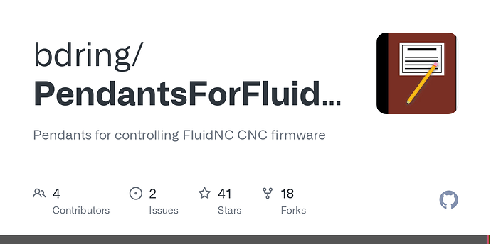

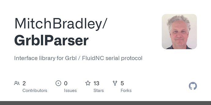

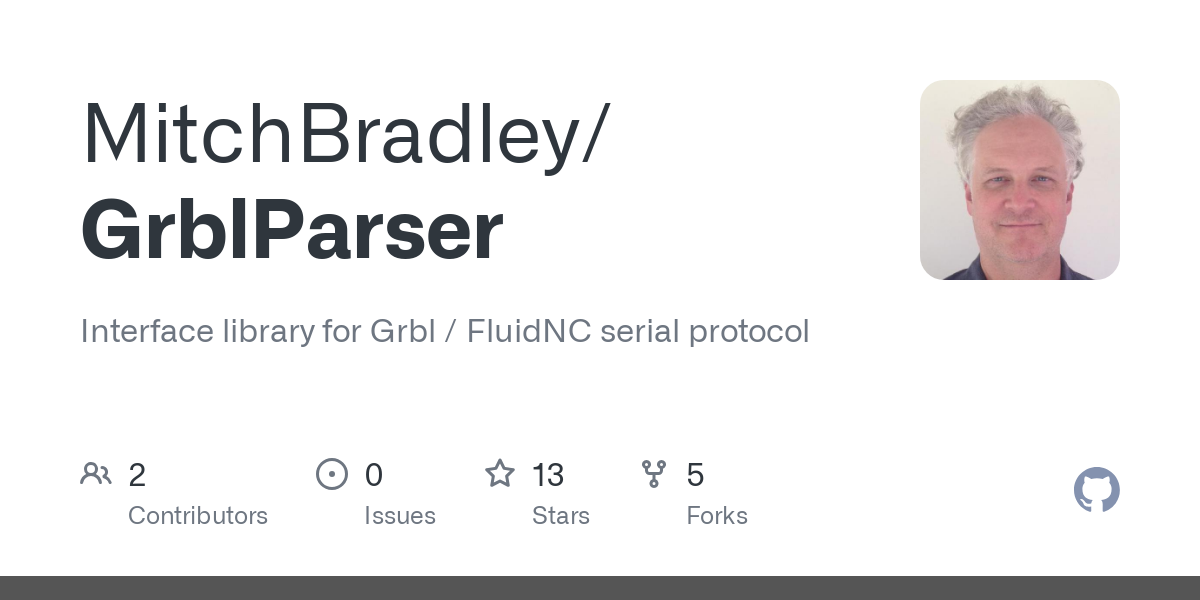

Edit2: some references for review, in case any of my understanding is BS. “Jim is a moron” is always the first branch on the bad understanding fishbone.
GrblParser:
Sample Applications:

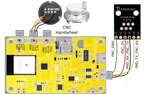

Board 1 - connects to the CYD using the 4 wires that would go to the connector:
Board 2 connects to the Jackpot expansion slot the same way - in each case matching TX to RX. strong text

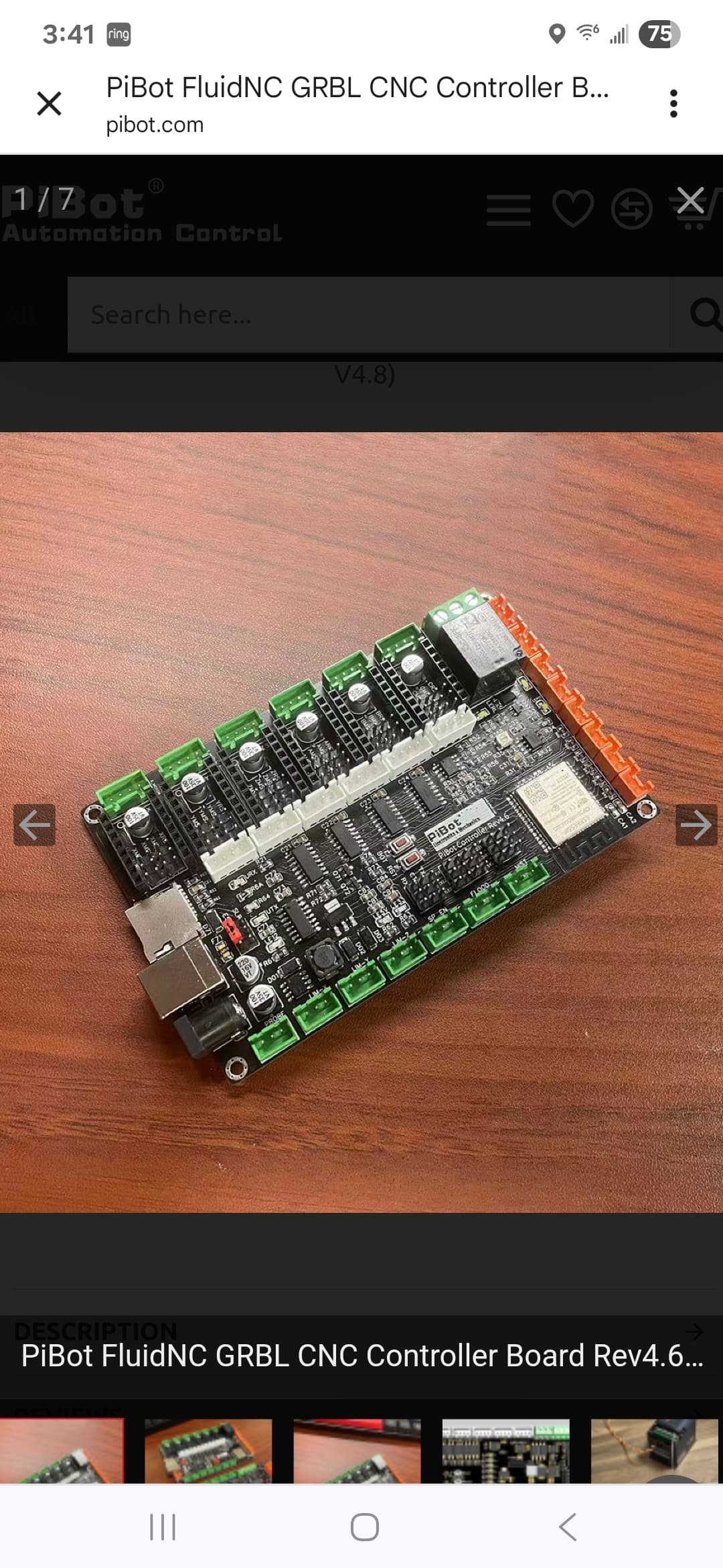

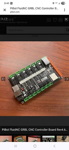

Interesting that PiBot seems to be doing something like this. There’s a video in the description.
Very interesting indeed, as it showa it is fluidnc! Wonder what they are connecting to
Oh they have their own fluidnc board!
Wonder what the 2 knurled knobs arw for!
