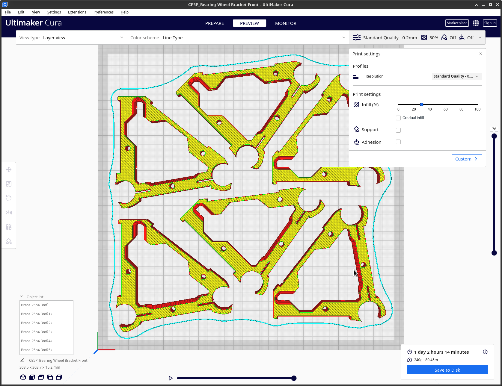

I am new to 3D printing and am trying to adjust my expectations to reality.
I downloaded Cura, loaded 6 x Braces using an example Ender printer, set fill to 30%, print quality to standard and ran a test slice to get a feel for how the software works.
Is 26 hours typical to print these 6 parts ?
Thanks much.
Your time of 26 hours is not unreasonable for the parts I see, but you may be able to notably reduce the print time. Layer height, infill type, etc., all have an impact on printing speed.
If you are new to printing and this printer, I recommend printing one part at a time. If one of your parts fails (which is far more likely with a new machine and you just start out), you lose all six, and that can be really disheartening considering the print time.

For me the issue with printing multiples is that if one fails (for any reason) the others on the plate will most likely get ruined also. I haven’t done any analysis, but it feels faster to me to print one item at a time rather than to lose a full build plate of items several hours into a print.

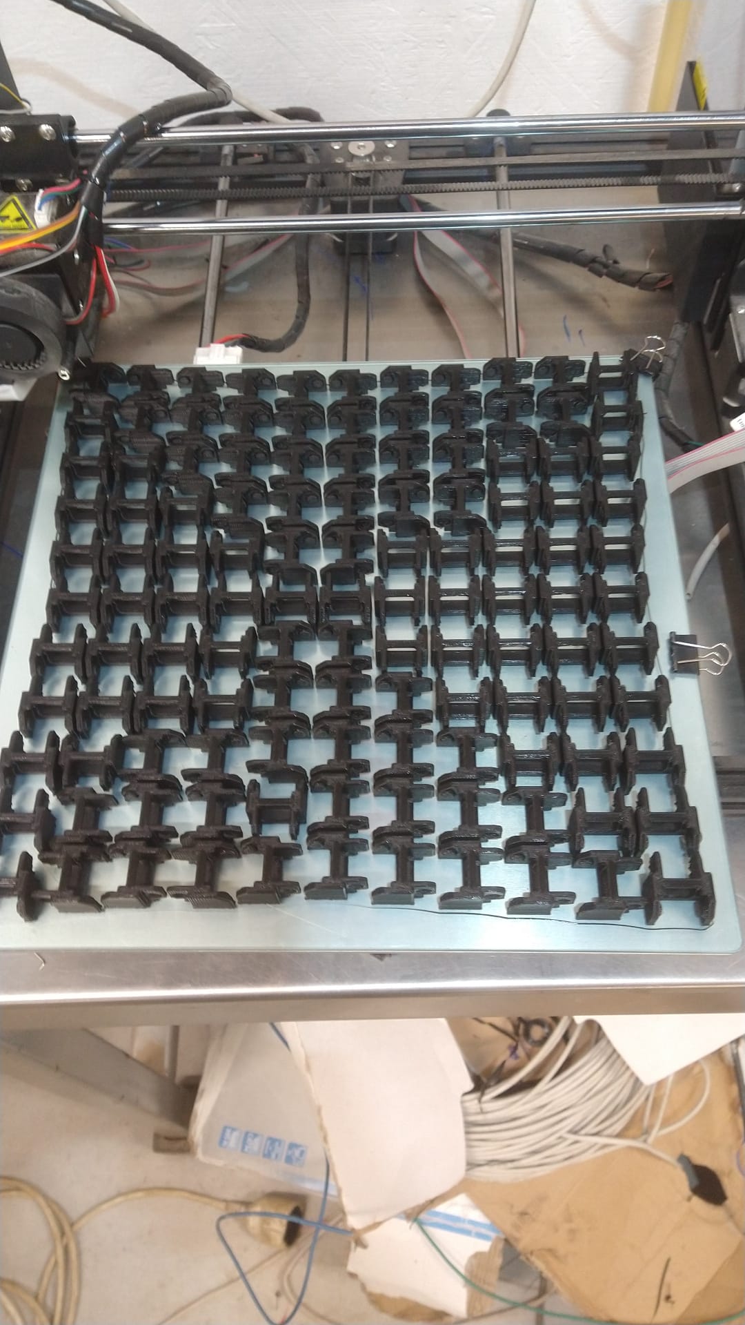

I tried my luck once,
Most of the times I use less of the buildplate…
That you did.
How did the parts come out ?
Was the adhesion between layers strong ?
They all came out well. I wanted to see if bed leveling with my bltouch was working the way is should… it did!
Layer adhesion was fine, adhesion to the bed also. It’s a cablechain which is on my primo now.
