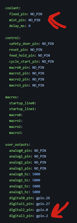

Howdy, I’m finally getting around to putting everything back together with the new JP3. I took a hiatus from the cnc after the initial install, and never got past the basic wiring/function stage. I have (had on the jp1) been using the m8 or m9 command in my startup gcode to turn on a coolant pin, that tripped a 24 relay that turned on my dust collector and router at the beginning of a cut. It has been a long time since I did it on the jp1 and it looks a little different in the 3.
So I have the relay connected to the 24 socket #2 on the board and I need to configure the… config file. In the coolant section the stock yaml has
flood pin:NO_PIN
mist_pin:NO_PIN.
I tried flood_pin:Gpio.2, uploaded and rebooted, which I thought would assign it to that socket, but no bueno when pushing the flood button on the dashboard.
Soooooo long way of asking, how do I configure this?
Swap the inputs from one spot to the other. You can only have a pin assigned in one place.
Alternatively, leave the config as is and turn the digital output on and off instead using:
M62 P3
and
M63 P3
So change the user output 3 to “no_pin” and then flood to gpio.2?
Since I’m just flipping a 24v relay, is there a difference between the analog and the digital outputs?
I honestly stopped scrolling the yaml when I found the coolant section :laugh:
That would explain the generic error message that popped up after I added to the flood line.
I prefer Daryl’s way. Just use those instead of M8 and 9. Then updates and stuff stay simple.
Swapping the 2 worked, thanks.
