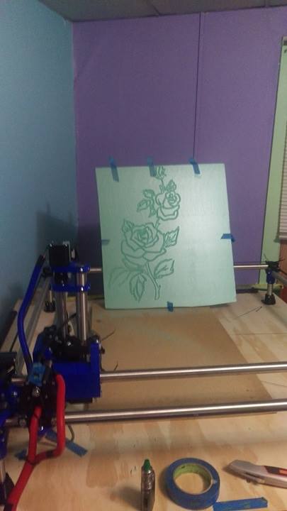

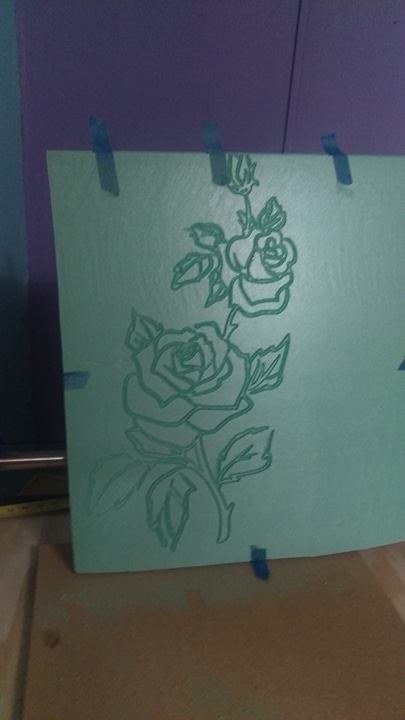

Just want to Give a Big Thank You to All who helped me get my machine running.
A lot of long hours past month and a half made me tired and cranky.
When I would get a little time to work on machine I would get frustrated really fast. I am sorry I sounded like such a jerk on this fourm.
That is not how I am normally.
Anyway, my loving wife convinced me to take a few days away form machine, till I was rested and could get a fresh start.
That is exactly what I did.
Started fresh. I started the wiring process from step one and went through all steps, double checking as I went.

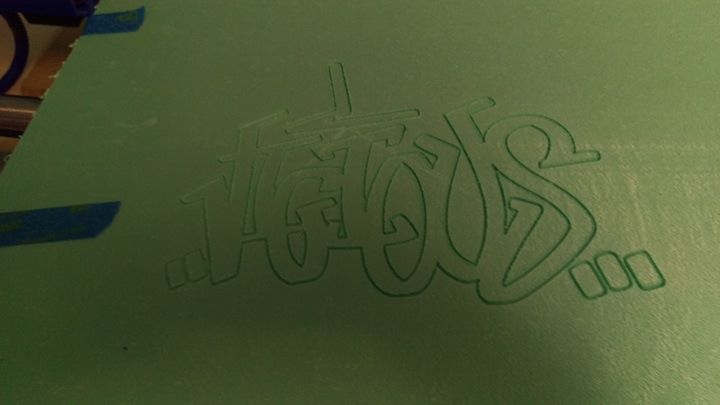

This time, Success!!!.
All is good and test cut, Vicious1 logo is perfect. The 2 lines in middle is the foam was slightly bowed.
Now just need to play with the different types of cuts, engraving and carving options.
This is going to be a lot of fun.
Thanks again
George

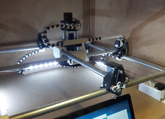

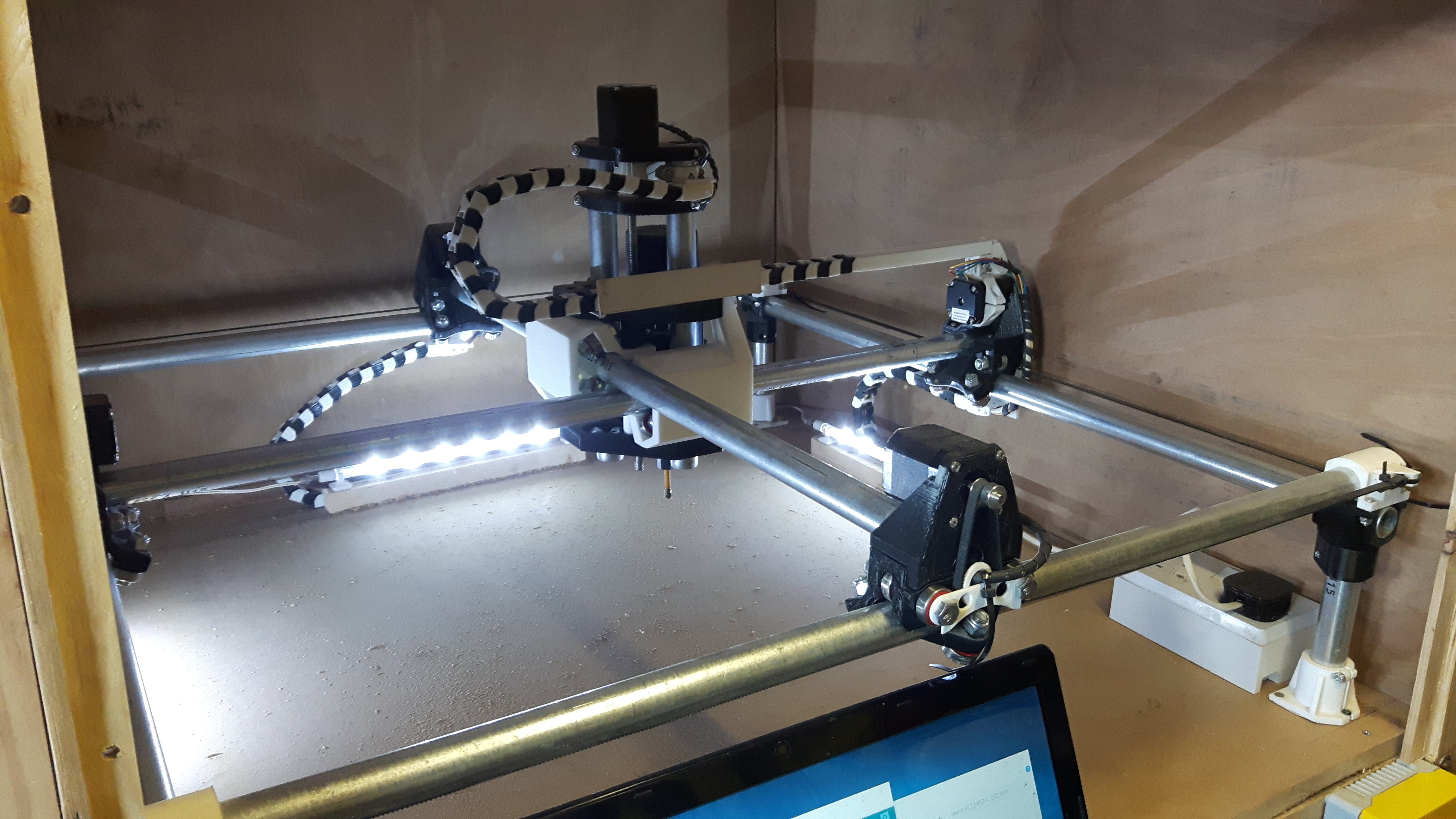

I’m glad your having luck with yours George. Unfortunately looks like I’ve burned my board out, no idea how . Tried a different laptop ,when flashing says can’t find port, changed usb slot (powered down) when turned back on little puff of smoke ? . Lights still come on , On board ,but none of my laptop’s find it so back to frustration . And presume new boards from Amazon for Ā£50. Realy struggling again had working fast week in rh movement scale didn’t seem right but prob did something estlcam .
here’s a pic
[attachment file=33593]
here’s a pic
[attachment file=33596]
Sorry you had a set back like that.
Did you try a new USB cable first?
Would it be cheaper to get a new board from Vicious. It will already be flashed as needed.
I wish you luck, keep us updated.
The picture is nice. How big is your machine, looks about same as mine.
My Minion is 40" X 40", which will give me about a 29.5" square cut area.
About 36 x 36 inch working area . Looks like yours is all up and running ,congrats . Going to order new board at weekend hope to have a bit more luck this time but will have to flash it from scratch so fingers crossed . Would order another one from usa but taxes were expensive .
