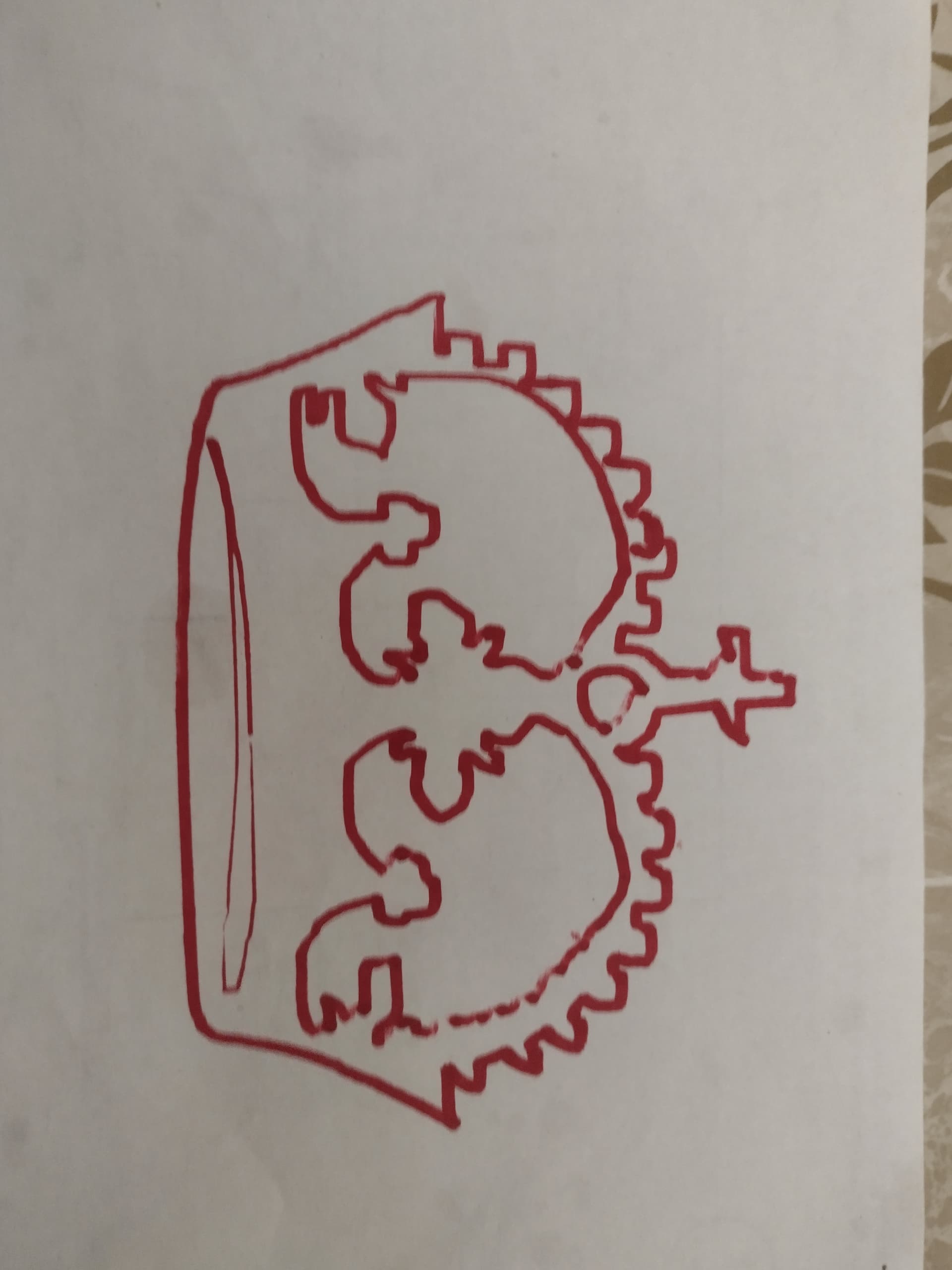

Trouble wih Crown and Z movement
I have two issues (at least).
Thank you for your continued patience and help.
One is with my crown.
I think I’ve followed Ryan’s tutorial but all that happens is the Z just goes up and down.
X and Y don’t move.
I saved with a .gcode extension.
Is that correct?
I can move all axes by command so hey work.
The second problem is my Z axis.
It doesn’t go the whole way to the table top.
There is approx. 2" of lead screw when it stops going down.
It chatters and won’t go any further.
Maybe I’m not cut out for this CNC stuff.

Does this happen when you move the Z axis from your display? If so, this is likely a mechanical issue. As a starting point, run the lead screw by hand and see how much resistance there is moving it up and down.

BTW: For your X and Y issues, I suspect you output your g-code in inch mode, but the V1 maintained Marlin only deals with millimeters. If you post the first 25 lines of the g-code file that is failing (open the file in a text editor and just copy the top 25 lines), we can tell if inches is the issue.

I don’t use Estlcam, but if you look on Setup/Basic Settings, you will find these two settings:
The important setting is Feed unit CNC programs. You want Millimeter per minute. That is the only units the V1 maintained firmware will accept.
As for the g-code, it appears to be in inches, which is what I suspected. I’m guessing you imported the DXF file and created the g-code from Estlcam. The link I provided you above is to a premade g-code file. The top of that file looks like this:

See how different the X and Y coordinates are compared to your file. In your file, your total movement was only a few millimeters.

There is another thing here that seems to trip up people when they first start. Note that there is a G92 X0 Y0 Z0 near the beginning of the premade crown. Your code does not have this command. This command establishes the current position of the tip of the router as the origin/home position for your job. Starting out, it is simplest to just have this command automatically added to all g-code files.
  • Select Setup/CNC Programs
  • Select Marlin if it is not already selected
  • Select the Text tab
  • Under the Program start tab (the default tab open), add the following line below any text in the dialog:
M9 X0 Y0 Z0
Thanks, Robert.
I believe that may have fixed my crown issues but need to find some way to mount my sharpie.

Try some tape besides the rubber bands. Then set the z zero just as the tip touches. Don’t need a lot of pressure at all. You’ll get it!
I’ve got the same router, so i can help if needed.
Thanks, Matt.
Had a long enough zip tie to go around the router and that firmed it up pretty good.
Here’s my crown.
