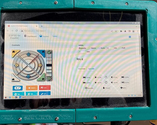

Here is picture of what I can’t click on. I can click other items on the screen just not the movement buttons

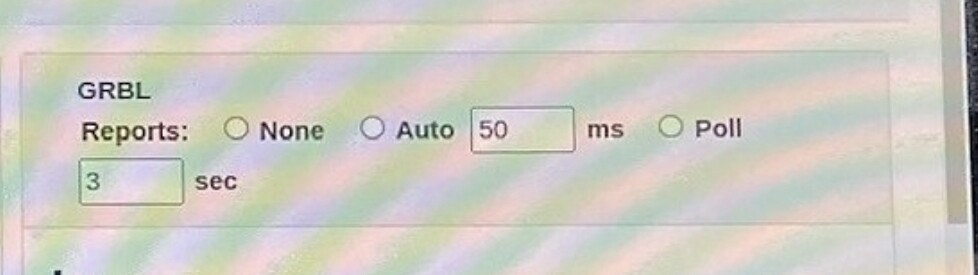

Not sure if it’s related but what stands out to me is that no reporting option is selected. I would set it to Auto 300ms
I’ll try everything was just at defaults for the first moves. i may not spend too much time on this I also have a laser module so I know I would be dragging a PC into the shop to run lightburn I can always find another use for the PI.
I made the adjustment, and that movement panel remains “un-clickable”

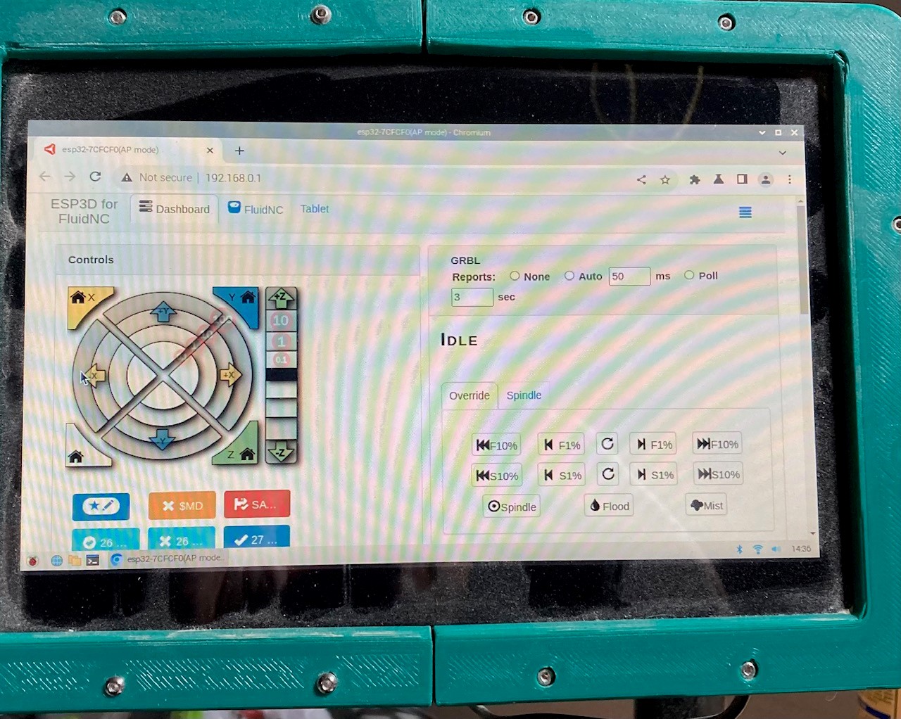

I guess what I had installed and called default was actually chrome, but still the same result the movement panel remains non-clickable. is there a FB group or discord for the webUI?

So I was going through the various things I had found none of which worked but as it turned out one thing did work , a not maximized window with none of it off screen. I was fumbling between firefox and chrome and I really shrunk down the chrome window and as I moused over low and behold the un-clickable section was clickable.
