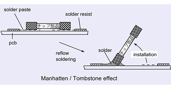

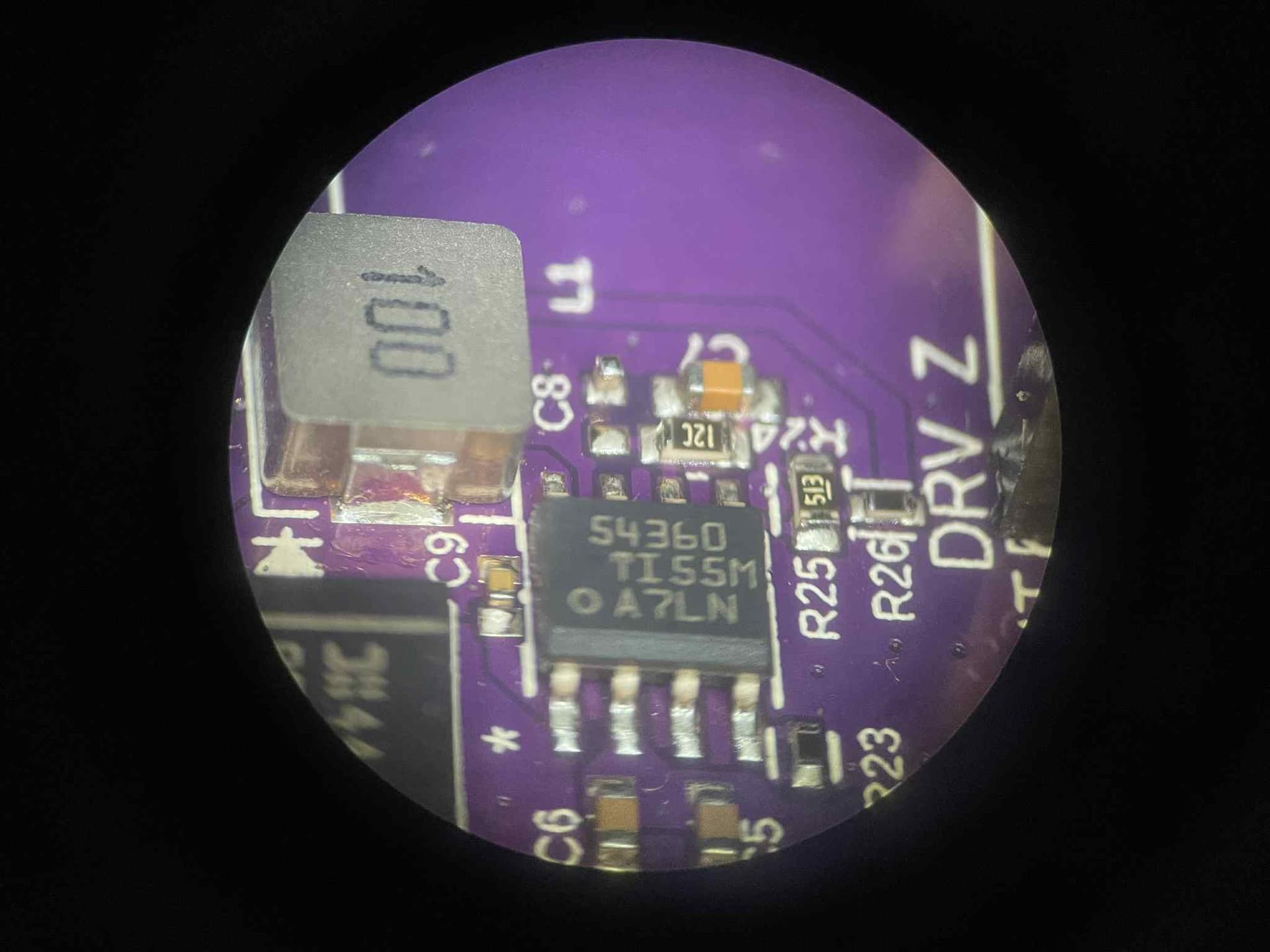

Halloween is coming… I found a tombstone on the boards that came in the mail from Cam today!
Not a big deal to fix, but just posting as a heads up until the footprints are fixed.
I had to look that term up.
I can see it now. C8 above that 8 pin chip.
You make this Picture with your Cellphone or something special Microscope for the PC ?
Oh nooo!! Thanks for the heads up sheesh. Fixed the footprints on the sensor boards but not the main PCB :pensive:. Gotta check the rest of the boards for that
Those are all DNP as well.
I have an amscope stereoscope, the picture is my cellphone through the eyepiece
Ok well glad to say none of the other boards in stock have any tombstoned components. Will definitely be modifying the footprint for future orders, though
