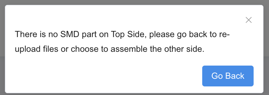

Were you able to get the boards ordered on JLC? im getting errors this error after adding BOM
I think there’s an issue with JLC, My existing pre-order is fine but I’m getting the same error as you importing the exact same files I used to build the order.

Just keep trying JLC is acting weird, that comes up every time at first.
Seems to work if you just click x on the prompt and keep trying a few times. Also JLC support said the change “name” to “designator” in the BOM. Seems to be working now. Thanks. Also, were you considering adding the headers as a component, probably wouldn’t cost much at add it to the assembly
