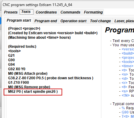

See here Ryan’s start GCode from the docs:

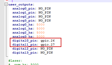

GPIO 26 & 27 are the pins on the Jackpot that control the 5V outputs.

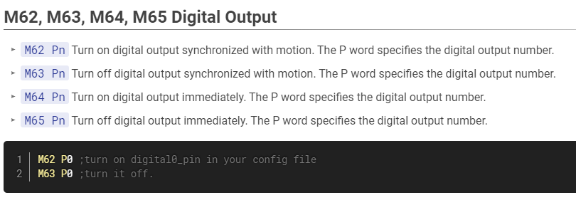

See M62 docs
and the mapping from Ryan’s config file:
I think this should be all of the details of how the 5V output rail hangs together for controlling things.
Be aware, 25mA max current on the 5V outputs I believe.
TLDR;
M62 P0 (enable GPIO 26)
M62 P1 (enable GPIO 27)
M63 P0 (disable GPIO 26)
M63 P1 (disable GPIO 27)
in the default V1 config
Damm I saw that and disregard it as it said sindle.
Stupid brain.
Yes 100% that will work for my application. For some reason it didnt click.
