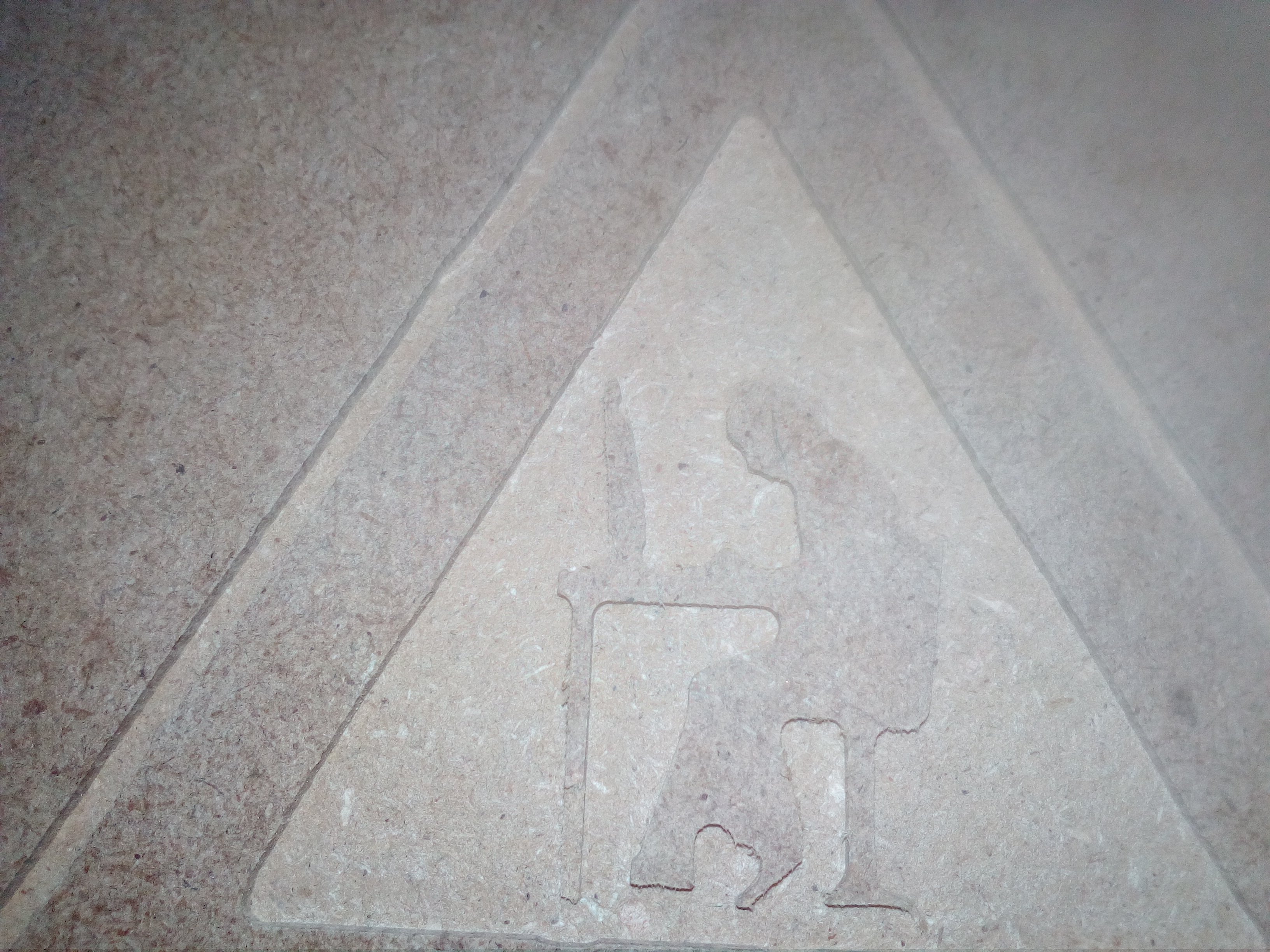

Hello there, sorry for my english. I put some image for explain my problem: how can i fix the trembling of the machine?

Please answer the questions from the sticky, it looks like you are using a 1/4" bit so what is your cut recipe depth of cut, speed and stepe over, what spindle, rpm’s, how long is your z axis?
If you don’t wanna answer that, The only advice anyone can give is slow down or make shallower cuts.

MPCNC 25 OD printed in PLA at 30mm/s 55% infill
Conduit
25od iron
Size External CM 91x91x11 (XYZ)
Stepper Motot
NEMA 17 wantai ( 42byghw811 ) 2.5A for phase
Stepper drive
Pololu DRV8825 CLONE
Spindle:
makita RT070x SERIES
RPM: 12k (the lowest speed)
Endmill
-1 flute
-shank 1/4
-diameter of the endmill 1/8
Firmware RC7
Pc User (estlcam / repetier )
The engrave size is 2mm depth and the external cut is from a 6mmm MDF sheet

Use shallower passes. Something like .5 or 1mm per pass.
seem better now
I suppose it was a software problem, now i will try to work better in that direction, thanks to all
