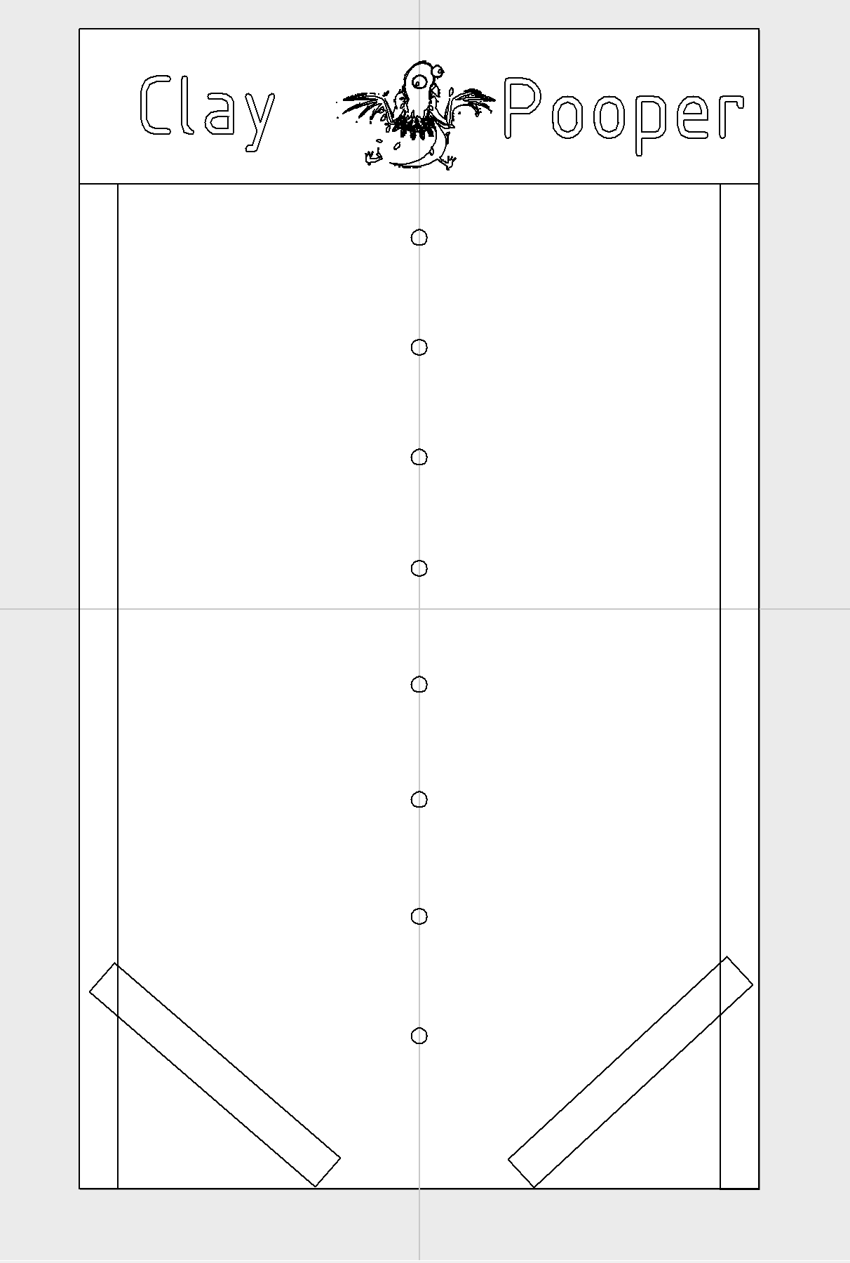

No, I was going to just make a custom one myself to fit in our current target frames at the range.
My plan was originally to use an arduino/pi to work actuators, but the cost quickly spiralled so I am going to do as in the video, with a slider and string. I may use something like a sewing thread holder to allow a partner to pull straight rather than someone at the side. I will also slightly angle where the clays are stored, so as to not release more than one at a time, and a funnel effect at the bottom to catch the smashed ones ( or more likely, the ones I miss )
I also am considering a french cleat for mounting, and either angle that, or have a bit of wood at the bottom to make it slightly angled so the clays don’t fall forward and out. I intend to use rabbit clays.
The nails in the video are a bit of a risk to me so I will use wooden dowels, and to help it last a bit longer use a 20mm ply, with a thin sheet with pre drilled holes to be inserted as sacrificial board.
I need to experiment with the software to see how to get the holes all ligned up and get a clay to measure the gaps.
Once I do all this I am happy to document it here so people can see the project and how I overcome issues, because I imagine there will be mistakes on the prototype.
Something like this.
How long will this last if you are putting holes in it regularly?
Im not sure, but its for a 22 only. From reading online they last about 6 months, but thats why I want a sacrificial board in front of the main part. Once I have the design, it wont be hard to remake parts on demand.

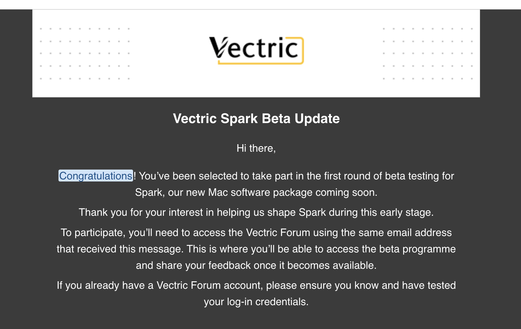

tbh I run mac as my daily ( its basically linux anyway ) but the newest update has really put me off it. My cnc surface laptop runs on windows :confused: just for vectric really, but the main PC is arch. More distros are moving towards arm64 and mac silicon support, I have tried arch, ubuntu, fedora, FreeBSD and such and must say, ubuntu seems a clear winner to date. We shall see how things progress.
so, I am almost finished my last project of the barrel lid - its slow going due to ill health. I am holding off on the clay one, but have a few other vcarve type ones I want to do. I shall hopefully have this new software in time to test with these more interesting projects.
