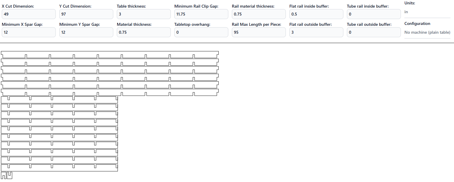

Minor issue, if you select the “no machine” configuration:
The last notch in the X spars is a little bit wonky:
(Sorry, I accidentally had my “QA analyst” hat on…)

Yeah, I’ll admit I don’t check that setup very much. I’ll take a look later today or tomorrow. I should really write some tests or something… bleh, feels too much like real work.

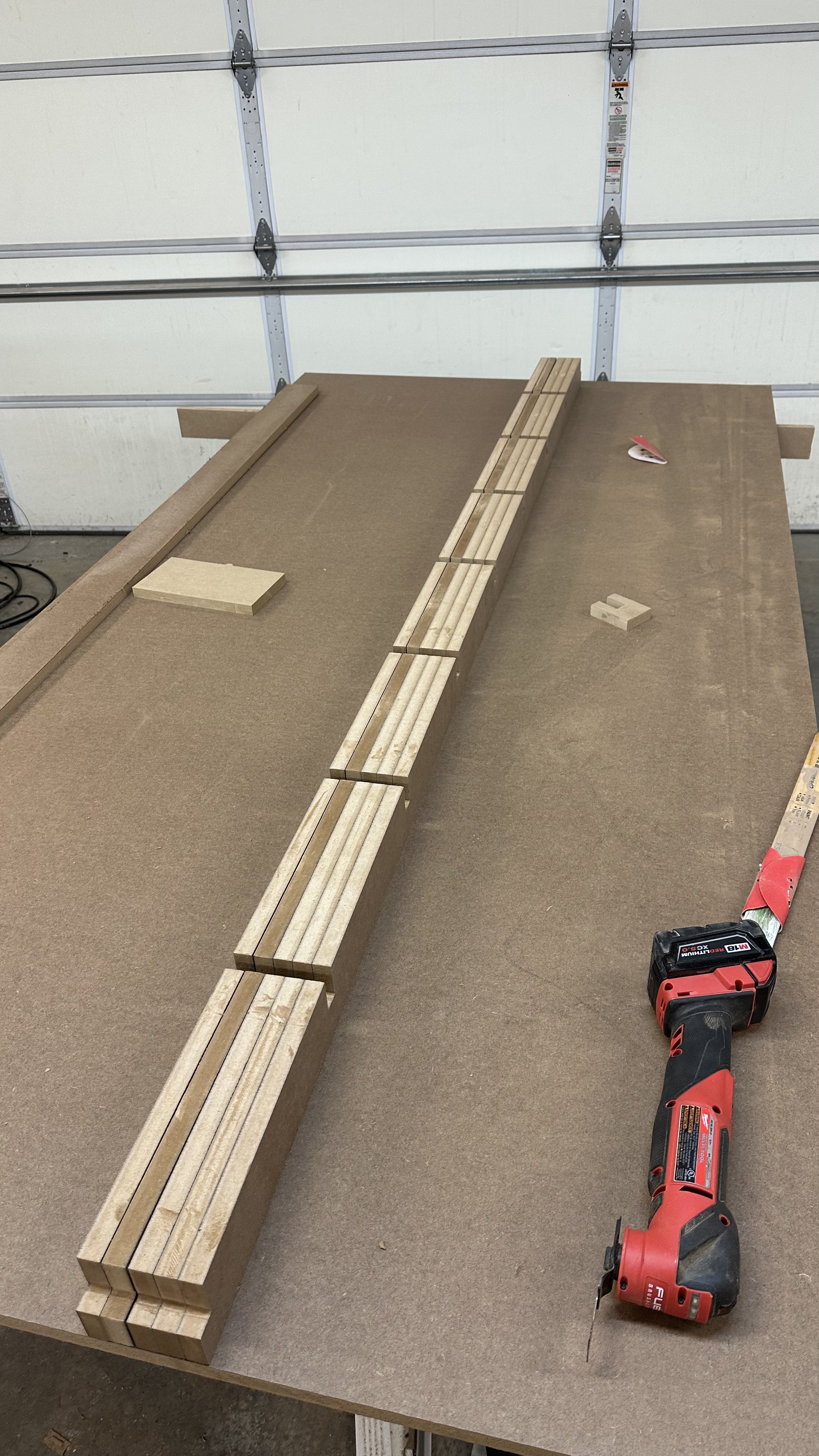

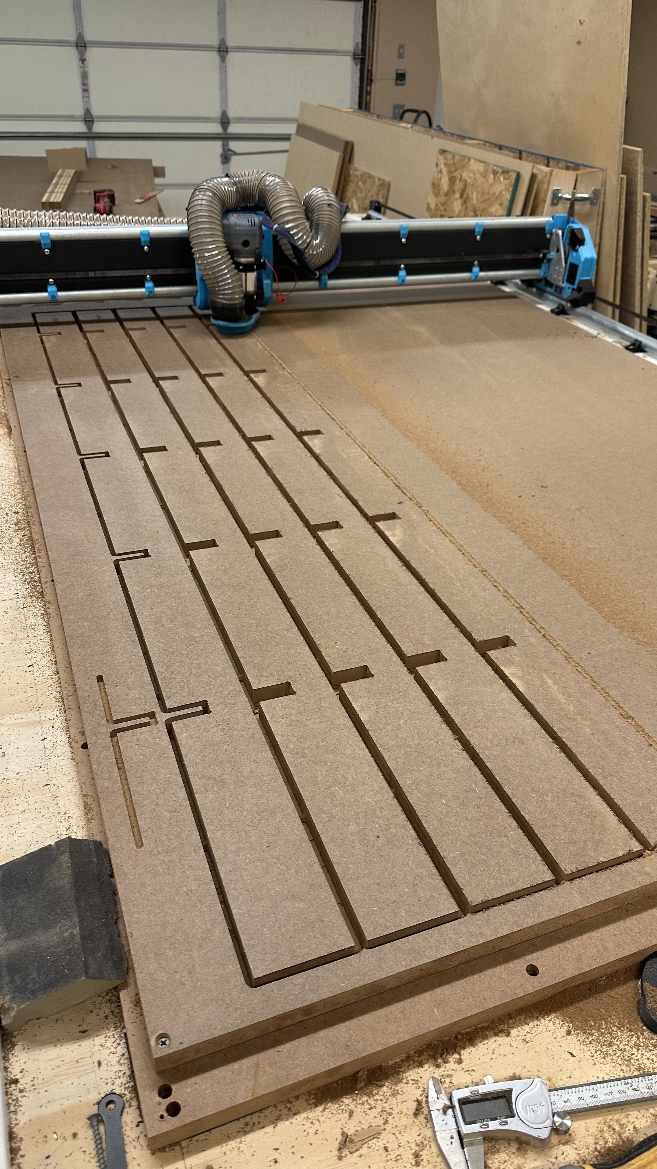

Cutting is underway… wish me luck!
Oh, so exciting! What are you using to cut (feed rate, bit size, DOC)? I was a little too squeamish to experiment much on mine.
1/4" up-down compression bit, .25" pass depth, 250 in/min in Estlcam (though I’m not positive the LR4 is getting quite that much speed but it’s moving right along…) Makita router is on about speed 5 which may be a bit too high but sounds better than listening to it bog on lower speeds.

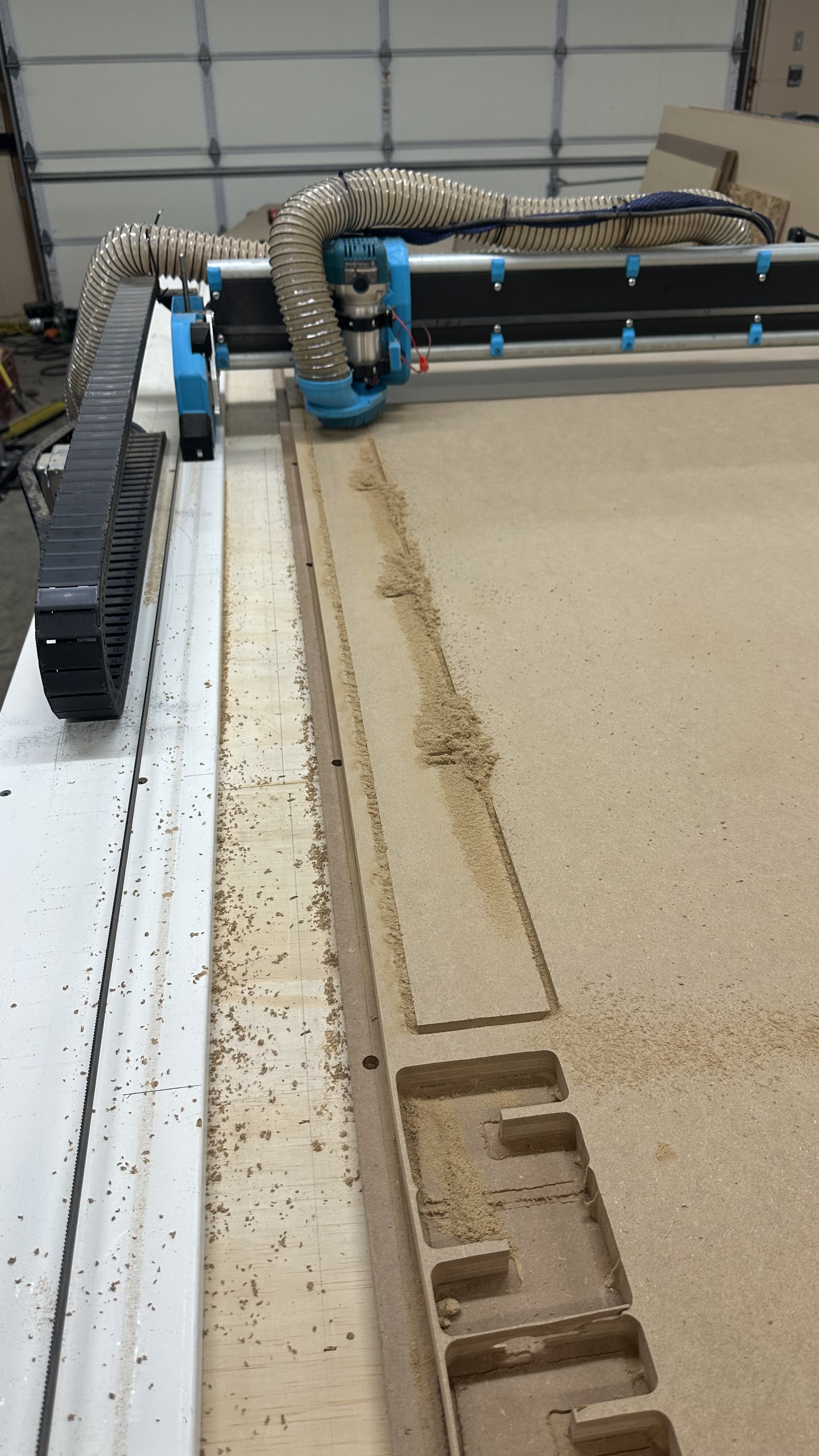

Discovered about 2/3 way through the X spar cuts that I had some wobble on the x rails - enough that I could watch the whole core move in the Y axis direction as the notch cuts were being made. Result was a bunch of pieces with a way-too-narrow notch, so those will get donated to the scrap pile and I’ll start again now that I’ve tightened the rollers to alleviate the wobble. If I only end up scrapping 1 sheet of MDF in this process, I’ll still be happy… :wink:
Oh, I think in aggregate I scrapped about one full sheet :joy::joy:

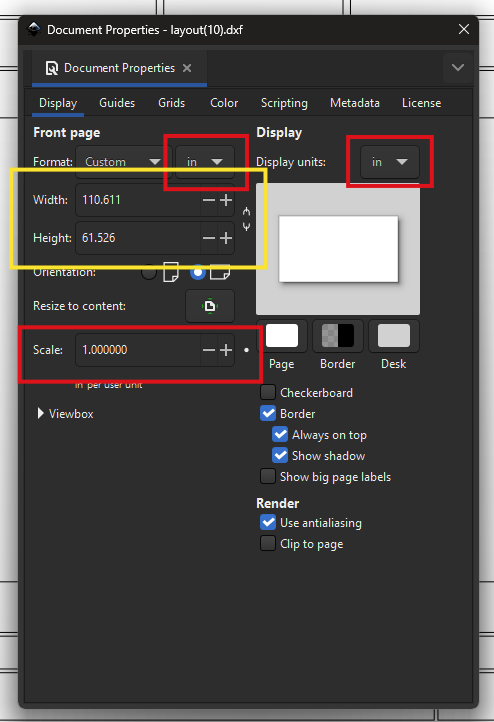

I have tried inches and mm, online converters, and re-exporting through inkscape. No matter what I do I can not get this to be scaled correctly in Aspire v12. Could this output a DXF format or include reference dimensions so I can manually scale the import?
I am surprised it’s so difficult. Does Aspire let you pick units when you import an SVG? Could you share screenshots of the options?
I don’t know how to create a DXF. I can look into it this evening.
I’m unlikely to add DXF support to the tool. Please try the following.
Open the SVG in Inkscape. Fuss with the document properties (File > Document Properties) until it looks roughly like below.
I set the scale to 1 DPI, and the format/display units to inches (if you’re entering measurements in mm on the web tool, try mm.). That’s all the red boxes.
You should see dimensions in the yellow box that make rough sense with the layout you’re seeing. Probably the width is the value that makes the most sense to check directly. This will be just slightly longer than you expect the Y dimension of your table to be.

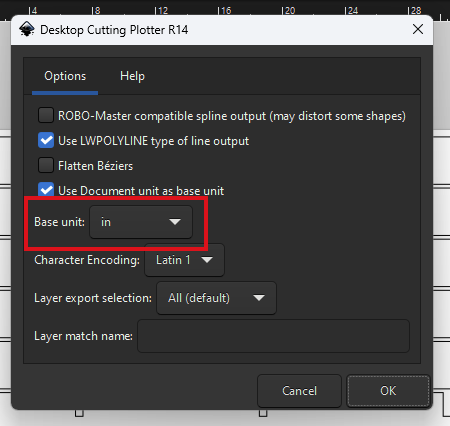

Now, save as a DXF. File > Save As, pick DXF14 in the filetype dropdown. You should hopefully see a window like this where you can pick ‘in’ (or, I guess, mm if that’s what you’re working with) as the unit.
This will create a DXF file. When I import this into Vectric (I just downloaded the free trial myself, hopefully your experience is the same/similar…) I see everything at the correct dimensions.
This worked perfectly. Thank you!
