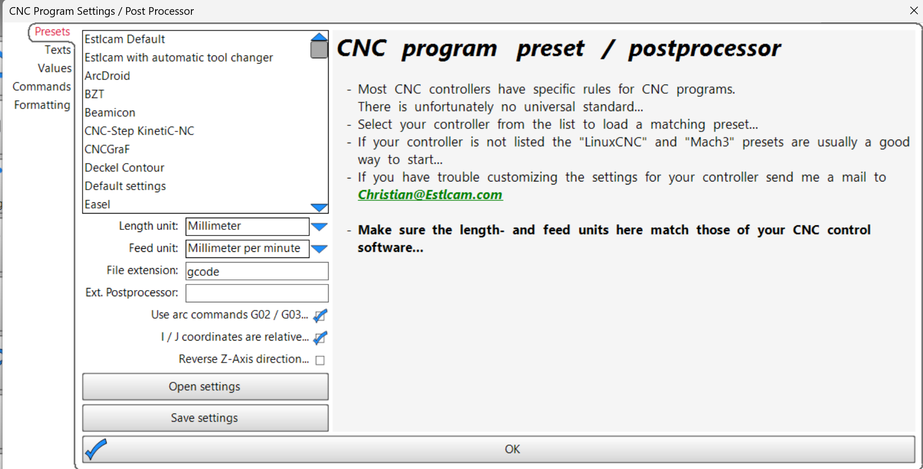

Hey all,
I’m running an MPCNC Primo with a Rambo 1.4 board. When I go to machine out my design in ESTLCam, the tool moves to the zero point but then does not continue to move throughout the rest of the print. I can move the tool in each direction through the motion page, but I cannot get the dang thing to carve out a design. Is this a control board issue, or some settings in ESTLcam? Sorry for the lack of info but I’m pretty new to all of this. Thank you!
Max
Check your estlcam settings…
Under setup go to CNC Programs and make sure your Feed Unit is set to Millimeter per minute
Its ok to have your bits in mm/s. That’s how most of us do it. But the feed unit here needs to be mm/m. If its feeding it 10mm/s as your feed rate the controller is reading that as 10mm/m so its moving so slow you cant see it move.

That was it, thank you very much!
