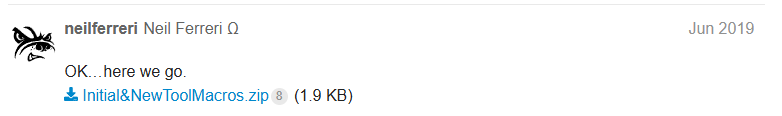

Using a set of Macros for G-Sender I was able to get the workflow I wanted:
See this Video for them in use:
video
Now the real challenge is to convert or re-write these macros for G-Sender into Macros that FluidNC understands
are there any programmers here who know the ins-and outs of converting from: “Javascript” to “LinuxCNC”
Advanced Macros
gSenders Macro architecture is based on JavaScript and uses the Esprima library (https://esprima.org/) and so will theoretically support any code that it does. This is exciting because Macros can move far past basic variables if you’d like to perform advanced functions on your CNC:
G-Sender Macro
to:
http://wiki.fluidnc.com/en/features/gcode_parameters_expressions
Parameters and expressions allow you to use gocde as a programming language. It has a lot of limitations, but should be able to allow you to create more powerful macros and things like simple tool changers. It is based on LinuxCNC and NIST RS274NGC
Are you using these specifically as is?
This doesn’t look bad at all to convert. It might use JavaScript behind the scenes but it’s mostly just using variables. It does seem to have some features that FluidNC doesn’t have but nothing that doesn’t have an alternative.
I’ve messed with this FluidNC gcode parameters and expressions quite a bit. I don’t think you need to be a programmer.
I can help convert this if once you confirm the exact scripts you are using. It’s also possible to create a macro to automatically do that X/Y/Z probing. It might take a few passes.
