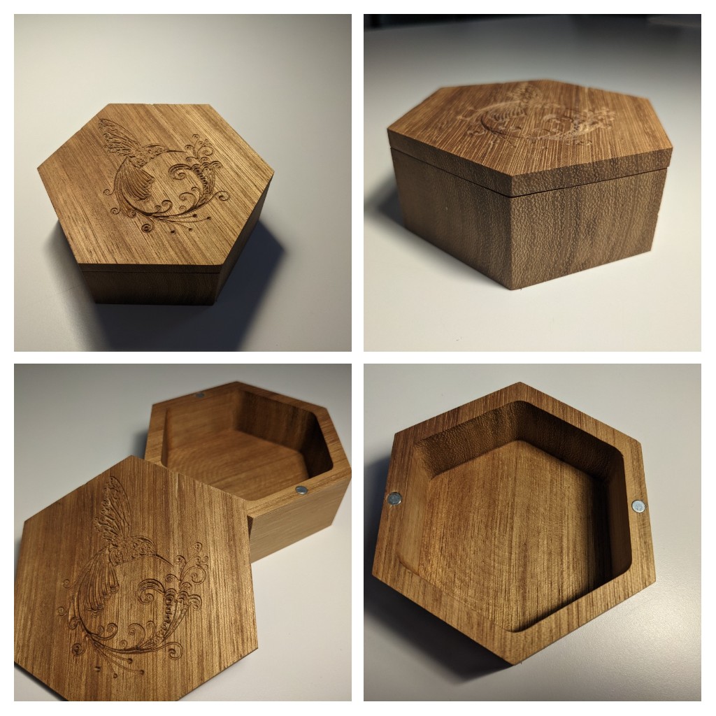

I built a burly in 2020 and upgraded it to a primo shortly after that.
The machine and me had quite a lot of good projects and fun, but I was always fighting with feeds and speeds.
Example project: hardwood round box with colibri engraving: https://www.youtube.com/watch?v=fgPMhQkOQeM
The build size is moderate (446x437x76mm) but accuracy was never living up to my expectations.
I want to use the winter time to dust of my primo and get it back running and upgrade parts or size down where necessary to get better results / stiffness.
