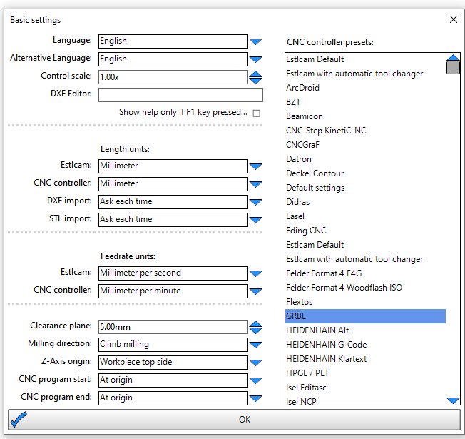

I’ve never run into that problem. But to be fair the only time I did in code (mid run?) bit changes was using estlcam. I don’t 'recall having that happen, but it was a while ago. After messing with ecam for a while I went back to vcarve. I set every bit as its own file and haven’t tried doing tool changing with it. Although now that I say that I’m wondering if I was doing the same with the other software. I do definitely remember not at all being happy not being able to decide where to probe to after the bit change.

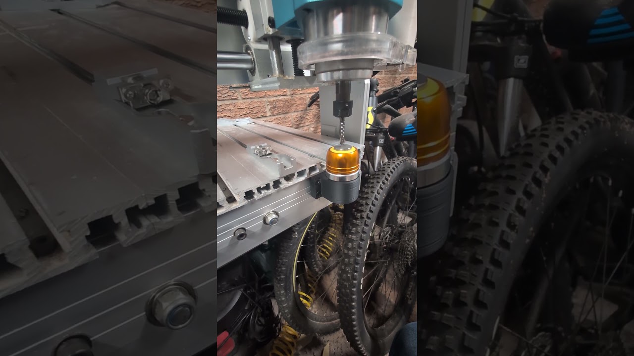

This style of probing is cool

Nvm found it on Ali express - I need to integrate it into my jackpot 3 (wiring).
I’ve looked at doing this but I decided against it for a few reasons.
  1. You have to run that cable all the way to the Jackpot. So, if you don’t already have a cable chain, this is a pain.
  2. That video is skipping the first step. You still need to probe the top of the material with a regular touch probe. Then it needs to use this other probe to calculate the offset.
  3. I’m not sure of all the gcode changes this requires.
  4. I don’t think you can do this unless you have a spindle? It needs to turn the spindle off, go to the tool change location, go to the probe location and probe, and then turn the spindle back on.
  5. Unless I was going for a full ATC setup (which I’m not), it didn’t seem worth the effort to save a probe or two.

I see the utility for carving where your initial surface for setting z height might be gone when you change tools.
I use one now for changing tools, it’s amazing.

But thinking more about this I wouldn’t use and of the ATC stuff in fluidnc. I’d put the steps above in the tool change configuration in EstlCam.
