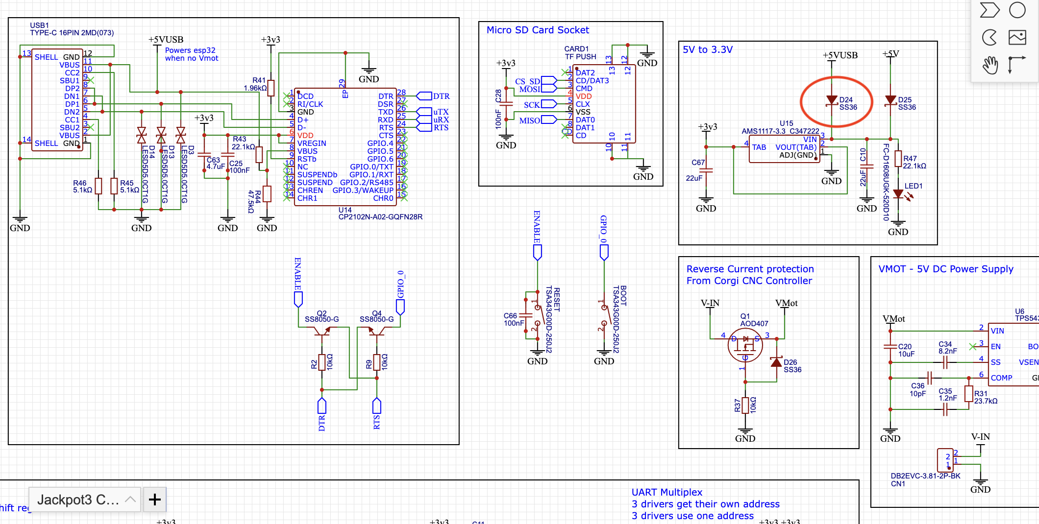

Well, this is a use case I didn’t think of. Seems like a power jumper on the USB rail is a good idea.
I’ll take a look at the schematic in the next day or so. I’m not sure the USB power lift will help as it may end up the CP2102 isn’t powered in that scenario.
Stand by for better guidance.

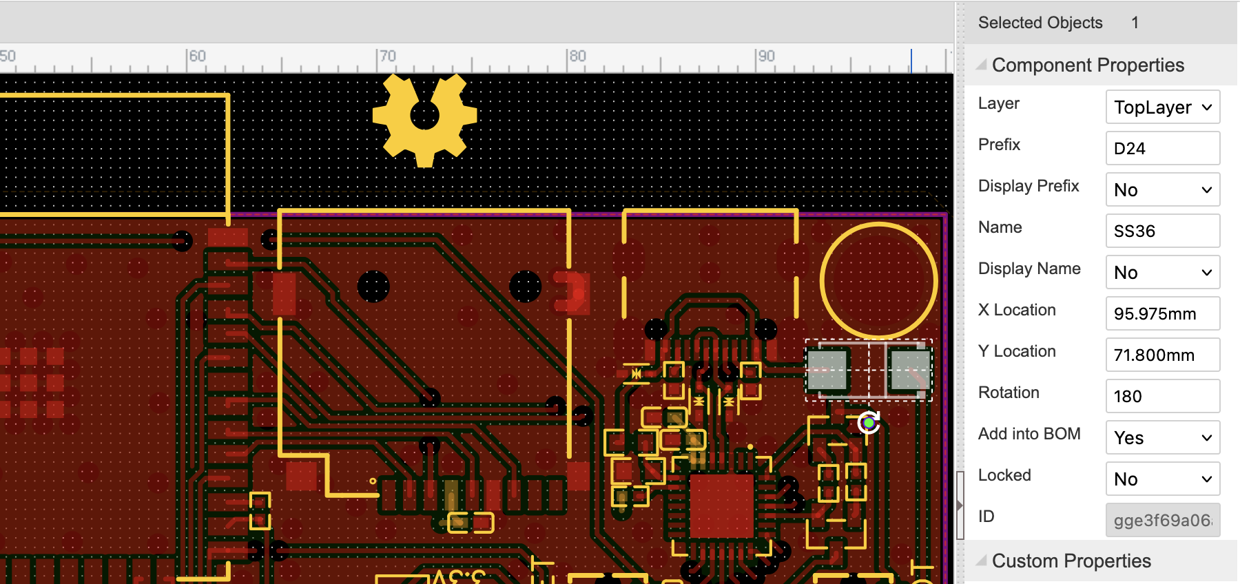

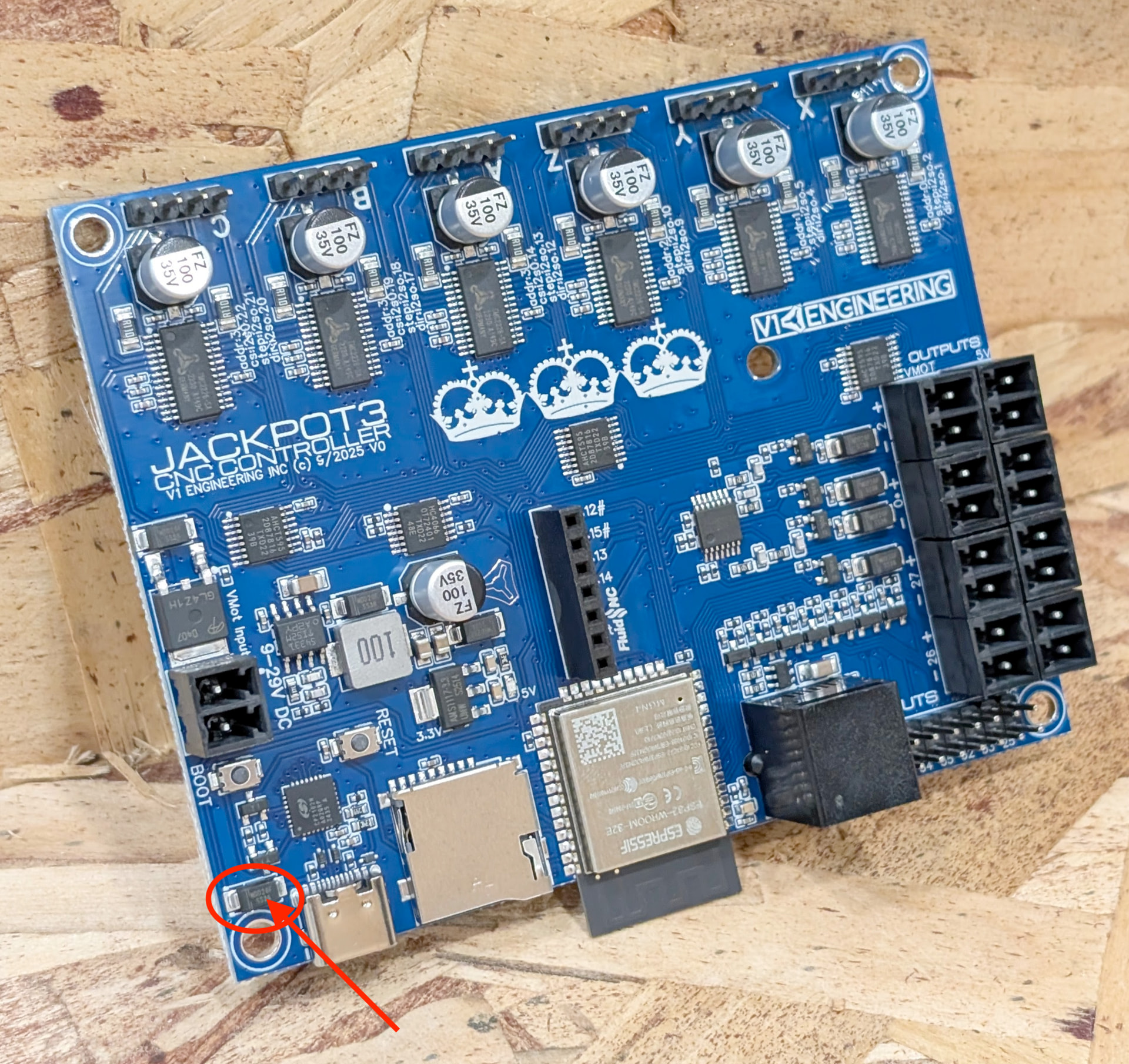

Copy/paste from design thread:
OK, we should have Ryan double check me, but it looks like someone electrically savvy could de-solder D24 and it would have the same effect as if we added the jumper we’re talking about:
One could probably also cut the trace if not wanting to de-solder D24.
