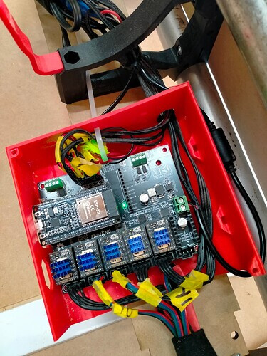

Tmc driver not detceted
Okay, let’s try this.

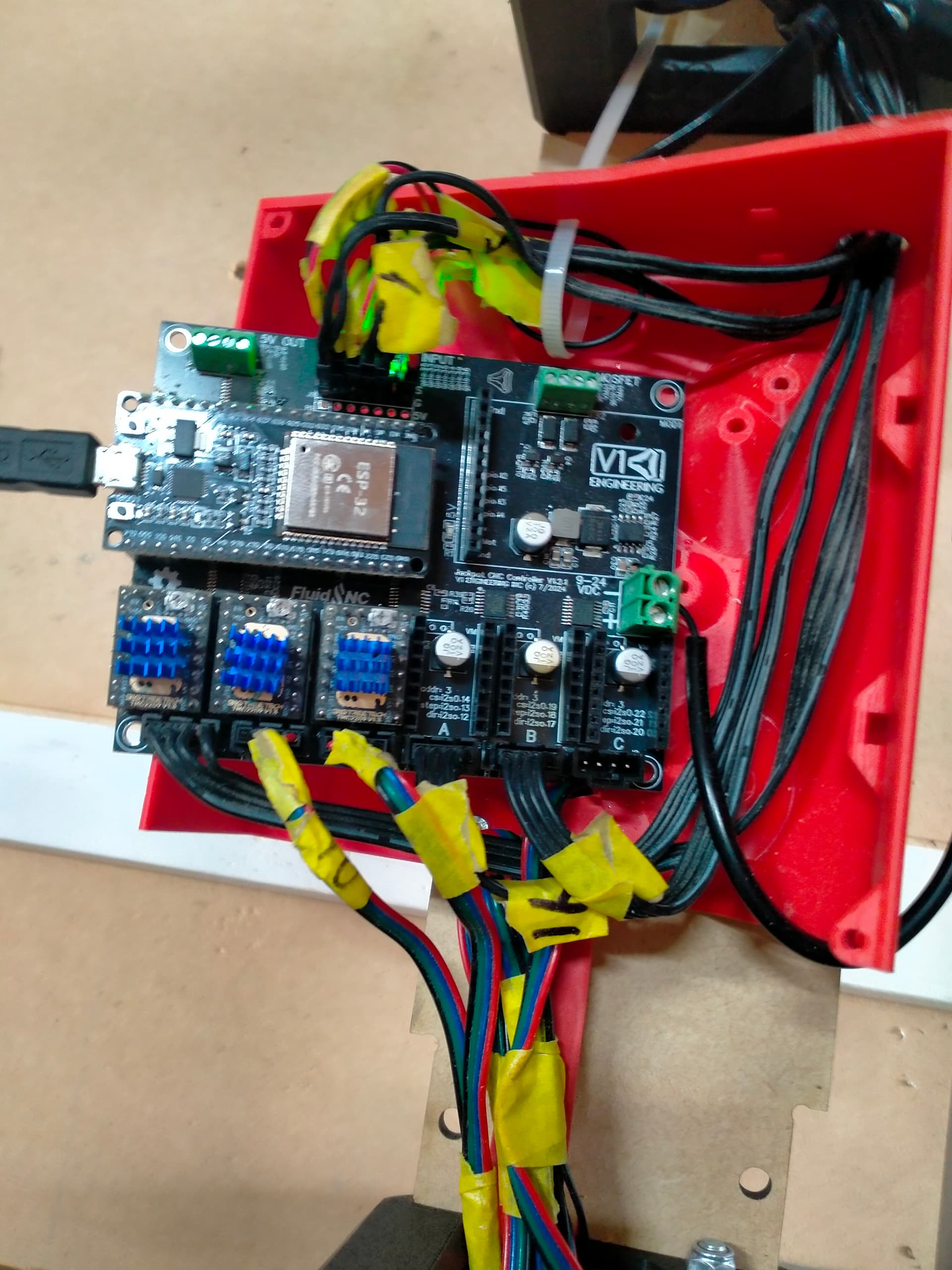

Power down remove the drivers from Z, A, B. Put the driver from B into Z leave the other two out and power up, let us see the $SS.
and it just keeps getting weirder
the esp wont register
even if i unplug from board and plug into laptop
fluidnc web installer cant find it , same usb cord ive been using all along
no sound from laptop that a device is connected
finally got it to connect

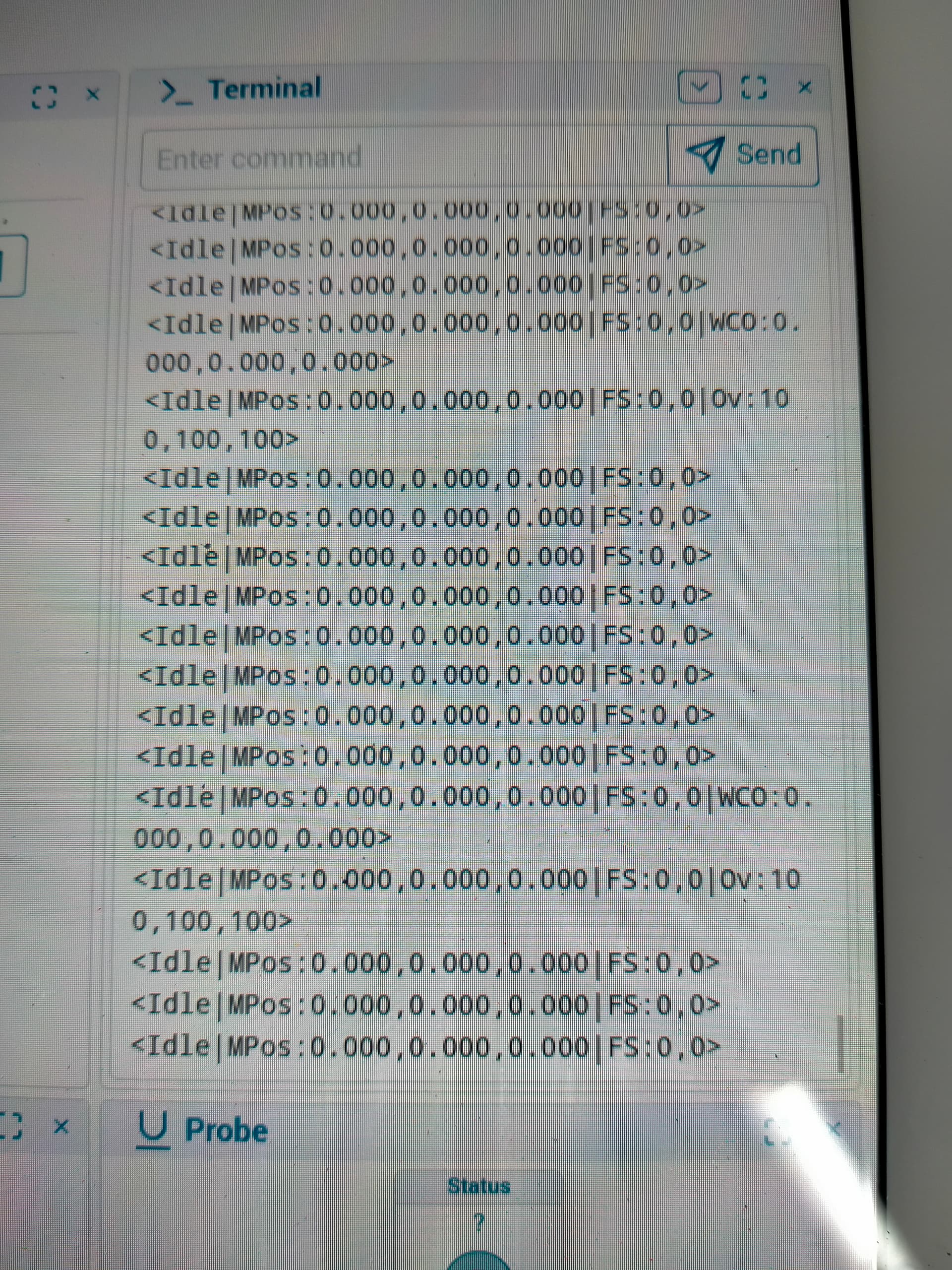

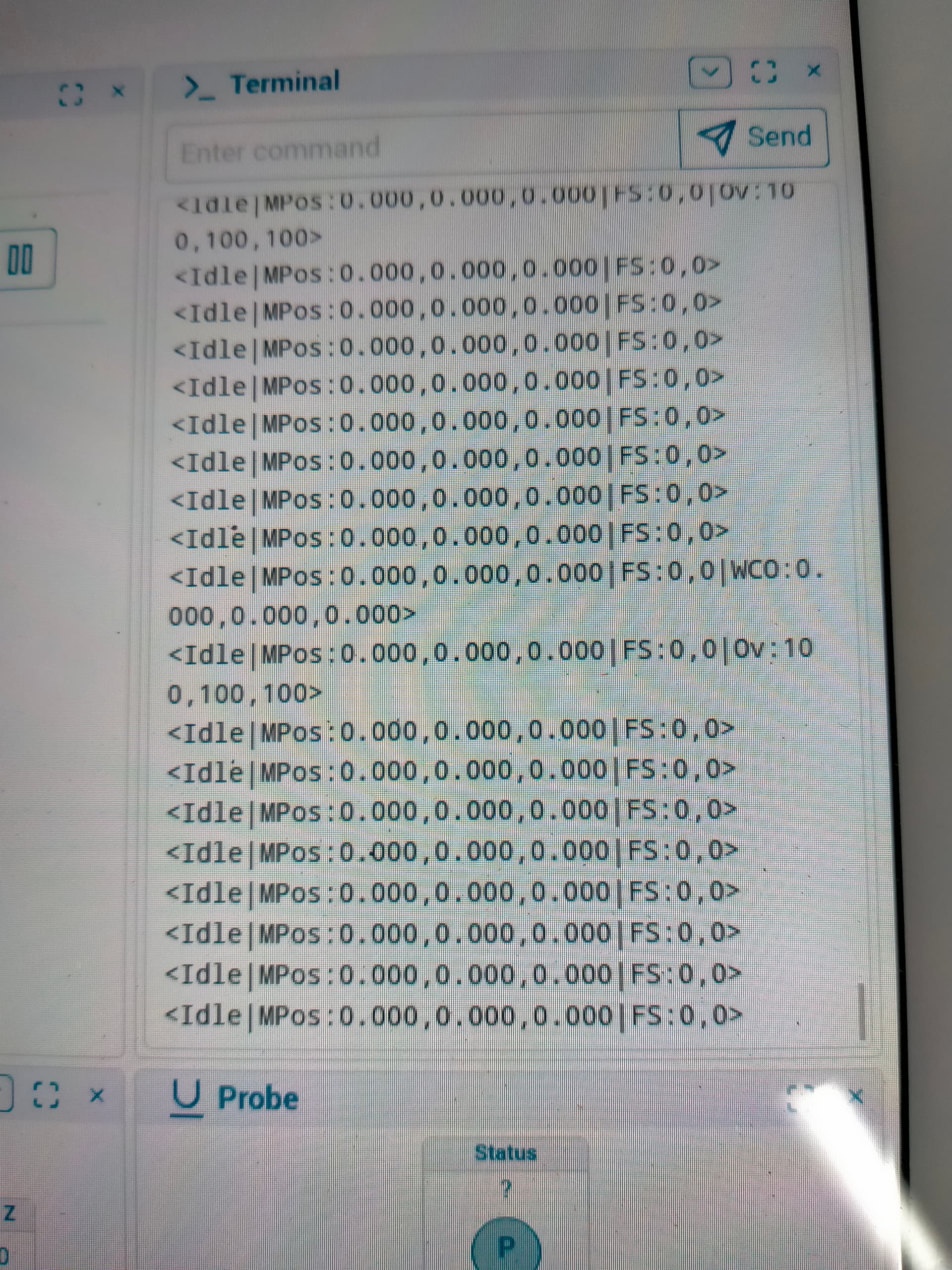

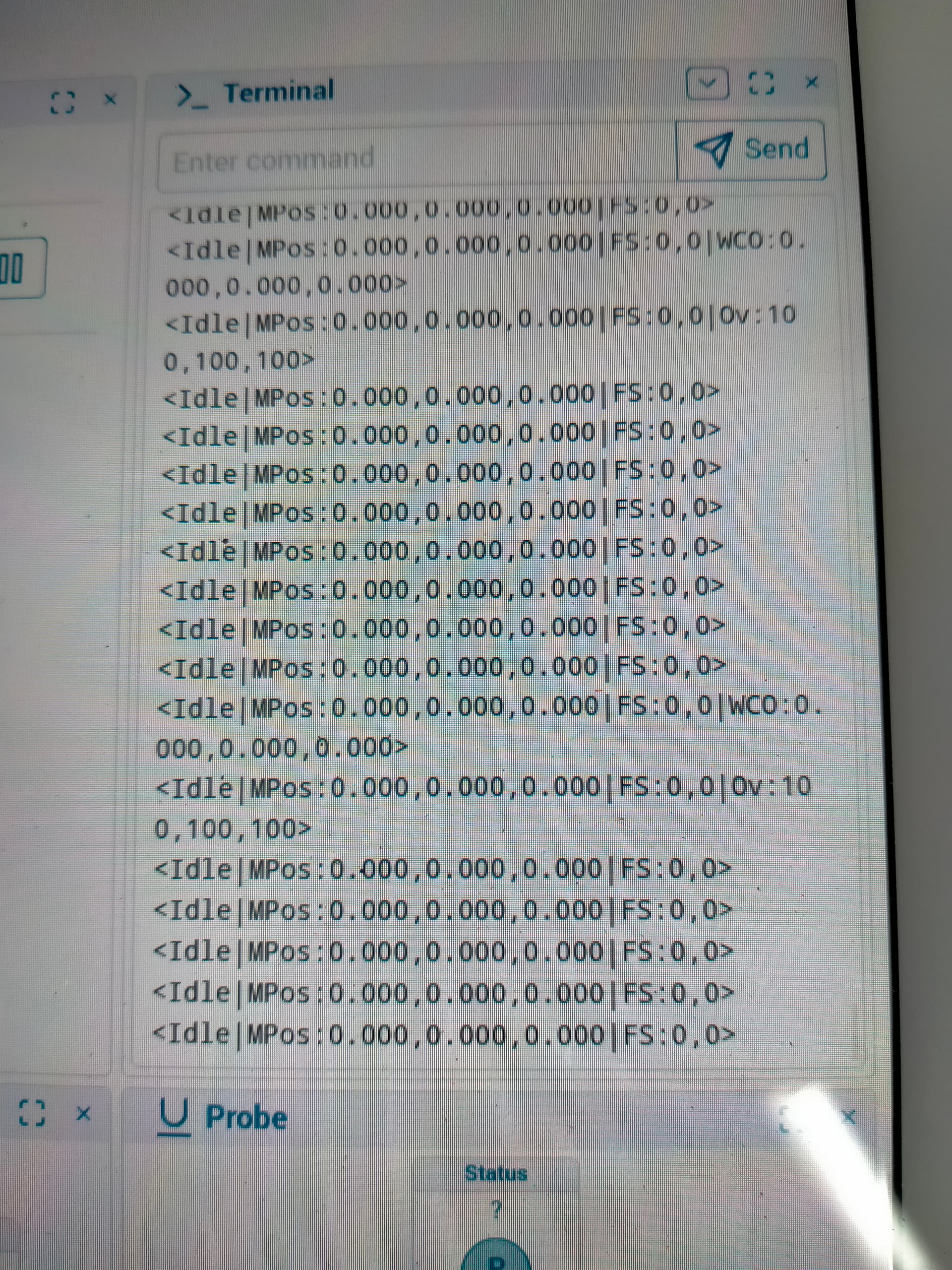

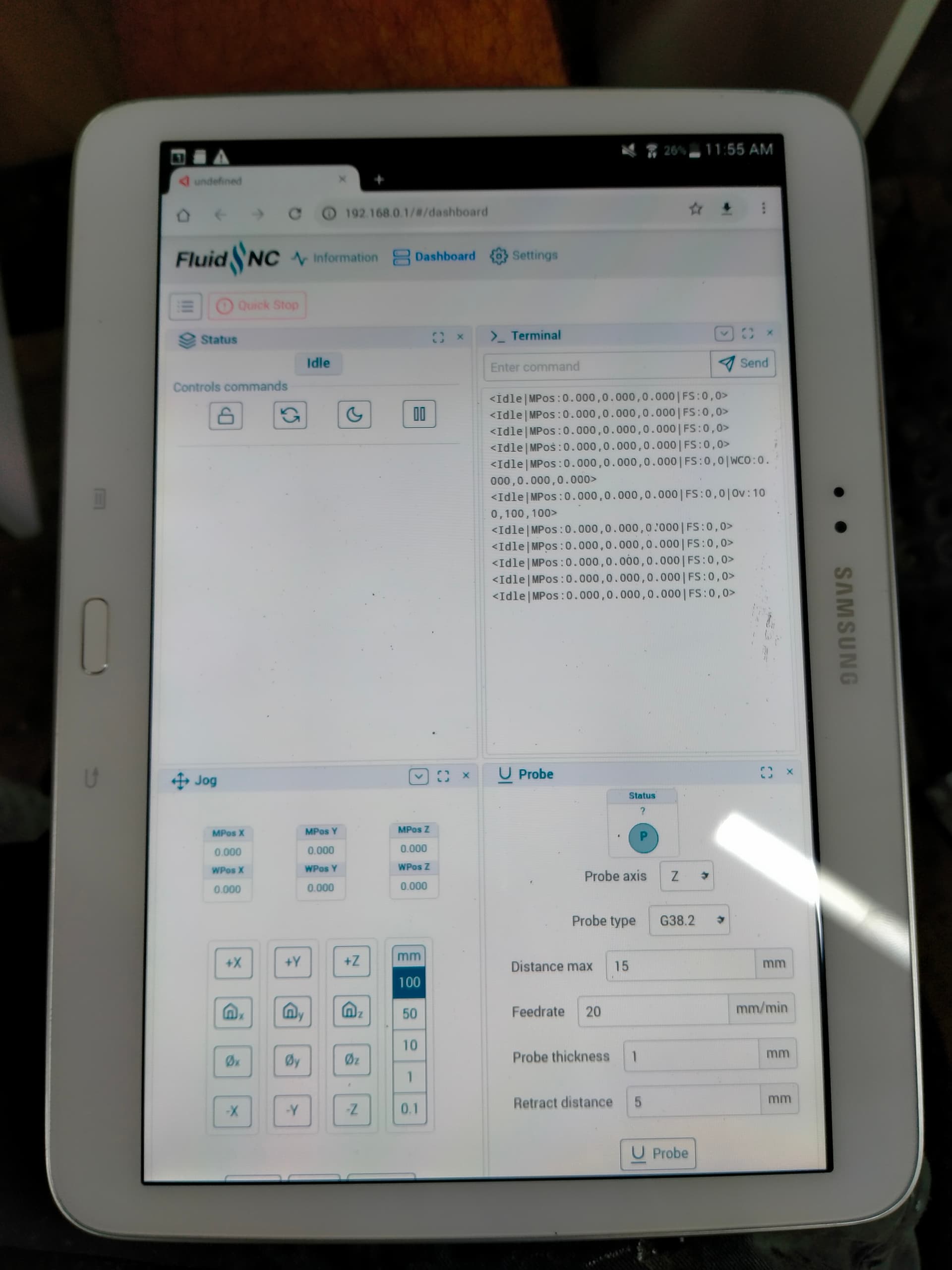

just logged in on tablet , yesterday it had the normal webui
today its got this ???, havent touched firmware on esp
and it gives me this
comes up with this in commands
just tried this

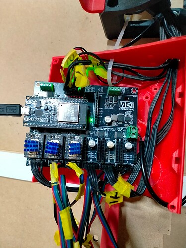

put a 2209 in c and plugged in each cable and the steeper’s energize and i cant move the the different axis
if i plug z into c it energizes and
Z is the only error now

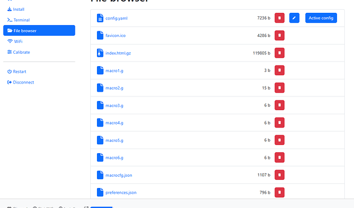

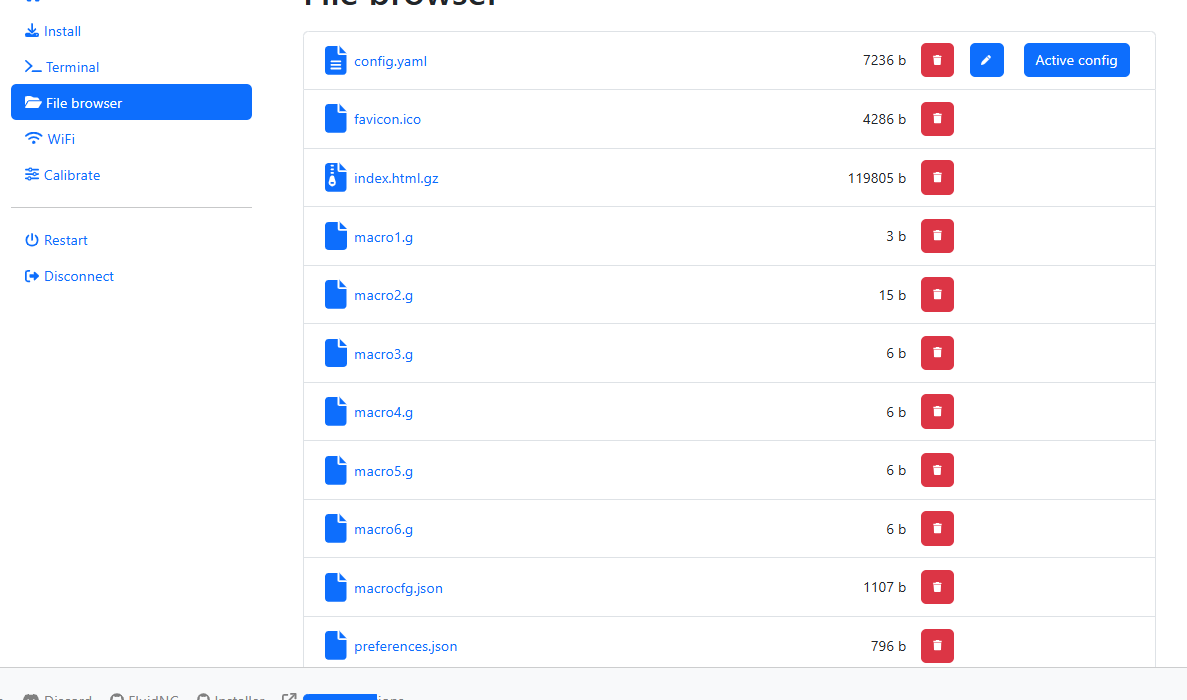

It looks like you’re back to this. Note that this means the index.html.gz file stored on flash was changed. It’s a relatively new feature of the web installer to have an option to choose this.
I’m pretty confused at this point on the rest of it so I’ll leave that one for someone else.
To help troubleshoot you can not keep changing the firmware.
You went from v2 UI to V3, back to 2, now you are on 3 again. PLease understand we can not help you if it keeps changing.
This was the last request. This should be done on V2 UI with all of the files I provide loaded.

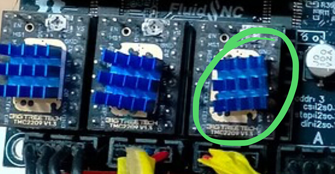

If the blue heatsink touches and connects the header pins together you could cause permanent damage.
They looked good earlier, but now two of them look pretty suspect.
You still haven’t created the config that Ryan asked for.
Power down.
remove the drivers from Z, A, B. (As marked on the Jackpot board)
Put the driver from B into Z.
Leave the other two out.
Power up.
Report what happens via $SS
Looking to test each driver individually.

No, it’s not. Your $SS clearly shows more than one driver is installed.
[MSG:INFO: Z2 Pos Limit gpio.34]
[MSG:ERR: Y2 Axis TMC driver not detected - expected 0x21 got 0x0]
[MSG:ERR: Z Axis TMC driver not detected - expected 0x21 got 0x0]
[MSG:ERR: Z2 Axis TMC driver not detected - expected 0x21 got 0x0]
Easiest way is to take all the drivers out with the power off one at a time put each one in the X slot and power up. Check $ss for every driver. We are trying to see if all drivers show functional.
new boards arrived , so have swapped it out , will worry about old board issues another time or maybe never haha
