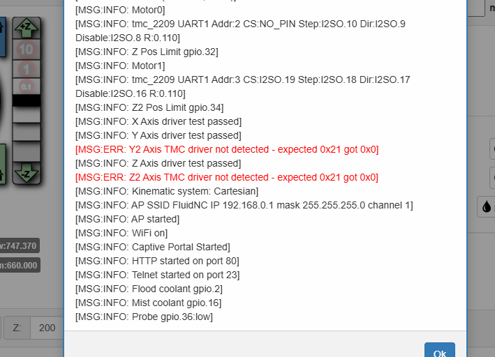

Tmc driver not detceted
was working fine yesterday
turned on today got these errors
have changed drives with ones from skr board , still same errors
stepper motors still have power to them as cant manually move y or z axis
have checked each driver in the x slot and all connect with no errors, so picking they are all ok ?
how do i fix this problem

X is the only driver that never faulted
is there a way to resolve why its not reading, is it main board ??
need it sorted asap , got a job to do for a customer next week
That is surprising. I would expect it to be consistent.
me to , so its got be something else causing them not to detect , but where to start,
spent couple hrs searching trying find info on prob shooting this error, without much luck
I’m really not sure. The only time I have seen those errors is when running FluidNC on the ESP32 not plugged into the Jackpot. It can also happen if you have a USB cable connected and that powers the ESP32 before providing power to the Jackpot. But then, it’s all the drivers failing. I believe that the drivers initialize fine even if steppers aren’t connected.

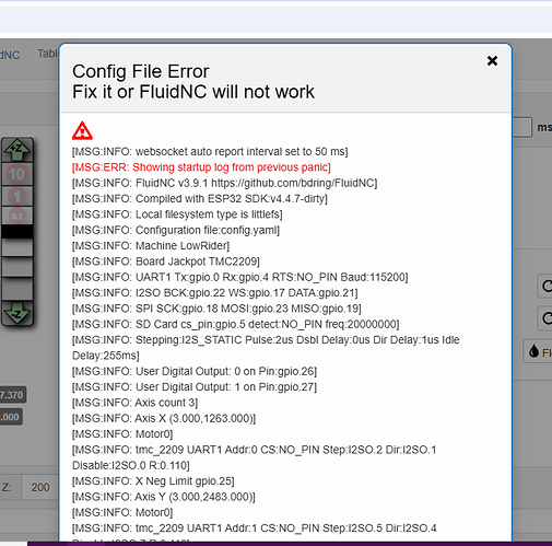

i did plug in usb couple hrs after and did full reinstall of fluid nc and reinstall config files to see if it may help still same problems. at a loss

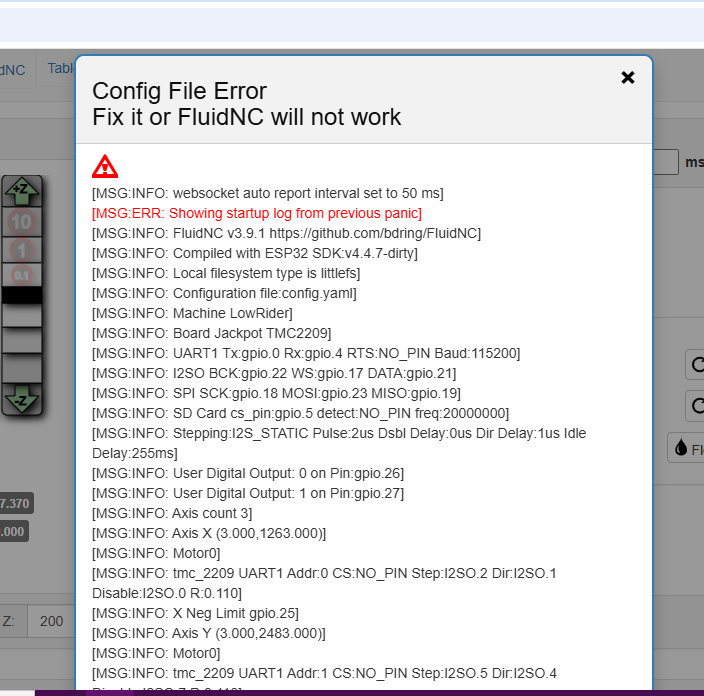

so things just got weirder , just gone out to shed turned it on and now cant even get the fluidnc Wi-Fi to register to bring up webui
unplugged esp from main board and pugged into computer , get windows message device not recognized, wont even show in fluidnc web installer . installed cp210x as read in another, post prior to reboot yesterday , think my esp might be toast

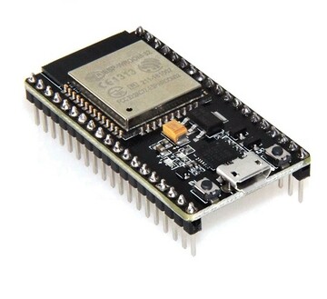

will either of these be fine as replacement esp

That’s a sign your ESP-32 may be toast, just as you suspect.
Do you have another one to test with? Are you CERTAIN that the USB cable you used is a data+power cable? (This bites people all the time.)
At this point, I’d verify you have a data+power USB Cable, if you have another computer try the ESP-32 there, and if none of that works you likely need another ESP-32.
Then we need to get some time with FluidTerm and $SS to see what’s going on with your machine.
pretty sure its got P on the cable , and it connected fine yesterday. ordered 1 of the ones in the post above, probably wont turn up till tue or wed so will wait just have to wait for it, looks pretty close to one on board its 38 pin , so many to chose from , hope its same as existing

You want me to wait on shipping the new board? Until you test your new ESP? If all the drivers tested good and all the ports work, even if they are random that seems like a ESP board will fix it.
Hey Ryan
nah get it sent ,
I have a job which is time critical on completion.
just with the random hiccups i’ve had so far,
having a spare board in cupboard, will be peace of mind
yip its toast same message on another computer
