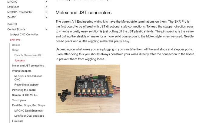

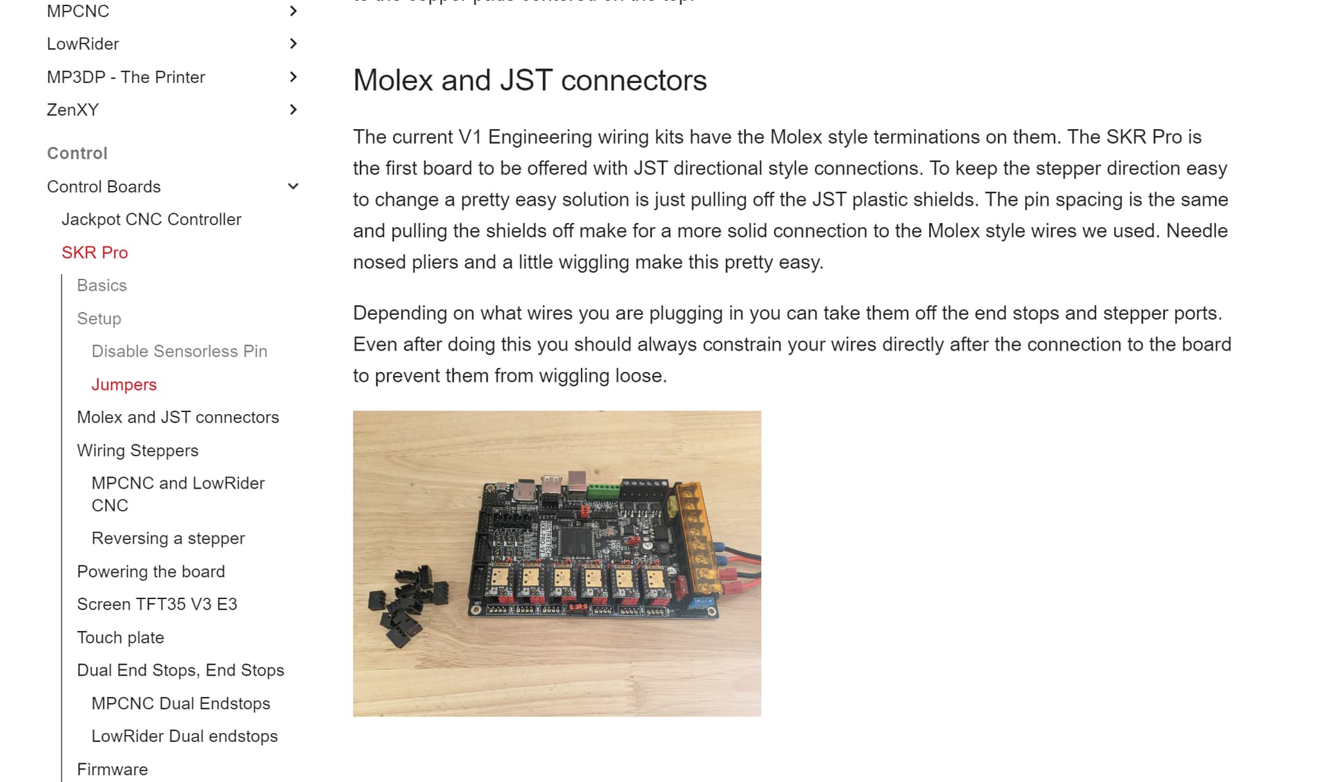

Have you removed the plastic connectors from the board?
Once you do this they connect MUCH better and stay on no problem
The easiest way is to make sure the cables are strain relieved somewhere relatively close. That way there’s minimal mass of unsupported cable to move the connectors. I usually aim to try have cables tied off somewhere within ~100mm of the connectors, but closer is better.

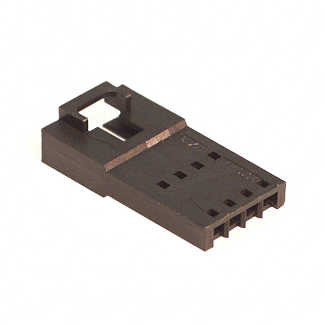

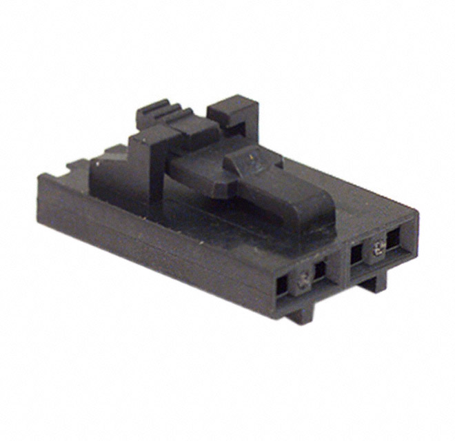

Female locking Molex 0050579404
CONN SOCKET 22-24AWG CRIMP for Female Molex
Male locking Molex 0701070003
CONN PIN 22-24AWG CRIMP for Male Molex
The female connectors lock to the connectors mounted on the Jackpot and some of the other boards.
I got the connection sockets and pins listed because it was in stock at the time. Look at the spec sheets for the wire gauge you need and each has 4 choices of plating and 2 choices of reel or loose for each. Something should be in stock.
