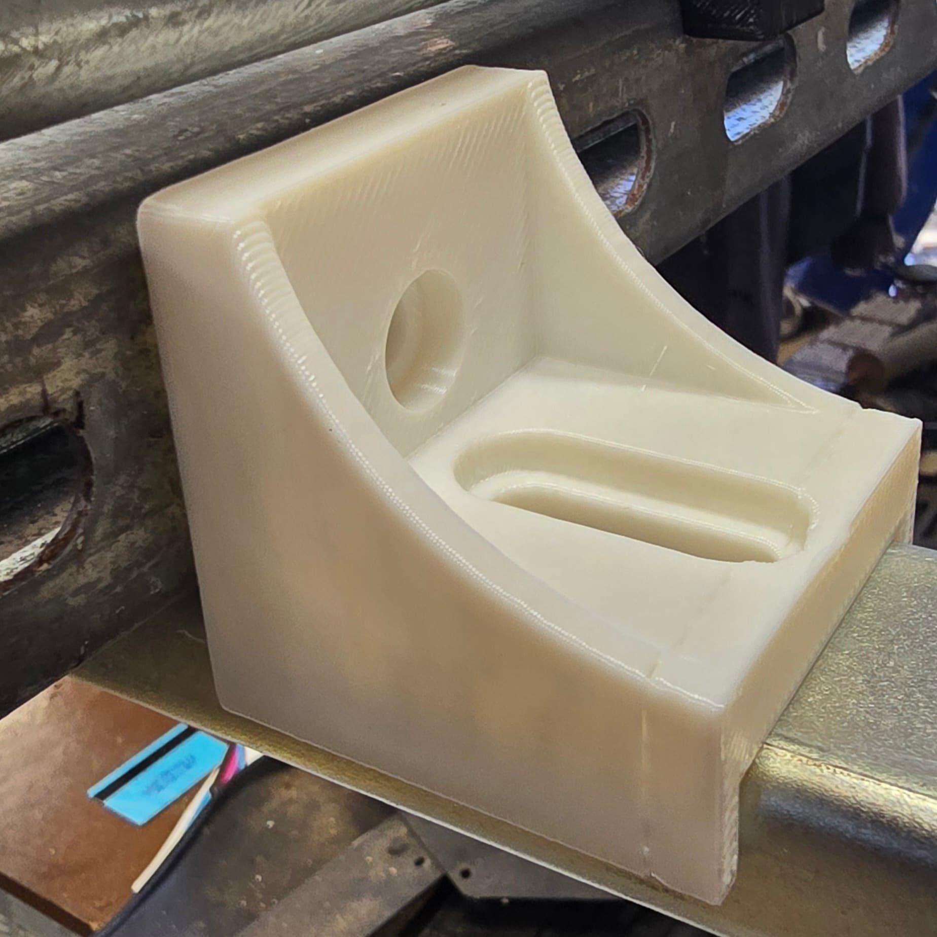

Time to see how bad I can mess this up
How is this not in the official build? So much nicer than trying to adjust them by hand!
The official build is such that the lead screws don’t protrude enough past the YZ plates to have room for these. You need to have the screws another 10mm or so in order to fit these.

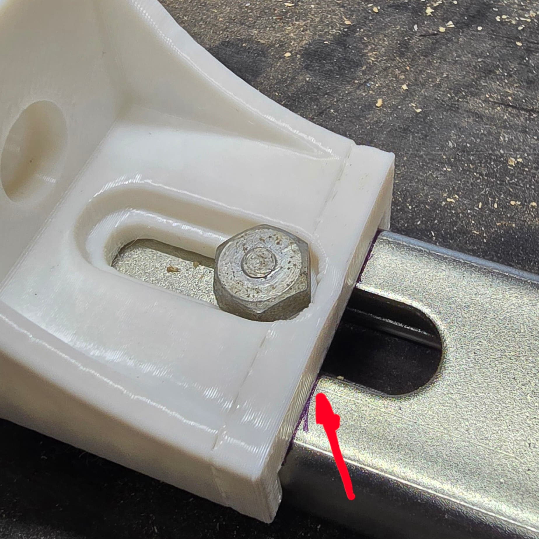

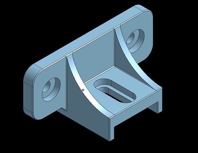

First one printed off to test my measurements
Measurements are good so this is the second version that hasn’t printed yet.

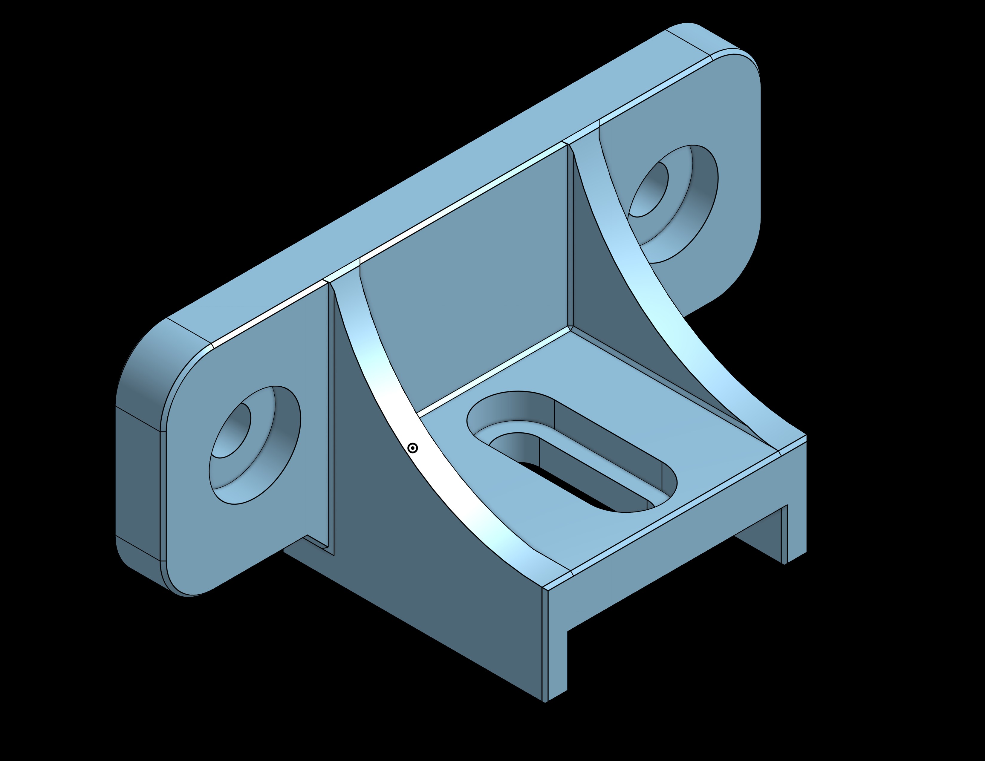

The real question is if I’ll have enough room between the two sides for a full sheet of spoil board with these brackets in there. They are beefy to hold skew at bay, but only 10mm tall where the spoil will be so that means they will be below the surface of the mdf. The good news is there won’t be any damage to the router if it hits them. The bad news is, back to drawing board
I do have room to cut new x rails and make the gantry span a couple extra inches to make room for the connection blocks. I could (as suggested from another member) notch around blocks in the spoil board.
I guess only time will tell.

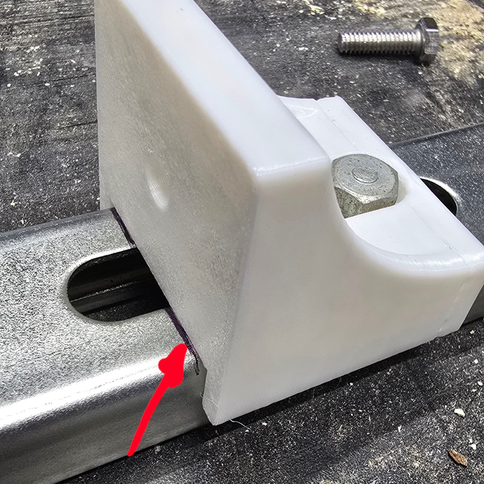

With the exception of the router hitting it, I’m going to call this a win.
Slot on the bottom allows for adjustment along the bottom rail.

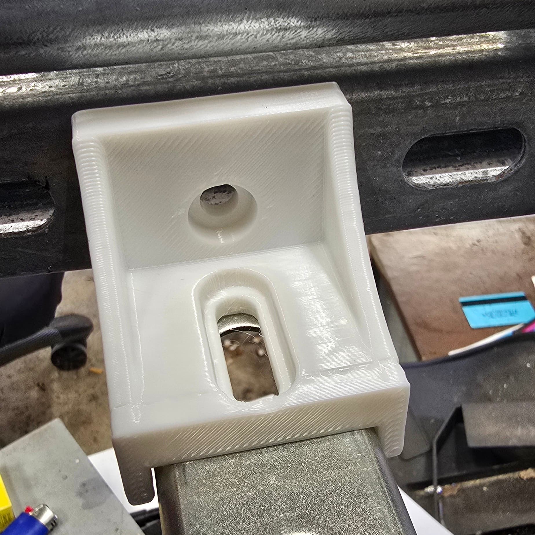

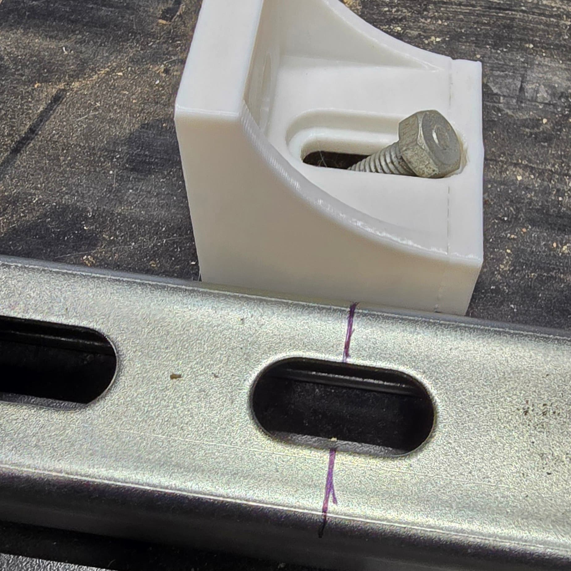

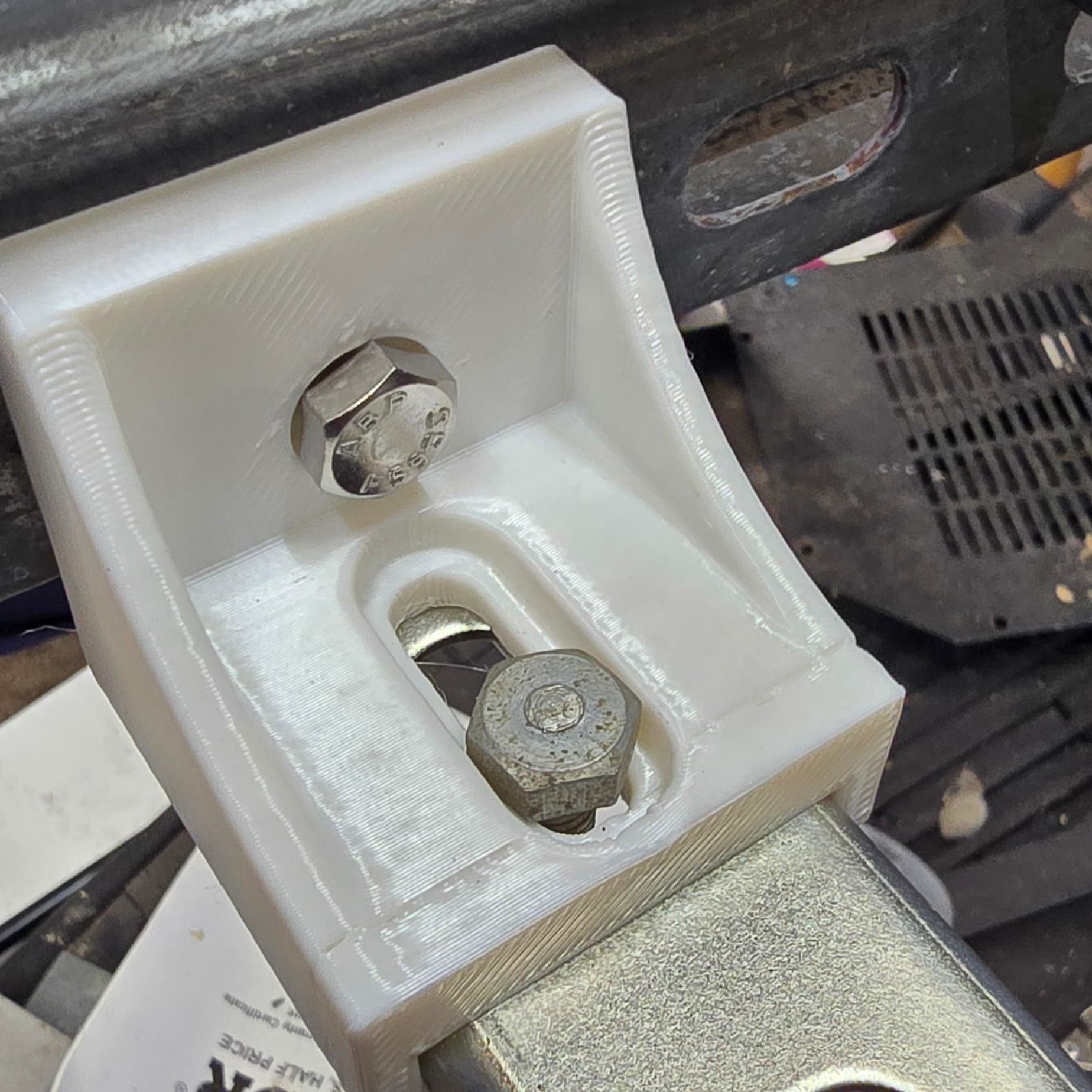

M8 Bolts fit, washers and lock nuts on the back. Now i just need to reprint this and 7 more like it when i get decent pla. Shipping says tomorrow.
Basically if i was using mdf, i could easily just move screw locations to get the machine set up correctly. With steel i lose that easy adjustment and fine tuning. These just give me that little bit of tweaking to get it right. Once its in place it’s the same as everything else, it stays put.

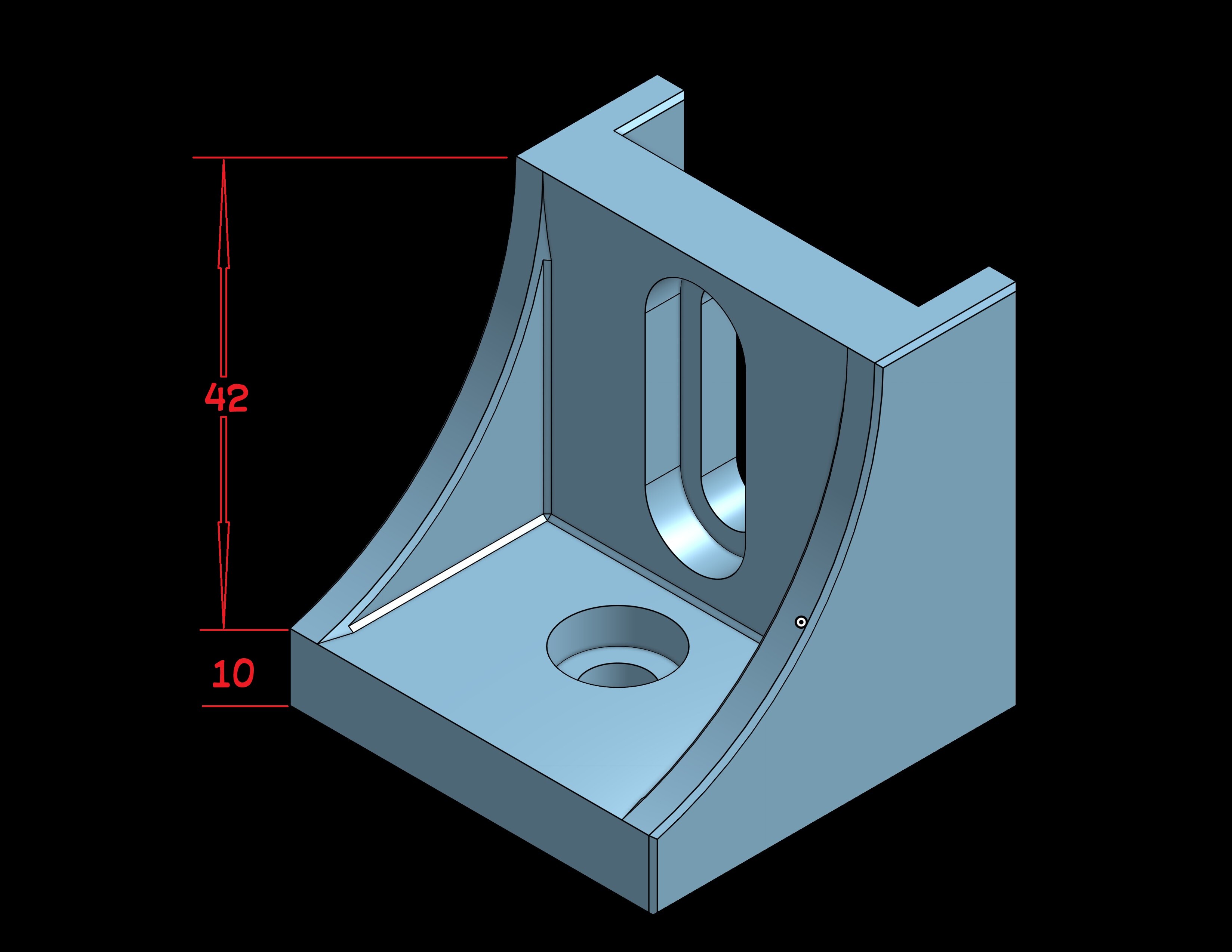

52mm as is, but they can probably be shrunk down a bit. The distance they come out from the side rails is only to support the slot for the bottom rails. I’ll have to play around with them and a bolt to see how much of that slot can be removed. Every mm saved will double because one bracket on each side. The flats that touch the two rails are currently 10mm thick and have a bolt counter sunk 5mm. If instead of counter sunk, I just left it flat, I could cut 5mm off the total distance towards the spoil board.

I went steel because steel on steel, I can weld if needed. Decided on these unistruts because they have all the holes in them already so bolting the MDF down is going to be less work.
Side note: These brackets will work on the 14g or the 12 the same because the back side with the holes is the same between the two different variants.

After testing i don’t want to shorten the size unless i have to. The way it is now allows for 100% freedom. Max in one hole lines up perfectly with min of the next hole.

I think I like this version a little better. I’ll have to test it when my pla gets here, but the basic idea is to hold the two sections square. Everything still fits the same on the bottom section, but it holds the side rail flat to itself and hopefully that will give me square.
