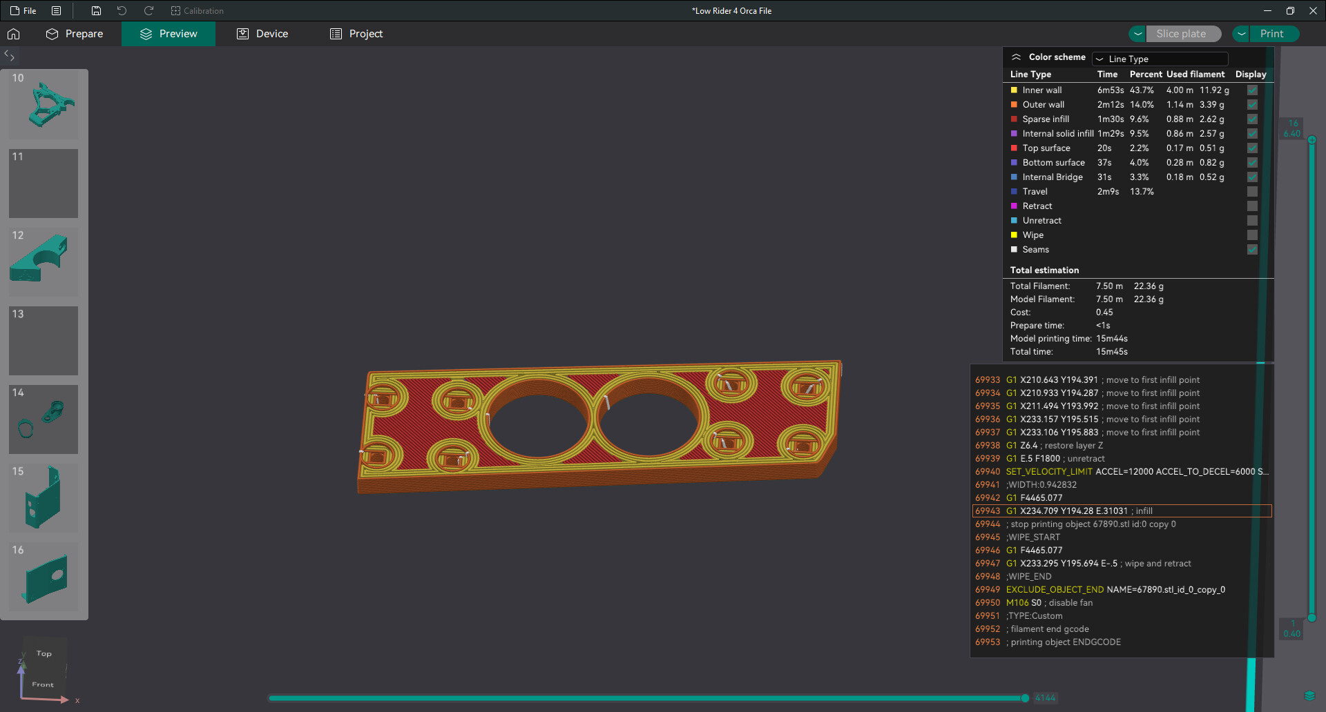

Sitting here watching my core print and it dawned on me that Im a moron.
The print settings are matched up, but I clicked “inner-outer-inner” to get better dimensional accuracy. I’m printing my layers (adaptively) up to .48mm thick. How accurate can I really get? Instead my overhangs and such arent quite as good as they could be if I was smart enough to just leave the stupid thing on “inner-outer”

All 4 parts printed the same, and the two blacks were the same roll of filament. For some reason “front wheel min” (middle of the picture) curls upward on the overhang and looks like crap. The other 3 came out very good. I’m open to suggestions. This is my 3rd try and still junk.
.6 brass nozzle
Adaptive layers on (.15-.48 depending)
.8mm outer lines
.9mm inner lines
Speed controlled by max flow rate set to a very conservative 25mm/sec³ (machine tests to just under 40 before any issues on .4 steel nozzle)
That is inadequate part cooling and/or too hot and likely too fast. One thing you might want to try is printing two of that part at once, and fixing the cooling.
Even with the other 3 printing well? I wasnt clear about that so i went and edited that post.
Yes, that is part cooling. Out of curiosity, what orientation was the middle part’s bad surface compared to. your cooling fan?
I have one older printer that has a “great” side and a “crap” side for cooling airflow and on that particular machine I have to orient the part so that overhangs are getting cooling air from the “good” side or results like that happen.
Do an experiment for me, print that part 2 or 3 at once, and turn the orientation of the part 90 degrees or so per part as a means of troubleshooting this.
I tried the rotate trick. Overhang used to point right. I tried front and back. I had the same idea. No noticeable change.
Got a good print finally and not sure how i did it. I adjusted line width, layer height, overhang percentage of each line that makes it slow down… it was starting to warp again so i went on mainsail and made it do 50% print speed. It corrected itself with just a pause and snip of the corner where it started to curl.
I don’t know if it’s the overhang itself that was too fast or if the rest of that area in the same layer needed to cool more so it didn’t pull on the overhang. Looking at the slicer, only that one line that is cantilevered slowed down. When i set the whole print to 50% everything slowed down. Would be great if i could just adjust my overhang settings, but it seems like i would have to adjust the entire wall on that side.

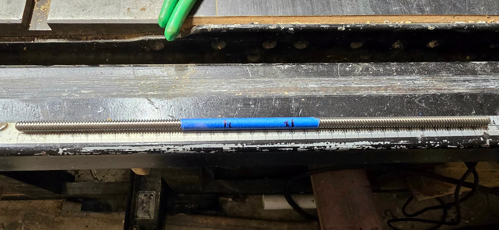

Before i cut this, it’s 350mm long and i have it marked for 150mm sections so I’m a touch over the 145mm minimum. Is there anything i might want to cut them longer for? 175 minus ½ blade kerf is the longest so it’s not going to be jack and the bean stock. But it’s there an advantage or use mod that i might want to leave the extra 20mm on the ends for?
