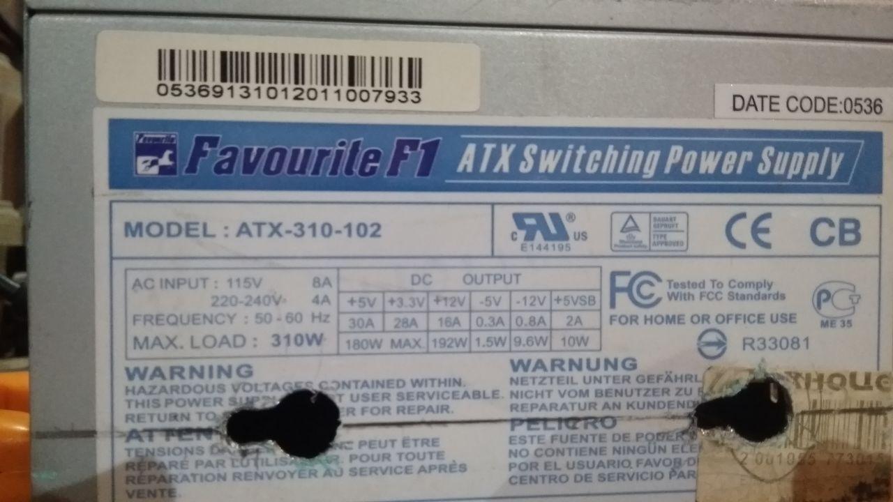

Arduino Mega 2560, RAMP 1.4, Stepper motor drivers A4988, 17HS4401 engines. When checking the movement along the axes of the motors, the contrast of the screen often drops and the power supply is rebooted. The reference voltage on the drivers is set to 0.95 volts.
Maybe the computer power supply (characteristics on the attached photo) does not pull?

One more observation. The reference voltage of the drivers was reduced to 0.7 volts. If you move the motors in one direction through the controller menu, then everything is fine. But after the movement, the current on the motors remains. And if you move all the motors, the screen dims as if there is not enough power of the power supply.
A lot of those old ATX power supplies don’t regulate the 12 volt rail well (if at all) unless there’s some load on the 5 volt rail. Might be your problem.

Most likely it is still a power supply. I tried another power supply, there are no such problems. But there was another problem, for some reason, when sending home the X and Y axes, the controller stops with the message “Printer HALTED”.
