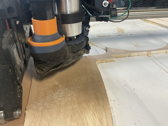

I’m using fabrics tape as a skirt and it’s working quite well.
IMG_2315
IMG_2317
looking forward to that outcome!
fwiw, I use plastic that one tends to lay inside a kitchen drawer to protect the inside. it is both flexible & stiff enough. Obviously took the idea from @Tokoloshe

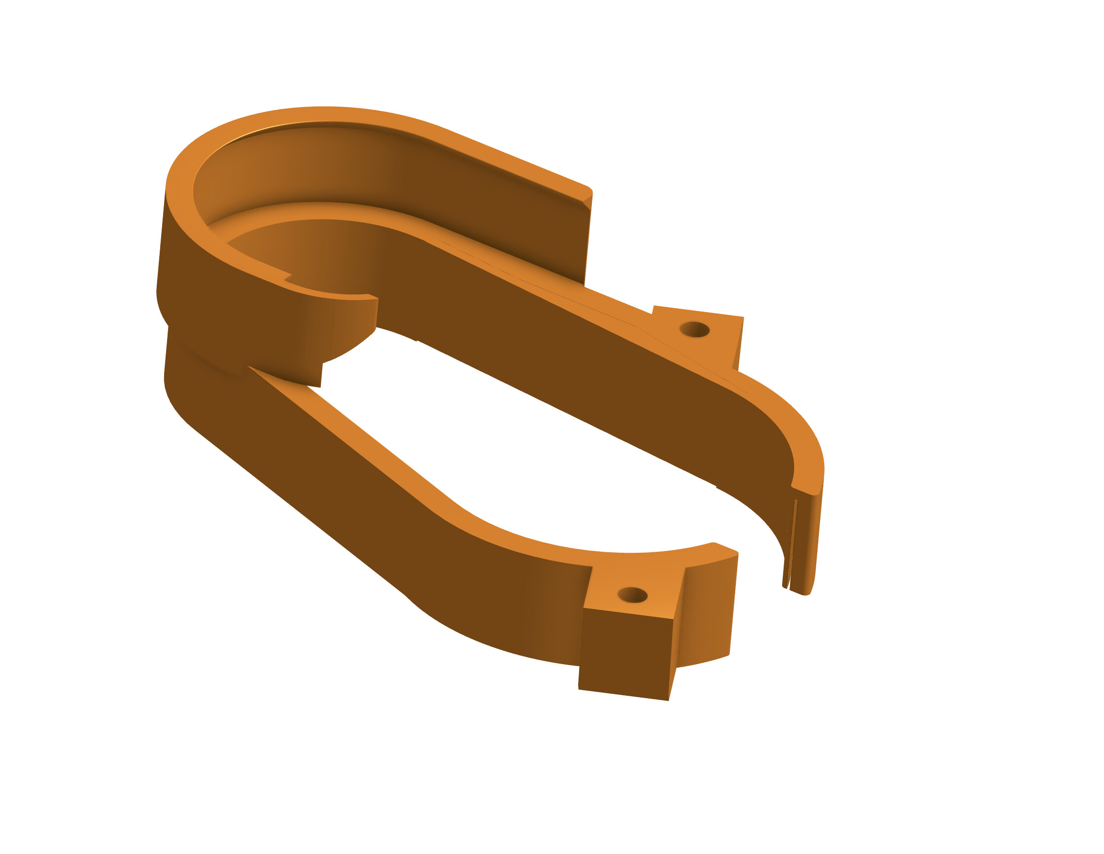

I’ve seriously contemplated it and last night I decided that’s the way to go — but only after looking at my already printed prototype with the bottom opened up more, yet not all the way. And mine has pretty much a full lid on top — for ze floating Zed! :blush:
PS: this is for a “bristle” approach with floating Z — and my plan is to use craft foam for the bristles.

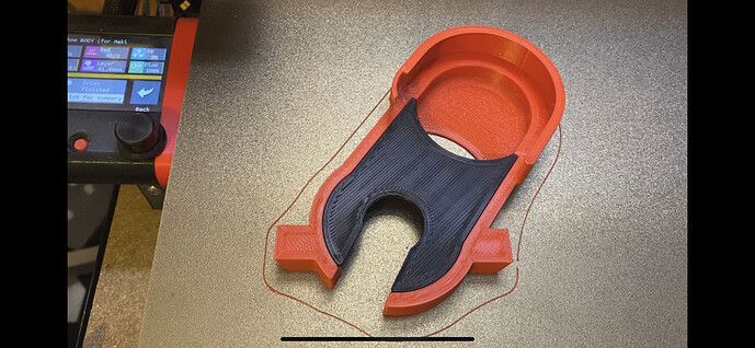

This image shows the groove where either bristles or craft foam [or TPU printed bristles] would be inserted:
You can print it thinner or thicker as needed.
