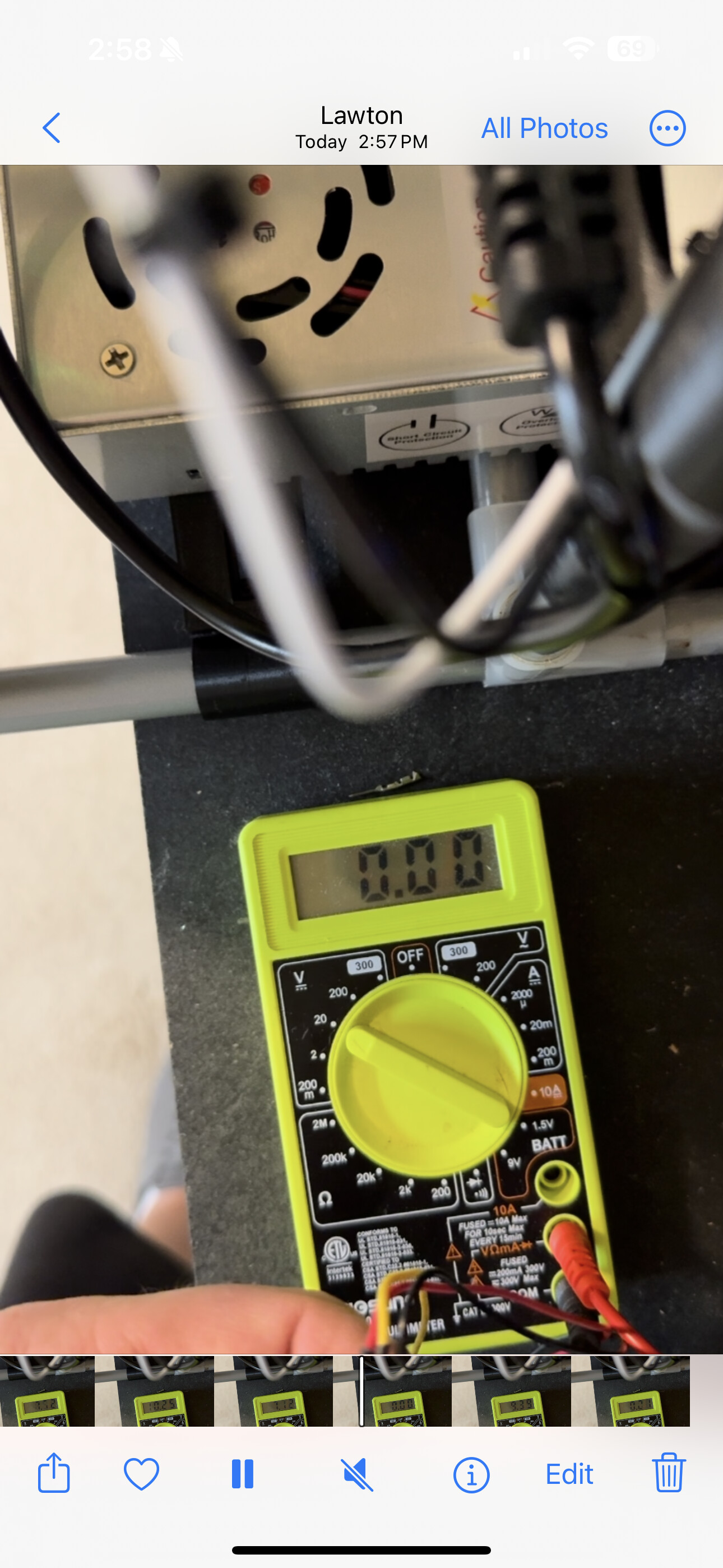

The last thing I can think of is to hook the potentiometer back up but to the voltmeter to check the output it’s sending over its full modulated range. Maybe my documentation is shit…
Well, in the meantime at least she moves and can draw things with a pencil… and the laser is on the way. More wiring problems to come!
UPDATE

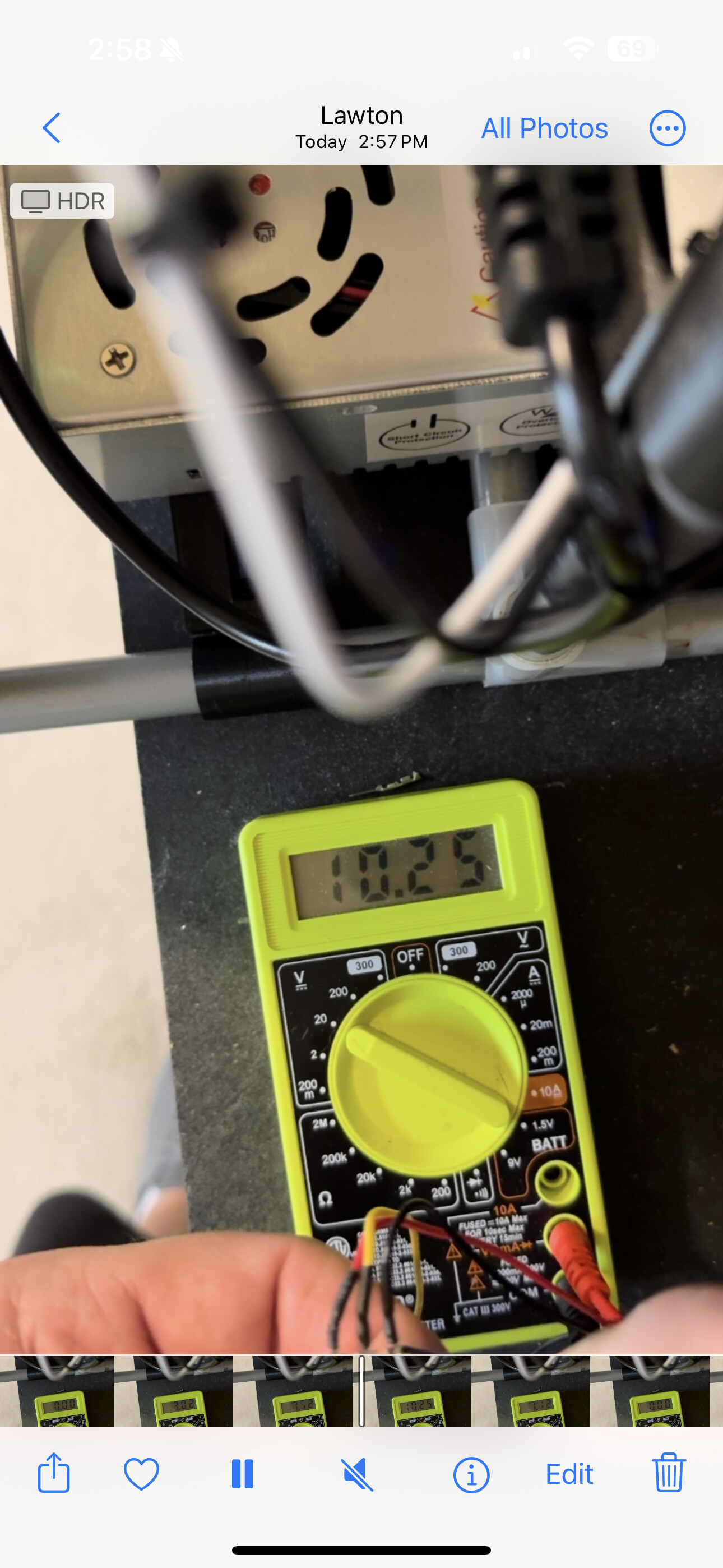

Nope, the potentiometer is sending from 0.00 to 10.25V down the line… what the actual hell?!
I reconnected the potentiometer using the wiring for the Jackpot 10V and ground with a hot plugged into the speed readout line and it fired up under manual control… plugged it into the jackpot and FAIL again…

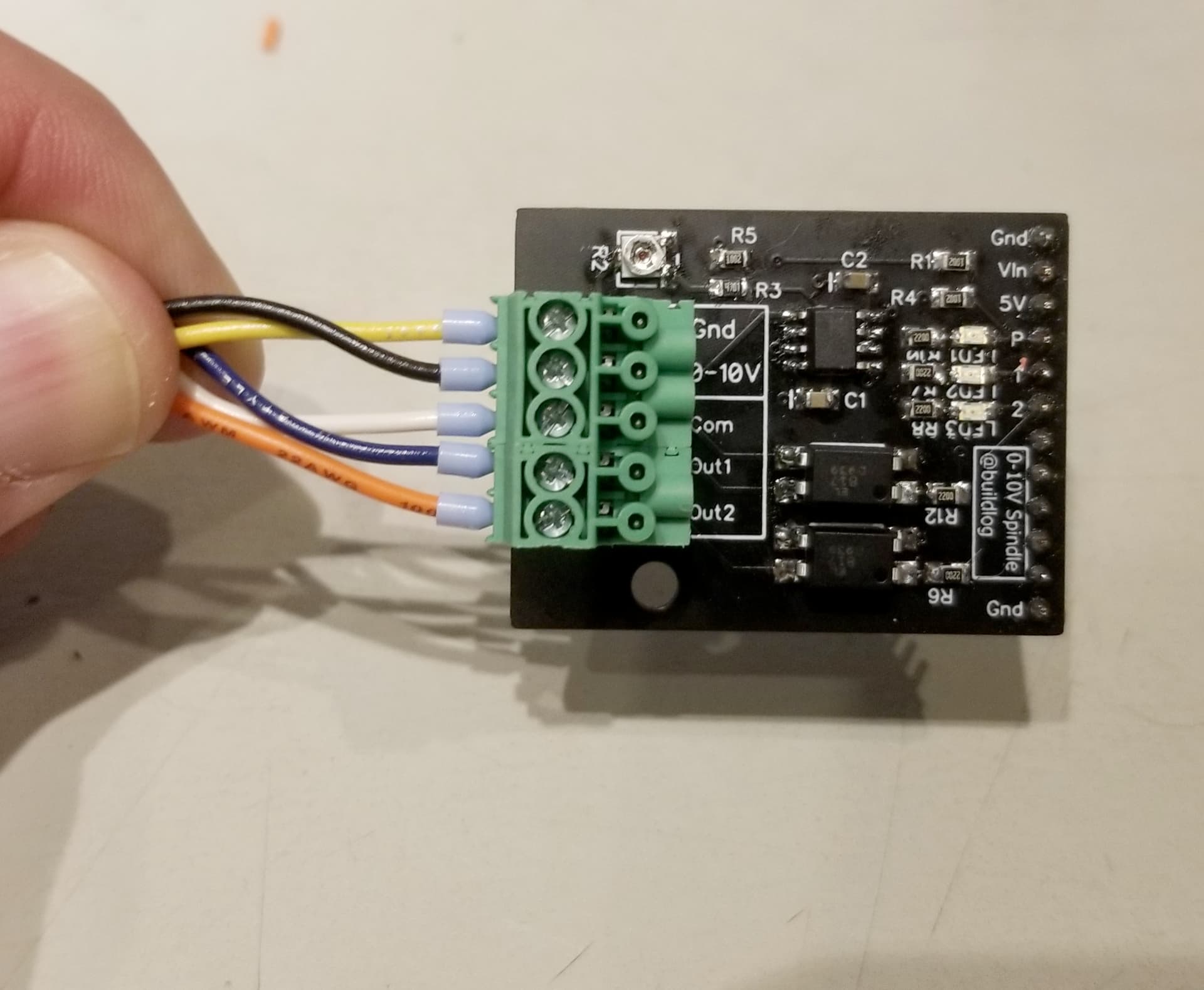

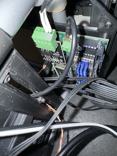

10V:
output_pin: gpio.14
forward_pin: gpio.13
reverse_pin: gpio.15
spinup_ms: 0
spindown_ms: 0
tool_num: 0
speed_map: 0=0% 6000=0% 12000=100%
pwm_hz: 5000

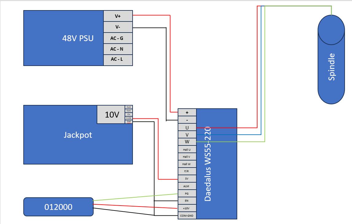

Can you provide a picture and schematic of how you have this hooked up?
The Jackpot 0-10V signal and return should go to the spindle controller signal and return.
There’s a chance you may need to tie Jackpot VMOT return to spindle power supply return- but that would be unusual.
All your spindle controller should need is it’s return connected to the jackpot 0-10V module return, and then spindle voltage in connected to the jackpot 0-10V module output.
This is the diagram from the manual:
I added the wiring for the digital tachometer as well, but I’ve tried it attached and unplugged and same response. Works fine with Potentiometer, doesn’t work at all with Jackpot PWM.

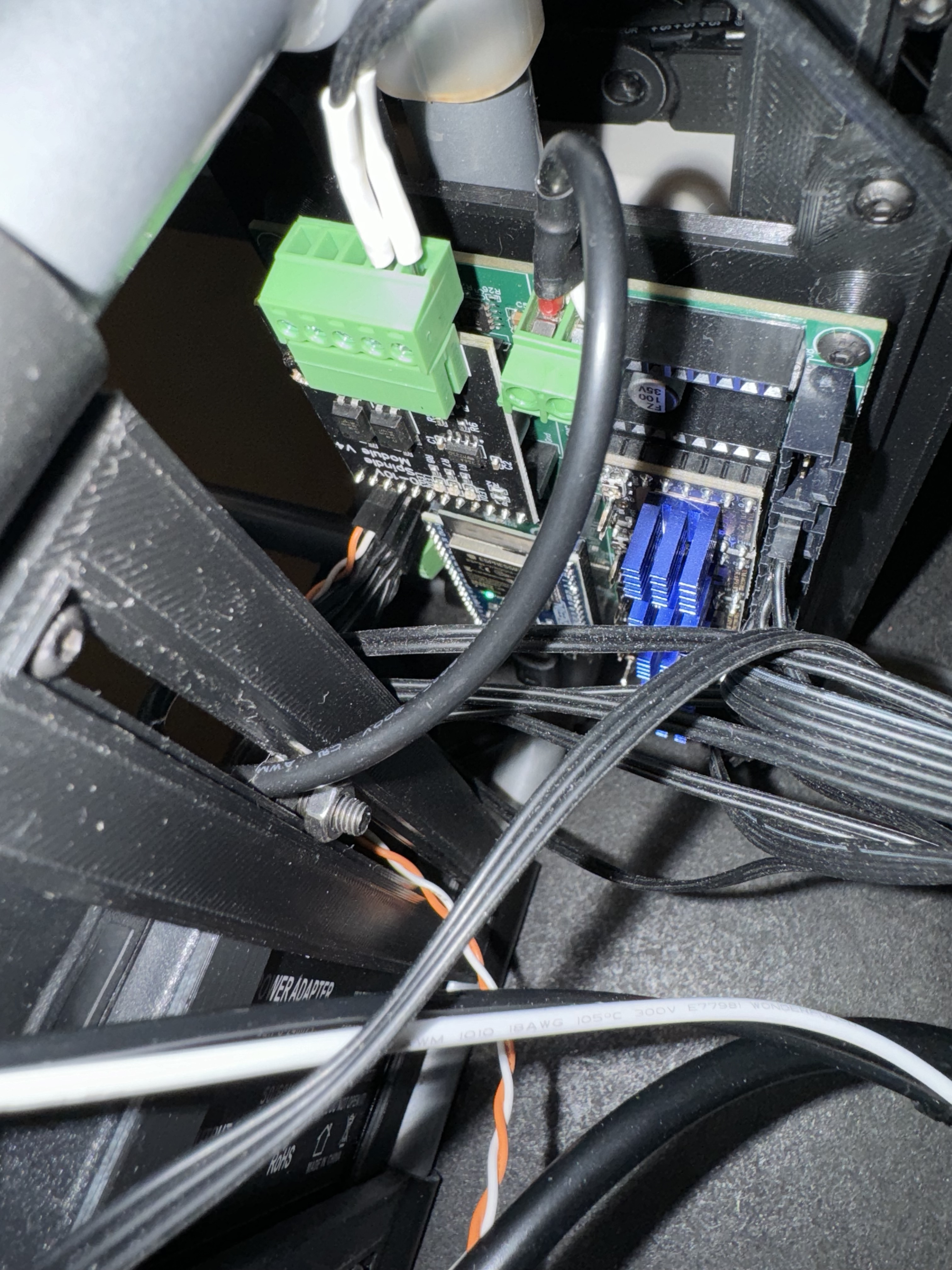

This is my Jackpot connection:

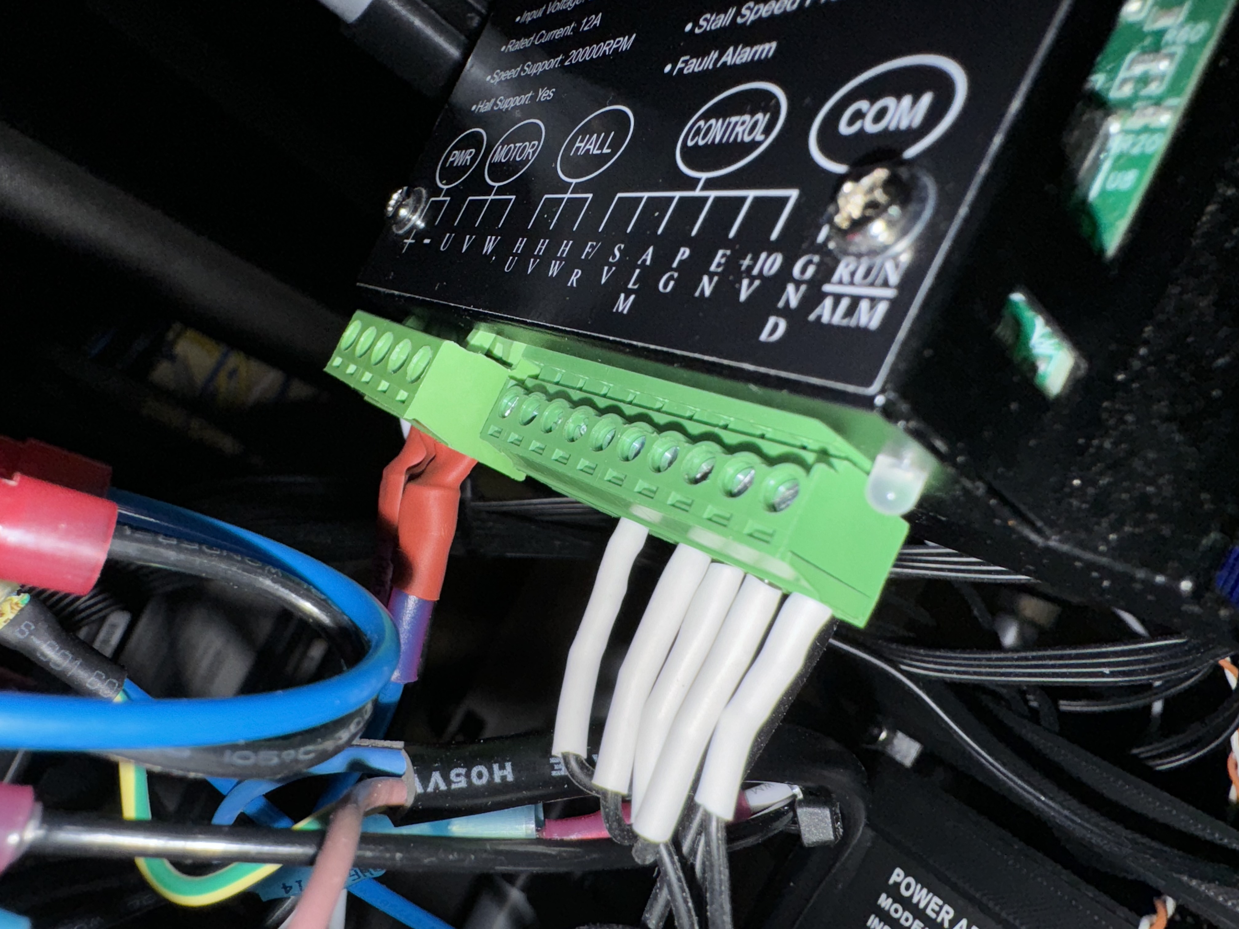

This are the Driver connections
I need some more detail.
What is the item labeled 012000?
When you hook up the potentiometer, how was it wired in?
Since you’re getting 10V out with M3 S12000, then the jackpot side is working correctly.
This means it is either a grounding problem or a hookup problem.
Edit to add: what is EN? Is it an enable? If so, grounding it may be telling the spindle controller to disable the spindle.
That’s the digital tachometer
It plugs into SV, +10V and COM-GRN
That’s where the power switch plugs in for manual control, for PWM control they just have you jumper it to force it to always be on.
So, it’s really an /EN signal.
Last thing I can think of for you to try then is to jumper that Jackpot incoming VMOT RETURN (ONLY!) to the spindle PS -V connection.
Double check something for me:
In the image above, Com is the DIGITAL ground, Gnd is the 0-10V signal common ground.
It should be the top (Gnd) signal and the 2nd (0-10V) signal that go to your spindle controller.
Confirmed, using Gnd and 0-10V.
Com, Out1 and Out2 are not in use.
@MakerJim you think maybe I need to connect the Com on the Jackpot to the Com-Gnd on the driver?

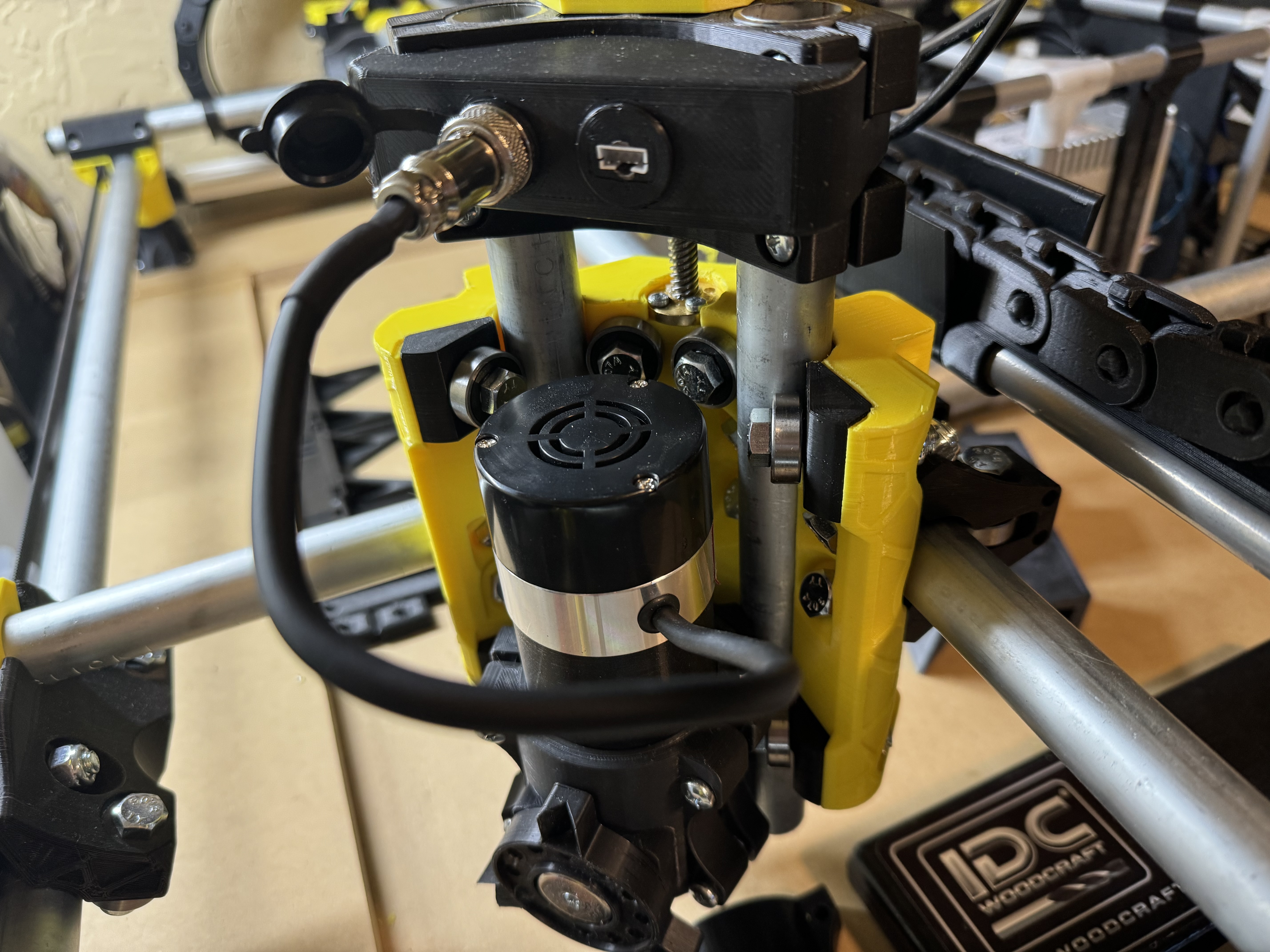

Still going nowhere on firing the spindle up via PWM, but got some work done today.
Added some quick connect plugs for my spindle and laser and ran brand new lines with no splices to the back panel of the controller box. I may print up a cover plug for the JST-PH 2.0 connector or just stick a blank plug in there when the laser’s not hooked up to keep the dust out.

I actually did this already, the potentiometer ranges from 0.00V to 10.25V when wired in. The jackpot output maxes at 10.00V (after calibration) at S12000 and then scales down to 0.00V at S6000 due to my speed mapping
