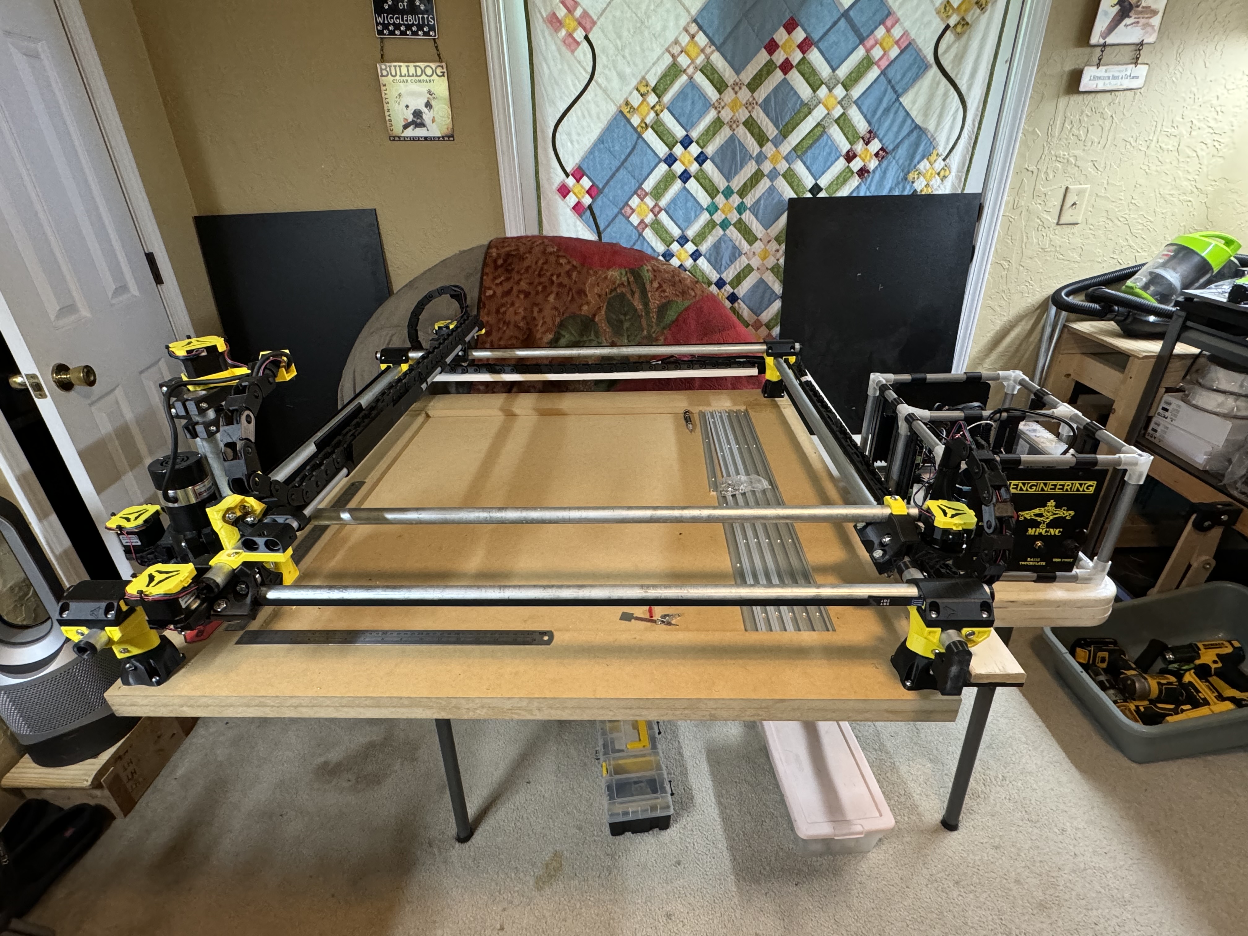

The Summer MPCNC

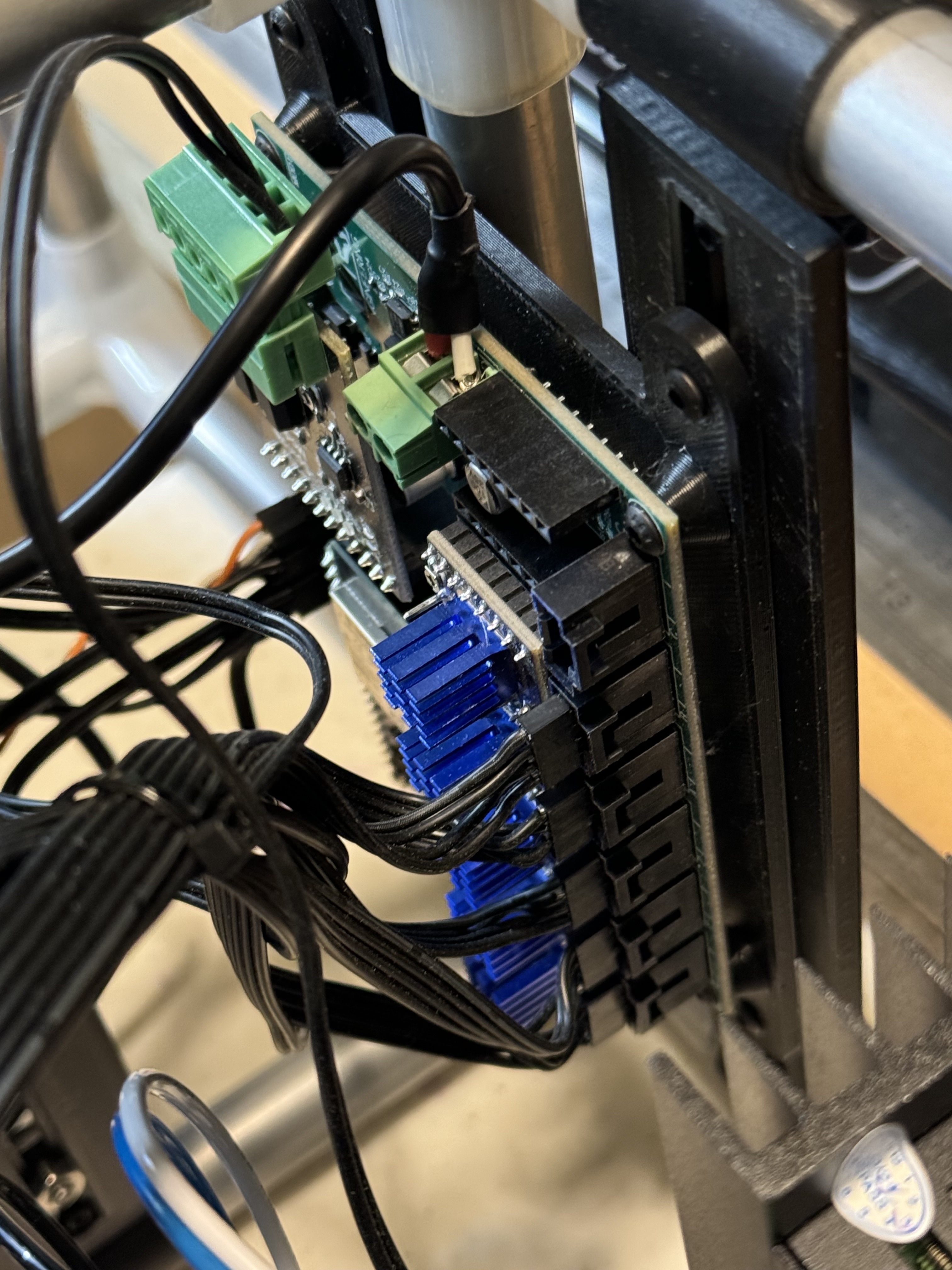

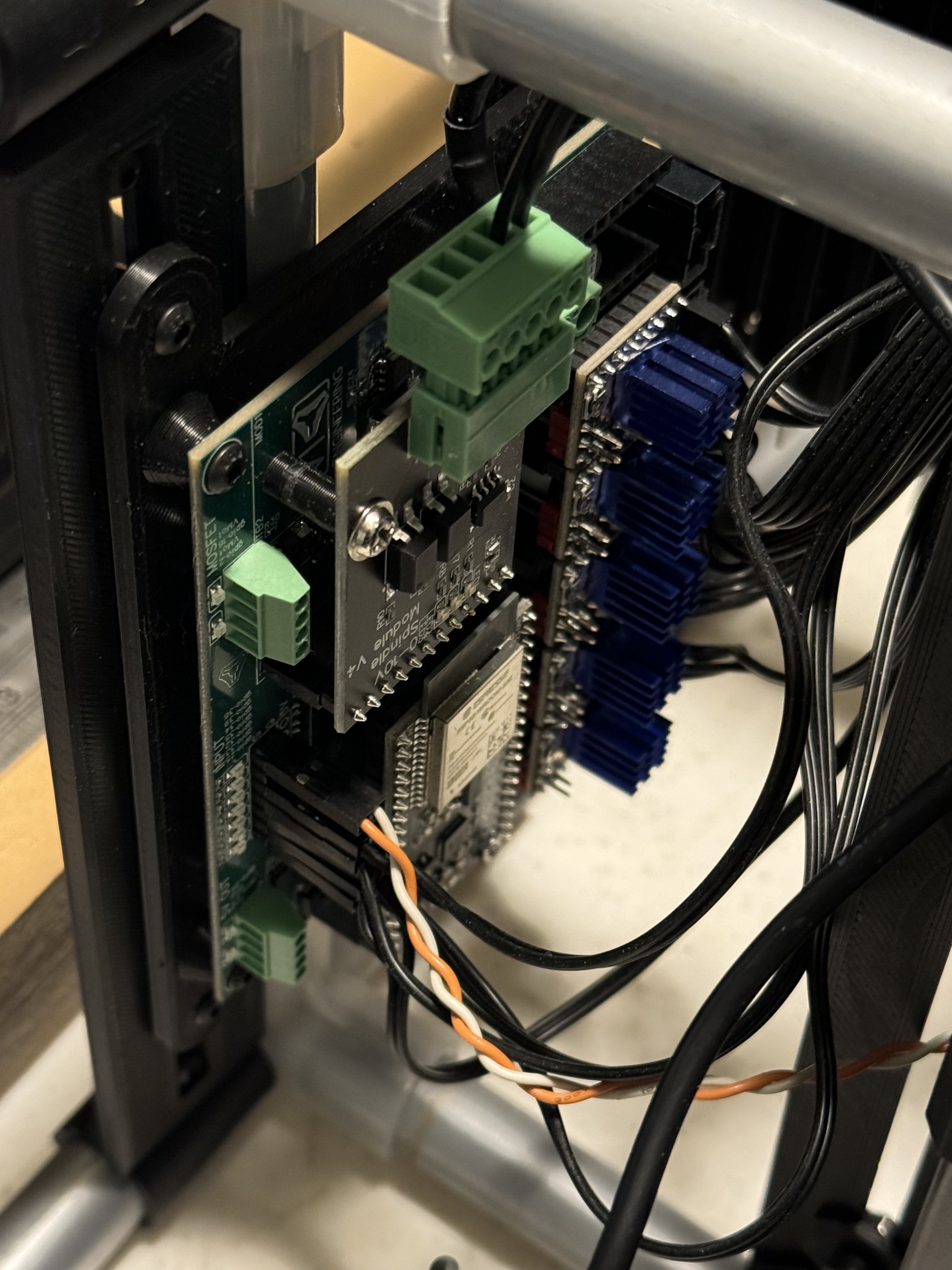

Got all of the control electronics wired up after I received the 0-10V Spindle CNC I/O Module on the mail. Need to do some serious reading on firmware change requirements and any additional wiring needed for that thing. Also remember reading something about having to calibrate it to actual 10V output via a potentiometer somewhere.
Debating adding a few 80mm 5V case fans but won’t need it as this will be living indoors with temperature control.

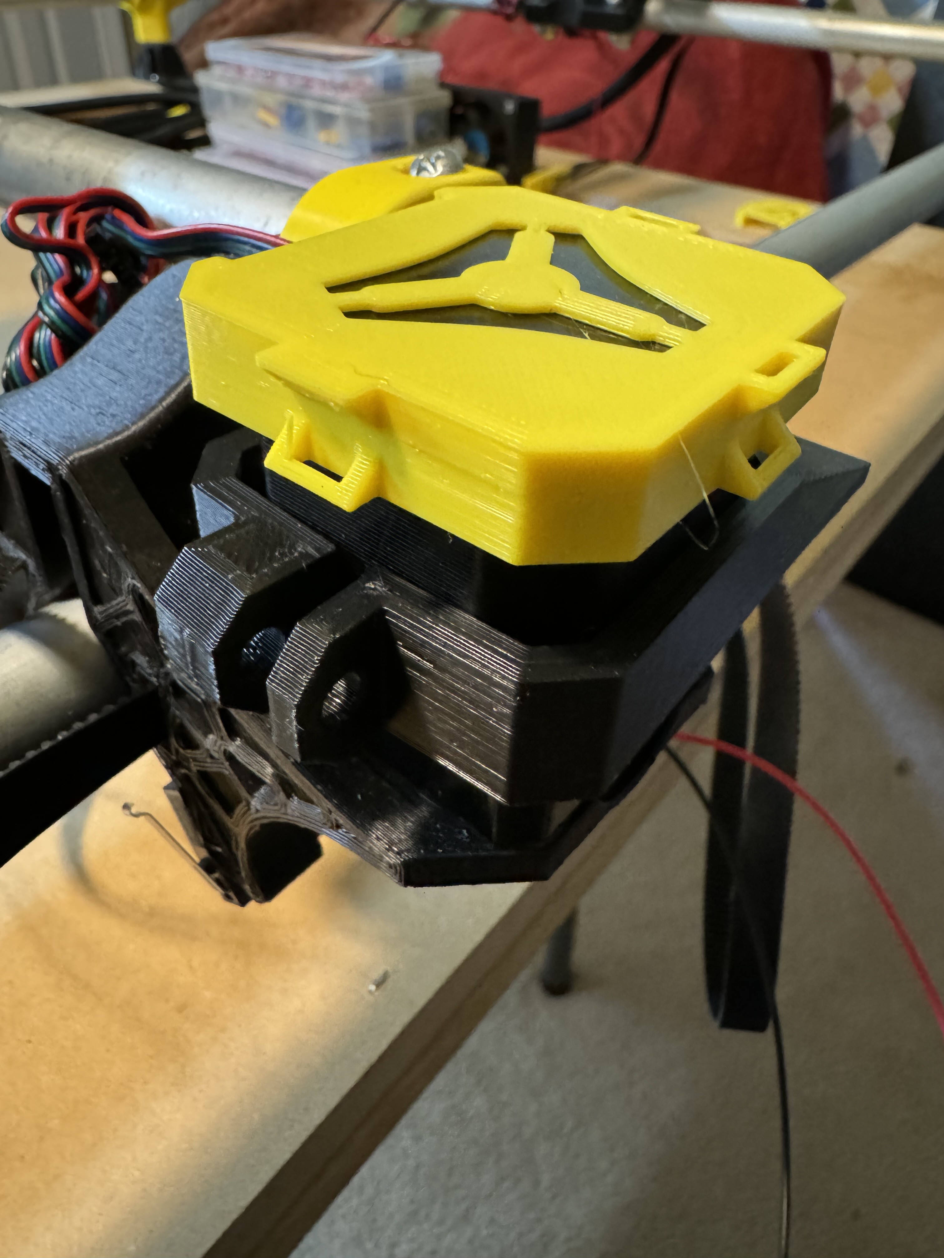

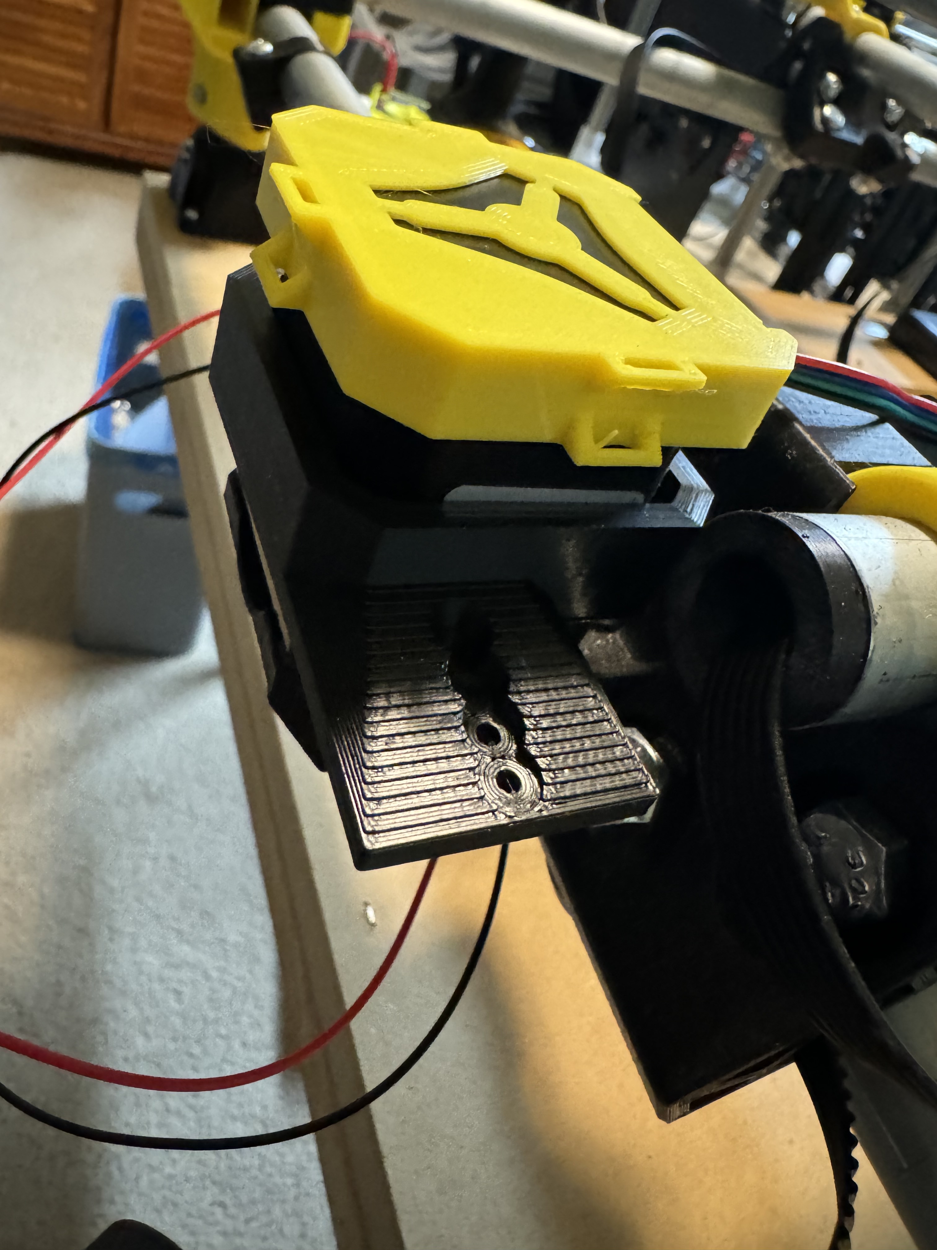

Also got a few bells and whistles printed and installed like stepper covers and stepper-mounted drag chain attach points.
Got a vac hose mount coming up next that’ll mount on one of the Z-axis EMT pipes between the z-motor and z-coupler parts, just have to remix it for a 1.5-in vac hose.
Careful with that Z tower, it has a lot of leverage on the core and it’s surprisingly easy to tug on it and have it affect the angle of the end mill.
My intention is for the mount to act as a guide for the hose to keep it out of the way, with the weight being held by the top of the future enclosure. Appreciate the heads up though, thanks!

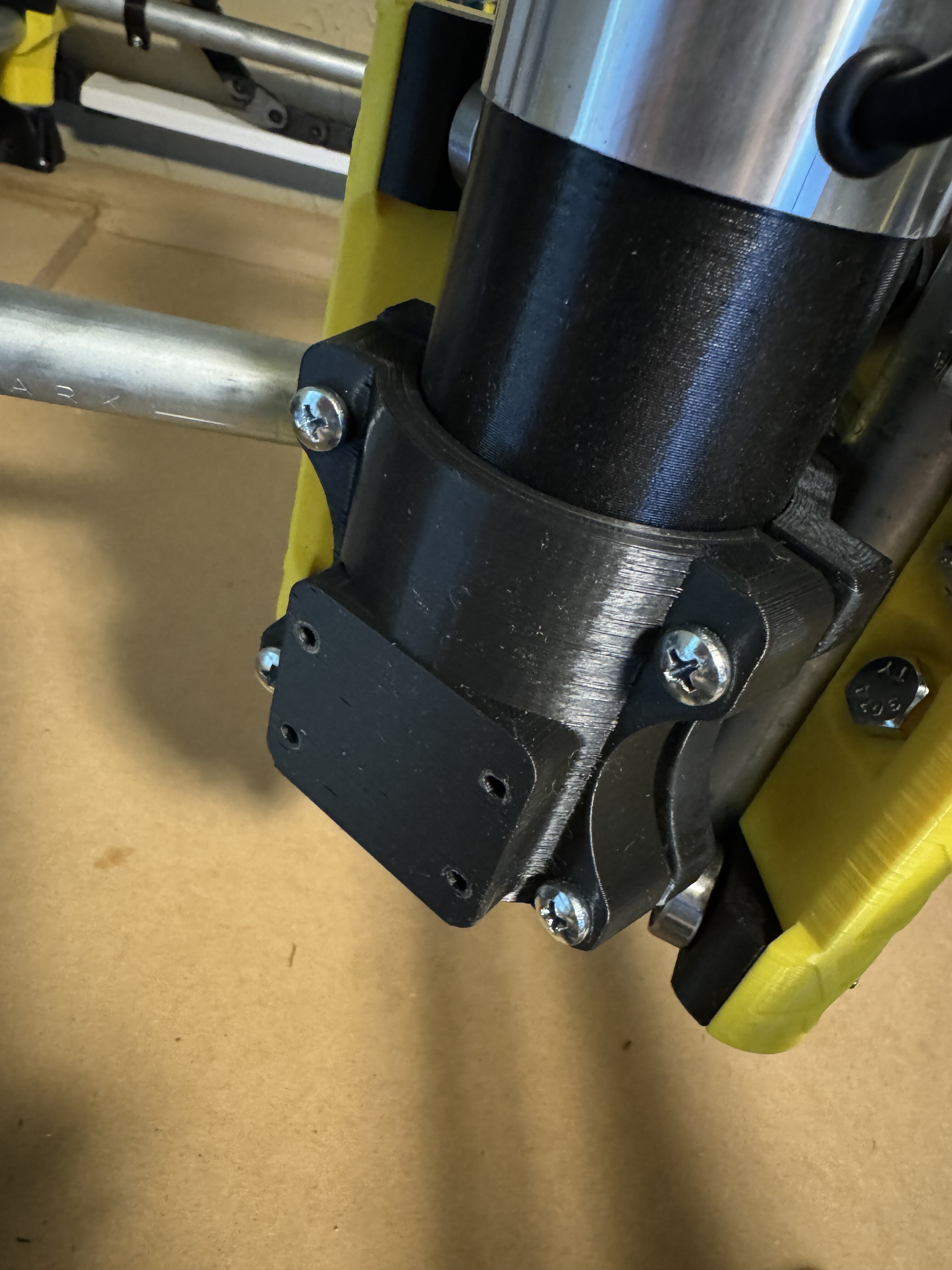

Had a total derp?! moment this evening with my MPCNC build… I printed and installed my 55mm spindle mount cover with integrated front Neje 40640 laser mounting holes… then I went ahead and mounted my custom dust shoe that I just designed a few weeks ago.
I figure you guys will see the problem in way less time than I did.
I guess all that vac hardware I printed is going into the extras pieces box for now.

After I got everything moving around in the correct directions, found out that my spindle mount bolts were just a touch too long and were hitting the bearings on the Core. Turns out that M5 x 30 Pan Head Phillips screws from Lowes fit just right and match perfectly with what @vicious1 shipped in the parts kit, so bought a few packs of those with extra lock nuts (man those things just up and disappear sometimes) and some M5 x 50’s in case of something dumb in the future.

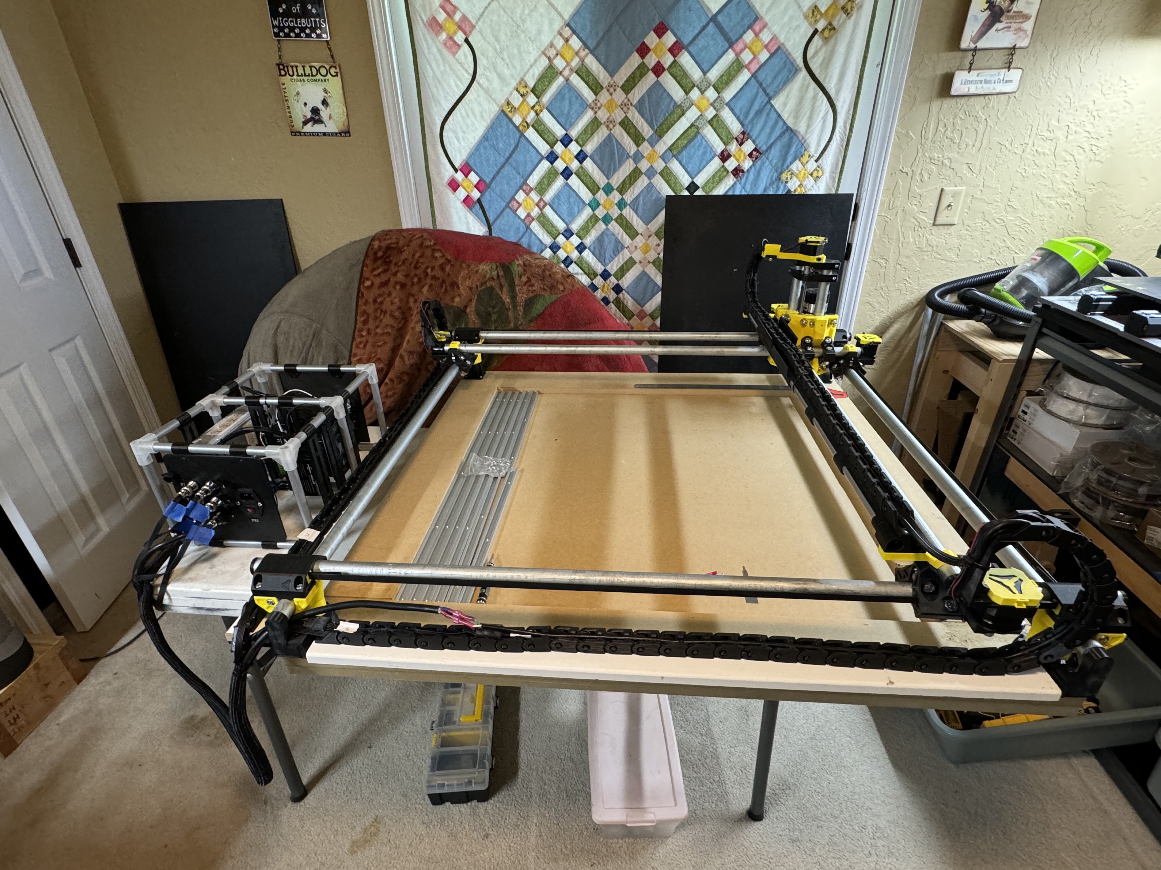

I printed up some side drag chain mounts for the back and right side so all of the wires could stay off the deck in case of a tiled cut at some point in the future. These will be inserted into the ends of the EMT conduit on the three corners away from the Home position and hang down low enough to keep the chains clear of the stepper trucks.
That also allowed all of my cables to end up in one spot in the back-right corner. From there I’ll end up bundling them up and pushing them through an access port in the enclosure somewhere down the line and placing the control electronics on top or something.
My next step is to finish up the drag chain mounts so I can get full range of motion. I need to measure, cut and bolt something flat down to those mounts for the chain to lay across but I seem to have lost my tape measure somewhere in the clutter of my office today… Also need to fabricate extensions for the stepper mounts to push the chain ends up about 3 inches so the chain can curve up and over from behind the mount like my Z-axis.

I have some drag chain guard rails printing now to bolt to those platforms to keep the chains from falling off, but I think I’m about down printing parts! I’ll still have to wire the Neje A40640 laser in when it comes in the mail, but after all this, it shouldn’t be too bad.

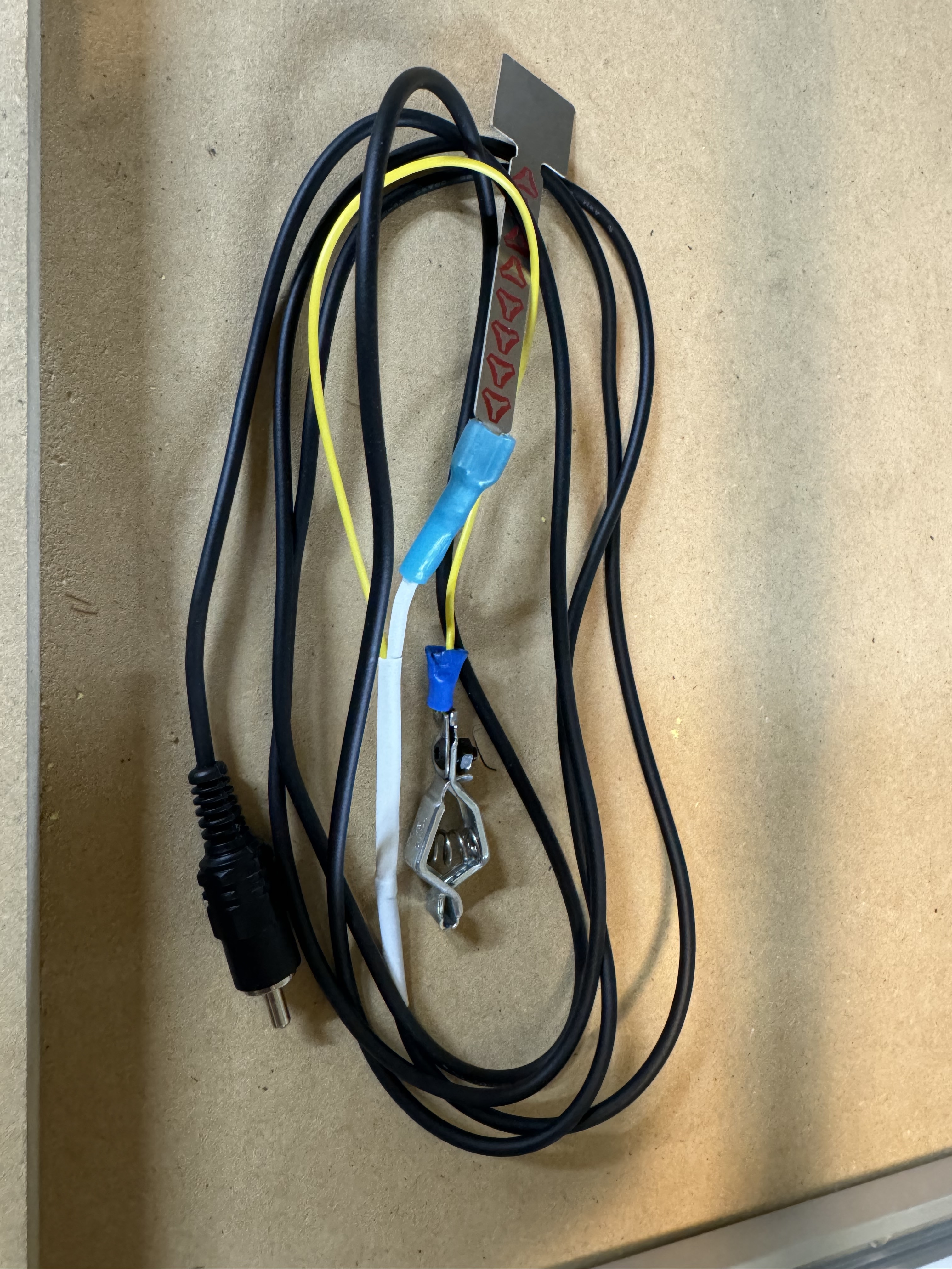

Got my touch plate wired up into an RCA-style cable end and about 6 feet of cable.
As soon as I get my LR3 lead screws and stubs changed out to the 2 start 4mm pitch style, get everything put back together and the firmware updated, I’ll cut the spoil board panels to place between the t-track pieces and get everything set up for threaded inserts underneath and dog holes through the table.

So next step for now is getting my spindle configured and the 10V Output Module tuned appropriately.

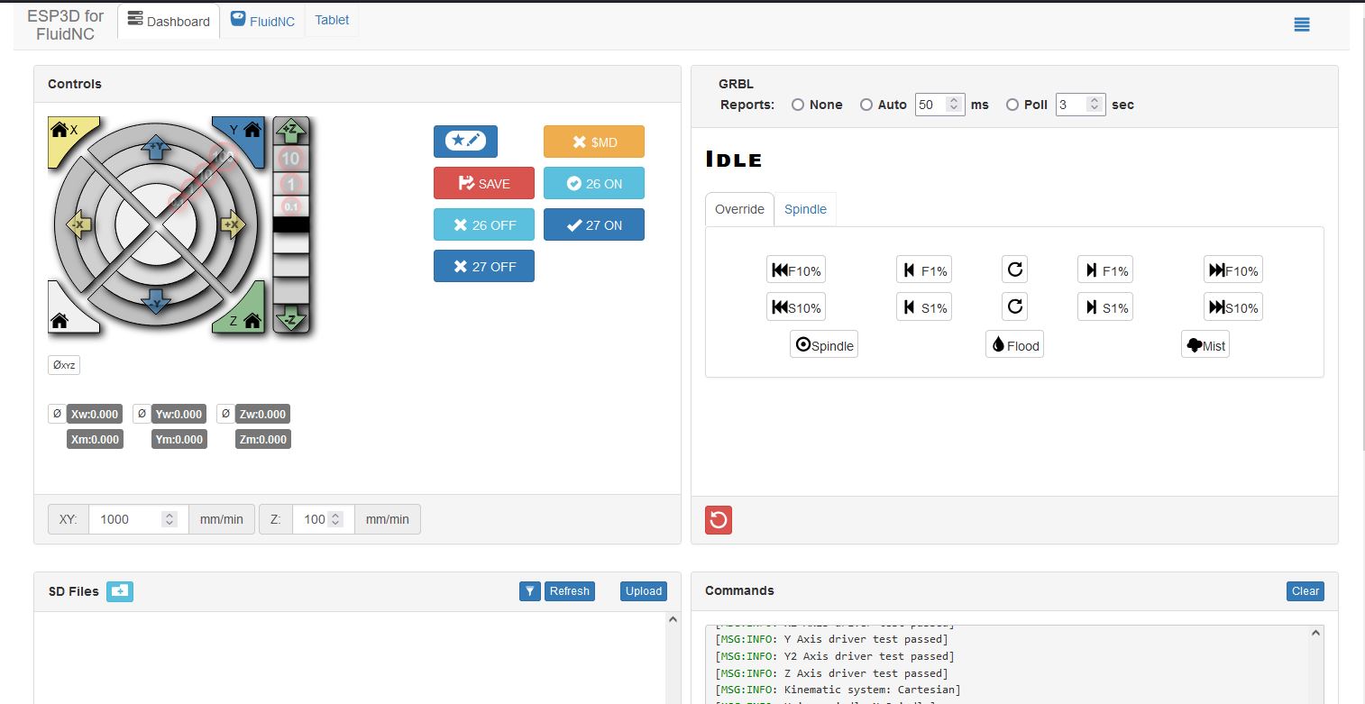

The instructions say I need to make sure the following settings are correct:
  • $Spindle/Type=10V
  • $GCode/MaxS=12000
I tried typing those commands in to maybe see if it would give me some answers, and I get nothing.
My startup info looks like the following
Jackpot Startup
$G
[GC:G0 G54 G17 G21 G90 G94 M5 M9 T0 F0 S0]
ok
$SS
<Idle|MPos:0.000,0.000,0.000|FS:0,0|Pn:XY|WCO:0.000,0.000,0.000>
[MSG:INFO: FluidNC v3.8.0 GitHub - bdring/FluidNC: The next generation of motion control firmware]
[MSG:INFO: Machine MPCNC]
[MSG:INFO: Stepping:I2S_static Pulse:4us Dsbl Delay:0us Dir Delay:1us Idle Delay:255ms]
[MSG:INFO: User Digital Output:0 on Pin:gpio.26]
[MSG:INFO: User Digital Output:1 on Pin:gpio.27]
[MSG:INFO: Axis count 3]
[MSG:INFO: Axis X (0.000,1220.000)]
[MSG:INFO: Motor0]
[MSG:INFO: Motor1]
[MSG:INFO: X2 Neg Limit gpio.35]
[MSG:INFO: Axis Y (0.000,2440.000)]
[MSG:INFO: Motor0]
[MSG:INFO: Motor1]
[MSG:INFO: Y2 Neg Limit gpio.34]
[MSG:INFO: Axis Z (-100.000,200.000)]
[MSG:INFO: Motor0]
[MSG:INFO: Z Neg Limit gpio.32:low]
[MSG:INFO: X2 Axis driver test passed]
[MSG:INFO: 10V Spindle Ena:NO_PIN Out:gpio.14 Dir:NO_PIN Fwd:NO_PIN Rev:NO_PIN Freq:5000Hz Period:8191]
[MSG:INFO: Using spindle 10V]
[MSG:INFO: Probe gpio.36:low]
I see a mention in there about Using spindle 10V and some other details about my pin usage configuration… Does that mean I’m good to fire up an M3 command?

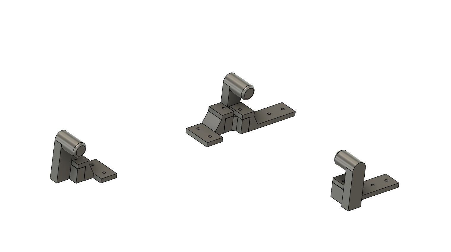

@DougJoseph just threw together a quick remix of your kinematic main mount for a 55mm spindle on the MPCNC. Made it a 4 screw M3x12 design to make it fit within the mounting area defined by another Neje mount I already tried. I want mine to be removable so I don’t get dust all up in the laser when I’m using the spindle, so I turned to your design.

My current conf.yaml shows the following:
10V:
forward_pin: NO_PIN
reverse_pin: NO_PIN
pwm_hz: 5000
output_pin: gpio.14
enable_pin: NO_PIN
direction_pin: NO_PIN
disable_with_s0: false
s0_with_disable: true
spinup_ms: 0
spindown_ms: 0
tool_num: 0
speed_map: 0=0.000% 12000=100.000%
off_on_alarm: false
I’m not sure where I gathered the info to put that together, I’ve been everywhere readying everything. However, I don’t have any issue with changing it over to your suggestion.

Threw an M3 S12000 command and got her all tuned up to 10.00V, per the instructions.
Powered everything down, reconnected the control wiring and the spindle cables and fired her up!
And got nothing…

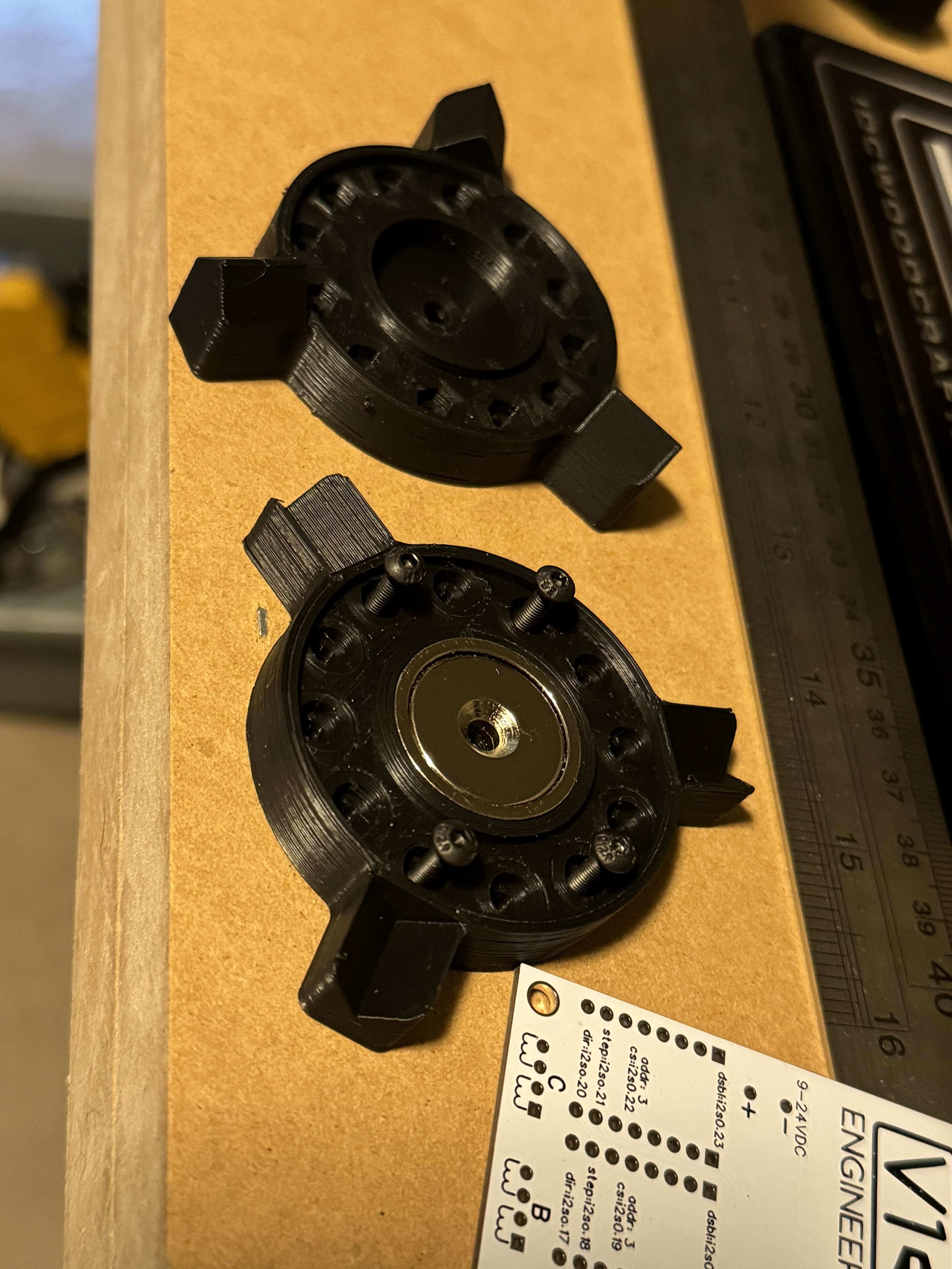

Everything fits up well on the MPCNC spindle and matches up with a fixed base!

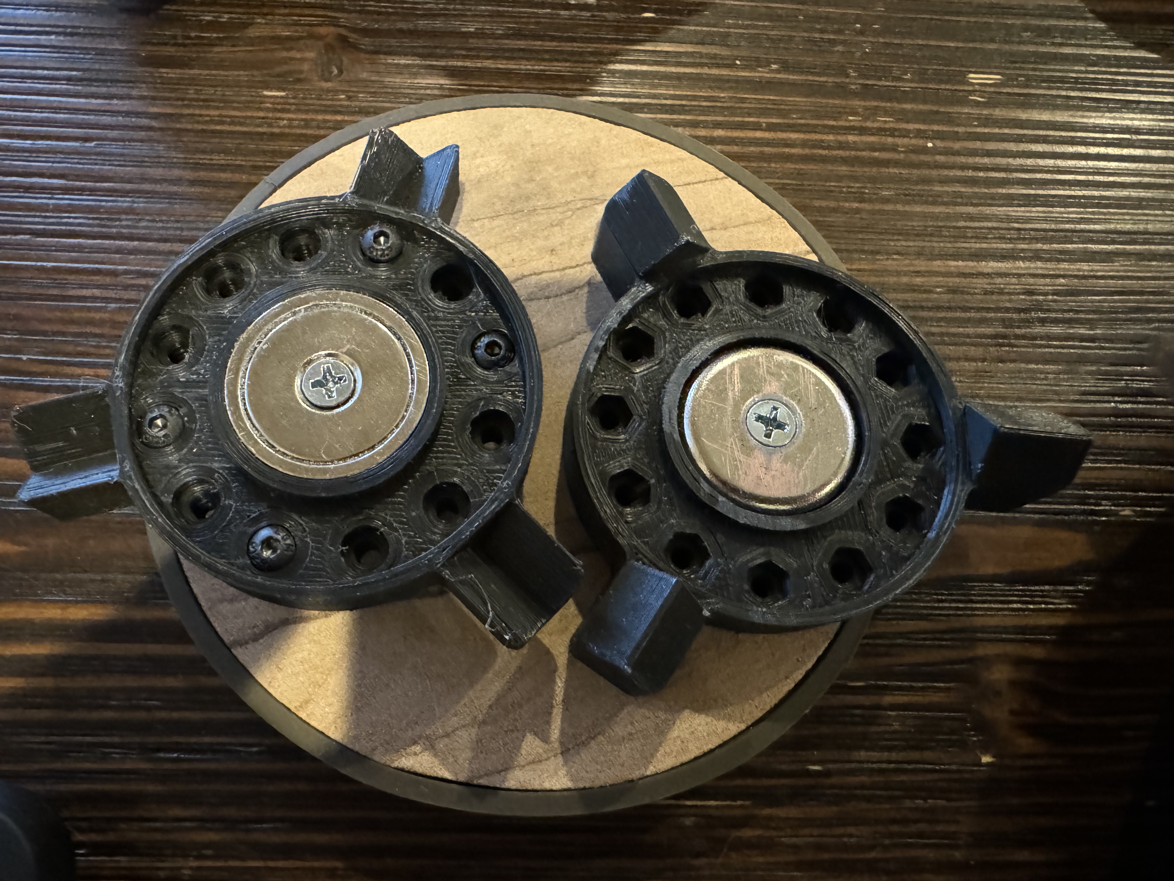

Unfortunately the fixed and mobile bases I printed out don’t fit my magnet selection, so I’m remixing those to work with my 25 x 5.5 mm neodymium magnets and adding a few 3mm and 4mm nut enclosures to assist with mounting. I just need to chamfer out the steel back side of a few magnets to allow them to be mounted in reverse.. More to come on those later!
Update

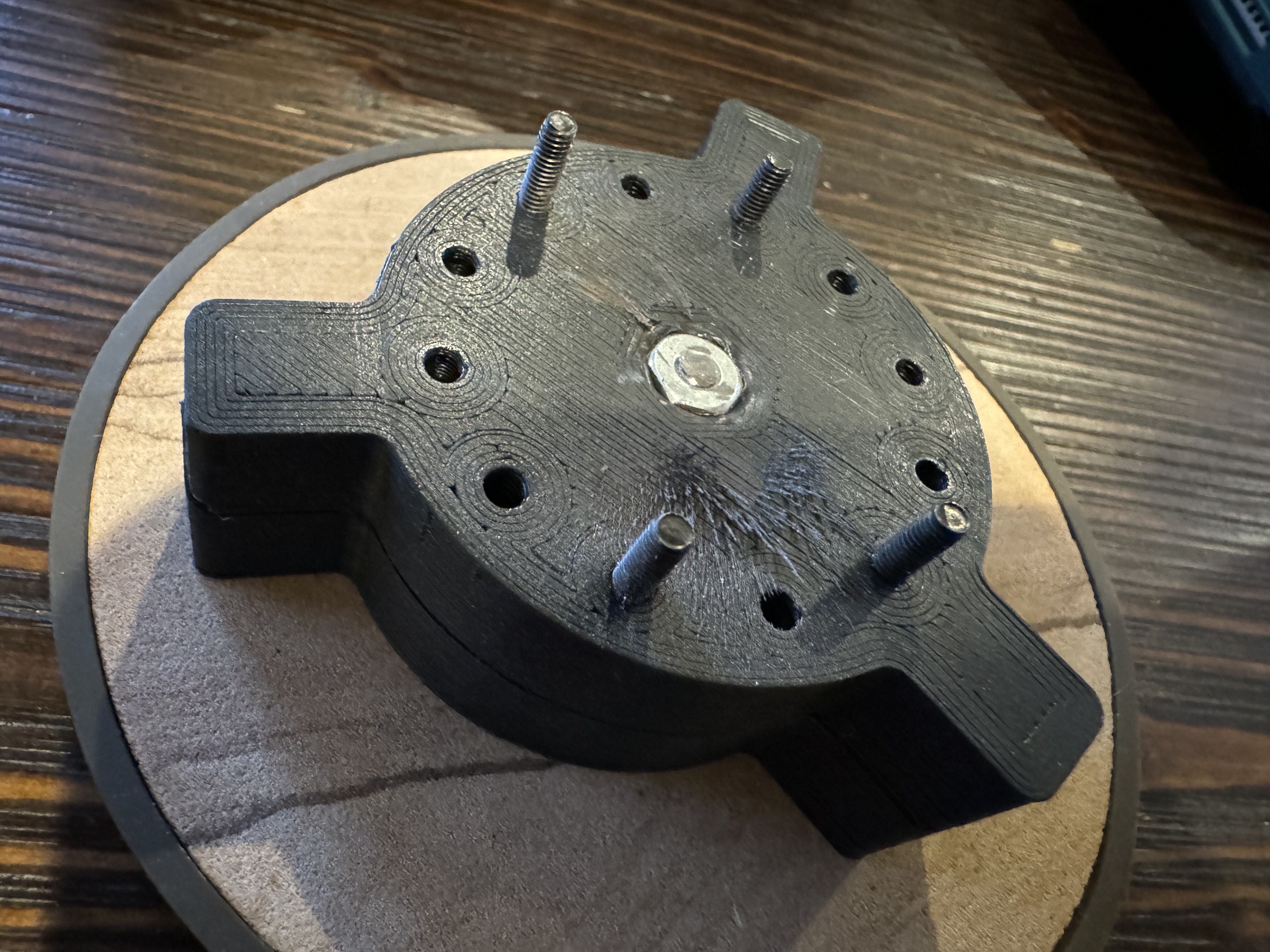

First set of bases finished and they fit together nicely, got the first magnet chamfered and mounted and then stuck them together and can’t get them apart, lol…
Really thin flat tip screwdriver got it done!
Totally mounted it with the standard magnet facing out in the fixed base… I would have had to chamfer out every mobile magnet back side. Flipped that around so the LR3 and MPCNC both have a fixed base now and the kinematic attachments are working great! Printing out a pen and drag knife holder to go along with the laser mount. Those suckers hold on TIGHT!

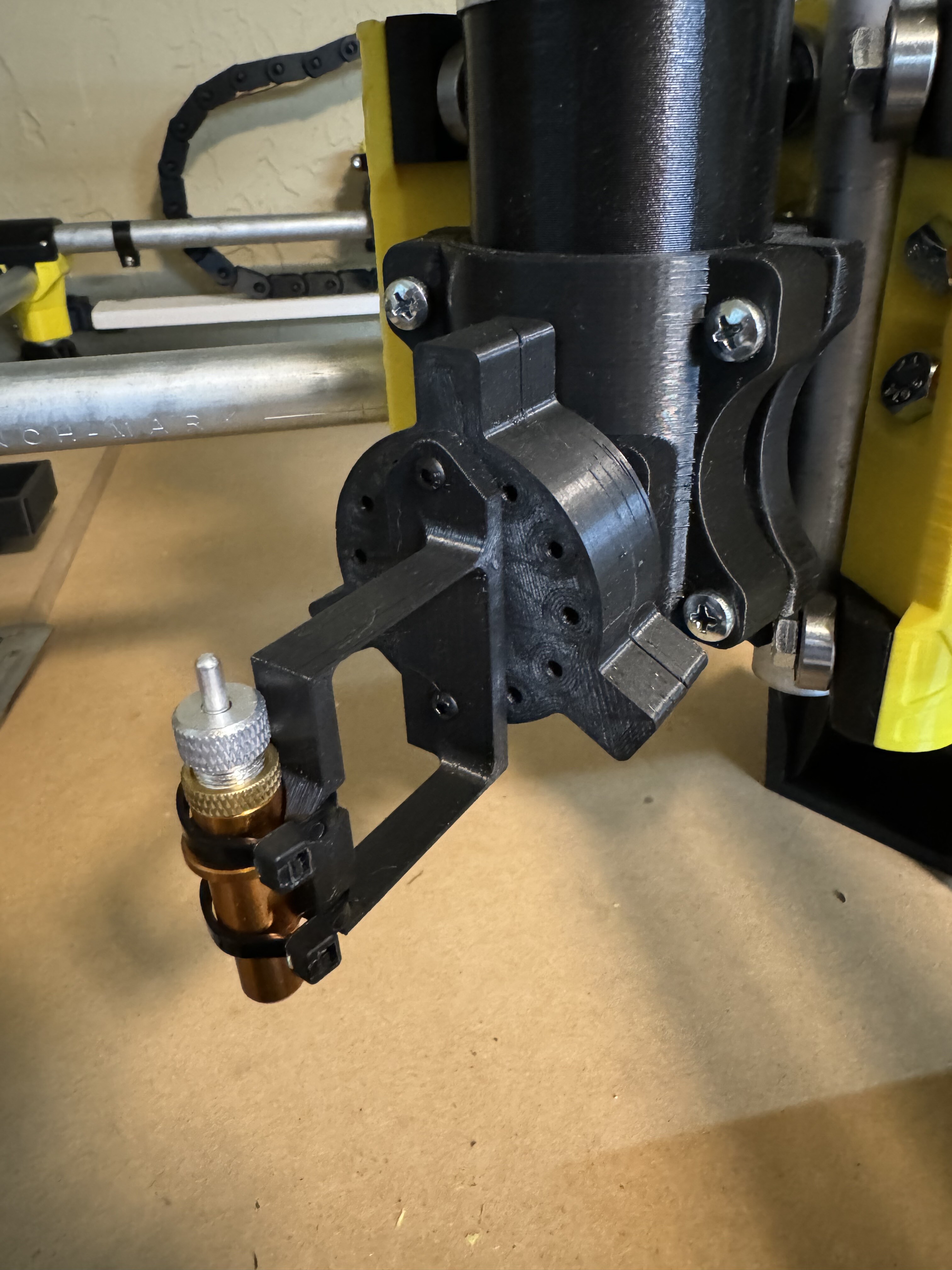

Don’t have the laser to mount quite yet, but…

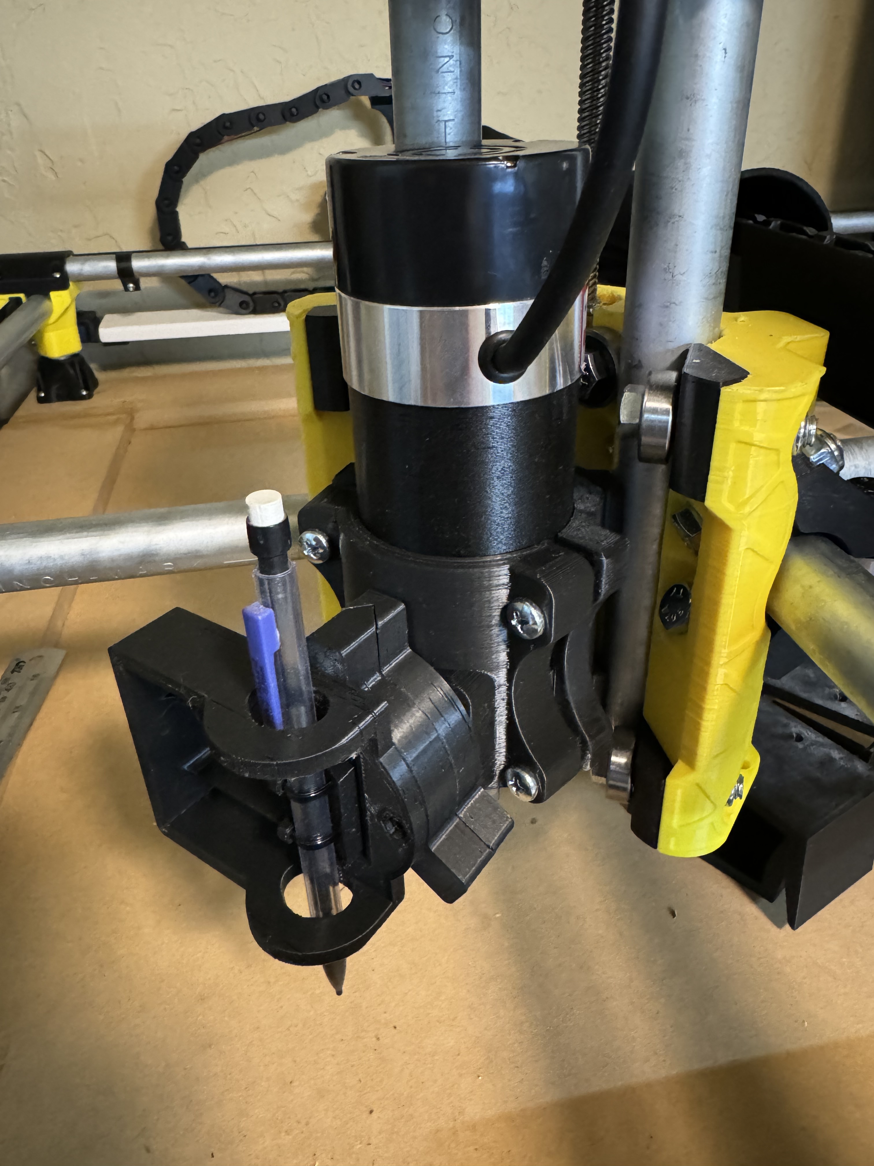

And the drag inside mount…
And the pen mount.
Feeling pretty happy about being able to walk the same attachments down to the garage to use on the LR3.
