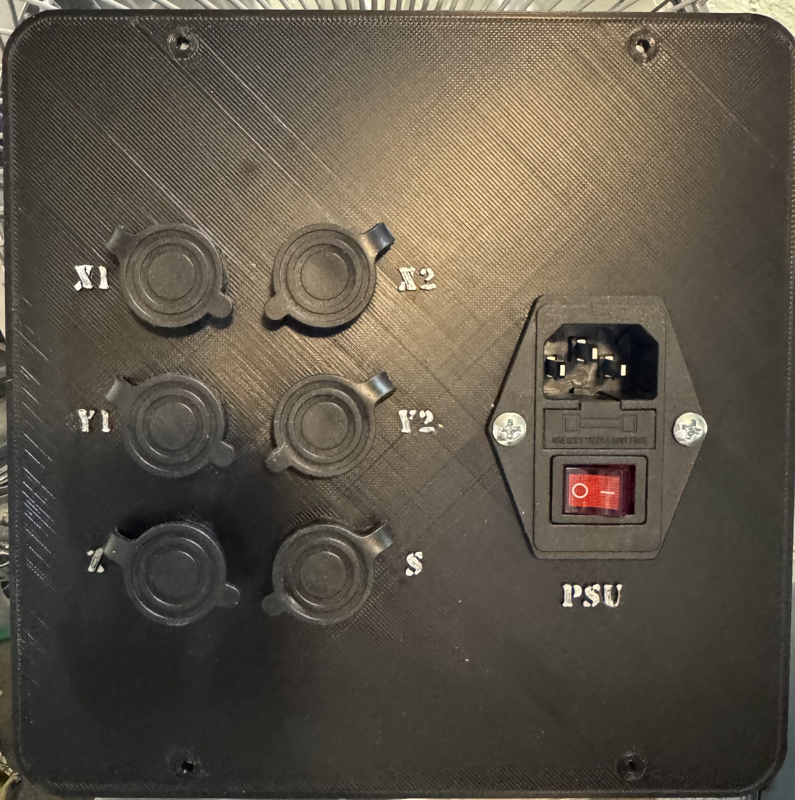

Ugh… I forgot to issue the M600 command to change colors, but at least it’s the back panel… a little white chalk marker assistance at least helped provide some visual contrast.

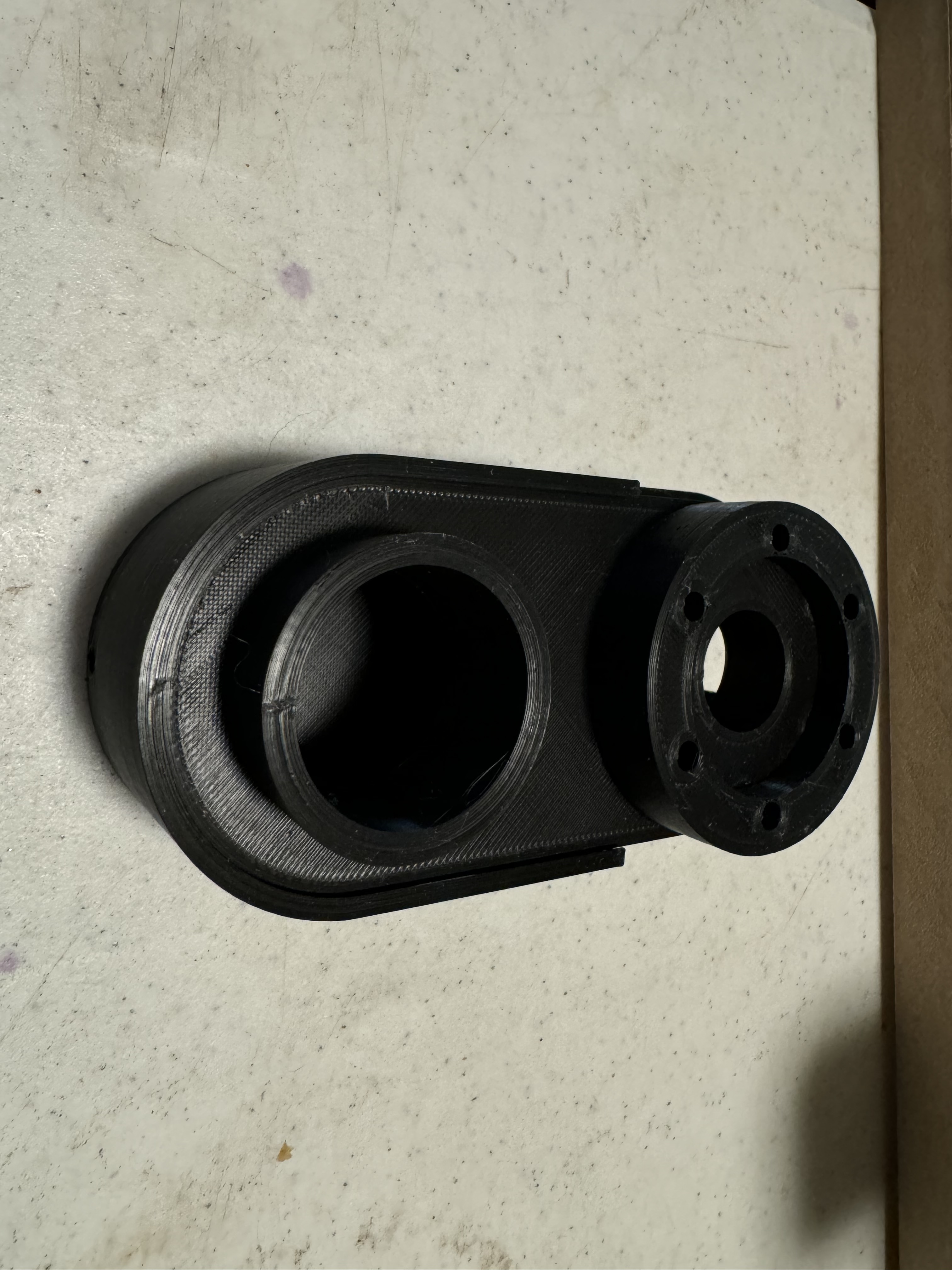

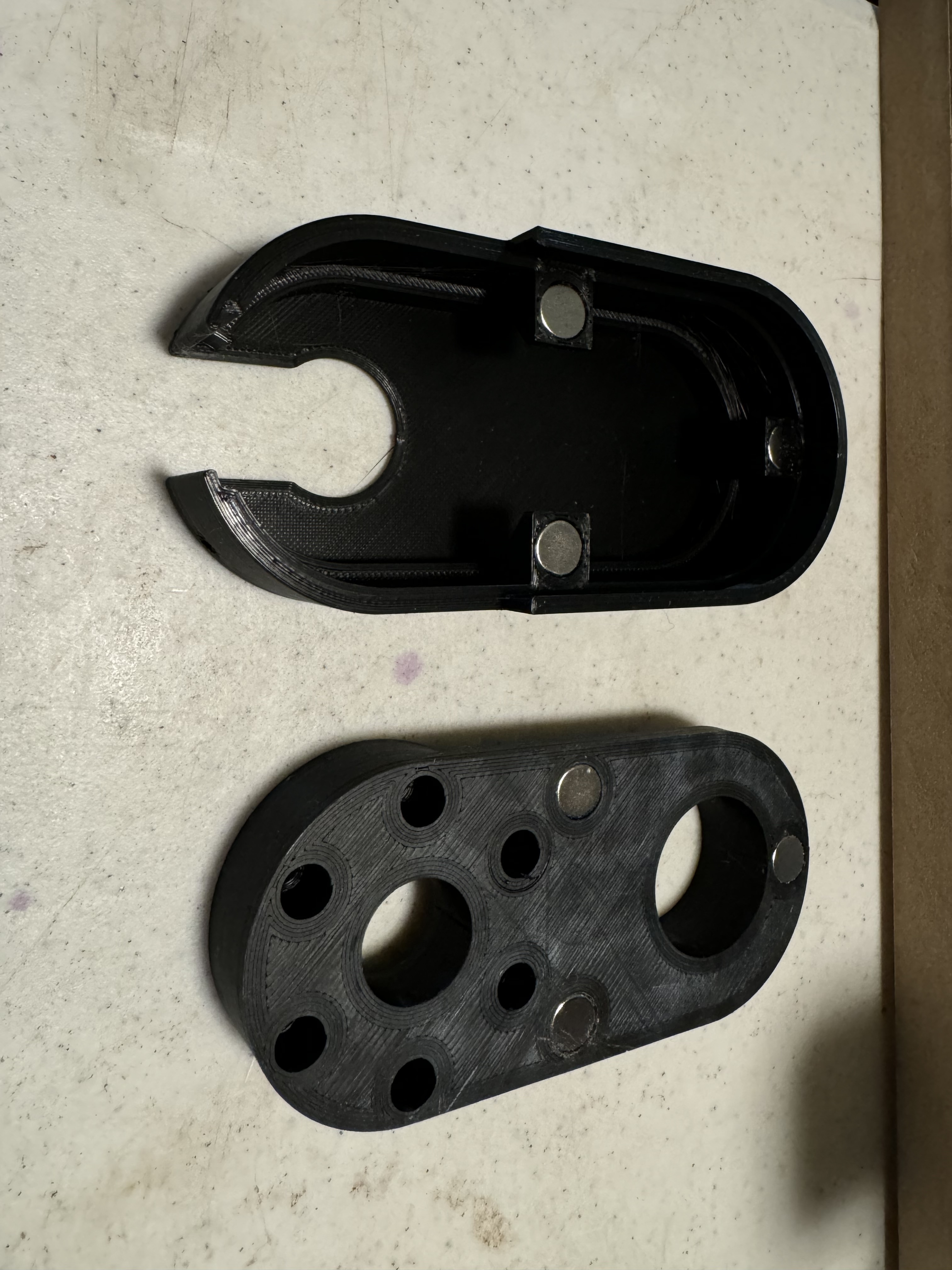

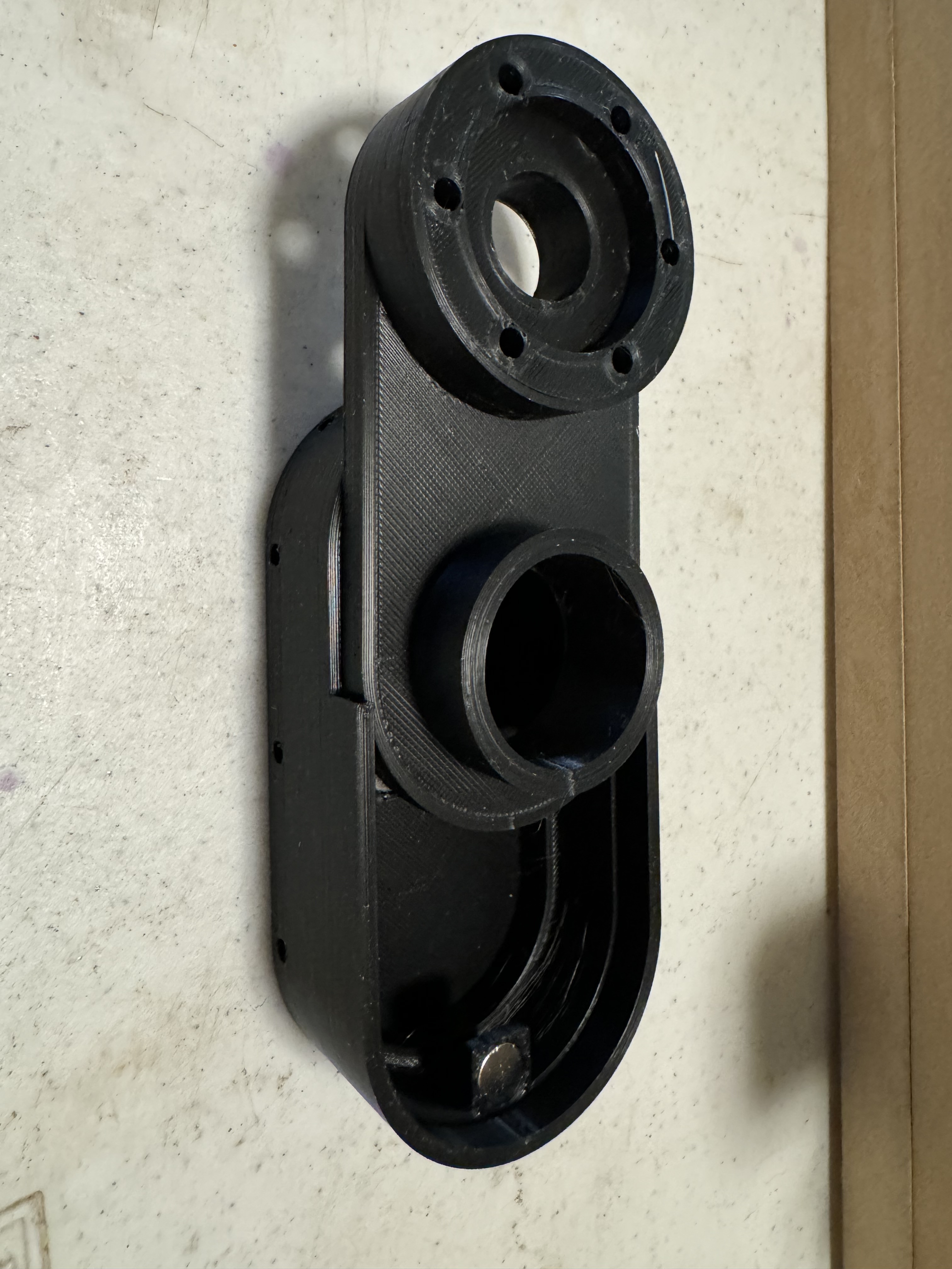

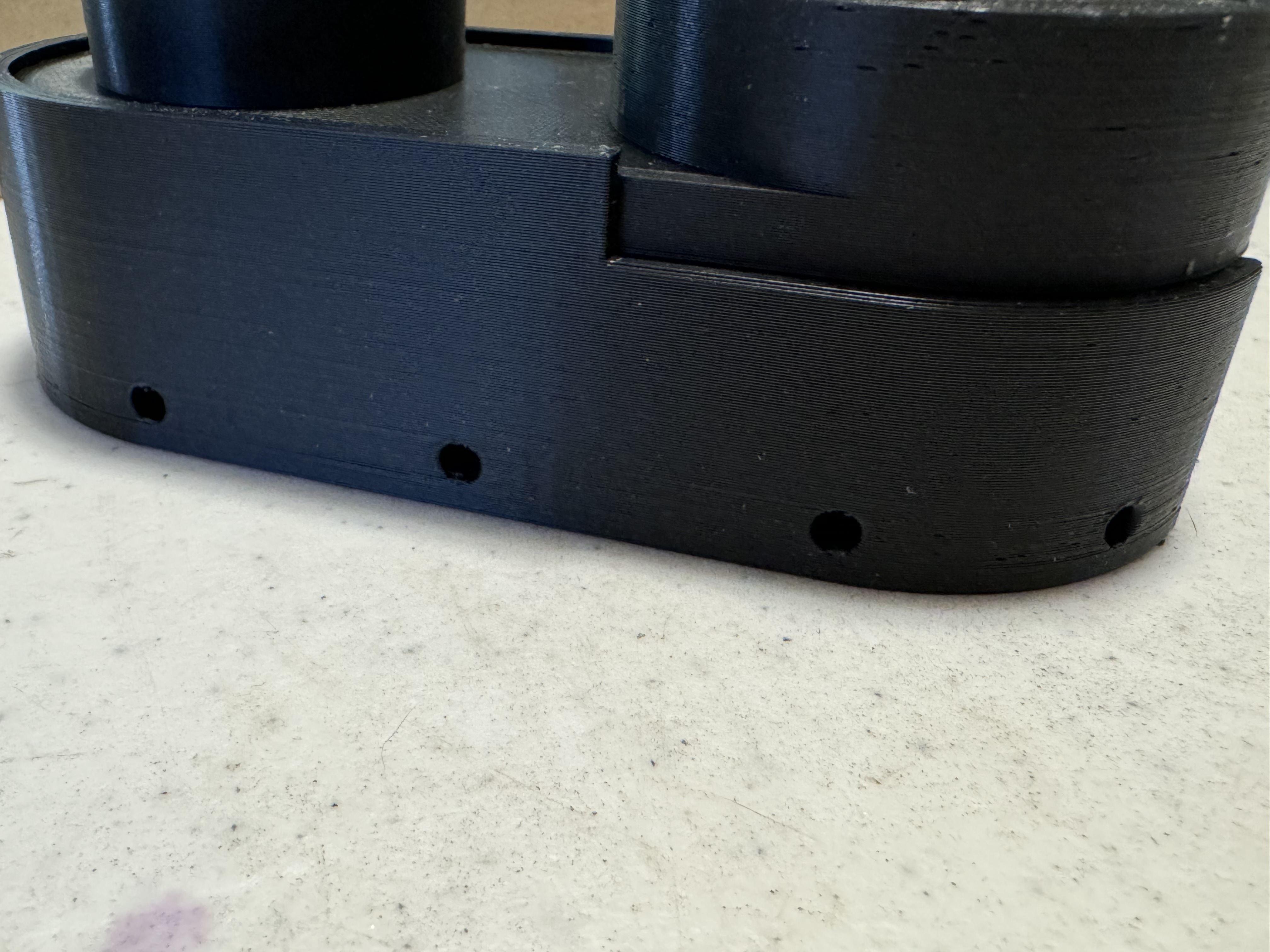

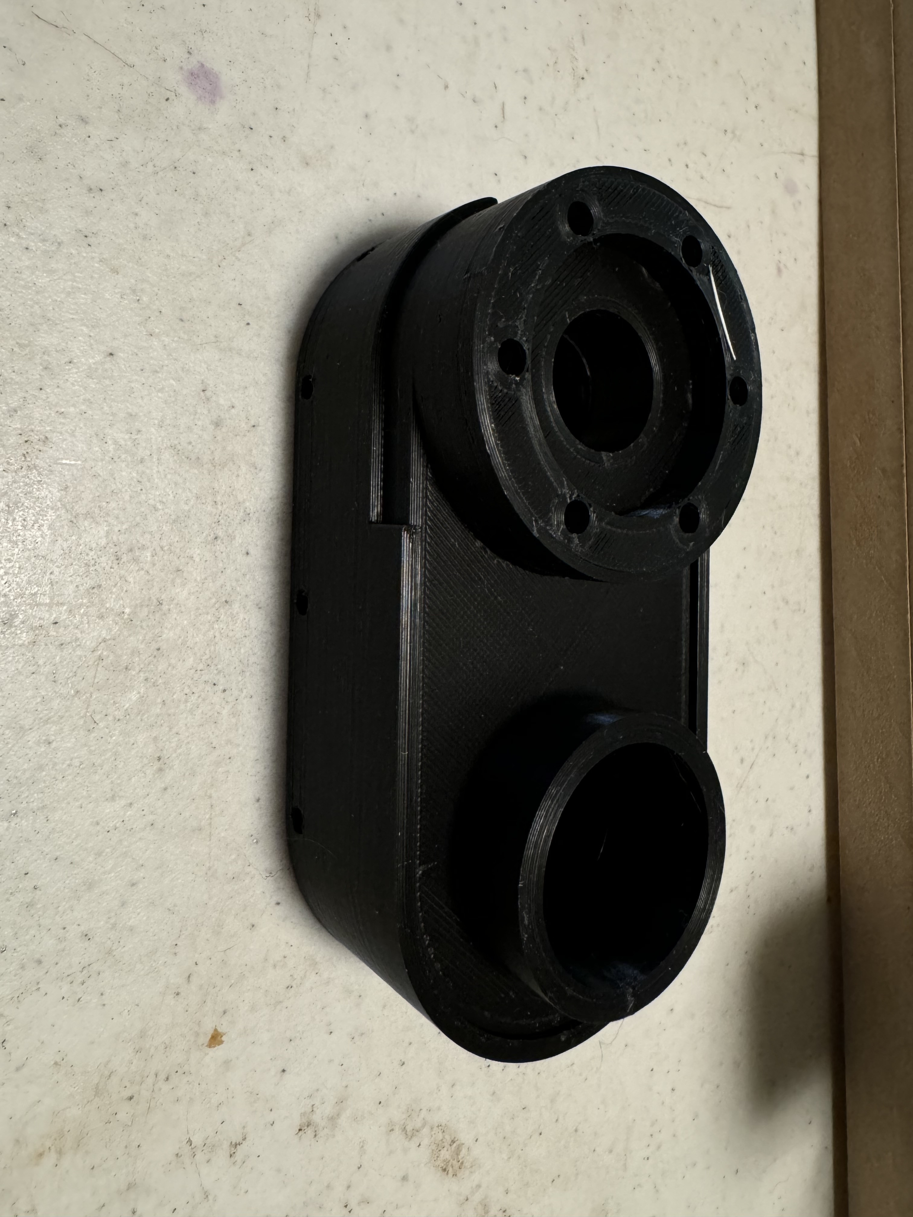

I finished designing the remainder of my dust shoe system, pictures below. The base mounts to my spindle using 6 - 4mm screws and has a fairly thick deck to handle any vertical force from the vacuum hose. The shoe itself slides onto the base from the front and aligns 3 - 10x3mm neodymium magnets to hold it in place. The tolerances for the magnets and the shoe/base fit came out GREAT! The holes in the bottom of the shoe are threaded for M4 screws and my plan is to attach a commercial dust shoe brush like this to the outer perimeter.
I’ll have to wait until I get the MPCNC operational to figure out how to mount the vac hose and check performance. If anyone wants to peruse the design, I’ve included it below:
Daedalus BLDC-500-ER11 Dust Shoe.zip (442.4 KB)

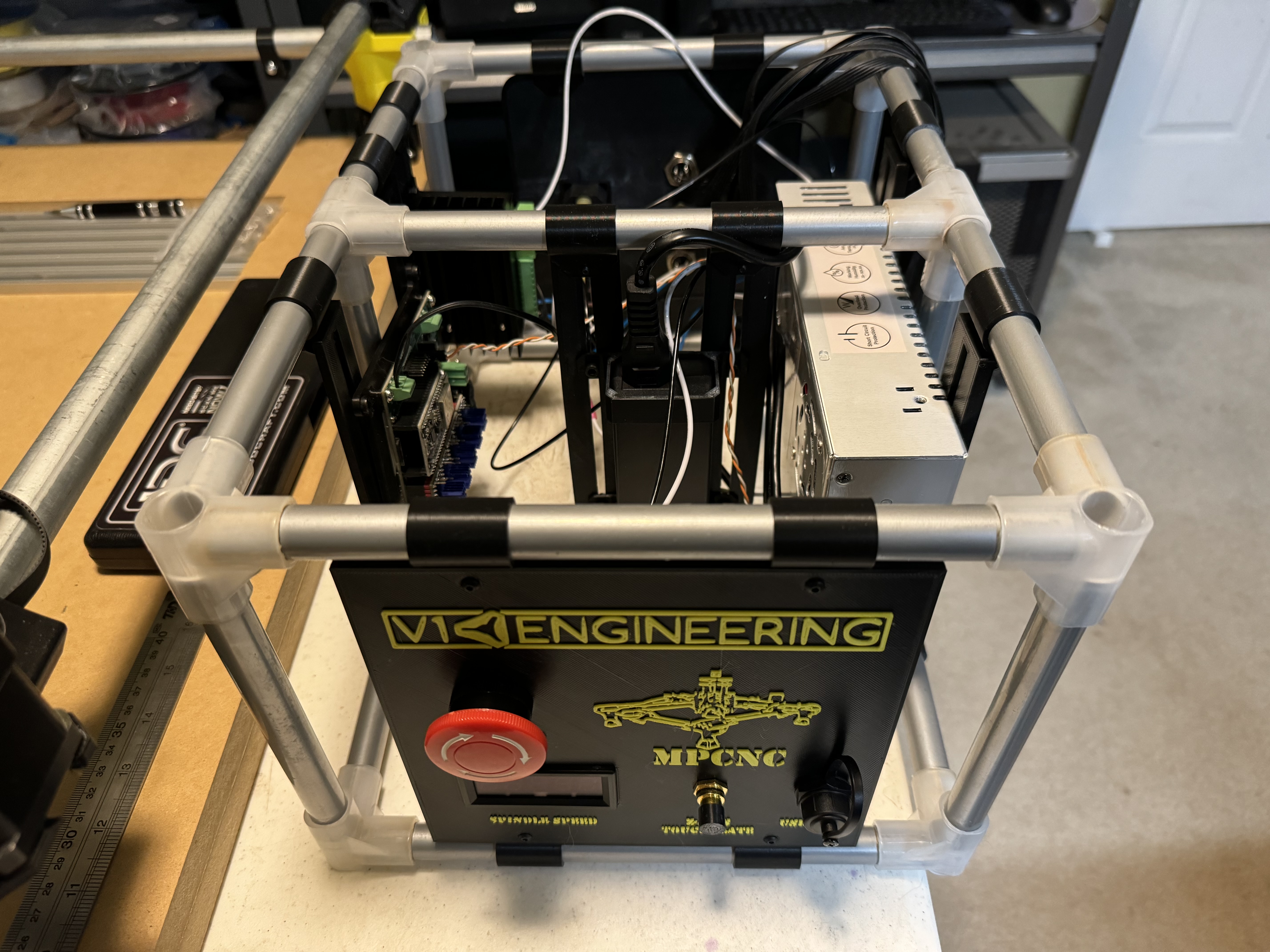

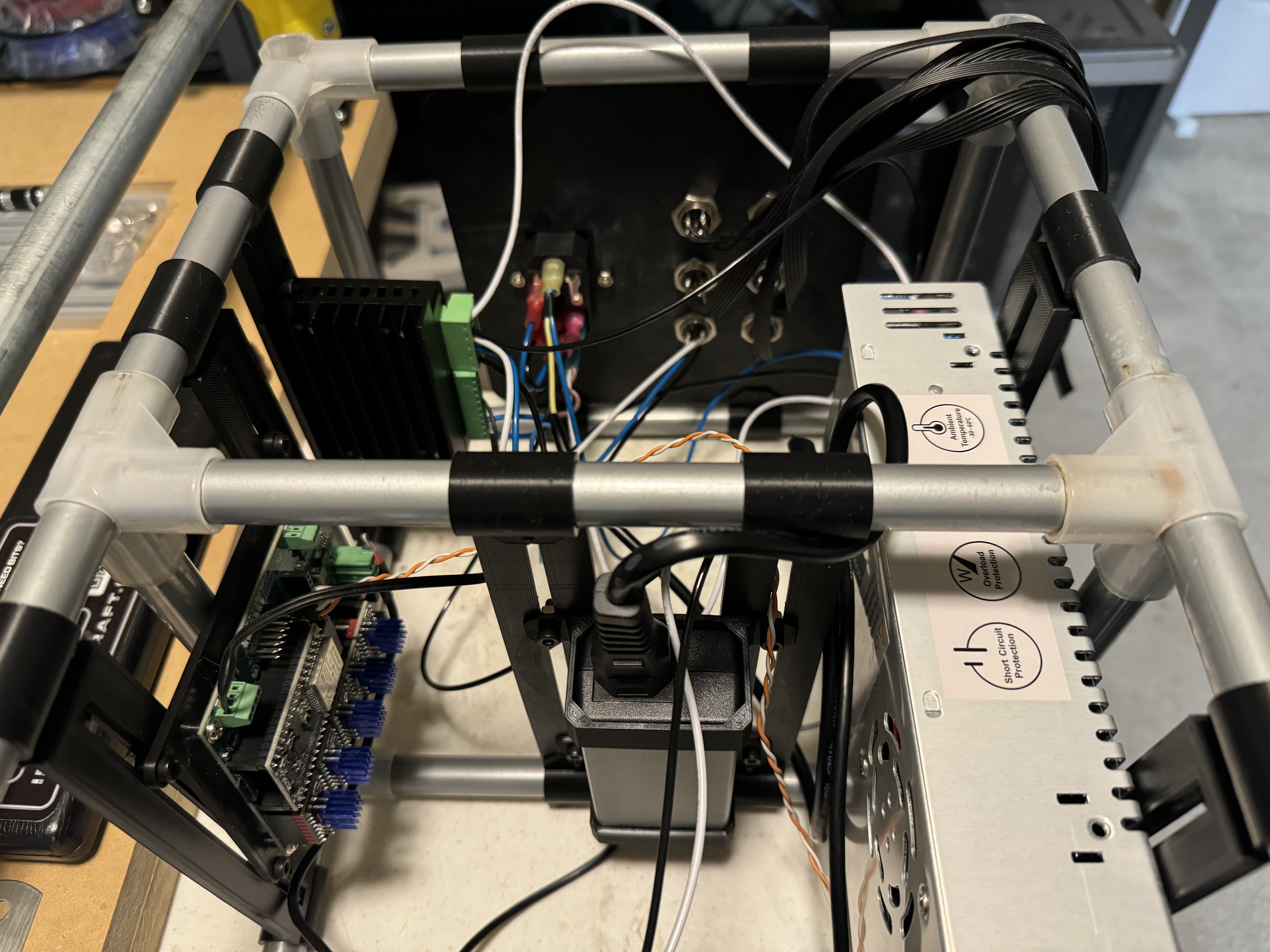

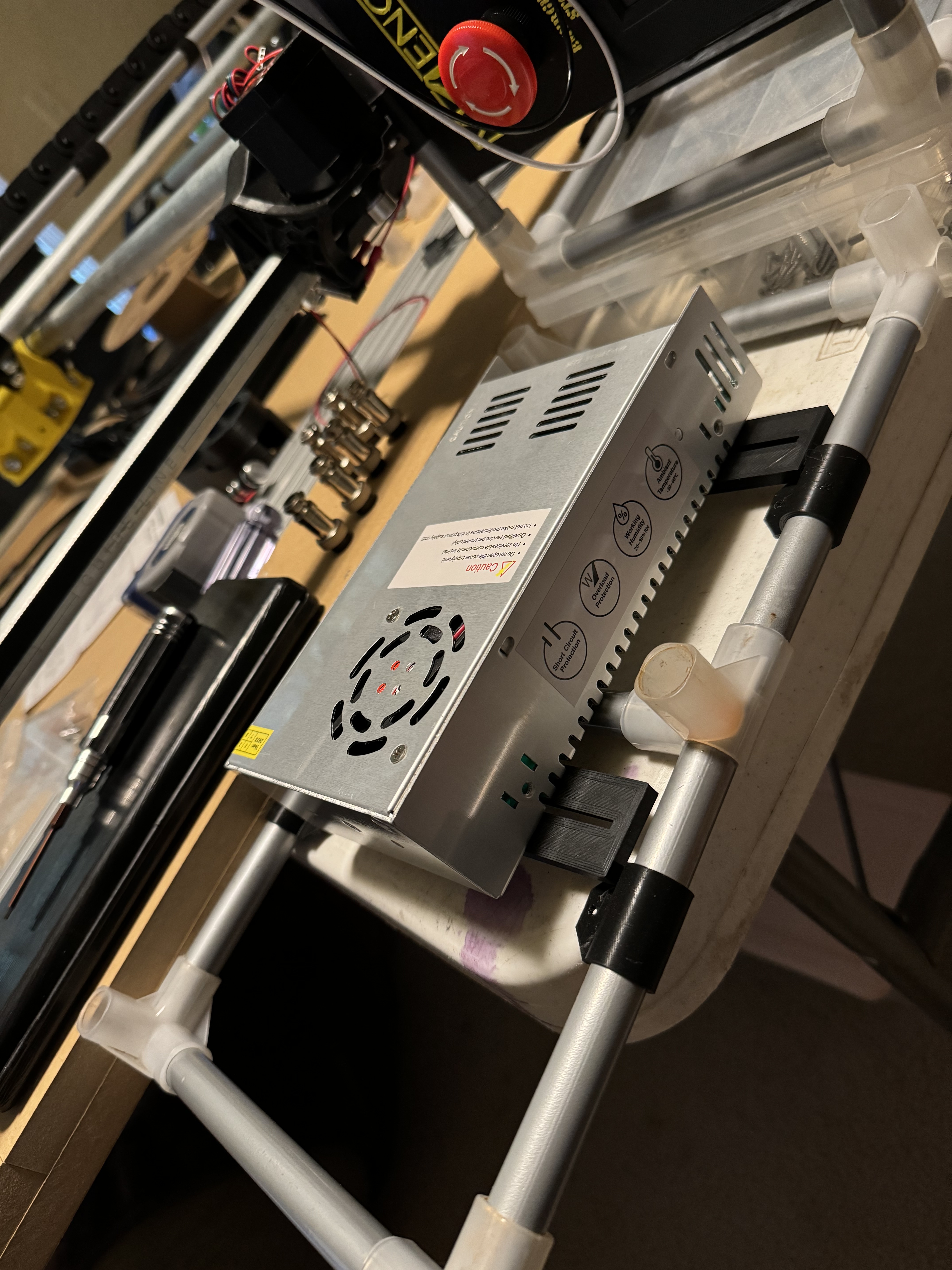

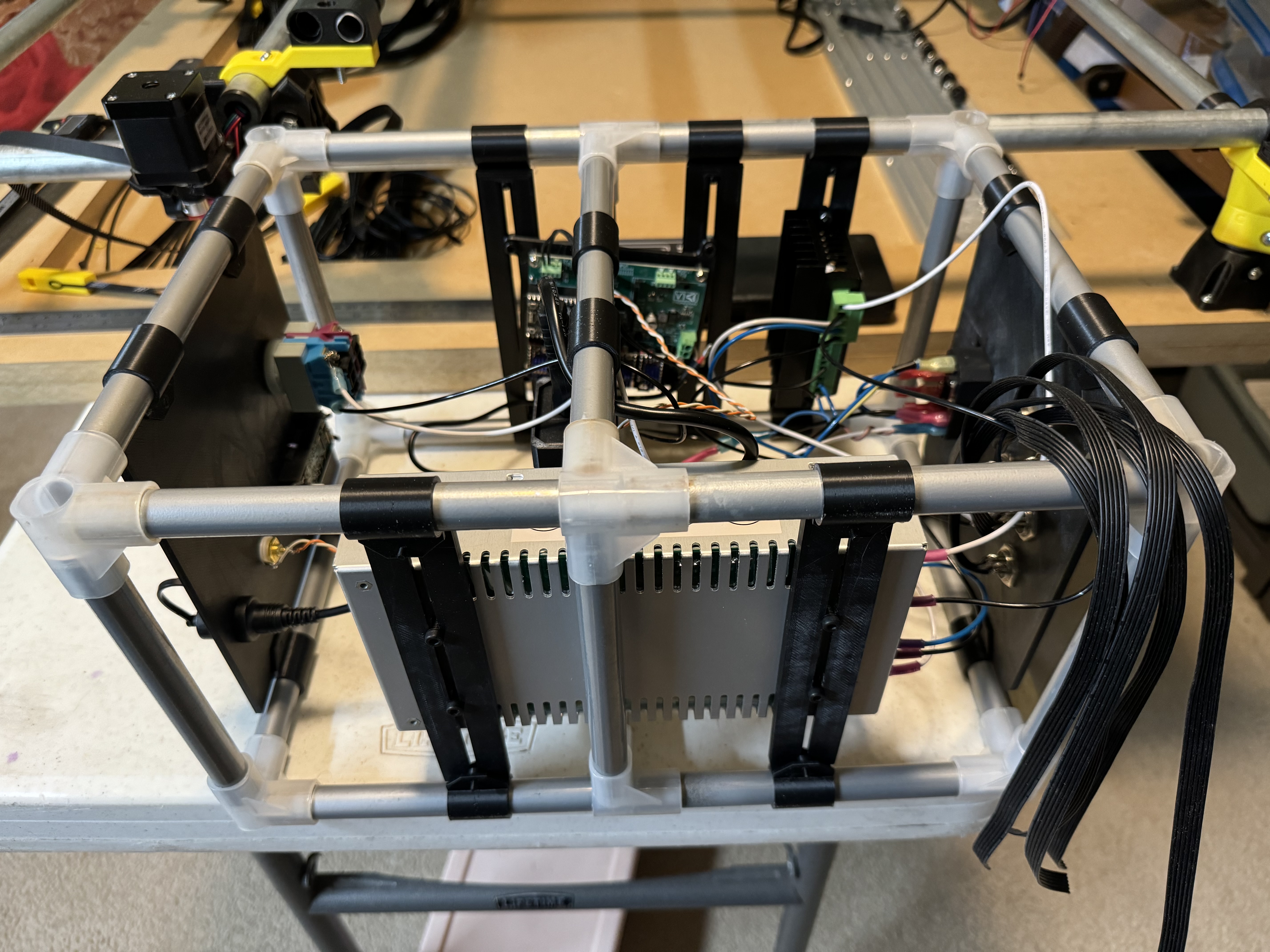

Assembly of the controller cage has begun! Just had to wait on some electronics toys and a bunch of printed parts… Still waiting on a few standoffs to get the Jackpot and Spindle PSU connected and then it’s on to wiring! Lots of soldering and crimping in my near future.

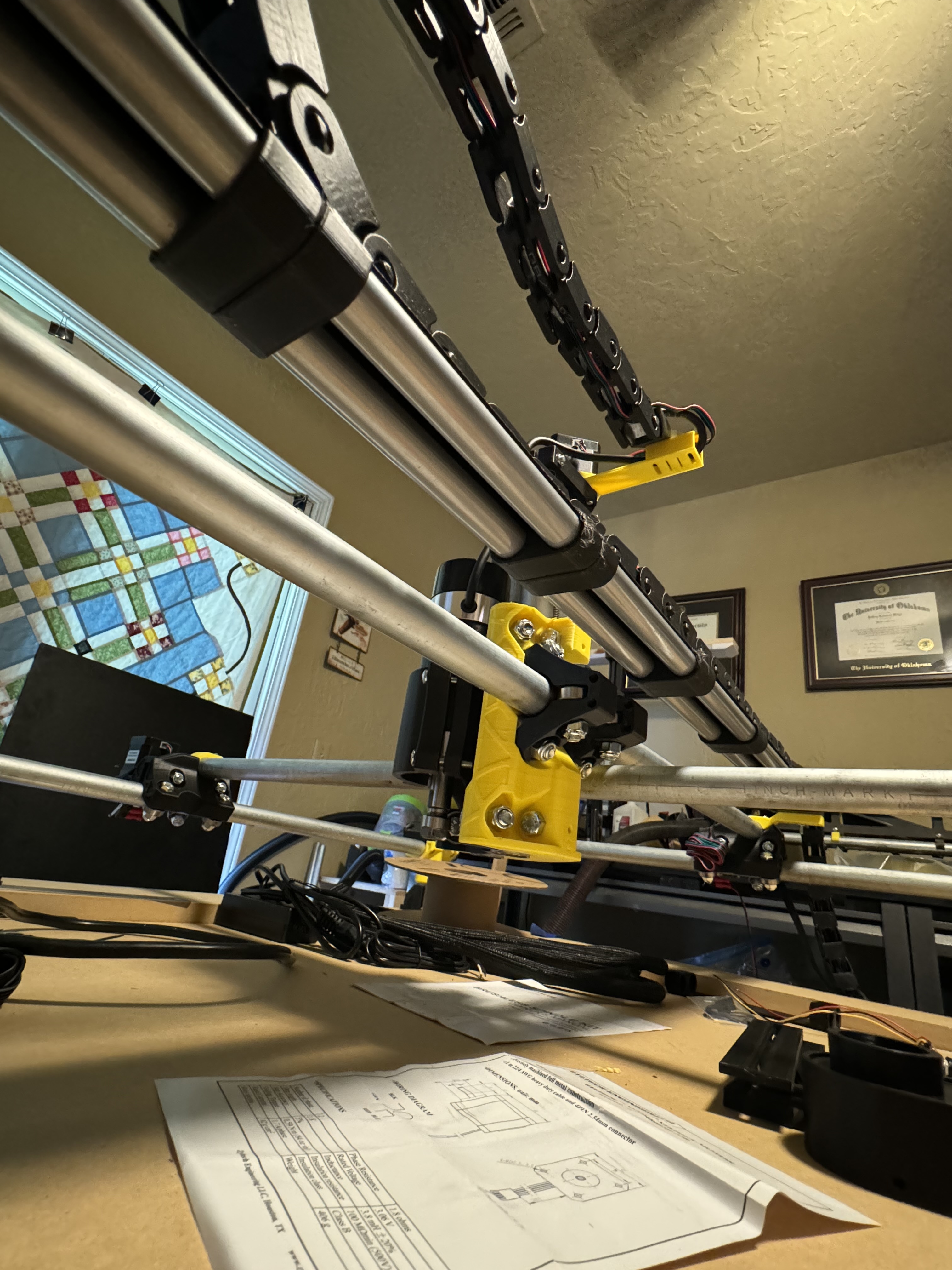

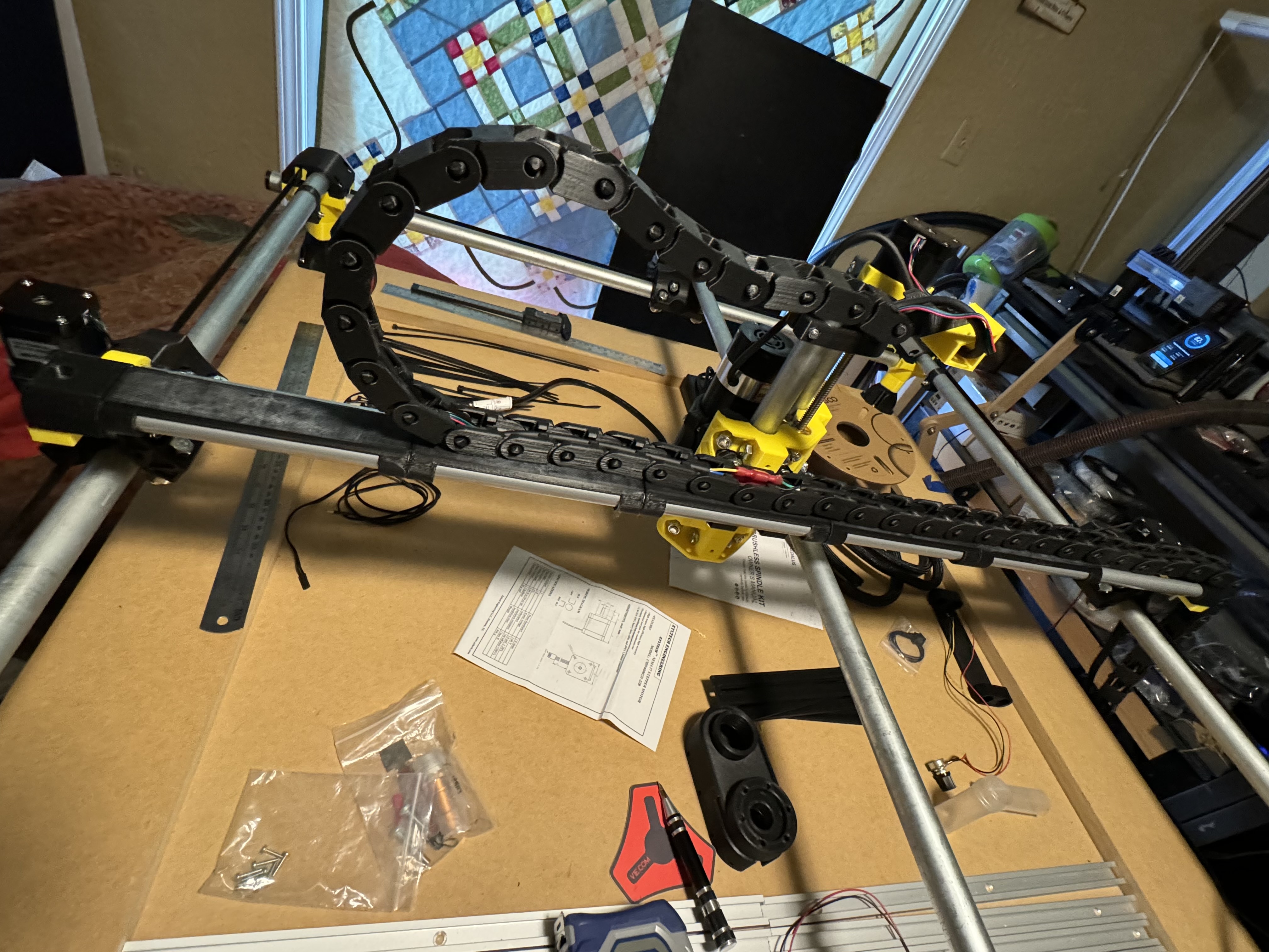

I’m also nearing completion on the drag chain and support system that’s suspended between the Y-axis trucks. It’s two more of those 16mm pipes I had a bunch of with some printed ends and platform pieces for the chain to rest on. I’ve got a few 2-in guide sections printing now to keep everything on the platform.
I found a few designs for 23.4mm Parallel EMT Conduit Chain Support for side drag chain supports to go along the back and right side to keep everything off the table as well that I’m debating… I think I’ll build chains for those either way, just debating the need to keep them suspended off the table or not. They kind of remind me of some 8-bit graphics from the old Nintendo games back in the day…

I got the spindle and Z-axis drag chain and platform finalized, had to add a few taller guides towards the far end to make sure the chain doesn’t fall off the side.
Also got the structure of the control box and most of the wiring done. Just need to do some crimping to wire in the stepper and end stop bridge to the back panel.
Then I need to cut all the spindle, stepper and end stop wires from the MPCNC to length and solder in the aviation plugs.
When all that’s done, I can fire her up and watch the magic happen!
