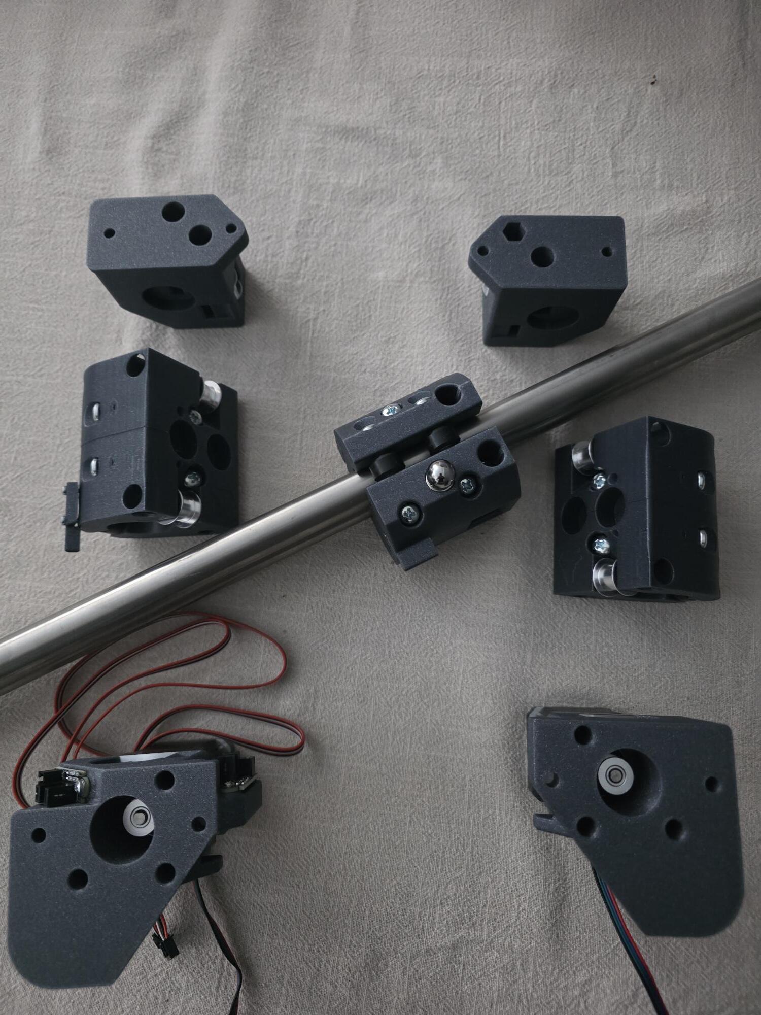

The procrastination build
The ZenXY kit is arriving next week, I am reprinting the parts and I have the large rails. I don’t have the glass or small rails yet.

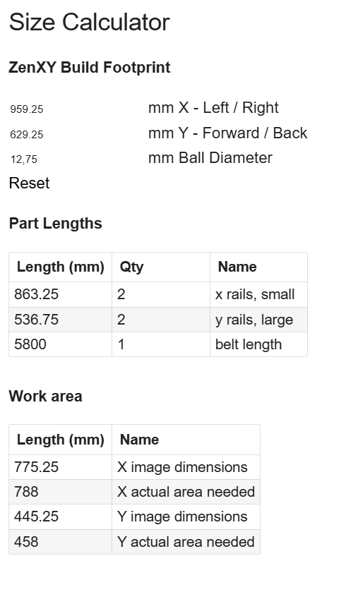

I’ve been looking at the calculator but it doesn’t compute :stuck_out_tongue:
If I go with the 80x37 cm glass, what will be the length of the small and large rails?
Should the “X image dimensions” be 37 cm or could it be more and then I restrict it in firmware?
This calculator, right?
https://docs.v1e.com/zenxy/zen2calculator/
That should be good. It is based on the total table size, so you could cut a hole in an existing table.
I tweaked it a little and I couldn’t select the non US version on my mobile for some reason. But I tweaked it until the “actual area needed” was 12mm smaller than your glass (to give some room for a lip to hold the glass up).
The X rails and Y rails have to be larger than the glass, for sure. This looks right to me.
Yes, that’s the calculator I’m wrestling with. I can’t select non US version on my computer either. Perhaps that option is not availiable?

This is the size I am going for, glass is 80cm x 47 cm. The “actual area needed” is 12 mm smaller then the glass I intend to use.

This is the current state of the build, I need to cut small and large rails into correct size. Would it be possible to move this thread into the ZenXY “Your builds”?
