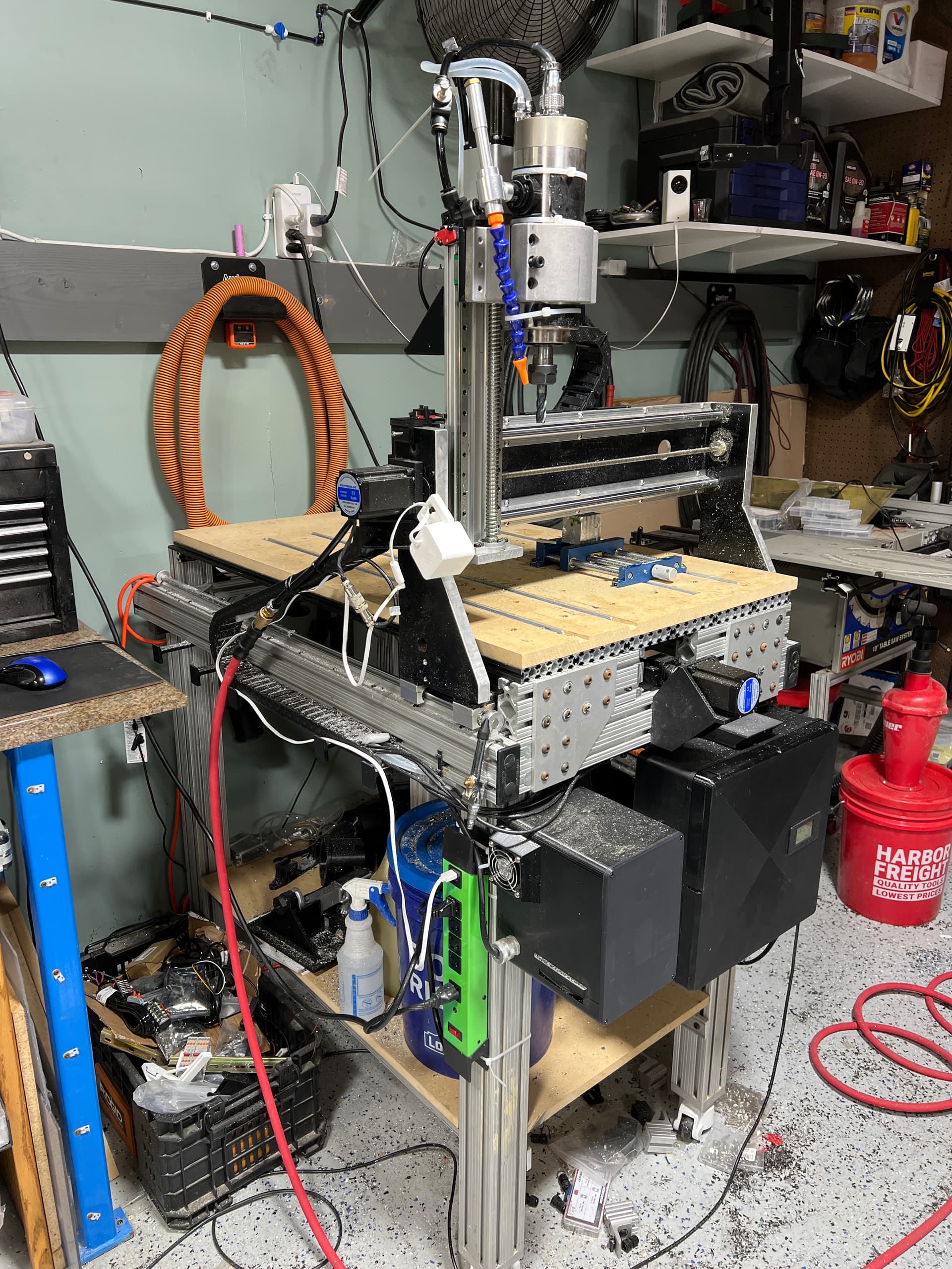

New to the forum. I built my second cnc during Christmas break last year, and it’s been a whole new learning experience.
Found this forum because i started with fluidial and loved it, but have now fried 2 integrated esp32 boards, both suspiciously proximal to dropping my pendant. So, rather than keep on replacing $50 m5s, i decided to try the cyd.
I soldered a new esp module and it’s back up and running, but the s3 in the m5 was also dead. Apparently i got flux or something in the sd slot, so now the push-push on the controller doesn’t work either.
While building it i noticed the sd slot and my search on whether it’s usable in place of the controller slot led me here.
I should mention i did not get a jackpot because i haven’t been able to find any in stock. The v2 sounds like a big improvement over my pibot 4.9, if nothing else for the esd protection.
I’ve added ferrite beads to everything going into the pibot, and added a couple 220ohm resistors to the tx and rx lines. I saw some mixed comments on tvs diodes and haven’t found any in the 3.6v range with low capacitance yet. I’m currently using gx-16 connectors at both ends with shielded cable, but will be swapping to the rj12 connector for the cyd.
Any other recommendations for hardening this princess?
looks like a great community. Wish i got the jackpot, but at least pibot also supports the fluidnc project. It’s a huge improvement over the old arduino grbl/ugs setup of my first diy machine.
First off, Cory, welcome to the V1 community forums.
OK, a bit of details from having and using M5Stack and CYD pendants. Never, ever, ever, connnect or disconnect the pendant when the machine is on. Even on a machine with otherwise reasonable ESD protection, you can blow the ESP-32 on either side by doing so.
Unfortunately, that includes disconnecting things even intermittently during a drop.
Particularly if your machine doesn’t have suitable ESD and current inrush protections, you’re risking killing the microcontrollers during plug/unplug events.

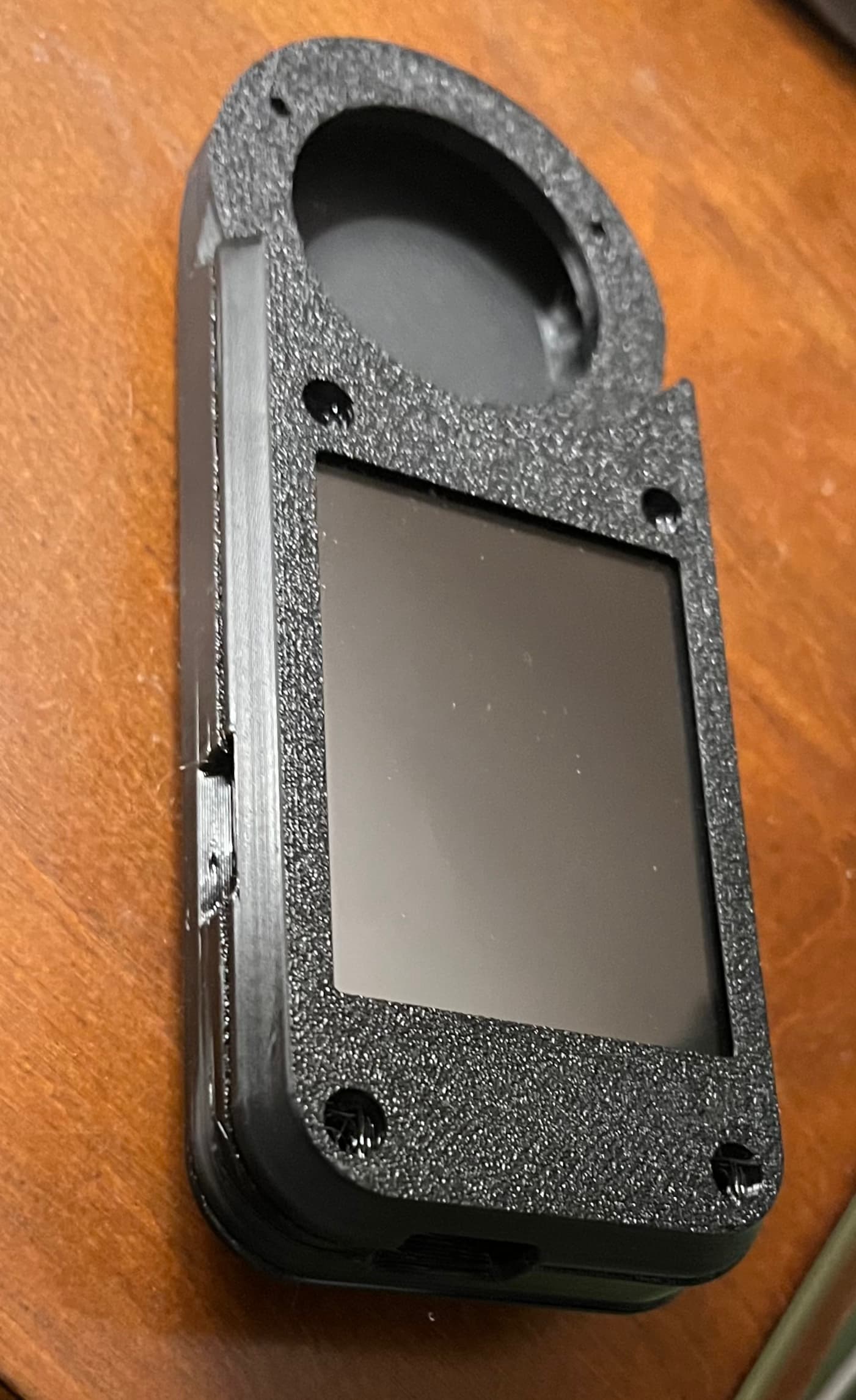

Printed one of these, that case is a beaut. I will need to get better pictures of the RJ12 connector breakout, I still don’t think I have the right one.
Ryan- on the printables site for that case, there’s a question from a maker who couldn’t find the right part. On one of these threads I mentioned it was a bad link, and you were going to update that posting.
I can’t find the forum thread here nor see any updates over on Printables about that.
I like this enclosure way better than the one with the three physical buttons (which are redundant with the UI on the CYD having touch buttons).
Most likely I’m going to swap my two CYDs that are built up over to this when I confirm the RJ12 breakout that it needs.
I’ll post a make over on Printables as well when I get one fully assembled.

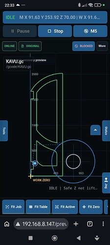

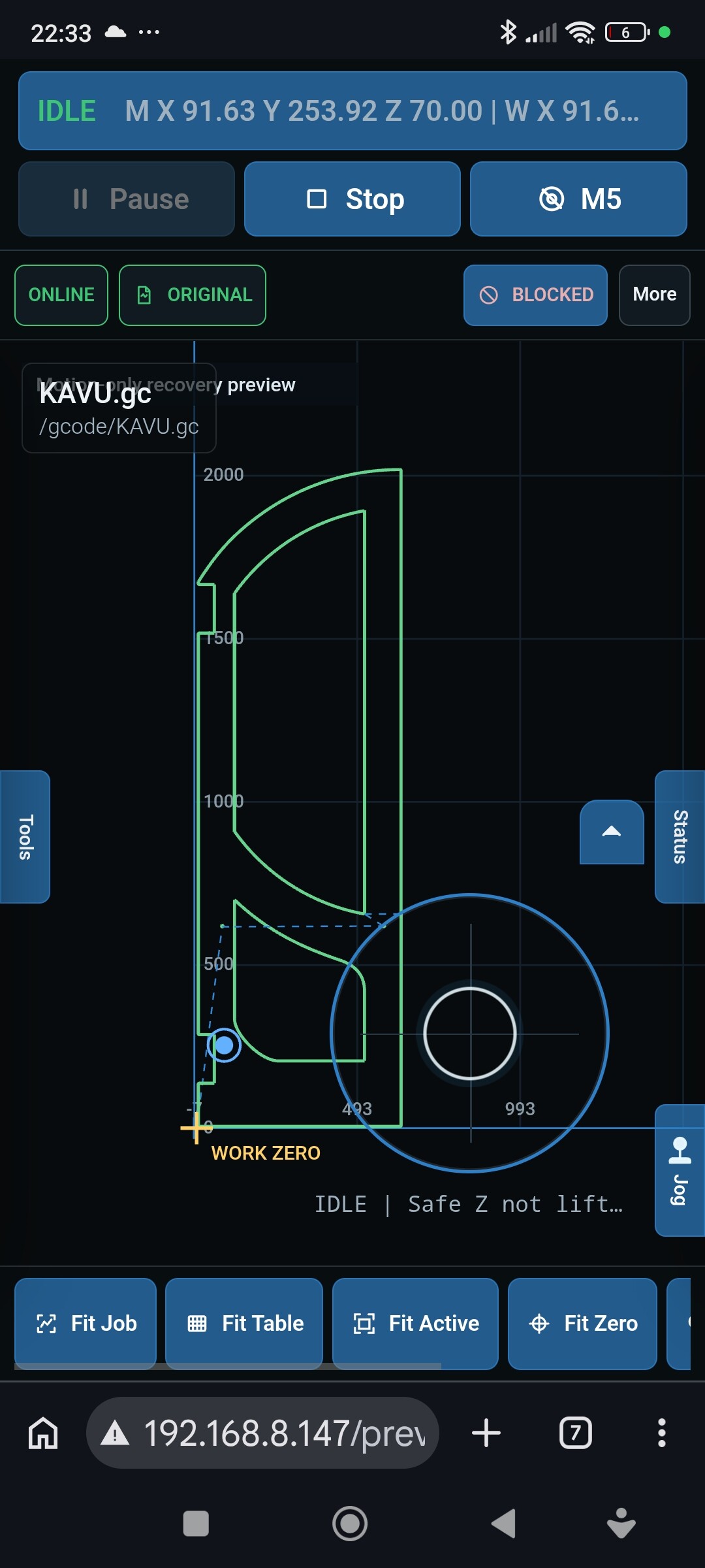

I have been building something similar for my Marlin-based LowRider 3.
It started when my TFT failed and I connected an ESP32-CAM to the SKR Pro over UART. The ESP32 has its own SD card, creates its own Wi-Fi network and serves a mobile web interface.
It has gradually grown from a simple pendant into a guided job workflow: upload a file, preview and place it, set the work zero, check the bounding box, do a dry run, arm the job and start cutting. The ESP32 then streams the file from its SD card to Marlin, so the phone does not need to stay connected during the cut.
I have added a video at the end of my project thread that shows the whole process, starting with connecting my phone to the Wi-Fi created by the ESP32:
https://forum.v1e.com/t/i-replaced-my-lowrider-3-tft-with-an-esp32-cam-web-pendant/54301
The video moves quite slowly because I wanted to show every step. Watching it at 2× speed is probably a good idea. :slight_smile:
This discussion also made me wonder whether the same system could work with FluidNC. FluidNC would remain the motion controller, while a second ESP32 would handle the interface, files, preview and job workflow.
I would personally connect the two ESP32s using UART. A wired connection feels much more reliable for a CNC machine and is not affected by Wi-Fi problems or interference.
The companion ESP32 could then communicate with FluidNC using normal G-code and GRBL status commands, much like it currently communicates with Marlin.
