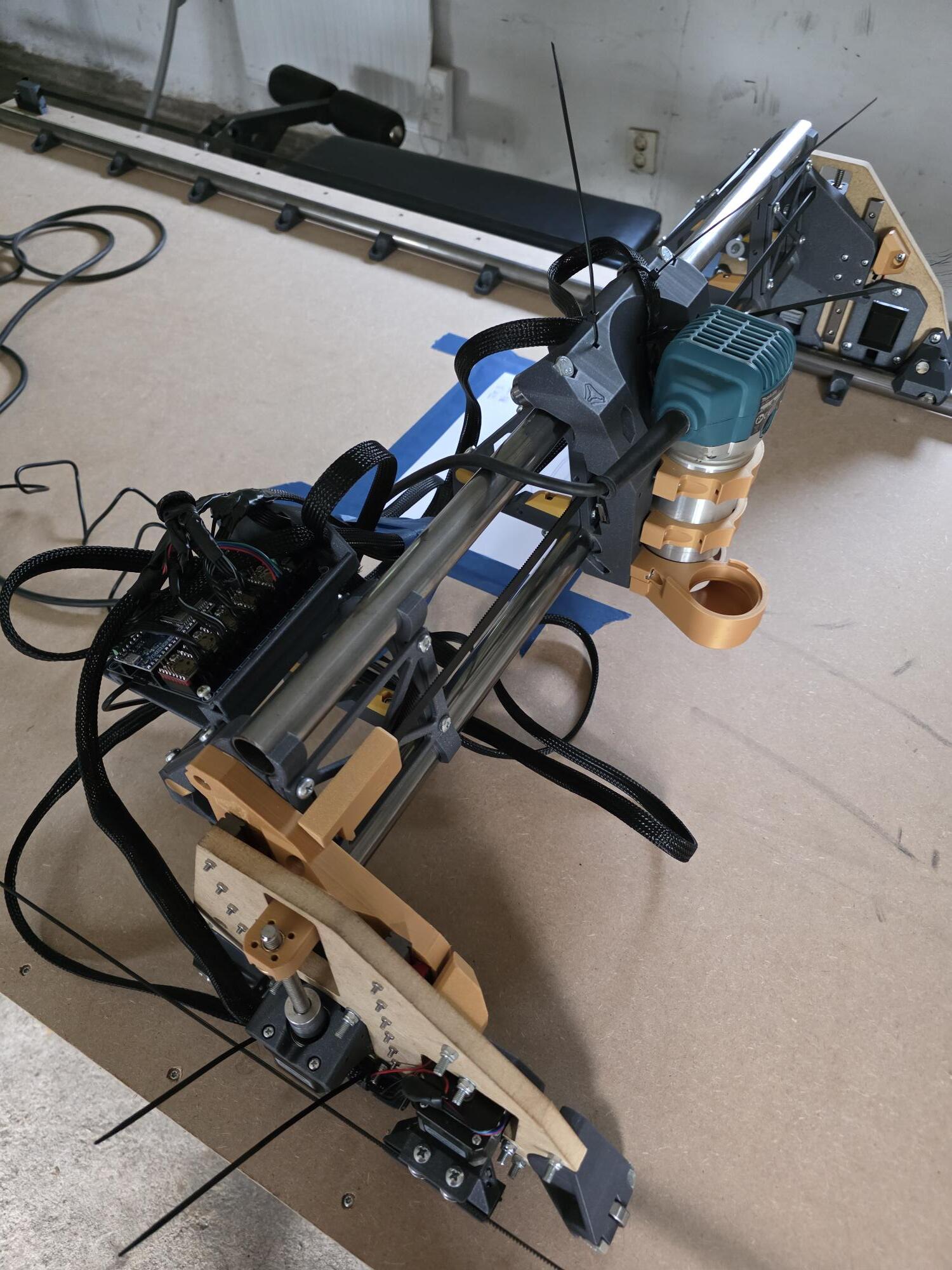

I was going for a LR4 build but I had all the parts for the LR3, so I build it. Printed in 0.16mm layer height in the colors glitz grey and gold.
I had a lot of fun printing, planning and assembling this build. It uses a Jackpot board.
I also had fun drawing the crown!

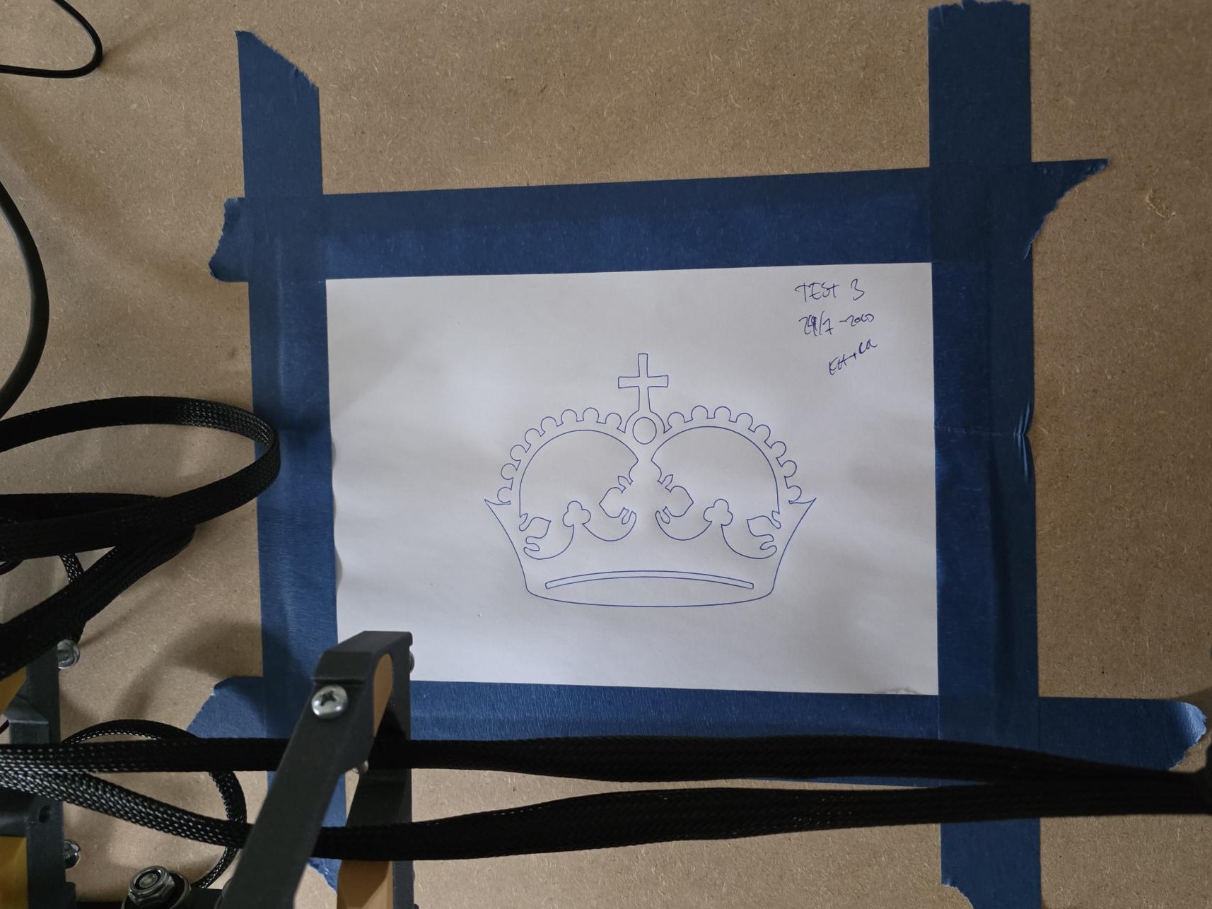

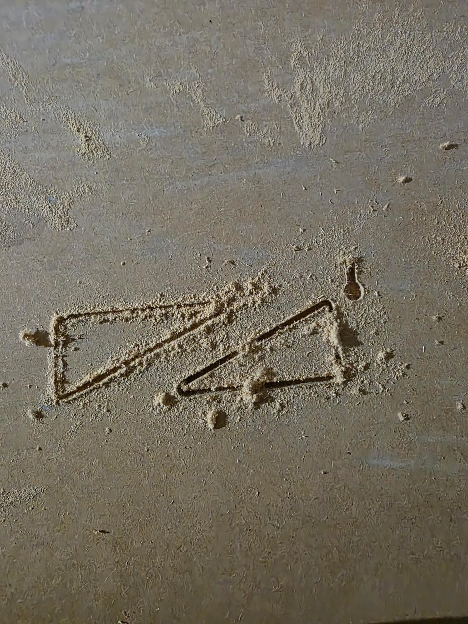

I finally had some time to play around with the lowrider 3, I measured the diagnoals and were within 1 mm so I did a quick test cut. Didn’t use a finishing pass and I used pretty slow values for plunge rate and speed.
Is the finishing allowance/finishing pass a percentage of the router bit? And what number of tabs is reasonble for the strut plates? 2 per hole? or 3?
Yes, usually around 10% (3-3.5mm for a 1/8" bit)
Depends a bit on the material and shape of the part/hole. For a triangle, I would suggest one on each leg.

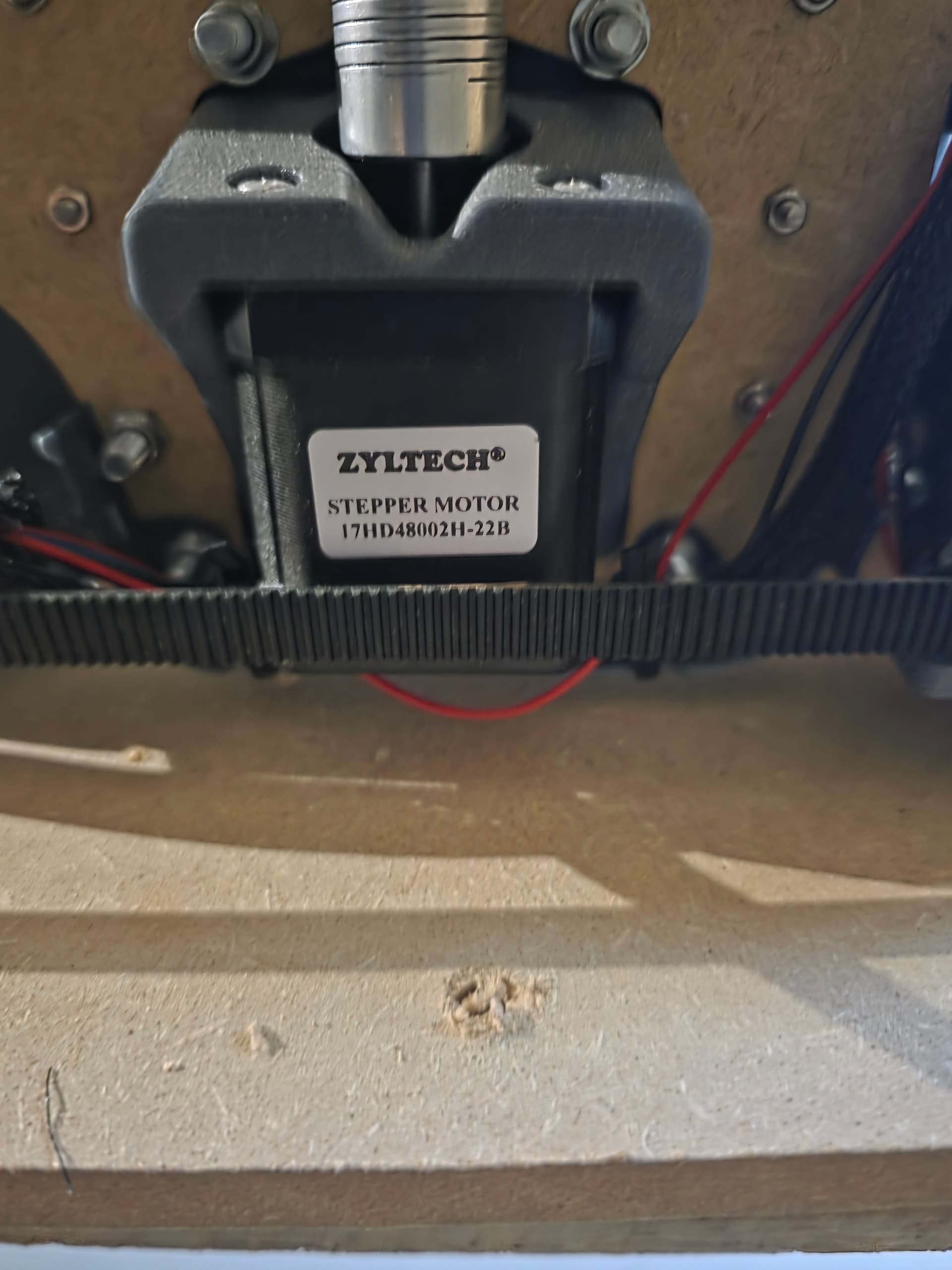

So I was redoing the cables into the jackpot case and I accidentally cut one of the endstop wires from the motor. These are the motors I have. Can I take a wire from another motor and unplug the broken wire and plug in the new wire??
Did you cut the motor or Endstop wire? But basically you can use any wire to extend the wires again.
I cut the black wire of the endstop, I found a wago connection that might work.

Wagos work or those little smeltythingies. Don’t know the name. :smiley:
