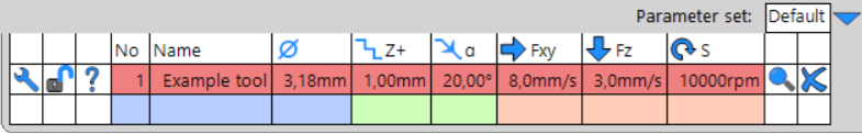

I am slowly learning EstlCam, very nice software!
Are these settings ok? I am confused about the plunge angle? Should it be 90 deg in MDF?
You can easily do 90° as well as at least double X/y speed. :slightly_smiling_face:
