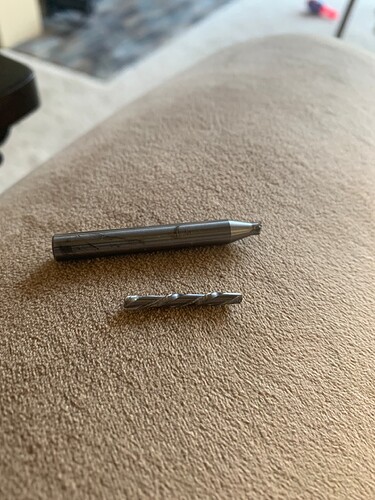

Just broke a 1/8” spiral down cut, 1/4” shank in a piece of cedar fence picket -like, the softest wood I have- running at 15mm/s, 3mm step down.
Hit a hidden knot or something, and it skipped a bunch of belt teeth in the Y direction . The gantry carriage also looks like it’s a bit wonky
Once I get some time this evening, I’ll fire it back up and square everything, see where we are at.
I had 1 job left to go before Sunday. Company logo sign. Uugghh
The steppers probably skipped (which sounds like the belt is skipping). They aren’t hurt by it. There’s aren’t actual gears grinding when that happens (even though it sounds like when I learned to drive a stick). Hopefully your machine is totally fine.
Weird that it broke a bit. Any chance the bit stopped spinning, or the uncut part of the shaft hit the work?
Nope- piece was 5/8 cedar plank, but was a SpeTools long reach with 1.25” cutting length. It was 3/8” into the piece when it happened. The router was still spinning.
When I removed the piece, there was a
Small chunk of the bit embedded in a dense knot. It wasn’t visible on the surface. I don’t know- maybe I dropped it or it was defective?
